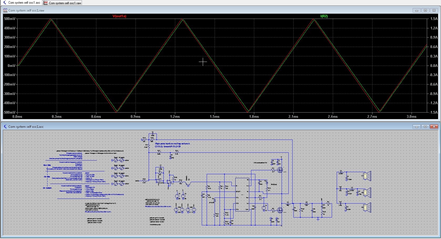

I have look also at some designs like ice-power, I do see it is patented, but technology is already known before that.

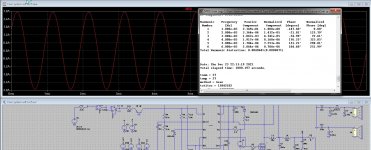

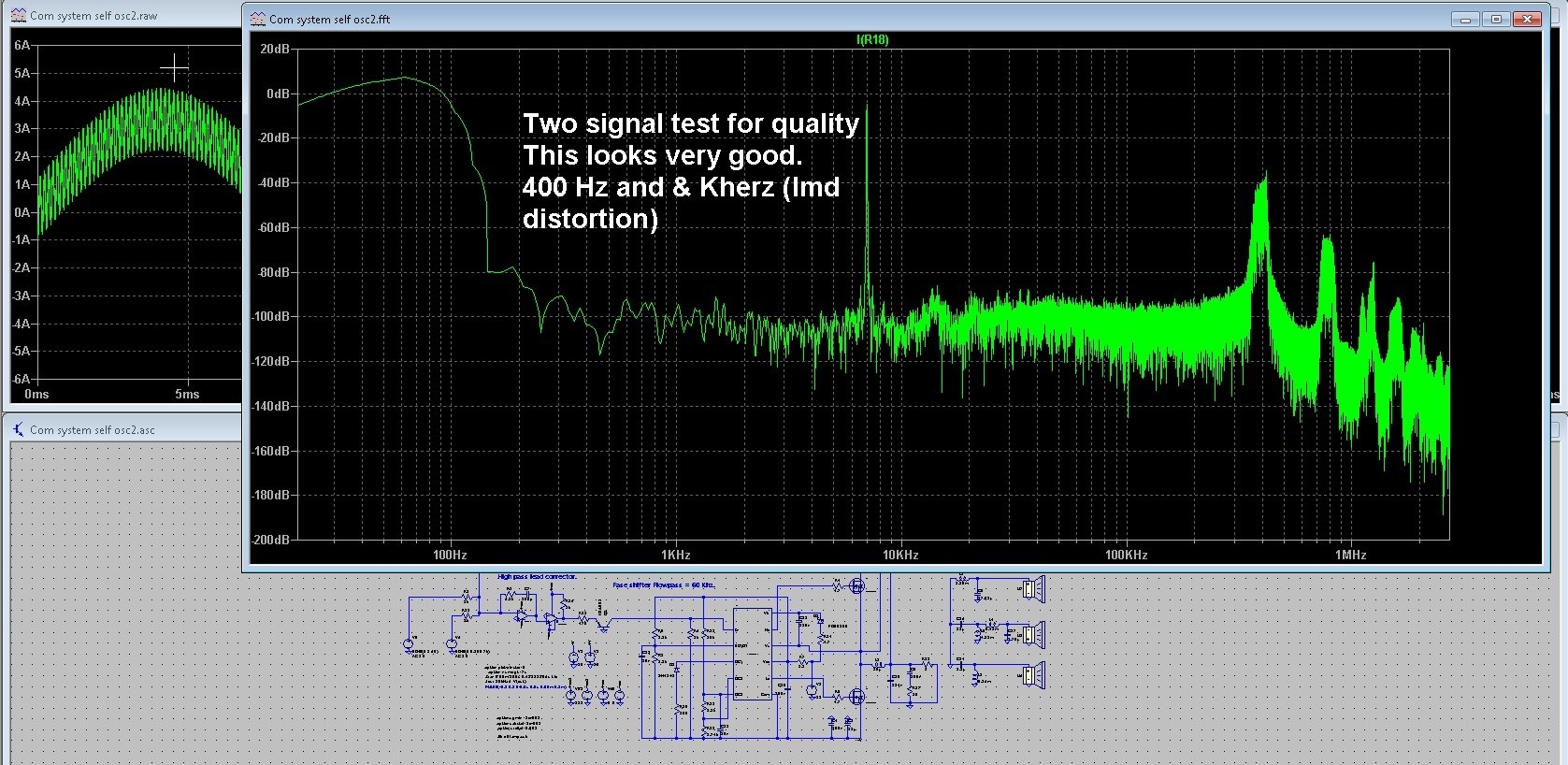

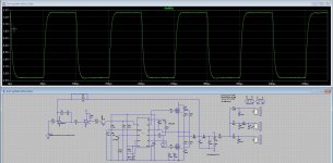

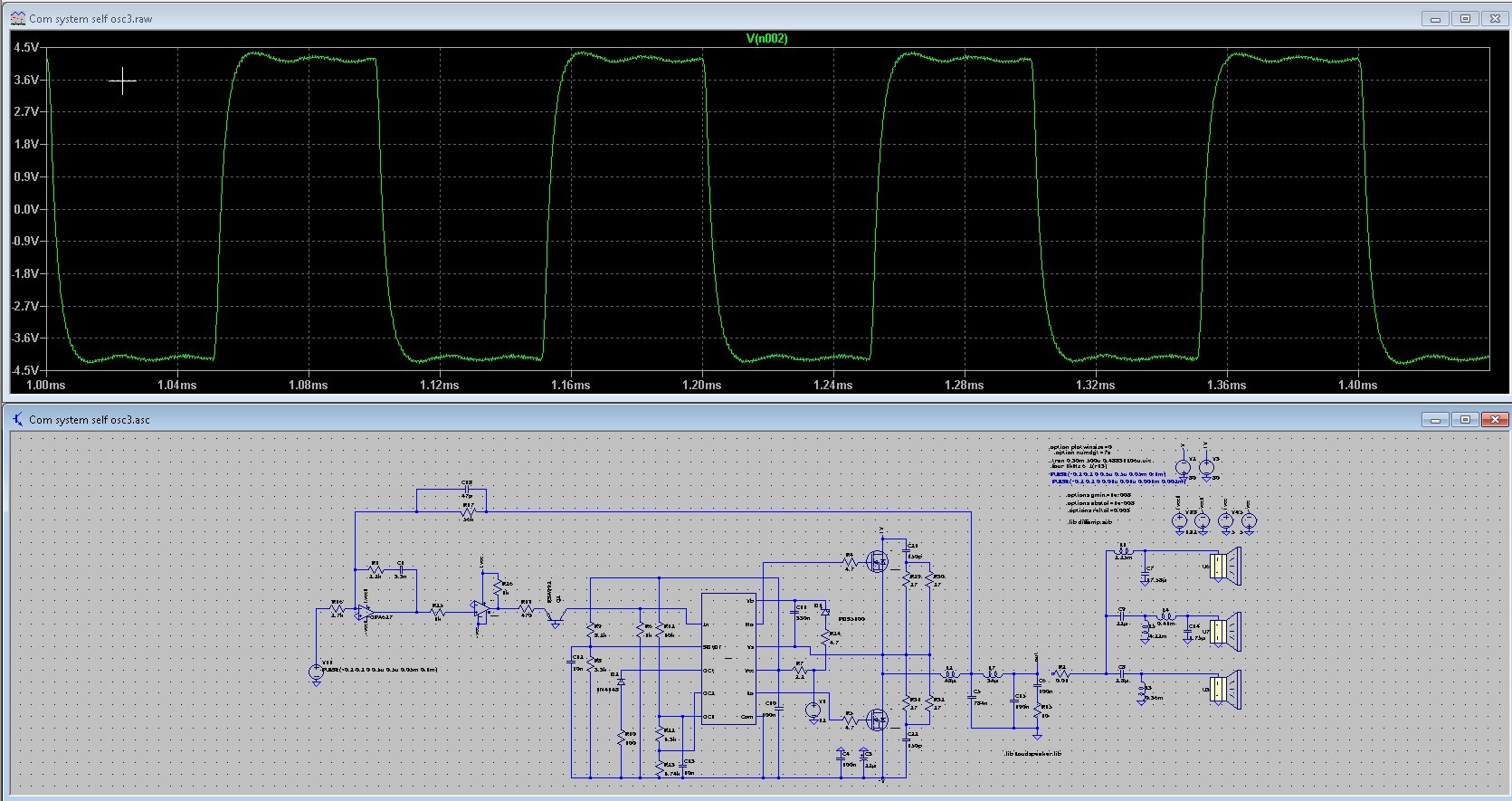

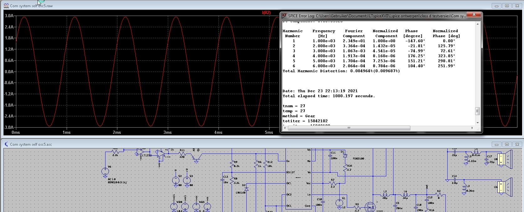

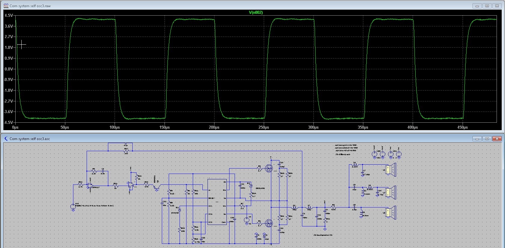

Here some tests, see the square tests, with three way speaker connected and open output, the feedback does quite good with pole set above switching, there it does control quite oke, even with open output, now using this as a front end, I can design further for lowest distortions, unfortunately both stability and distortion impact stability so need some compromises. Did see a high pass filter does correct quite nice for low pass lead purposes. Design has a faseshift oscillation system, and with a pole setting high there is no lead for low pass, only there is a zero present with no pole.
Pics let see results, with square 10 Khz, with speaker load (three way) and open, + result of triangle on input and see how nice it is on the output in 8 ohm resistor. first pic distortions look low. All is included with dead-time on highest setting UC 20124 chip..

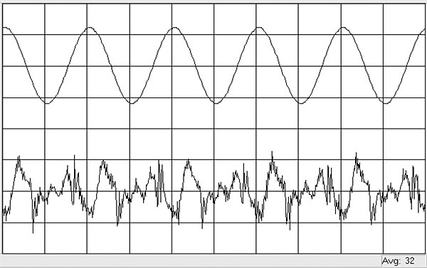

Now I know exactly what the reason is therefore - check out in this case the curvatures for distortion character (fundamental notched out) of various class-A and class AB power-amplifiers, reviewed in the magazine Stereophile - go to post #2 under

in the attached files here you will find basically the same diagrams, but only class D power amps - also reviewed by Stereophile (best results seems to be get from the Yamaha).
The question for me is, whether it is possible to obtain the same distortion character (sine wave, clean H2/H3) as with tube or class A solid state power amplifiers like Graaf GM200 or Pass Aleph 4 (as showed in the previous mentioned URL) through an optimized design. or is it an inherent/intrinsic distortion effect due the still present switch mode on all class-D amplifiers.

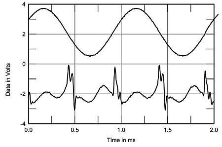

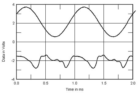

As I know triangle wave instead sine wave for distortion character on analog amps I get only in cases, if inside of a NFB loop are two gain stages and a so called C-dom (around 22-100pF) is in use. This capacitor create no low pass filter but a converter from sine wave to triangle wave (very audible, if you increase the value to 10-47nF).

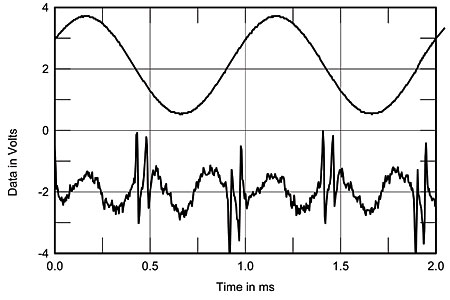

The Sharp SM-SX100 looks quite good despite the age - go to post #16 under
https://www.diyaudio.com/community/...ded-class-d-amplifier-overview-wanted.271519/What is here very special (in opposite to most used class D approaches) ?

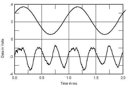

I have heard it on High End exhibition 2001 (Gravenbruch Kempinski/Frankfurt) and was impressed about the sonic quality at those day.

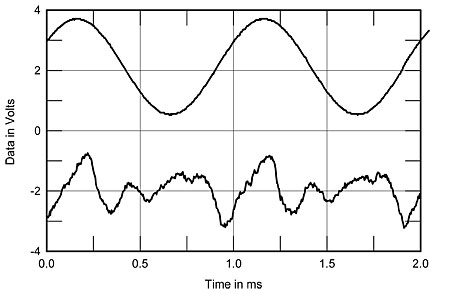

In this model with Class-D technology, the diagram of distortion character (fundamental notched out) really looks like from a Class-A amplifier:
LKV Veros PWR+ - go to Fig. 8 under

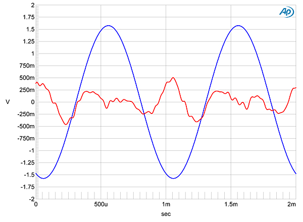

https://www.stereophile.com/content/lkv-veros-pwr-power-amplifier-measurementsfound under

I ask Mr. Bruno Putzeys concerning the issues mentioned in post #192 and he send me this statement in his reply:
Actually the effect you’re mentioning is solved by removing the hysteresis distortion that the output inductor (which all class D amplifiers have). I would suggest trying the Purifi Eigentakt modules - go to

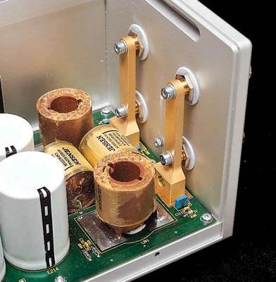

Why aren't inductors used in each output filter of class-D amplifier units that don't have these disadvantages ?
What kind of inductors are in use of the modules of Purifi Audio and the mentioned amp (with modules from purifi audio) in my previous post #196 ?

Inductors always have disadvantages. Any Magnetic material (like iron) used in the core of the inductor will have some hystersis. Using the magnetic core allows high inductance in a small space & low I^2R (resistance) power losses. One could use air core inductor, but it will be larger & the inductor magnetic field is more difficult to isolate and shield. The inductor cores in the Purifi amplifier have a closed magnetic circuit so the field stays mostly contained."....Why aren't inductors used in each output filter of class-D amplifier units that don't have these disadvantages ?

The TacT Millennium uses such inductors from Jensen without ferrite core (air coil):Inductors always have disadvantages. Any Magnetic material (like iron) used in the core of the inductor will have some hystersis. Using the magnetic core allows high inductance in a small space & low I^2R (resistance) power losses.
http://www.jantzen-audio.com/wax-coil/go to the attached photo
So what is the resonant frequency of those inductors? I don't see the specification.The TacT Millennium uses such inductors from Jensen without ferrite core (air coil):
