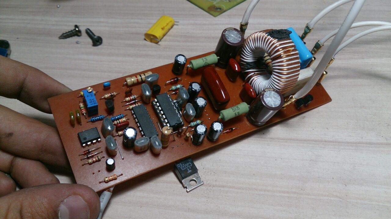

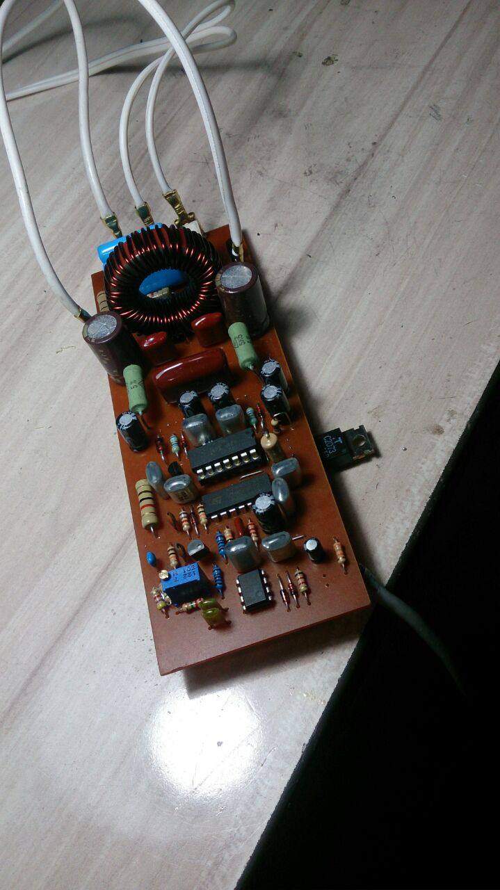

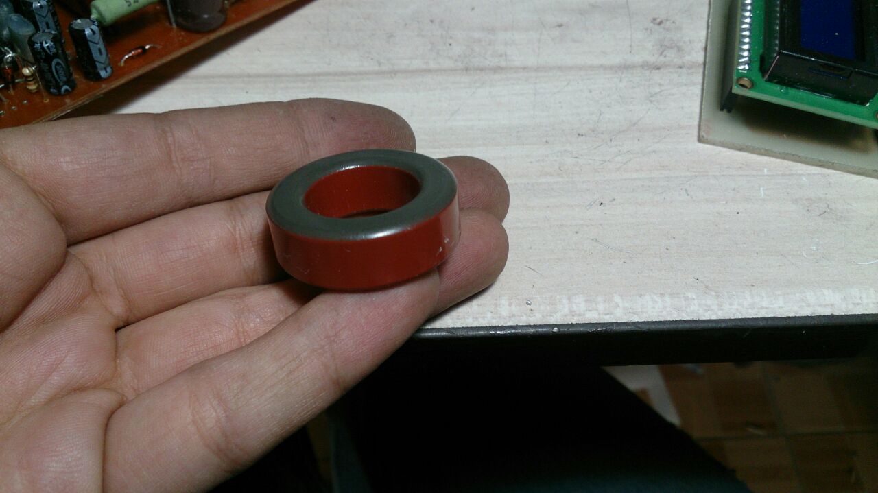

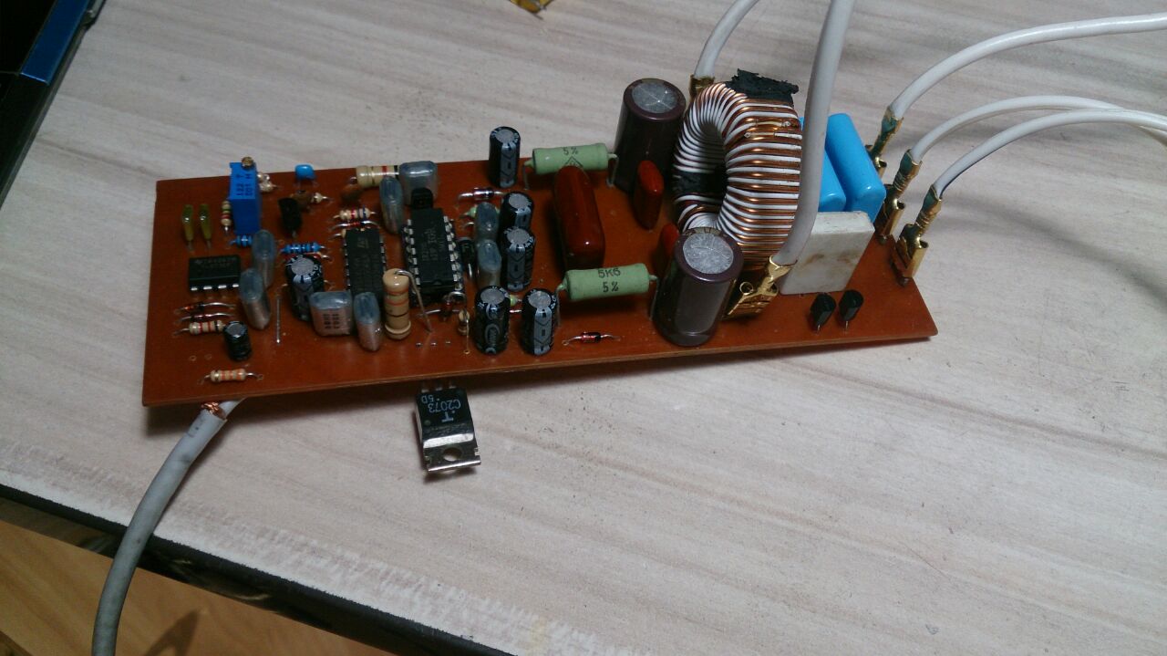

Hi
I made d200.2 and its working but sounds like snoring
I tried output coil from behringer dpa400 and powersoft digimod 1000
But problem still exist and its worst when turn the volume up...
Supply is +/-60
Mosfets are irf 540
Please help me
Supply is +/-60
Mosfets are irf 540
Please help me

you are using wrong fets . you are lucky the irf540 are still alive . use irfb4227 or irf 640 use at 8ohms only . your voltage is too high for irf540 fets
I changed fets but still have the problemyou are using wrong fets . you are lucky the irf540 are still alive . use irfb4227 or irf 640 use at 8ohms only . your voltage is too high for irf540 fets
I tried 640 and 260!!
