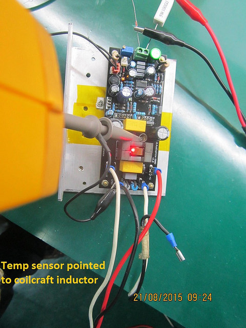

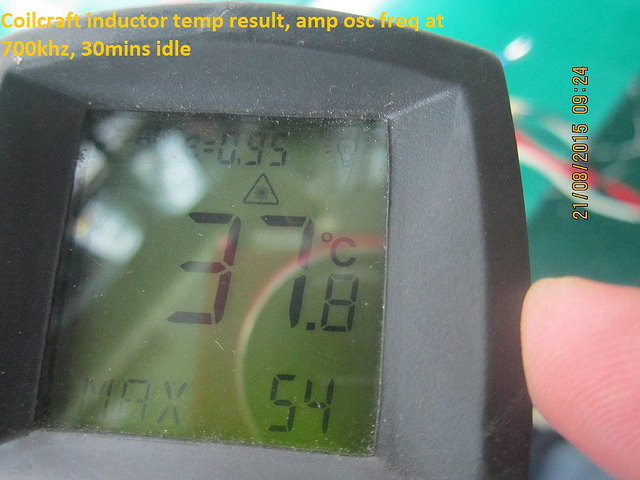

Coilcraft VER2923 is good, I'm using it for my jlaudiophile-250D and 900D. Was able to get 450W 2 ohms +/-65V DC rails (VER2923-153KL). Amp also survived when stress tested at 150W output in 1.5 hours (no fan or forced cooling). At 500khz and above operating frequency, the inductor is very cool to touch.

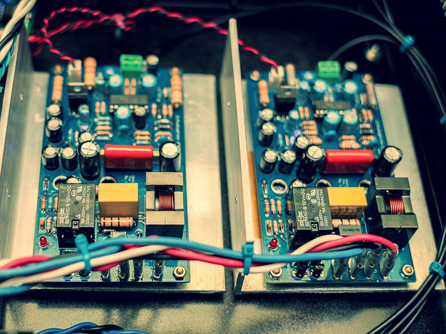

My new Apex "D100W" SMD Edition![]()
Nice work, what is pcb size
Regards
nice work sima . how is the noise issue??
