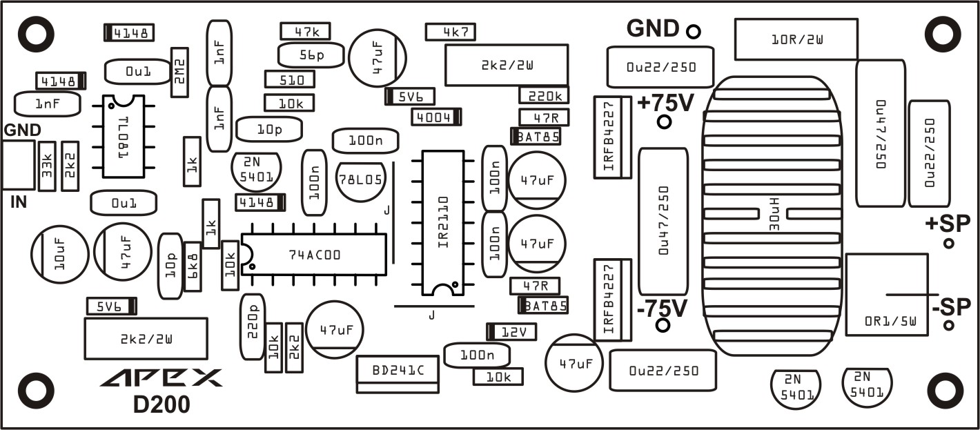

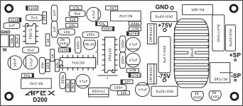

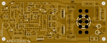

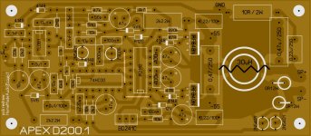

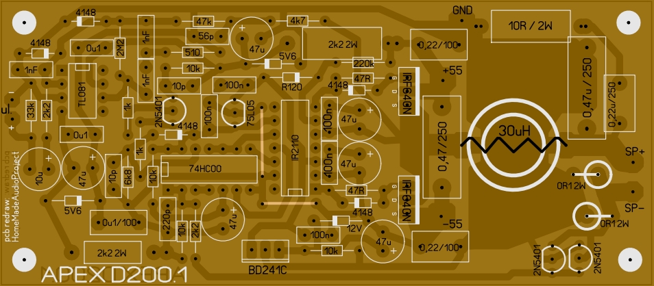

Hi Mile ,can you help me finding a working(tested) pcb and schematic for this Class D amplifier?

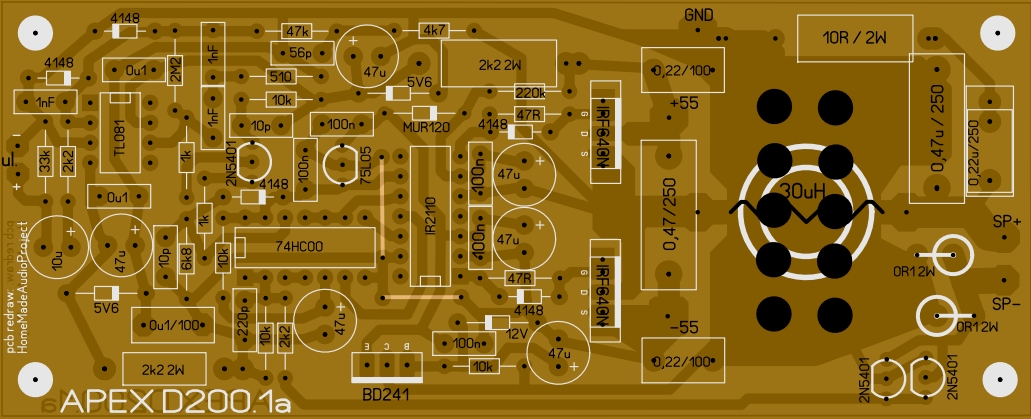

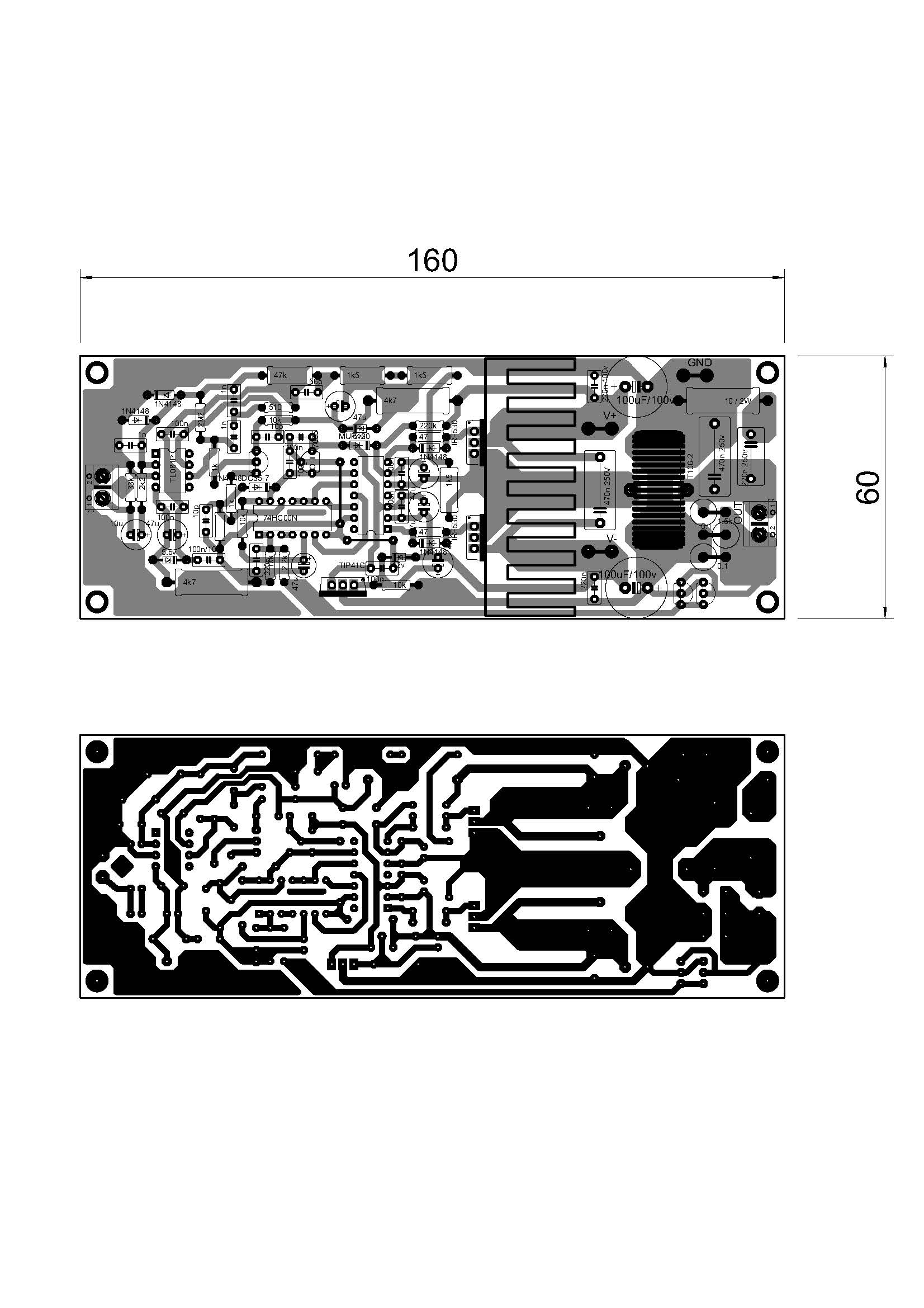

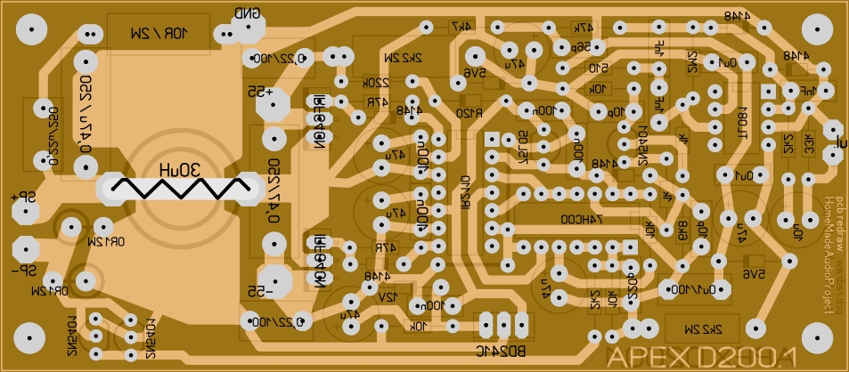

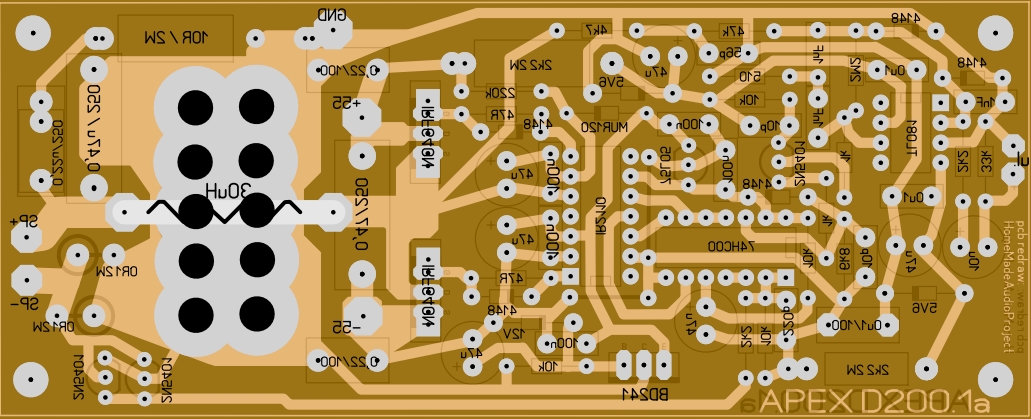

this should help. i did my APEX D200.1 (not 1a) files,but 1a files should work as well.

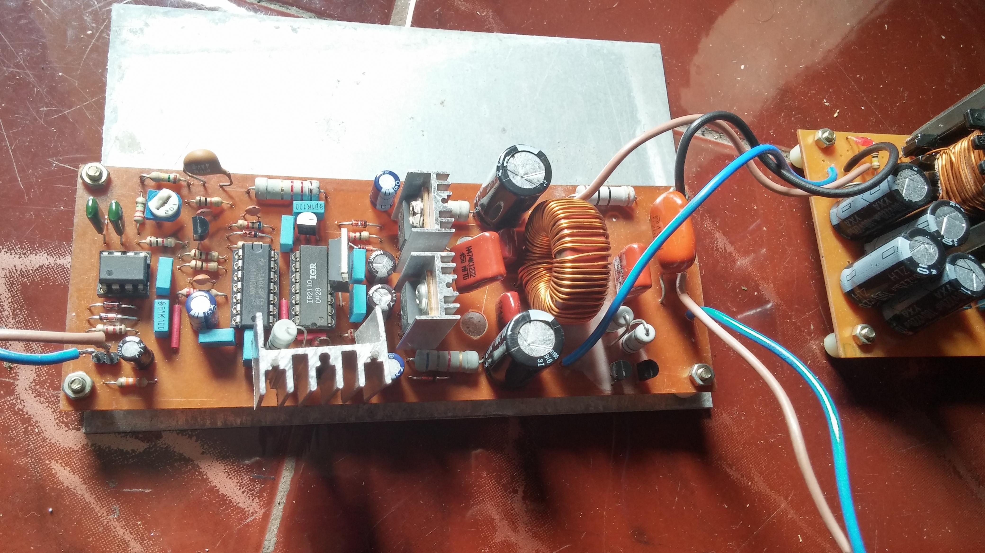

D200 - Manoj MOD
Thanks Abetir for sharing the PCB! 🙂
Tested with +/-45 and works fine!
But when I increase the voltage up to +/-80 I couldn't stop the switching noise. It also crashes Radio signals.
Used IRF640. Also tested with IRF740
Changed gate resisters from 10/22/47 ohms
Inductor T106-2 54 turns (tried 44 to 60 turns)
for MUR120 I used UF4007 then replaced with BYV29-200
Nothing could stop the noise under high voltage
Also noticed +ve rail voltage goes up to 120v only when the amp is connected to speakers. Powered by SMPS switching at 53kHz
Any suggestions please??
