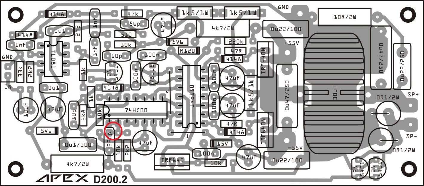

Anyone tested the over current protect? Will the over current in mosfet be reflected in output current sense fast enough? There's no delay after the trigger too.

I've traced the circuit for the protection. It uses 2 of the NAND gates(pins 1 to 6) for shutdown control, the input for the pins 1 and 2 of 74HC00 (encircled in the attached pic) is normally "low", when there's a voltage across the current sensing resistor, pins 1 and 2 will go "high", resulting pin 6 to output high then triggers the SD pin of IR2110.
But there's no delay for the trigger, the 47uf connected in pin 5 is only for startup delay.
I'm afraid the protection will loop fast (assuming current sensing in speaker out works) and might lead to mosfet destruction.
