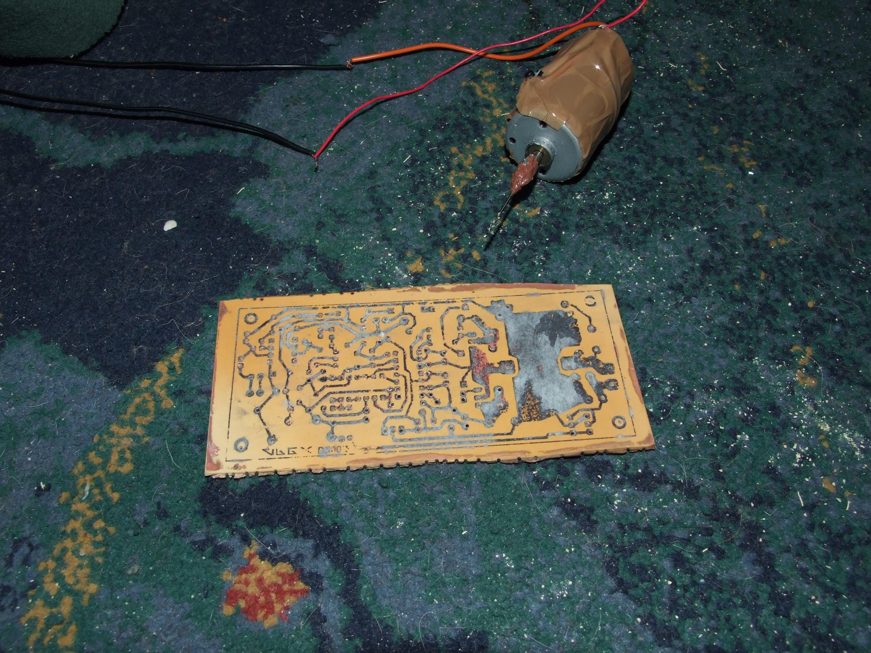

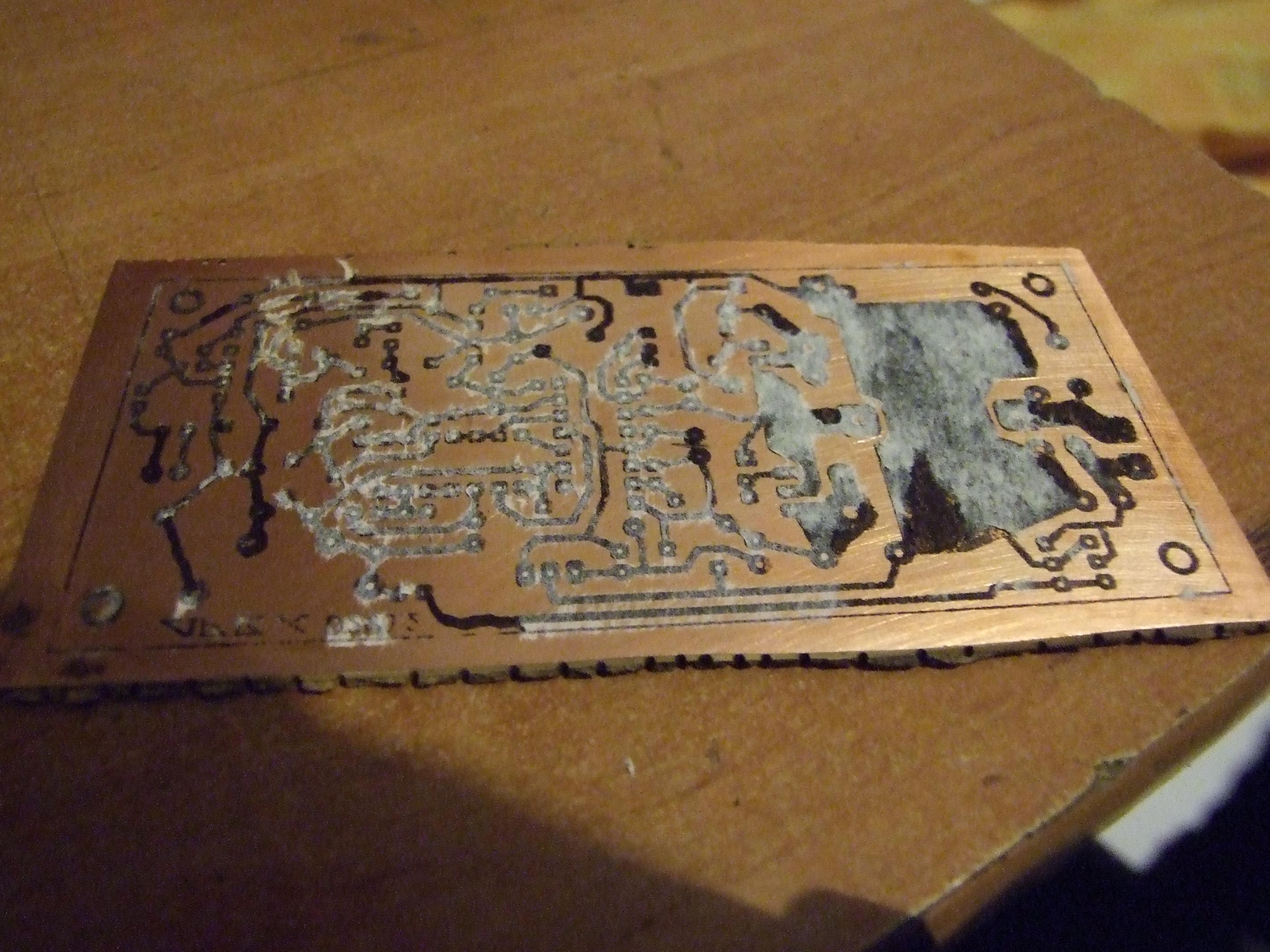

Pcb,only 1 chanell the other is so bad its not even worth trying,is this good for etching,looks pretty good for my first pcb ever,
Do you think its good enough or should i get another one,for the other chanell im obviosely goinf to get a new one
I suggest you to follow this method https://www.youtube.com/watch?v=tWnfnt2rNO0.
Also in youtube you can find many toner transfer method in order to improve your etching process.
All the best,

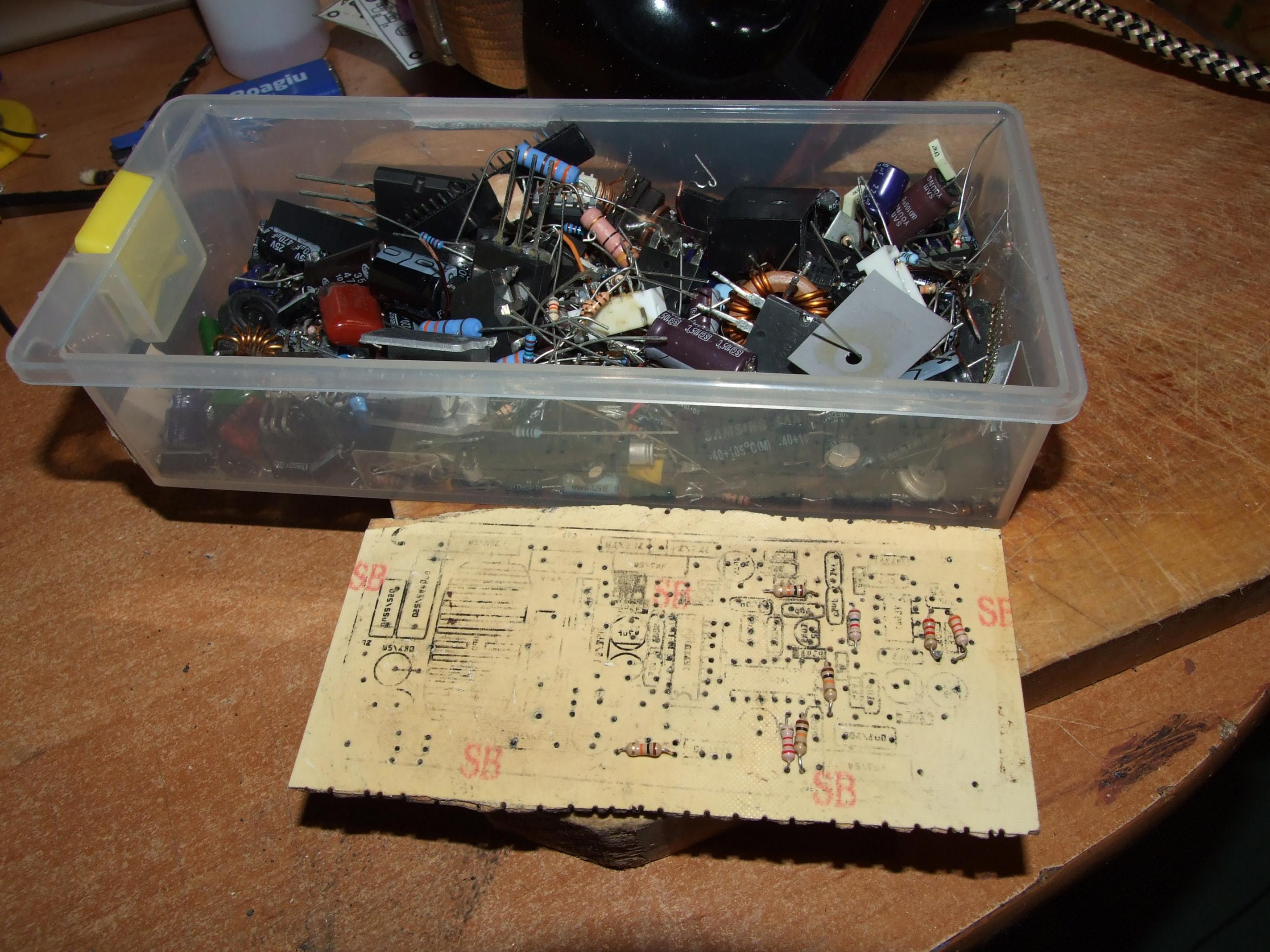

this is more like it,another copy shop,with different machine,non glossy paper.Plus this is cheaper,better,closer to me,i can easyly acces it when going outside since i have to walk just 200m
im starting etching after you tell me its ok
keep in mind im cleaning as i go

Petruv, make sure you draw with good pen or pcb pen. After etch do test with multimeter if any trace touch with other trace, check carefully. Im understand you`re so excited to make an amp but its good to give it a try 😀 . Next time if you draw the trace with marker or etc, draw it carefully 😀

i did it with a maker since they were some thinned out ones
Or you can place an order with itead studio and get ten boards for 28 us dollars shipped, though this requires having access to the PCB gerber files, which i'd guess is a well regarded secret locked away at apex's PC. Assuming Apex dident just draw his pcb's with a picture editing program such as photoshop, ms paint or similar.
and no norazmi, you cannot use a LS series ic, the circuit assumes and requires a HC series ic which is a mosfet based ic wheres the LS series is bipolar transistor based, the LS series is also much slower.

PetruV,
Are you doing laser toner transfer method? I guess it should be a good idea to practice first on a smaller design (lay-out). In my place there are two methods of toner transfer, using flat iron and the other using lacquer/acrylic thinner. I'm used to the ironing method and the technique on this one in order to come-up with very good results, is on the flat iron thermal setting and on the glossy paper being used. You'll have to practice on smaller design first otherwise you will only be wasting your precious PCBs.
