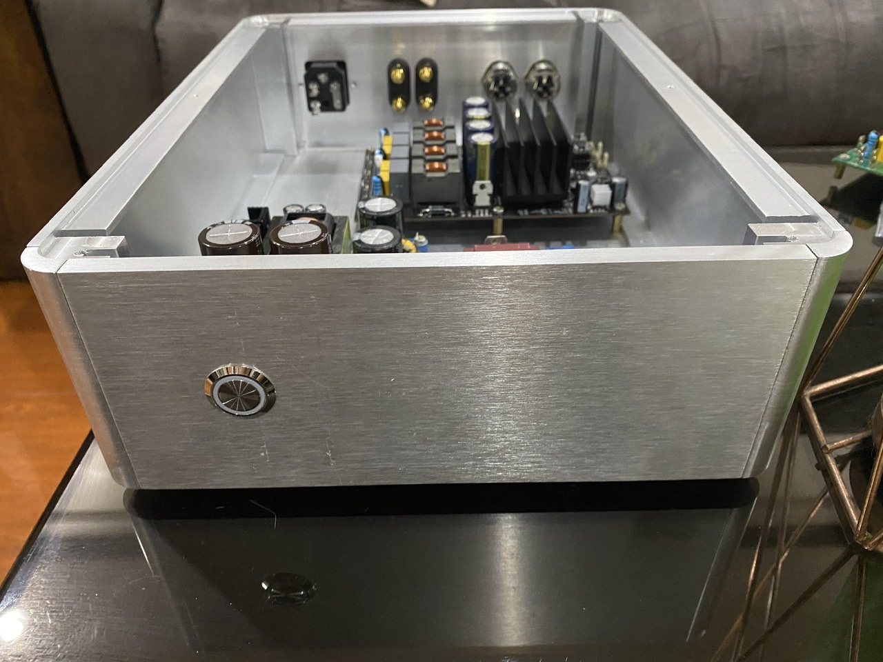

Sylph-d200 TPA3255 36V low THD build.
Test fit on BZ2409H chassis.

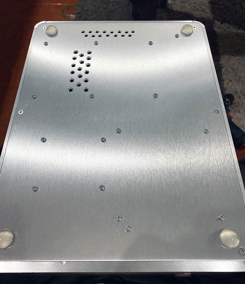

Nice Build ! really looks like mine )
I see you are using the same silver case.
Looks like my silver case is slightly bigger, I bought it here at 80USD shipping included.
I updated wirings to color coded. Momentary reset button installed on the back.
Chassis feet not yet arrived.

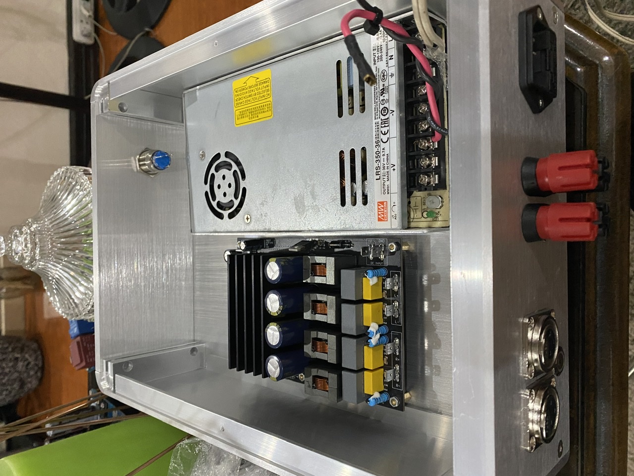

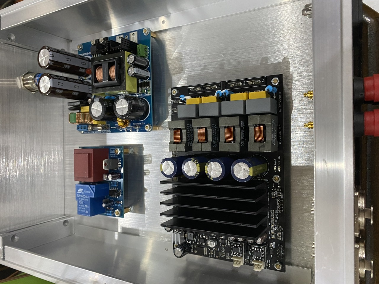

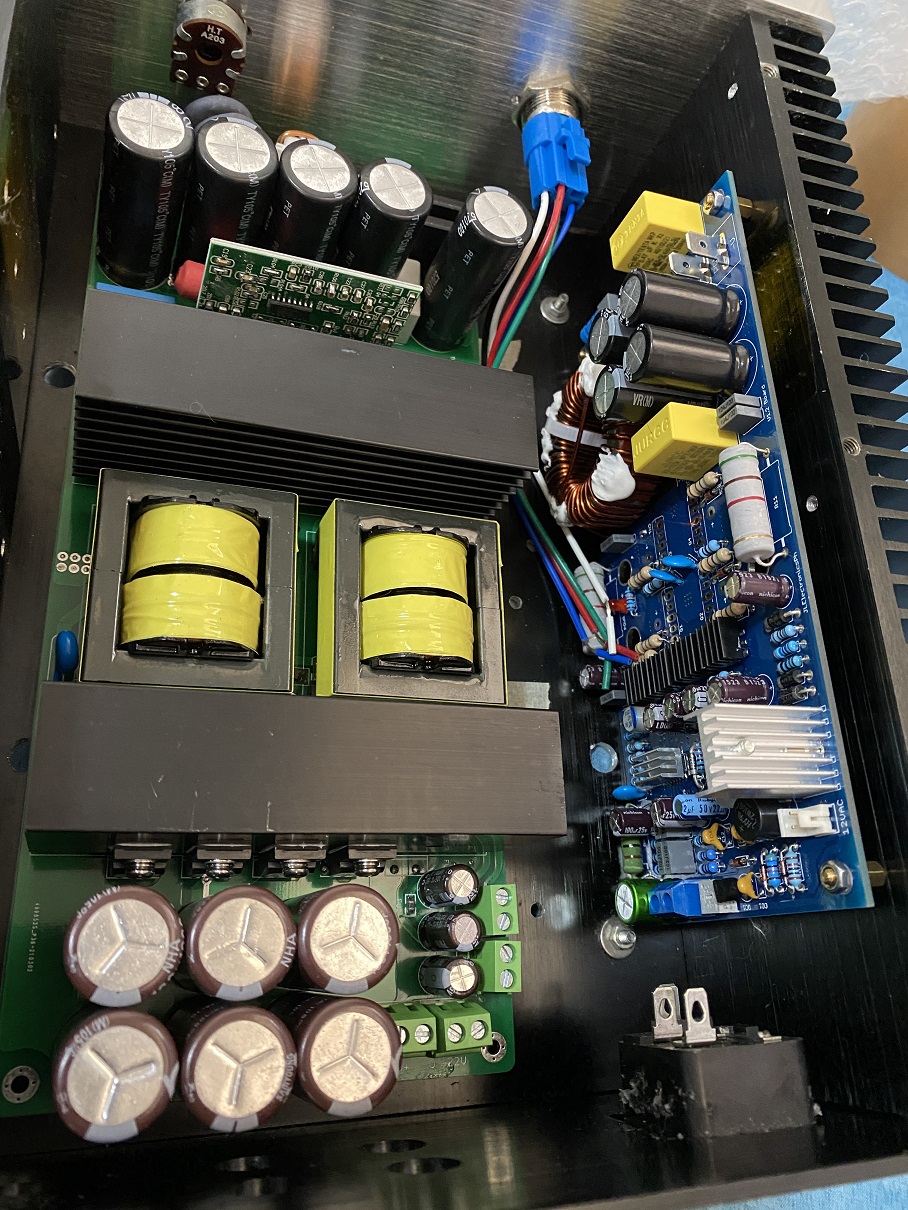

SYLPH-D200 TPA3255
I finished my first class d amplifier project.
Board: SYLPH-D200 TPA3255
PSU: Connex SMPS600RS 48V
Input Switch: Eizz
Stepped Attenuator: Eizz
Chassis: Modushop Galaxy

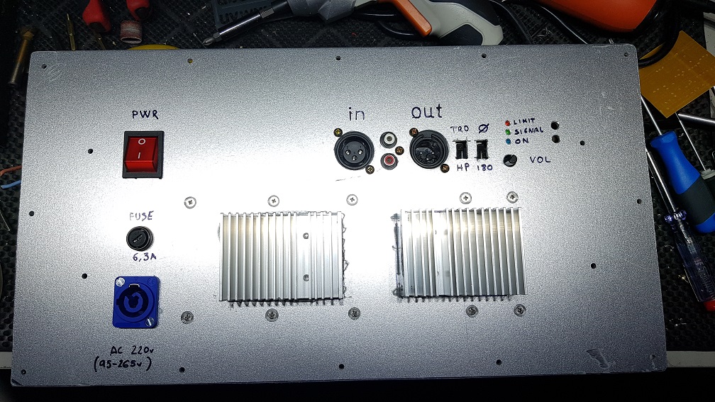

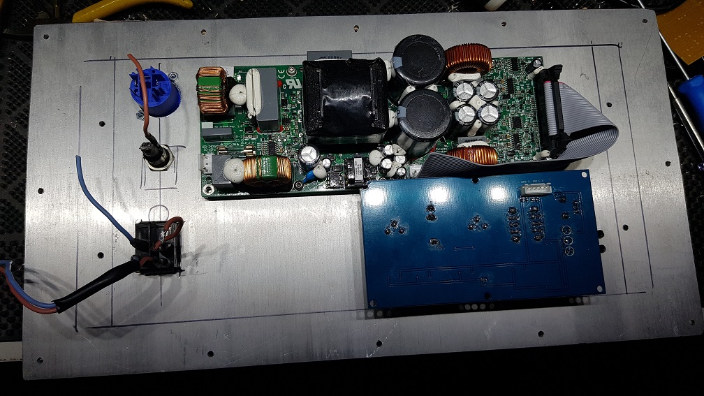

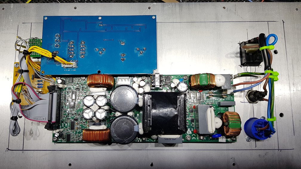

Hi!
Here a 2x15 "subwoofer plate, used in a sound reinforcement system, small PAs at events, etc.
Based on a 2x500 w / 4 Ohms bridged Pascal S-Pro2 module.
It packs a punch, hitting 1400 peak watts in the settings I use.
Used for many hours at 100% in dance sessions, it hardly heats up, a little more for the SMPS part.
As a preamplifier I use a low pass filter, cut off at 120Hz, and a small circuit with an NE5532 to invert the phase of channel II.
Regards!
