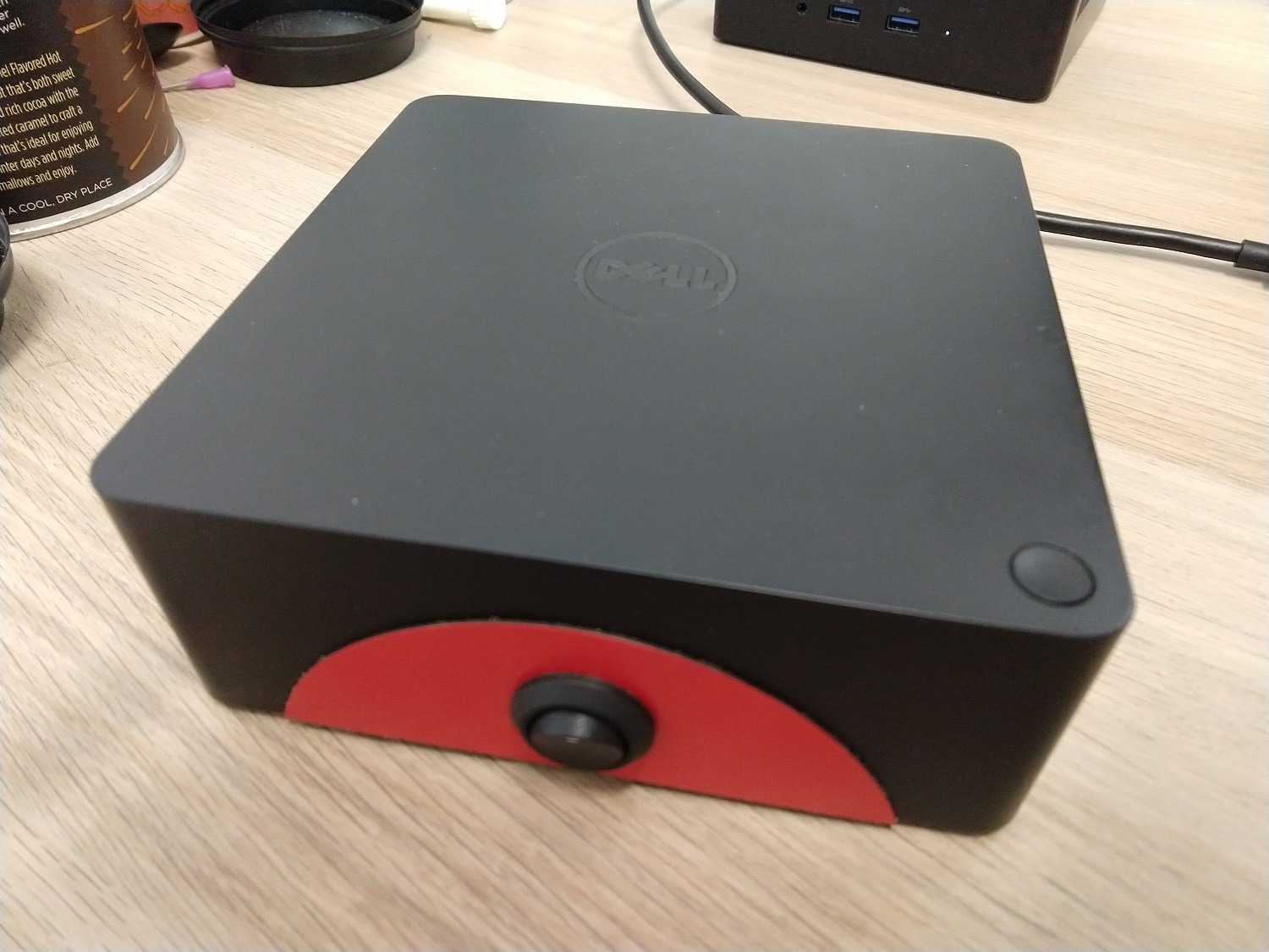

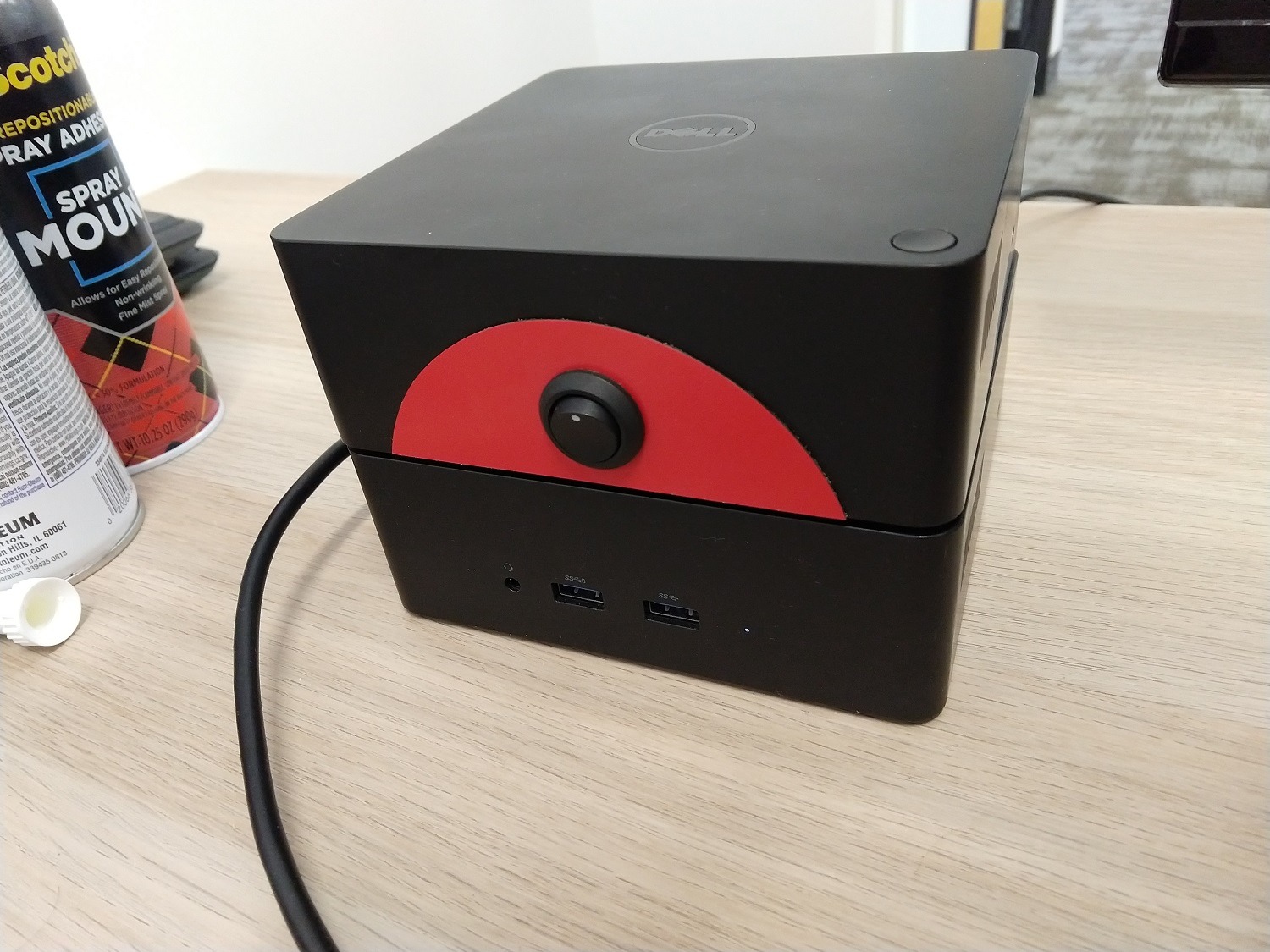

Stuffed a Sure Wondom 2x100W T-amp into a Dell TB16 Docking station chassis......
...last picture is the unit on top of a functional docking station........for reference.

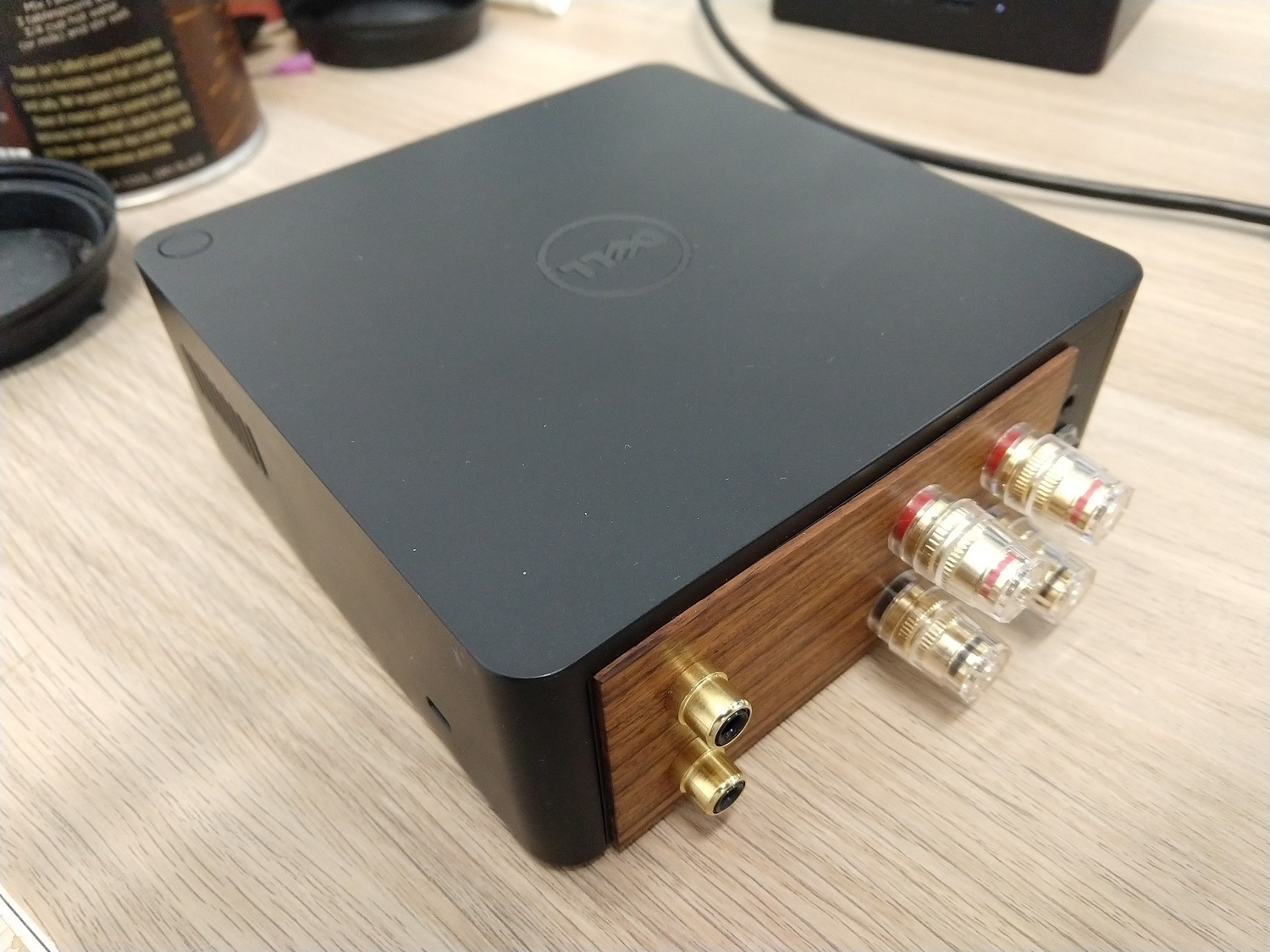

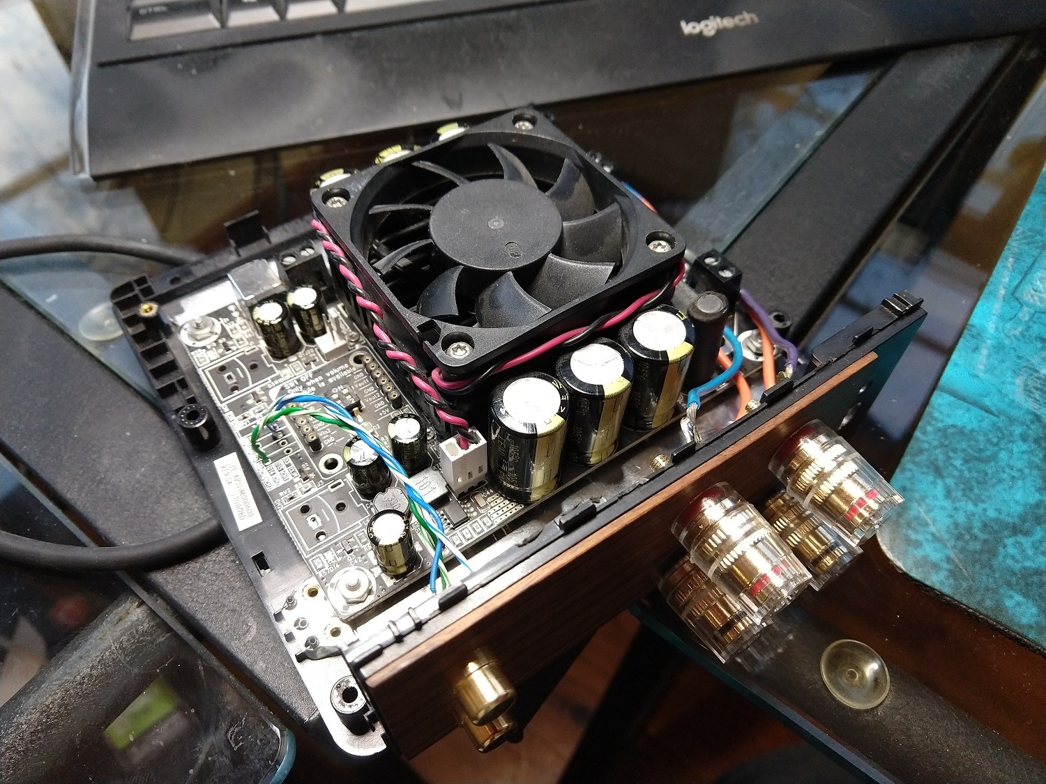

Here's the basic rundown....
Lots of dremel tool grinding of plastic bosses and heat stakes......these have a 3 layer steel base inside to give the docking unit some "ballast" while sitting on your desk..really wanted to keep that but needed the headroom for the fan.......
The rear video, USB, network etc ports are covered by the thin tiger rosewood piece on the back..I had that as scrap.
The front USB ports and LED are covered by the red laminate (formica) semi-circle that I cut using a router with a circle template. I'm thinking about using more red formica scraps on the back instead of the rosewood......but I've got a TPA3255EVM and meanwell PS on the way so who knows.
I used double-sided tape to adhere the red laminate to the front..and the switch holds it on as well.

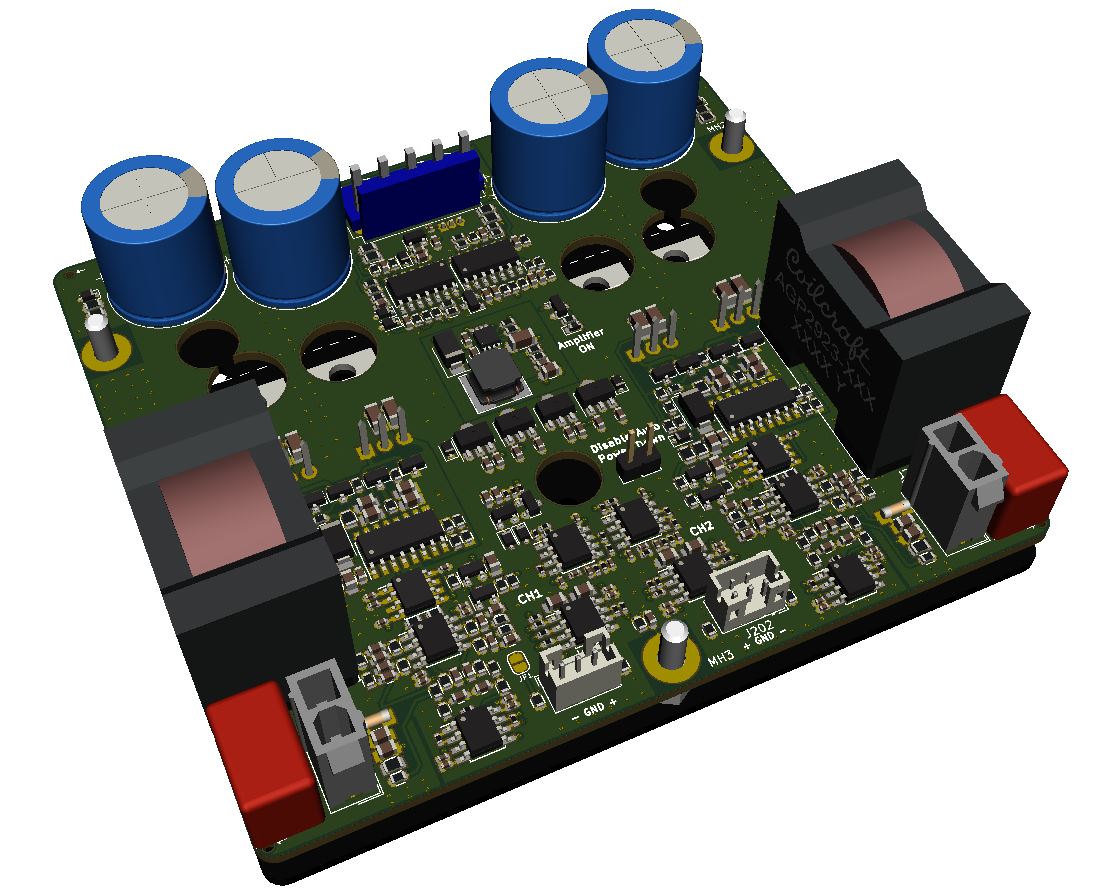

New DIY Class-D amplifier. Not a Chinese chip-amp, but all DIY.
Fully balanced input stage.
Power: 2x400watt @ 4ohm
Output current capability = 40A
Gain: 33dB
THD: approx 0.001%
Phase shift less than 1 degree at 20kHz
Fully differential modulator
Input impedance: Single ended = 10kohm and Balanced = 20kohm
Output impedanse: Less than 1milliohm
Output Noise: Less than 30uV
Protetion circuit contains
  • Fully differentiel DC-servo
  • Thermal protection
  • Short circuit protection (shut down @ 40A)
  • Under/over voltage (bus pumping) shut down
  • Auto Power down
Specs are fully comparable with the best on the market, like nCORE and Purifi, except for the totally flat phase curve. We have never seen any other class-D amp even close to this.

Looks nice, its good to see a DIY project instead of plug and play amps were the only "DIY" thing seems to be opamp rolling.
I'm playing with something similar it's an all discrete design, except for the DC servo.
All the best
Stein
All the best
Stein

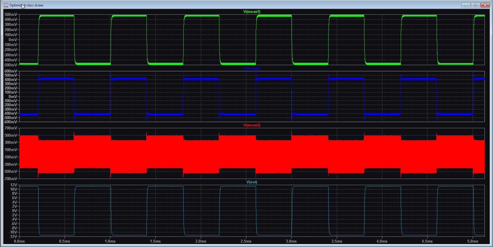

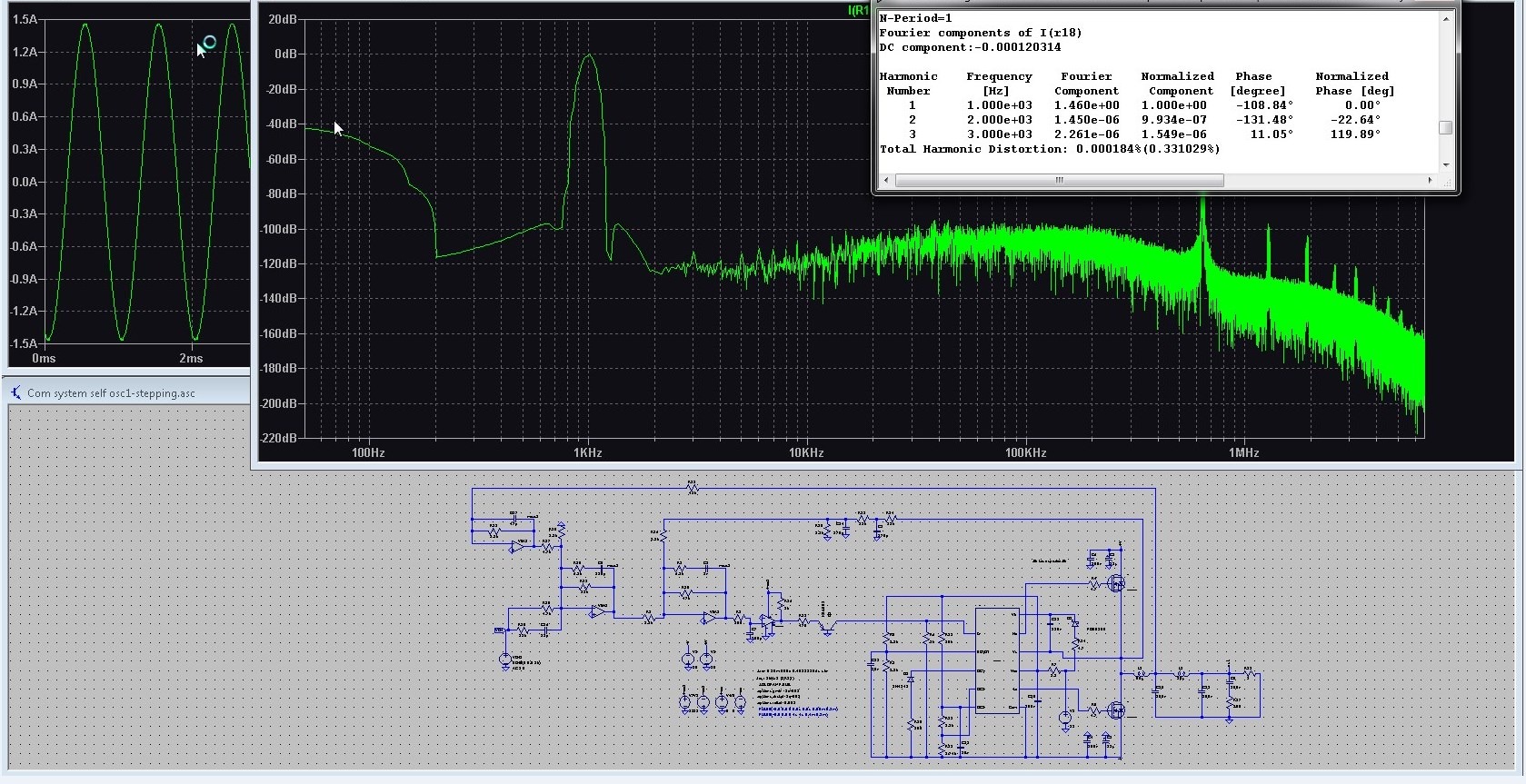

You say 0.001 distortion, with what power? because I do also work on c lass D, more from curiosity to learn some more about it. Did you use gan? I think not because of the big 40 amps output power. I have to say, you did a very good job making the pcb as it is. I see also much op amps, so I presume you did had the goal of a big gain to suppress distortions but do it then not get dull with sound.
Here I have simulate a version as a test, taking idea from papers on the internet. I did see when do this design, or others, is that getting a nice square, I sit quite on the right track, do I get a very low distortions like the other pic, the square get messed up, unstable, so there is a sweet spot in feedback systems class d.
I wish you luck with this beautifully looking amplifier, if it sounds as it looks, then in Dutch, zit je gebeiteld.
greetings.

We have not used GAL outputs, but traditional MOSFET, as it has not been necessary to obtain results.
In general, the output transistors have only a limited influence on the final result.
If you want to achieve good results, then it must be achieved in the design of the modulator and the feedback loop. You will see ex ICEPower, nCORE and Purifi, which without aggregation are the class-D amplifiers with the best performance. And there are simple designs, such as application note designs are limited.
We use a fully differential 5th order modulator, and a double feedback loop where one loop operates inside the other. Gain in the loop is mathematically optimized, to achieve the lowest possible distortion and no phase shift.
