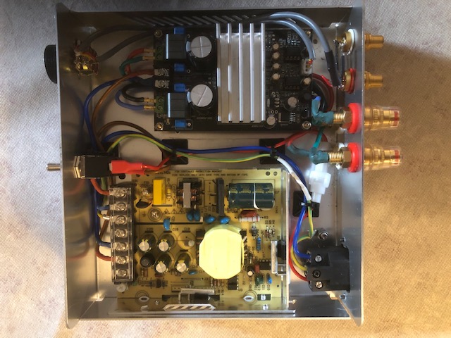

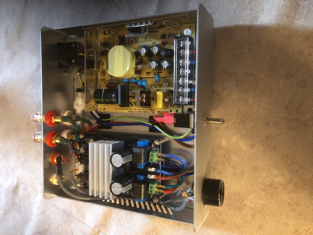

Haven't "sealed" everything down yet but the layout works and sounds great, terminals and rear panel all sorted. Love the box. Again, external brick so I can roll supplies (24v/2a sounds best so far). Will probably shorten and clean up wires on final fastening but no hums, hisses, or pops so if it ain't broke...

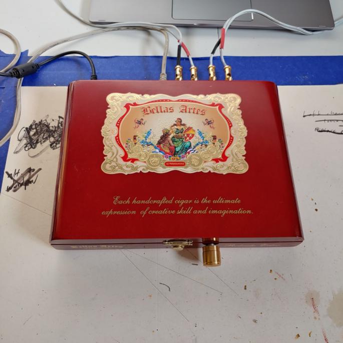

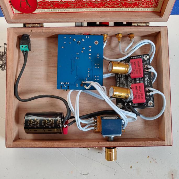

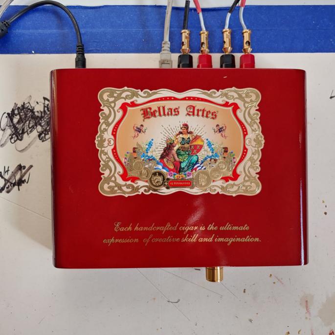

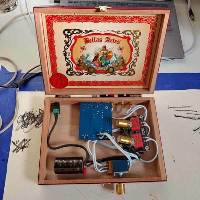

Guess this is the place to show off my TPA3110 experiments.

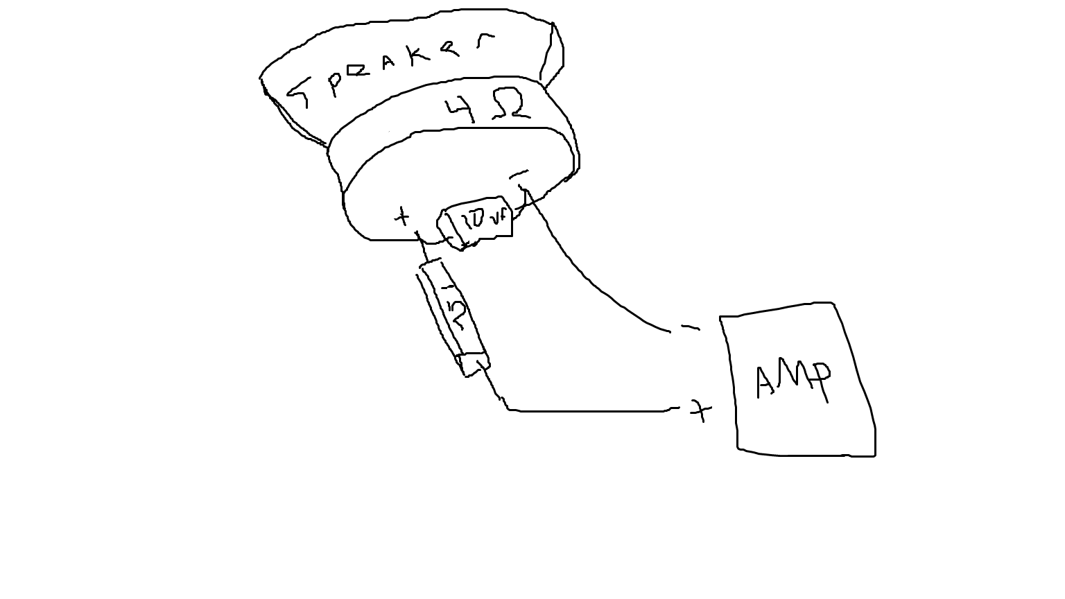

Here's a little Bluetooth Boombox. First pic is final cleaned up version. A laptop brick plugs into a jack mounted on the back. Speakers are 4ohm. Were super bright/tinny so used a 1R10ufC low pass wired at the terminals. Sounds really decent, high WAF.
A couple of questions, as I have similar speakers. Are they 3" or 4"?, 4 or 8 Ohm?
Can you confirm your filter values? 1K resistor and a 10 microfarad capacitor?
They are 4 ohm, amp plays much better with 4 IMHO. Speakers including the rubber surrounds are 4" wide, can't recall what they were listed at. An old Alibaba purchase.
Filter values are 1 Ohm resistor and 10 microFarad (uF) cap. I drew a crumby pic for you.

The speakers look the same as mine, Sonderlink, bought from AliExpress. I've used a number of them, 4" & 3", to convert old radios with BT and amps, but up till now have been able to build in ported boxes to great effect.
In my latest build, however, I can't build in ported boxes, so the speakers sound a bit bright as you stated.
I'll try a couple of LP filters using the info you've supplied to see how it changes the sound.

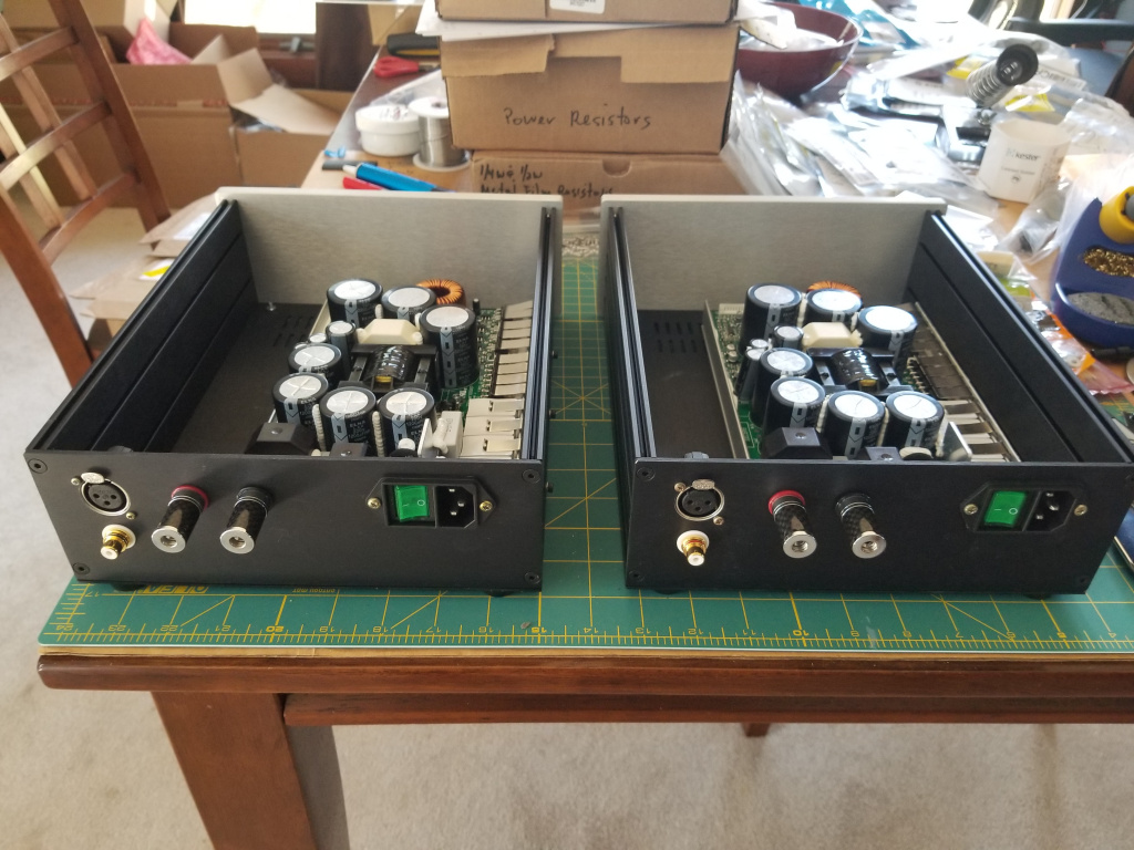

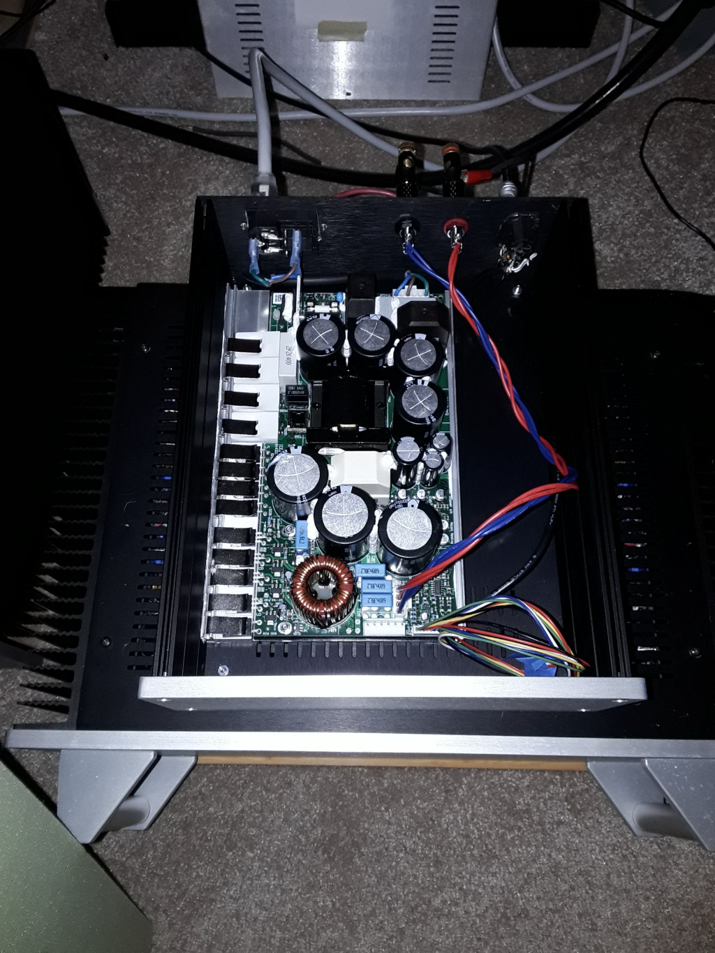

My first Class-D amp.
Monoblock IcePower 1000ASP.
Modual heat sink is attached to case extruded side panel.

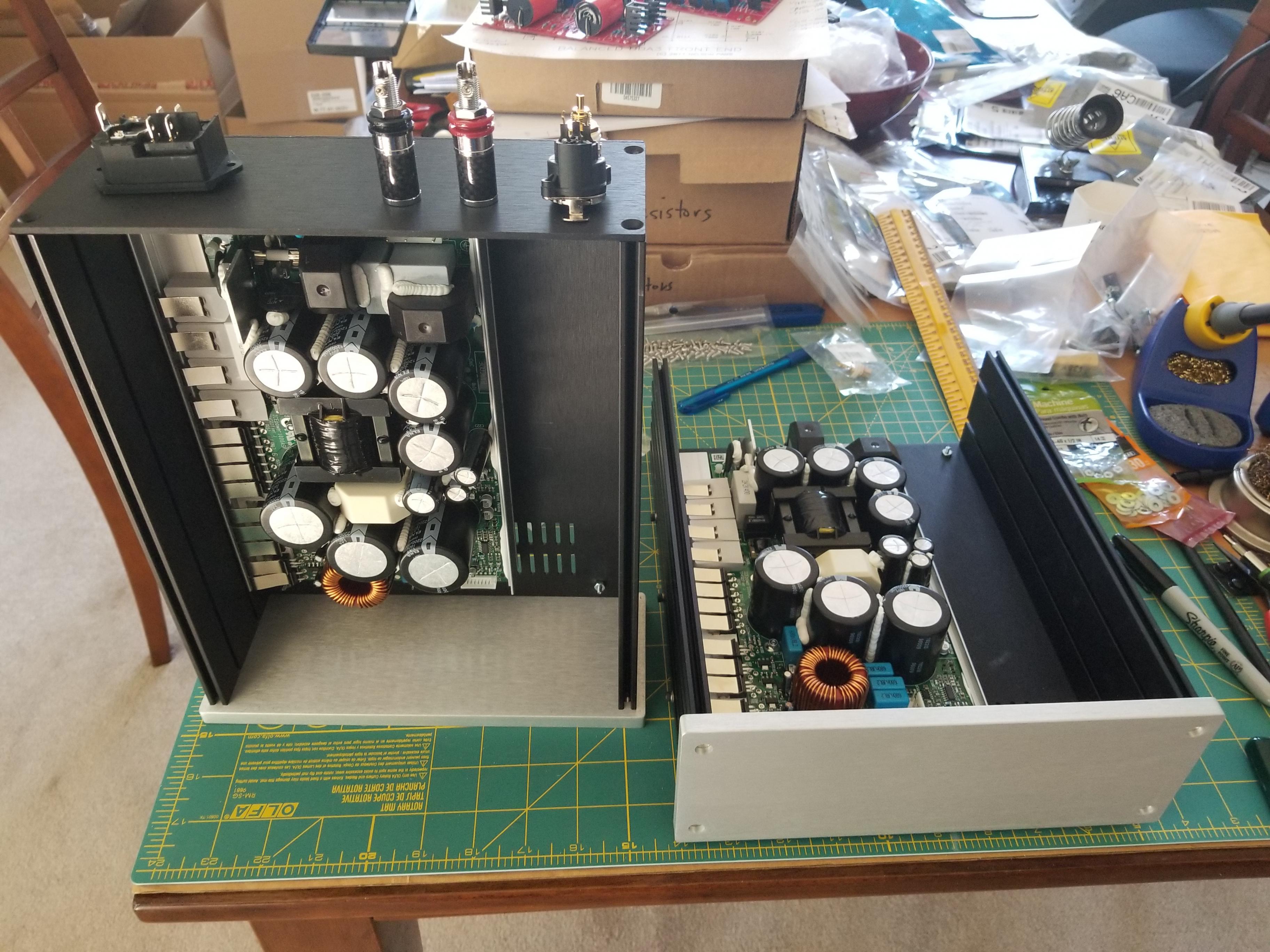

ICEpower 500A

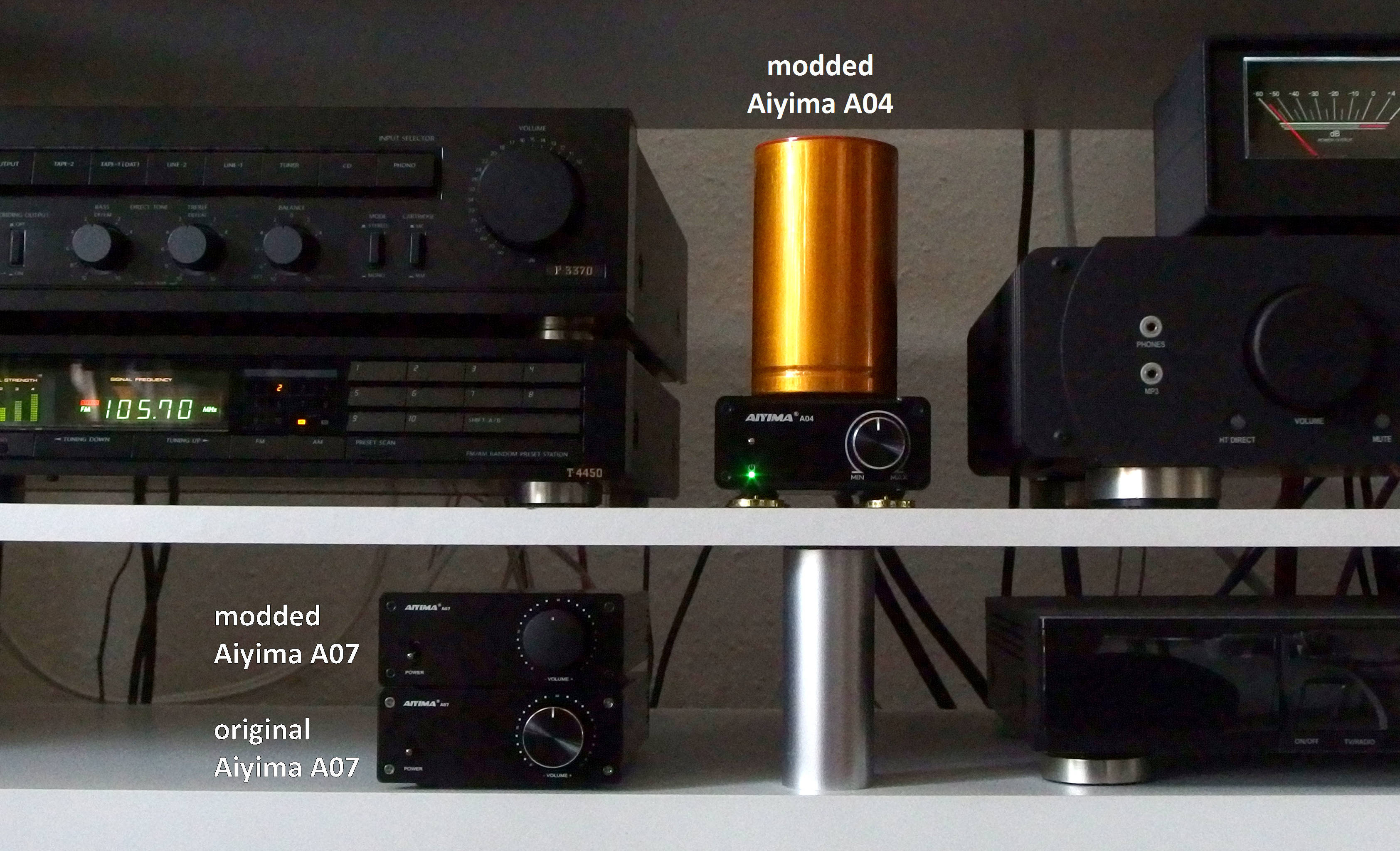

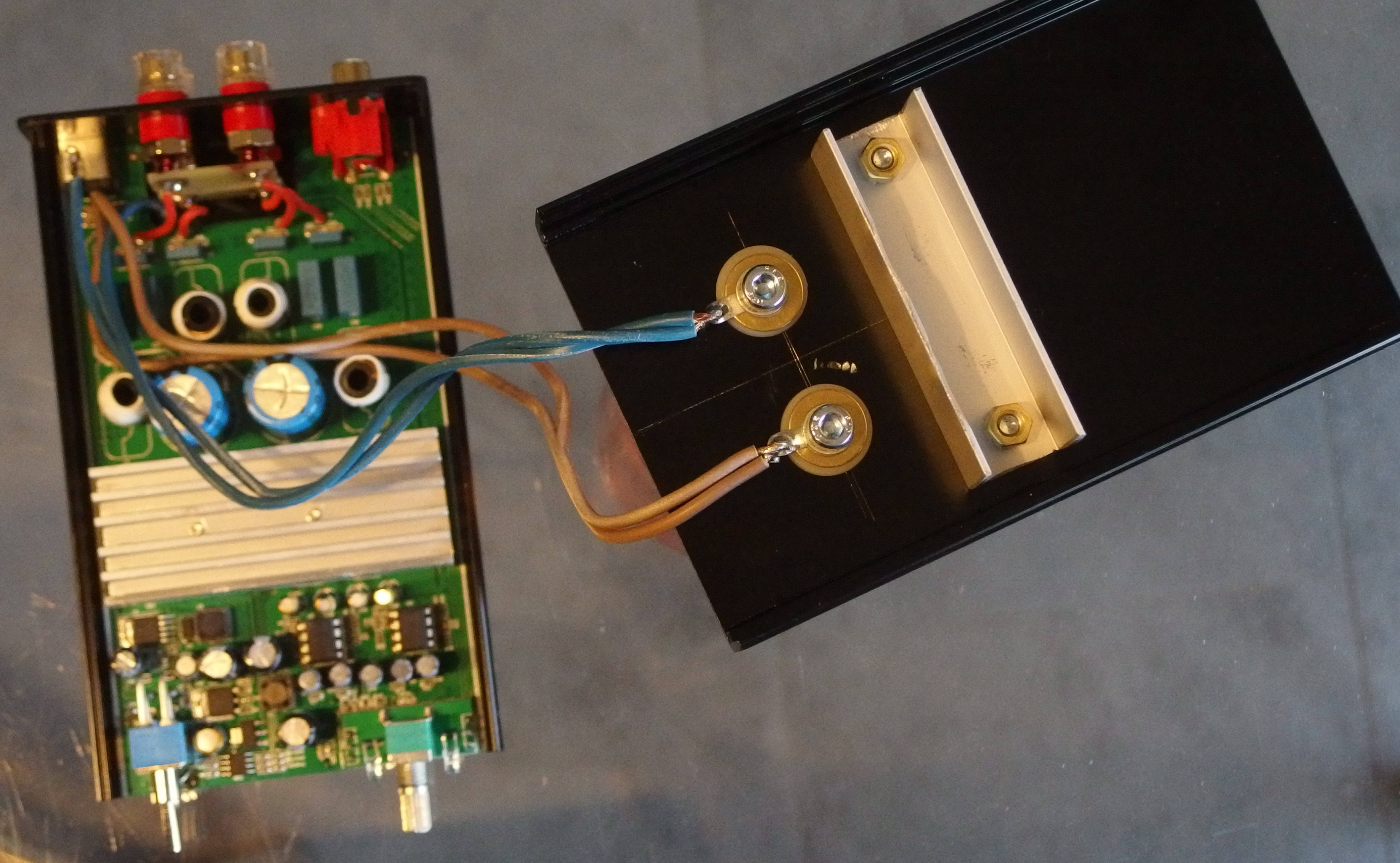

Modded Aiyima A04

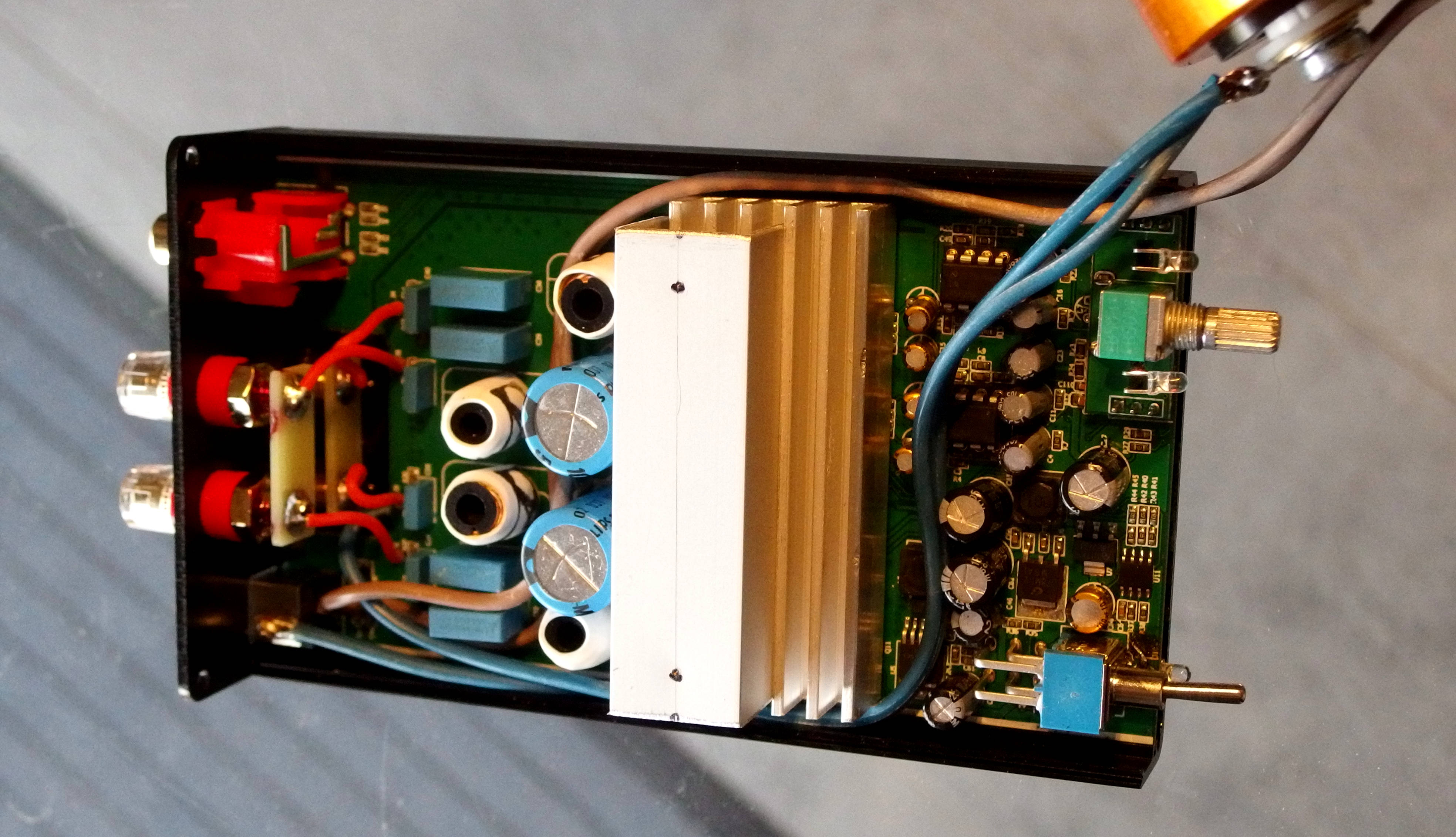

Added thermal connection of heat sink and aluminium enclosure using an aluminium u-profile and thermal compound (diy store, approx. 5 EUR) facilitating heat dissipation over the whole aluminium enclosure.

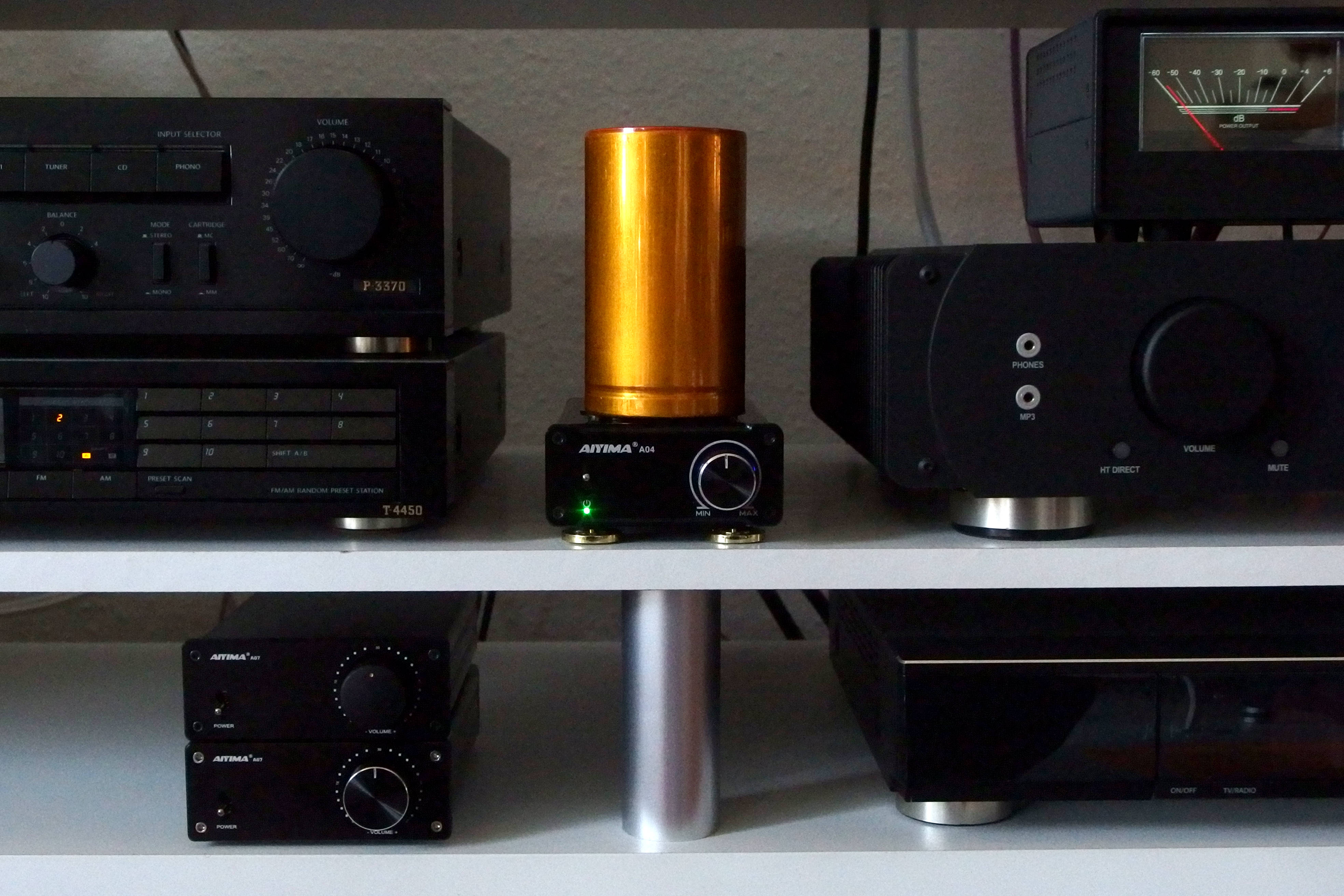

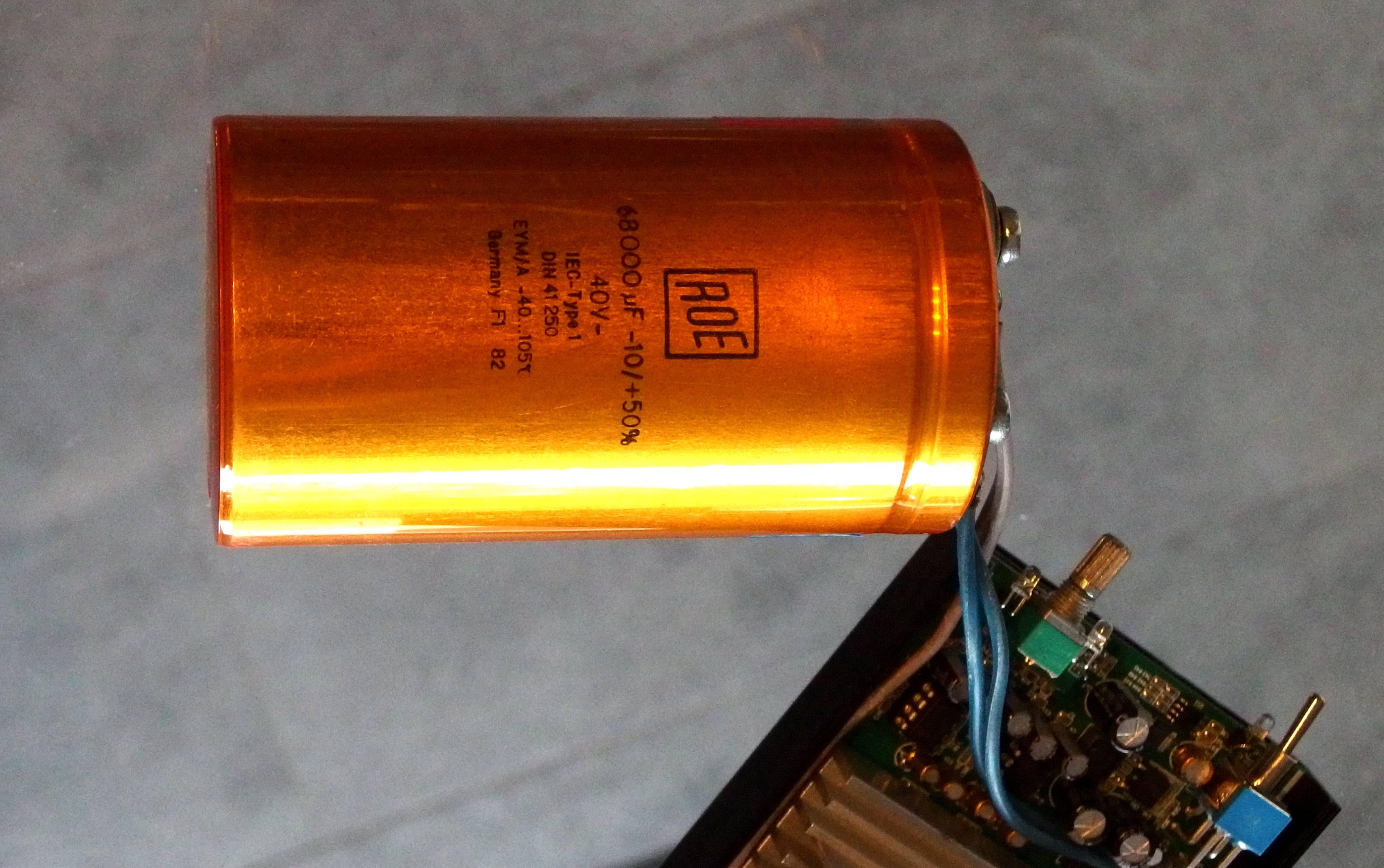

Added big internal(?, mostly external - see picture ;-) power buffer elcap Roederstein 68000µF, 40V (from my well-sorted experiments box, purchased from remaining stock, some 5 EUR).
Replace 35V power buffer elcaps by 50V types (from my well-sorted experiments box) in order to try this amp both with different "linear" and switching low noise 36V power supplies.
Replace 5532 opamps by 4562 opamps (reichelt.de, approx. 4 EUR). Unfortunately didn't succeed in purchasing OPA1656 incl. DIL8-adaption, although strongly recommended by Rob43.
Replace ferrite core inductors by air core inductors, so no ferrite saturation distortion. Choosed Italian made made stranded wire inductors, not solid core, in order to avoid skin effect. Aligned output low pass for 4Ohm speakers to 40kHz Butterworth (Q = 0.7, regarding the higher resistance of air core vs. ferrite). Was the most expensive upgrade (autocostruire.com, approx. 37 EUR), but seems to be worth the price.

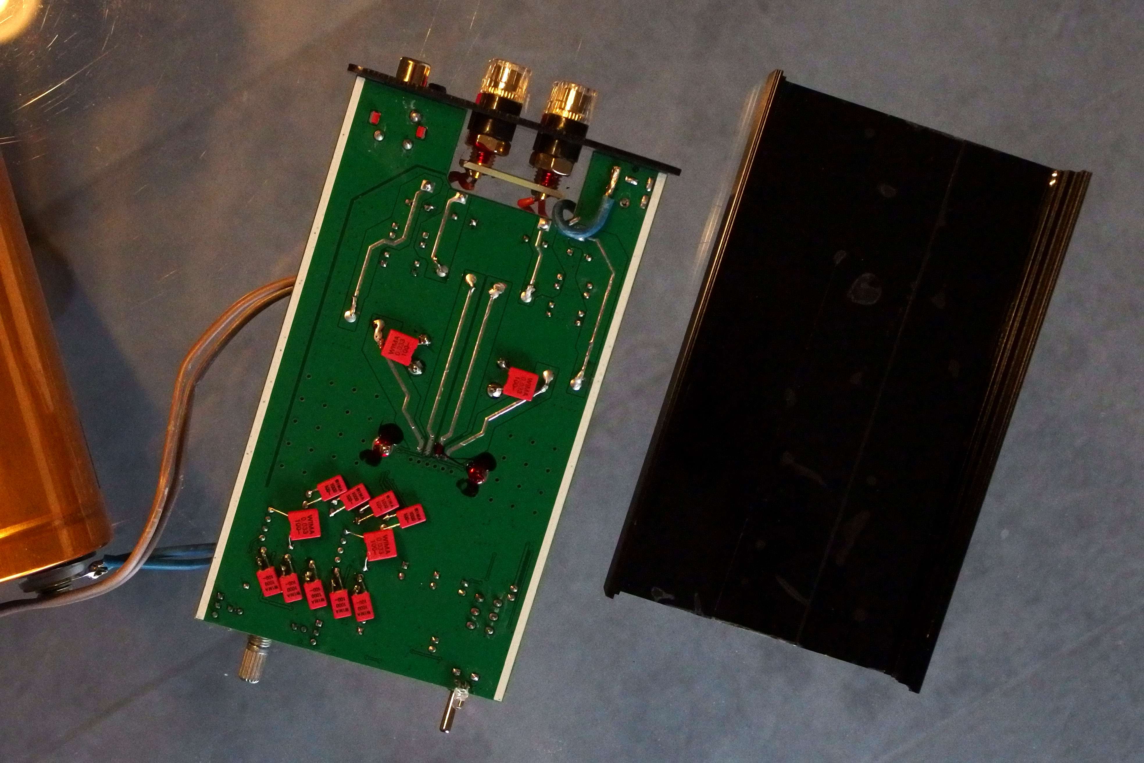

Bypassing of all power supply buffers and especially all audio signal elcaps by WIMA MKP/FKP Caps (MKP = polypropylene caps, FKP = polypropylene cap for advanced transient demands) (reichelt.de, approx. 3 EUR). The polypropylene caps used where the highest values available being geometrically small enough to be mounted under the printed circuit board - although these values do not meet the 1%-"rule of thumb" for bypass caps. Was advised not to use ceramic caps due to microphonic effects. Enclosure bottom tape-isolated to avoid short-circuiting.
Some minor replacements just for optical reasons: black screws instead of silver coloured screws of stainless steel fixing front panel, red power led changed to a green one, volume knob changed (optically still not satisfying).
A cordial "merci beaucoup" to daniboun to Lyon from Stuttgart. Your posts made me check A04 after first trials with A07! You were absolutely right!
(02) new OpAmps U-profile thermal connection to enclosure 1x43.jpg860 KB · Views: 418
Btw., question to community: Is there any knob available nice/similar looking such as new replaced knob of Aiyima A07 to be seen on picture (= knob Cliff FC7232/KMR-25), but diameter 23mm as needed for Aiyima A04?
lessons learned/open questions:
Weak link still seems to be the power plug/socket (max 2A). It would be better to choose a cord from power supply directly to big buffer elcap and from buffer further to board. In my mod I didn't succeed running all cables optimally in regard to the additional big power buffer elcap.
Must be careful in regard the stranded wire air core inductors (intended for approx. 100W), next time I would choose the 500W type also avialable (autocostruire.com, set approx. 49 EUR, so surcharge just some 12 EUR vs. a set of 100W types).
I wonder whether it's more worthwhile to use bypass caps for power supply of opamps not directly from + to -, but both from + to ground and from - to ground.
