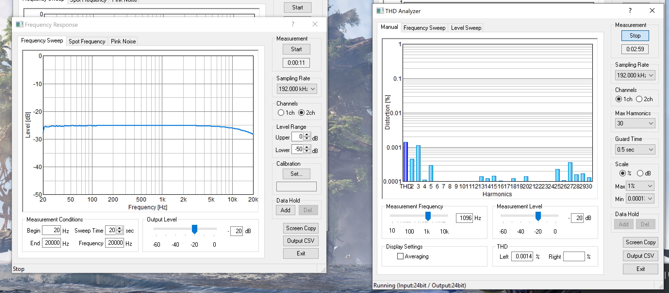

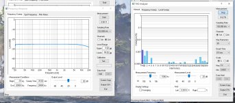

Another top end TPA3255 in my collection. )
Let me introduce you my brand new JLESTER TPA3255 (thanks again Jlester by the way).
5W 8Ω: 0.0006% THD
10W 8Ω: 0.0008% THD
5W 4Ω: 0.0012% THD
10W 4Ω: 0.0014% THD
Not bad)))
My amp 10W@4 ohm

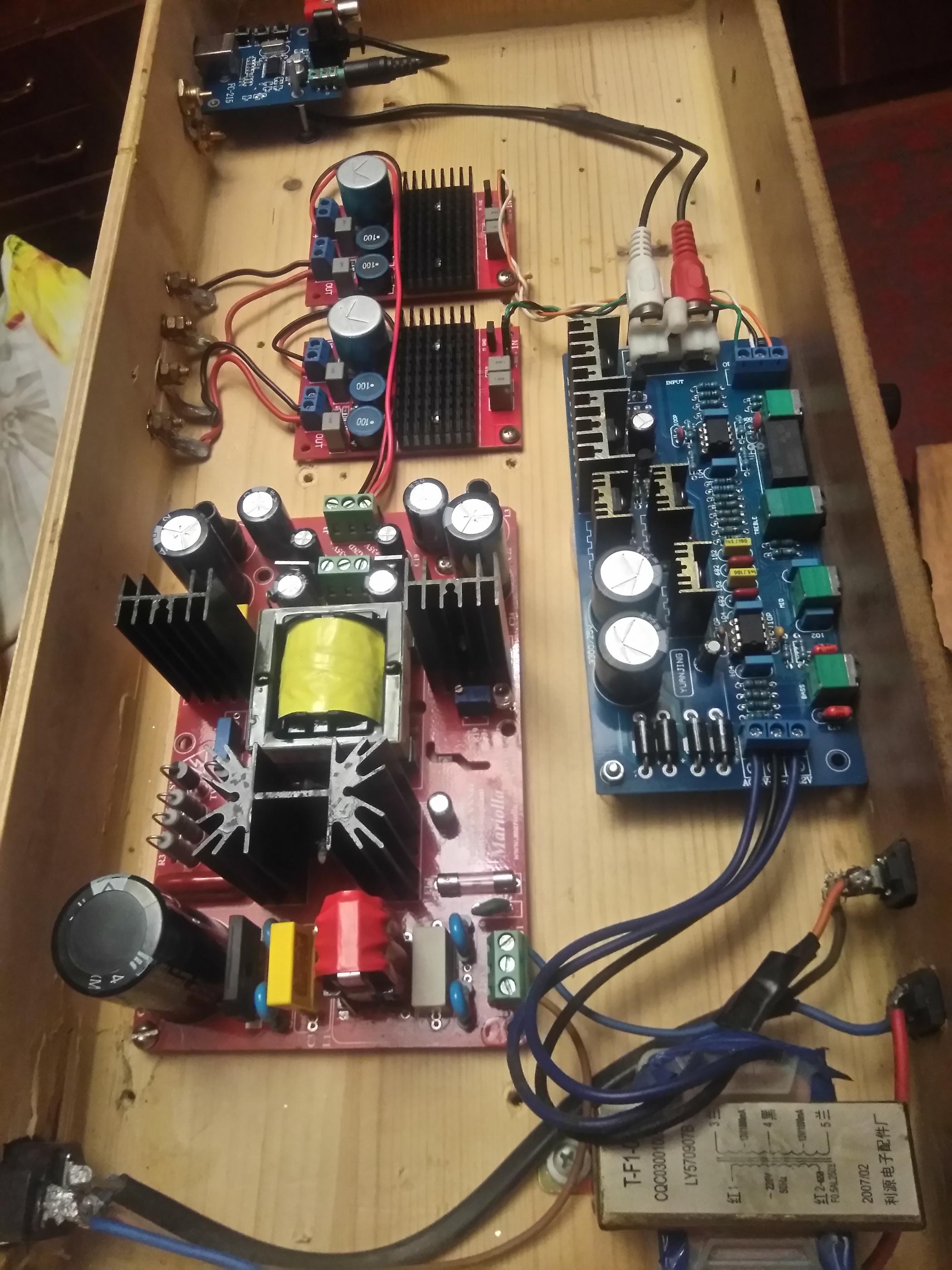

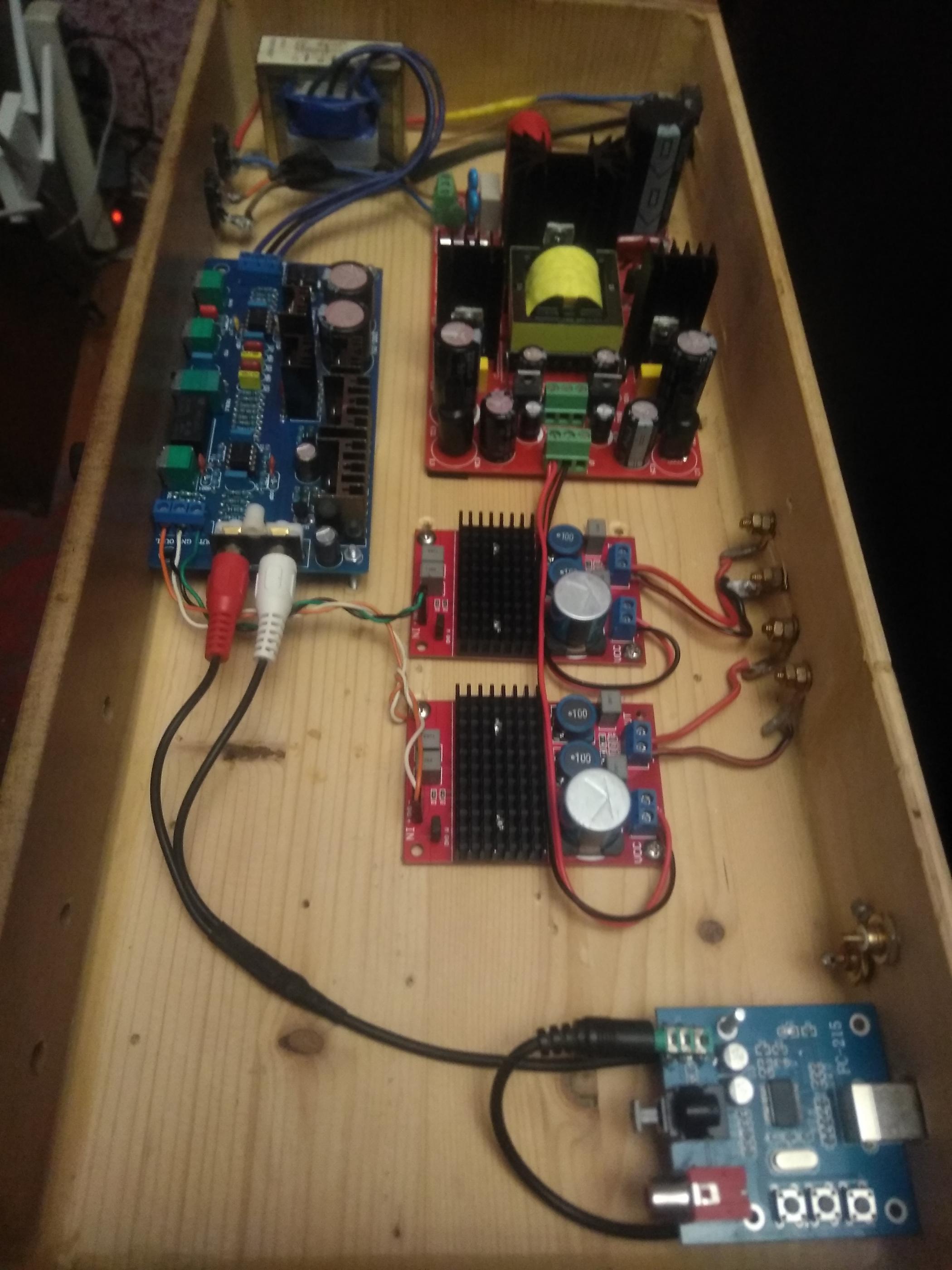

Ok, here is my baby - i realise it's not like i built the board from scratch, but still, as someone who never soldered a single wire or crimped a single connector before this project, I am pretty proud of my work 😉
y4mOosBHIti2gGvgBo0fmqZ97OdEl-zWuMIKOoT3k9yshWWbGb1HAPL5TIExxXxc-5uBVXGtSGXhzbRLm-mtuoi_pOsgjq4OJqruwWOLuJdgk-adgl8bqz9e-VuoeurH35Z6XC_asqgYXcK5qoQi1gNQ5jT0nKvXXaVrTdLD4cvZ6yUHArYE-8Um1i3UJKqk4F_
y4mLJuV_cqvzvYM1SWwbGqo5dssGIBzcmA59rYiWOnlppsaYvxUdNxuPNL6Z9qmj-Z5S9M8IXaHPKOmy9tb3n4u0E7KqeLqODIvtMo90tM1ZAxHxRYZnIHxJeNrh6yJwHOiBVYO2ePlcqOKVTEIhTH-BaDgt3v1Q3rRSrjY6H9sdtpvDeY4s3i3vyUHZ2flGrFz
It's a v1 version, ventilation obviously sucks, will be addressed by more holes top and bottom, and I'll add automatic input selector a bit later. With 24V power supply it's goes pretty loud ;-)

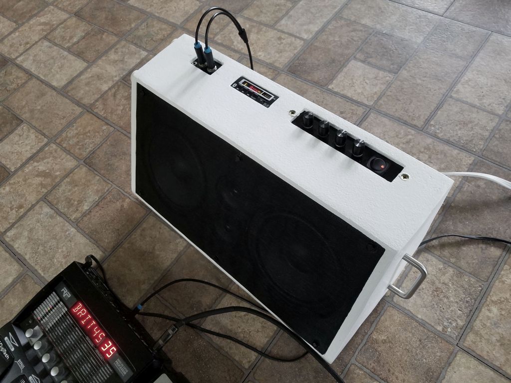

This is my first audio project, a stereo combo amplifier built using a TPA3116D2 board.
It has a bluetooth module with USB & SD card input, FM tuner, and 1/8" & 1/4" L+R Phono inputs. The amp has an EQ with Bass/Mid/Treble & Volume, and there's a speaker protection/delay board to get rid of power-on thump. It's powered by a 24V supply, with a stepdown converter to run the bluetooth module. The box is an open-back slant design built around 6 ohm speakers salvaged from an old Sony shelf system.
I'm really enjoying the flexibility of this little thing - it's a stereo guitar practice amp, a boombox, a radio, a media player, and bluetooth party speaker all in one.

5* as a guitar player that i am too i love it 😉
