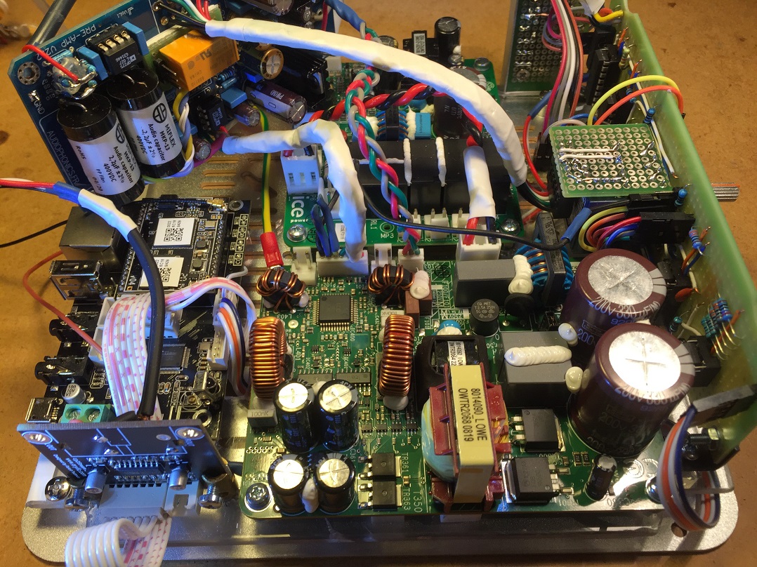

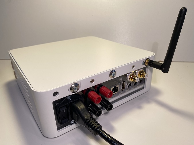

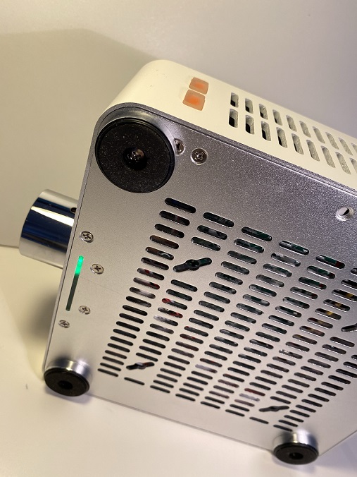

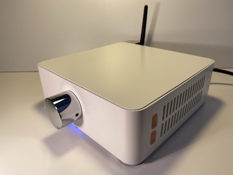

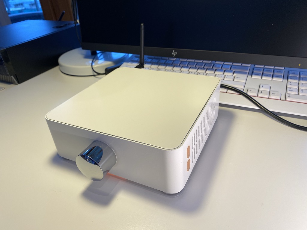

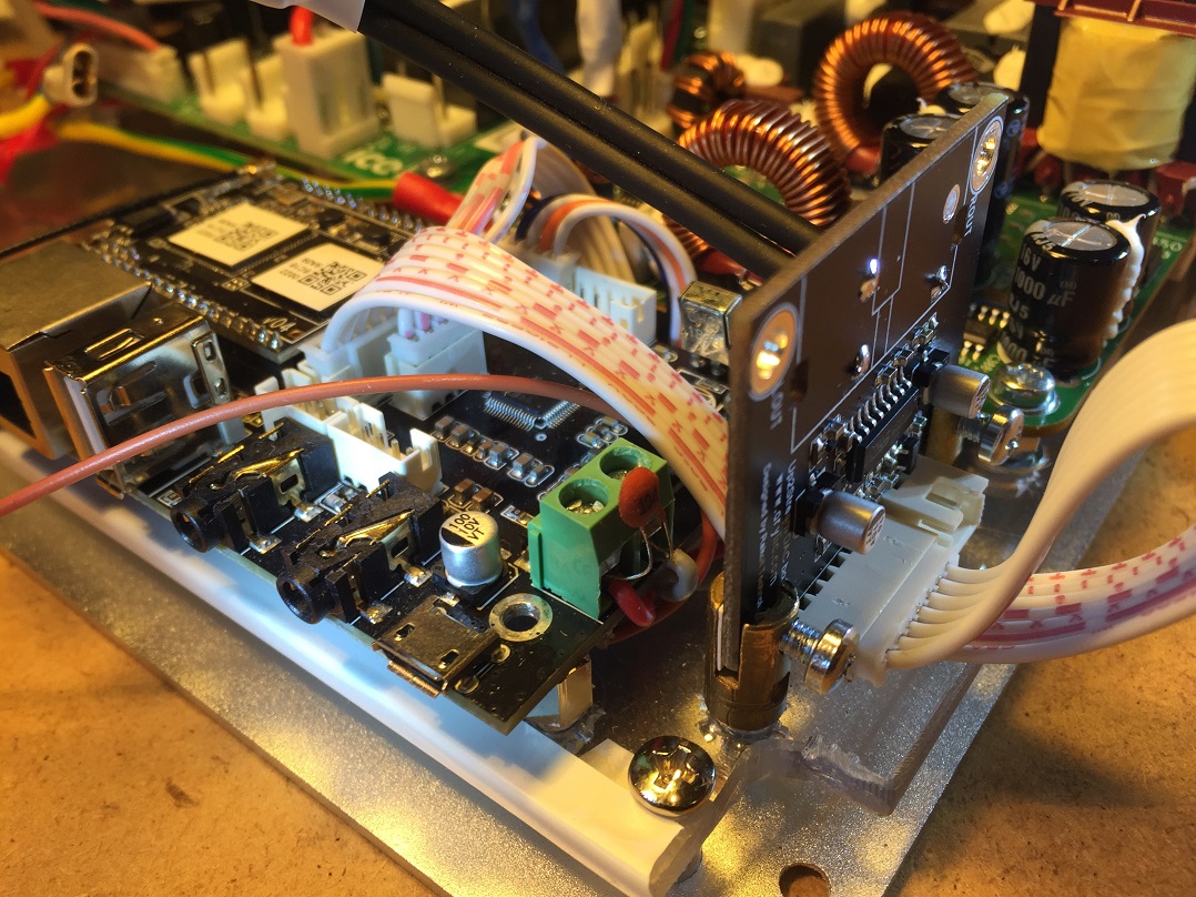

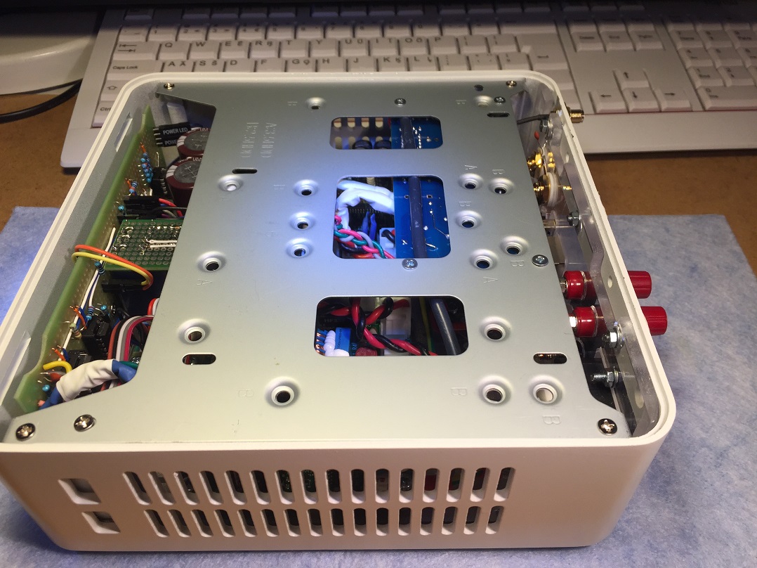

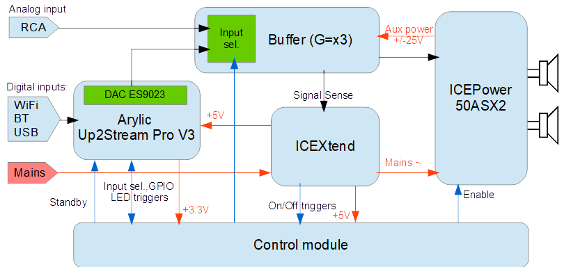

Hi there,
my first post on the forum with my first creature after some 20+ years away from diy. I got an urge to do something and thought why not start with something modular which felt like a low hanging fruit for a humble come-back. Little did I know... Anyhow, here it goes - a modular streamer amp integrating 5 modules:
* ICEPower 50ASX2;
* Arylic Up2Stream Pro V3 + Arylic DAC ES9023 (those handle the 3 digital inputs - WiFi, BlueTooth, USB); I chose Arylic for this role because of a their very decent App allowing to operate the amp from a smartphone;
* ICEXtend (its feature set was spot on for my application);
* Buffer module with gain x3, stepped attenuator, input selector relay (this module handles the input from the Arylic DAC and the analog input (RCA)). Although Arylic Up2Stream board can handle the analog input signal as well, I decided to feed the RCA inputs directly to the buffer bypassing the Arylic board to preserve signal quality;
* Control module which ties the above modules together. Although a simple one with just four logical gate/driver ICs but I am happy about the outcome since everything really works as one system.
I also added a simple block diagram.
I realised way too late in the process that I might have squeezed too much into the enclosure (20x20x6.5cm mini-PC) risking some performance impairments. Yet, the beginner's luck was on my side and no performance issues have come up to my great relief. Class D can obviously be more forgiving. Sure, I did spend quite a while studying the theory, application manuals, positioning of the modules and wiring for least interference etc. etc. as well as the immense number of posts of you guys here on the forum for which I am really grateful!
And now on to the next project!

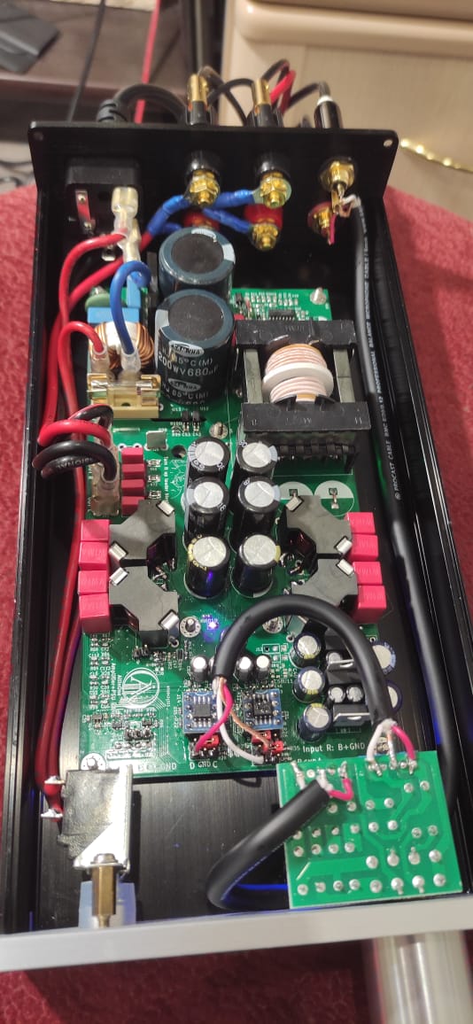

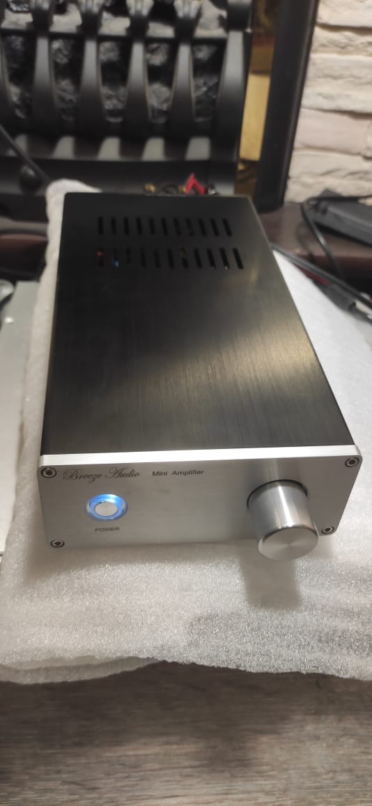

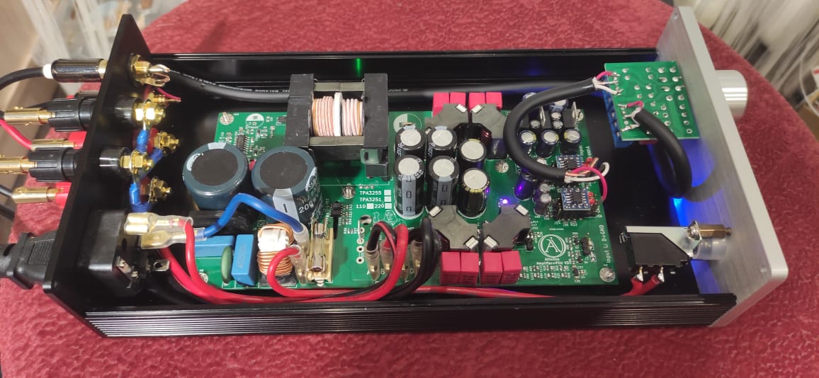

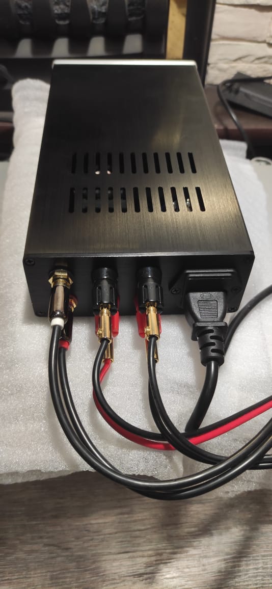

Hi amigos,
Just finished my new Shui Yuan TPA3255 Amplifier. Sounds very very well )
Some pictures so you can compare with my updated Aiyima A04
As per reminder, what I did :
Stock version
A small 110*70*35MM TPA3255 module with :
SAGAMI 7W14A inductors
Full Nichicon caps, as below :
Nichicon 2200UF/63V VZ serie power caps
Nichicon FW serie Buffer caps (Audio Grade)
DIP8 OP amps socket
My minor Updates :
For TPA3255 module : Remove 2X Nichicon VZ serie 2200UF/63V > Install 2X Nichicon 4700UF KW serie (low ESR Audio grade)
For LLC SMPS PSU : Remove Output Caps 2X Nichicon PM serie 50V/1800UF > Install 2X Nichicon 2200UF KW serie
OP amps : Remove NES5532 Op amps > Install OPA1656
Full Setup:
Updated TPA3255 Module with full Nichicon Audio Grade caps (110*70*35MM)
SMPS LLC 600W 48V PSU small factor Nichicon caps (113mm * 67mm * 56mm)
Aiyima A50 AC DC Filter (anti RMI/RFI) board
Full Copper twisted wires
Full Aluminium black case BRZHIFI (131*249*55mm.)
Premium Banana plugs
Pictures :

Hi Dr Mordor.
Looks very nice, Just a question - Is the case earthed and is this shared with the signal earth ?
Many thanks. James.
NOJust a question - Is the case earthed and is this shared with the signal earth ?
Nerone's amp, TPA3255
Looks really good ...
Compliments Vitaly ...😉
Thanks Vitaly, nice to see it assembled in the case, I can't wait to hear it
