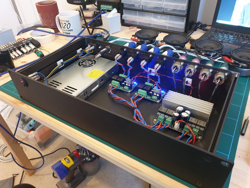

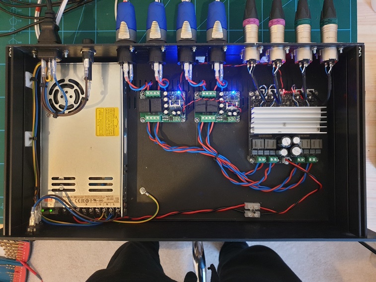

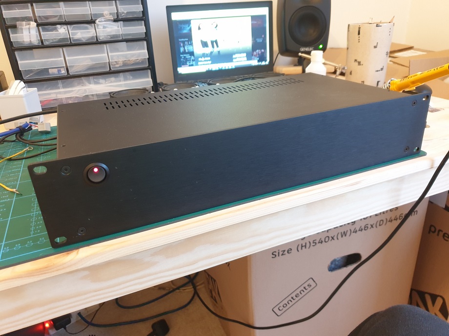

- 3E TPA3251 4x100w Board
- Hifi2000 Rack Chassis
- Mean Well LRS-350-36 PSU
- Neutrik Speakon and XLR
Rather industriual looking to some of the other creations here but that's what I wanted 🙂
Does anyone have any experience in modding this TPA3251 board? I have already bypassed the op-amps.

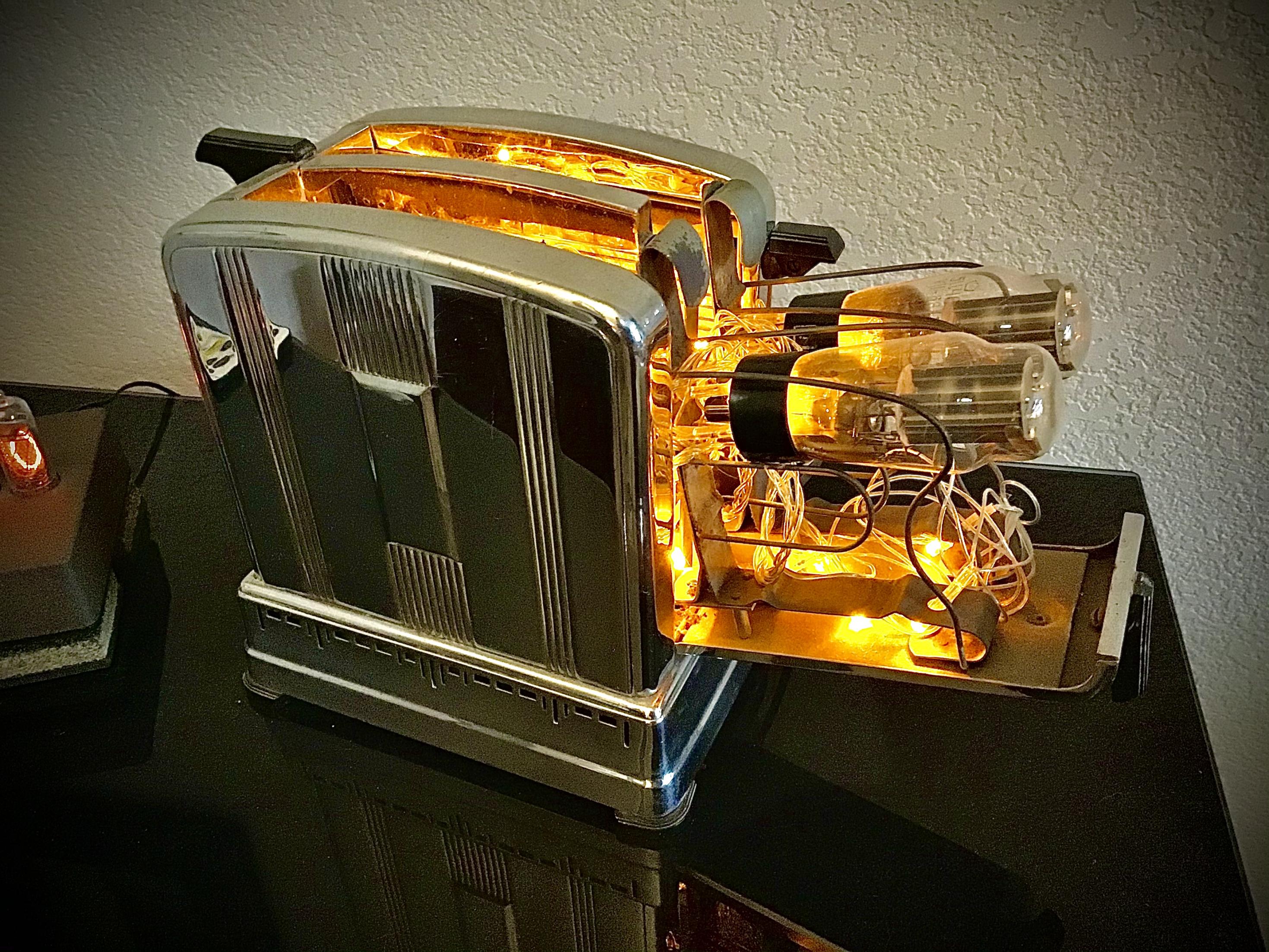

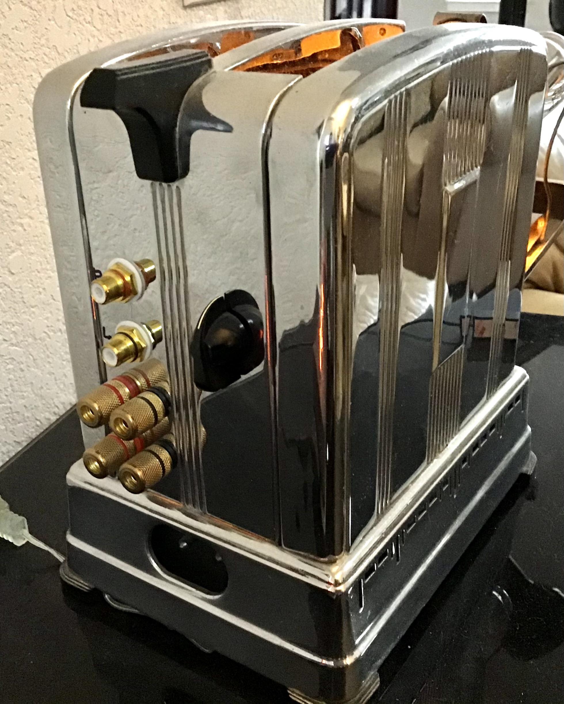

Toasty TPA3116D application
Fun with an antique toaster - Using a 19vdc laptop power supply to yield ~35wpc, sounds quite nice (note that the tubes are props)... Have constructed several similar steampunky creations from this particular TI-clone board - Have since moved on to a few Pass-clone Class-A implementations.
Cheers!

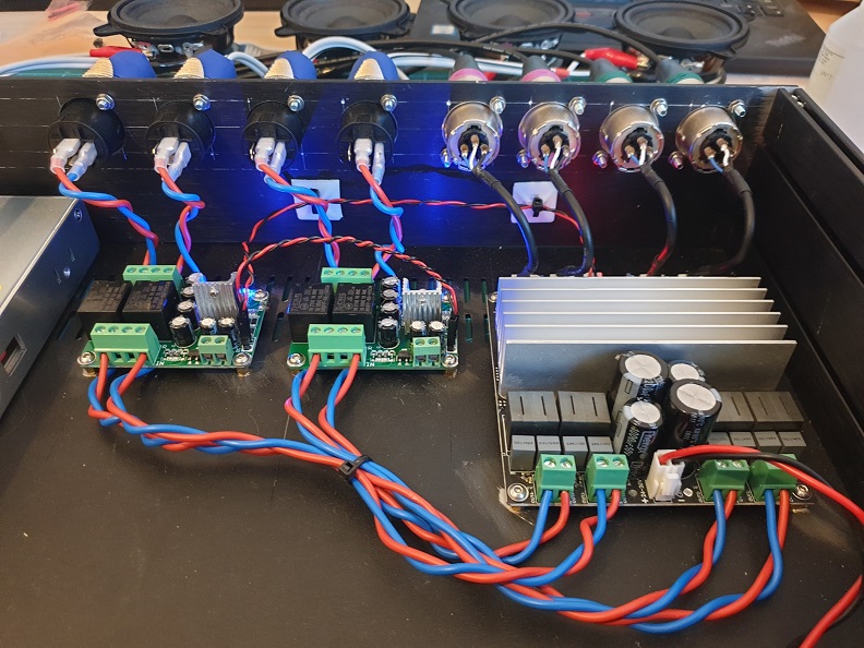

Just wondered why you needed the speaker protection boards with this amplifier as I thought pop suppression was already built in to the amplifier board ?
I also note that one side of the speaker protection is bypassed as all these boards seem to assume a common earth for both speakers !!
BushellJ, well, in short, I'd rather have them than not. The ON noise isn't a pop but still a click which puts the willies up me. Also, I have fried a handful of voicecoils owing to various things including class-d board malfunction.
What really concerned me was the aforementioned DC getting to speaker. These TPA chips don't like load on one half of the chip/circuit and not the other and although I am as careful as can be who knows? I may forget to connect one side, pump up the jam reconnect and then there's DC all over my face.
The boards are wired and modified as per manufacturers instructions for BTL boards. It requires removing two resistors.
BushellJ, well, in short, I'd rather have them than not. The ON noise isn't a pop but still a click which puts the willies up me. Also, I have fried a handful of voicecoils owing to various things including class-d board malfunction..
Weird... I will have shared the opinion of BushellJ because I have the same 3E board that I mounted with a linear power supply and I have no problem with when switching ON / OFF, neither pop nor a "click" )
If you're happy with your setup, that's the main thing after all)🙂

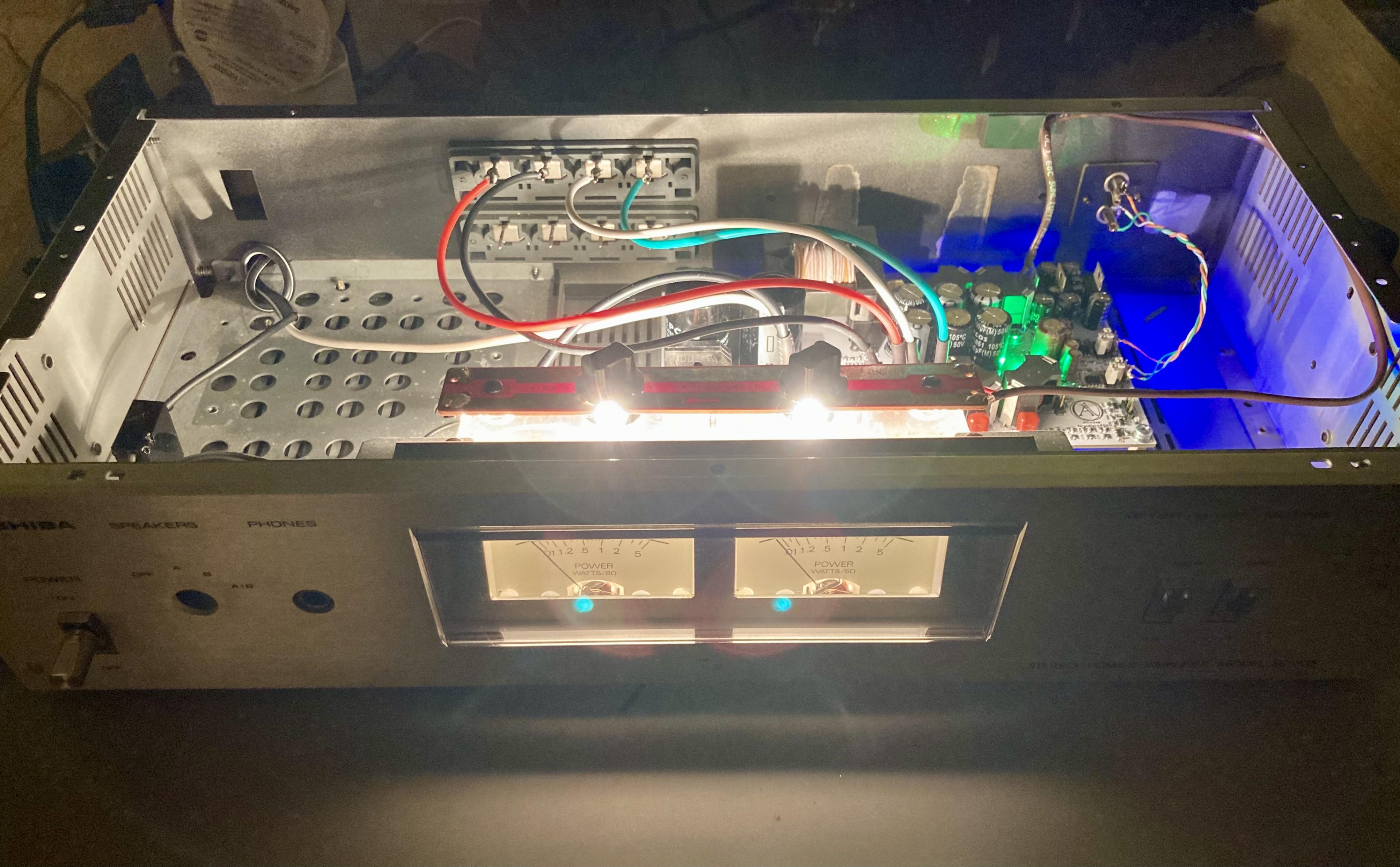

Happy New Year Amp!
Over the weekend I gutted the chassis of a Toshiba SC-335 and put in an All-in-One TPA3255 with integrated SMPS from drMordor.
The meters are not yet connected, but the lamps are nice and bright.
It sounds absolutely fantastic, likely the best amplifier I’ve ever had in my system.
Thanks again to drMordor for a great amp and help with getting it running smoothly. I am very pleased with this project.

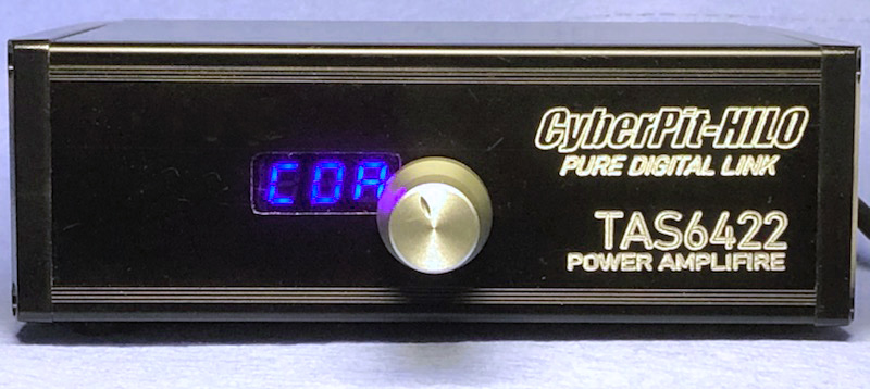

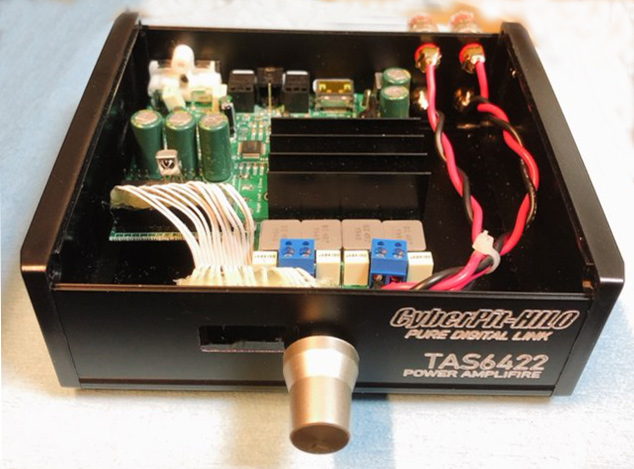

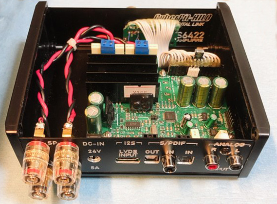

TAS6422 2.1MHz PWM Amp Casing
Hi Folks!

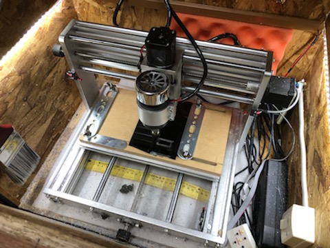

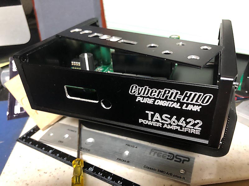

I put my TAS6422 2.1MHz Class-D Amplifier board into Takachi KC5-13-15BB enclosure.
Drilling and Text lettering were CNC 3018 pro MAX milling.
Plexiglass windows is also CNC milling cut.
This is my first CNC DIY...😉
CyberPit
Hi Folks!
CyberPit
Nice job CyperPit 🙂
... and just browsed the project itself ... wooow cool stuff
Happy New Year Amp!
Cute! Make sure you earth the chassis!

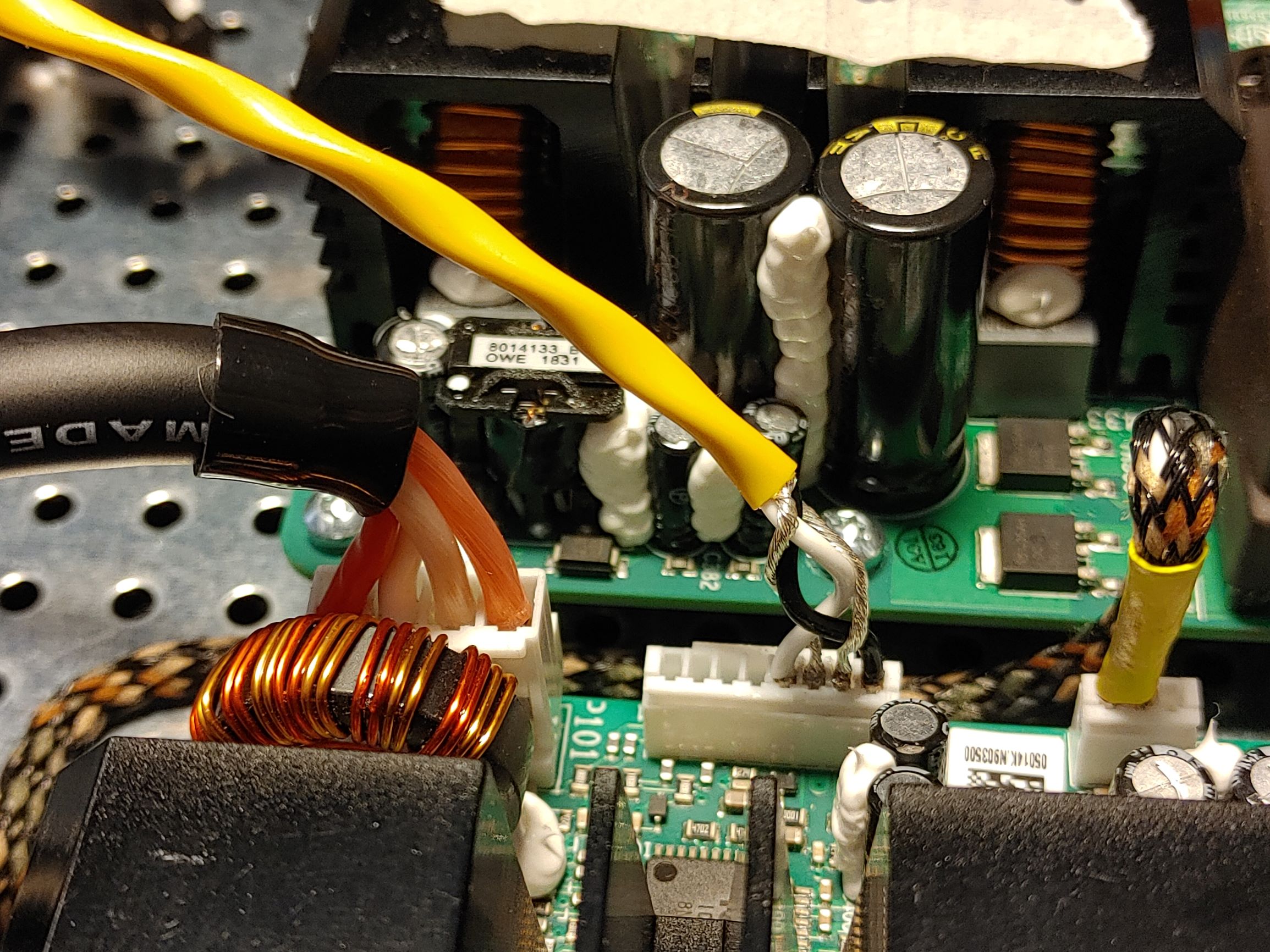

Let me introduce you my brand new JLESTER TPA3255 (thanks again Jlester by the way).
I will review it soon so I can compare it to my DrMordor TPA3255.
I can already say you, that this module is very promising at first listening )
Spec :
Jlester TPA3255 module
PFFB : Yes
OPA 1656
Coilcraft inductors (flat wires)
Samsung FC power caps 4x 1800uf
SMPS LLC PSU 44V (350W / 600W peak)
EMI / RFI Filter
Nichicon UES buffer caps
Alu case / twisted cooper cables
5W 8Ω: 0.0006% THD
10W 8Ω: 0.0008% THD
5W 4Ω: 0.0012% THD
10W 4Ω: 0.0014% THD

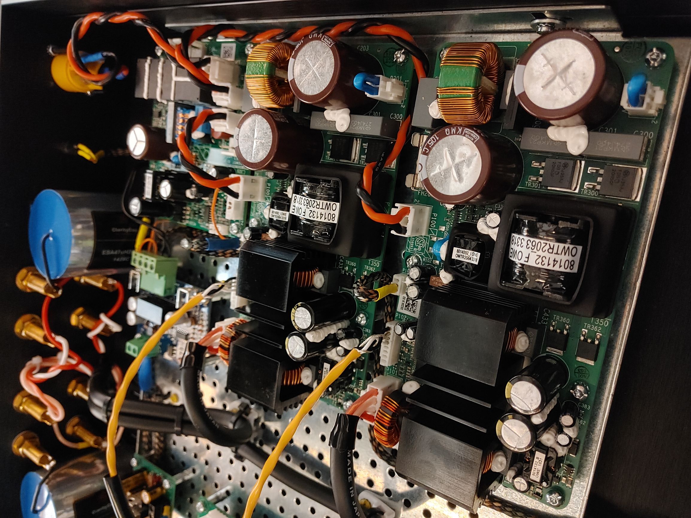

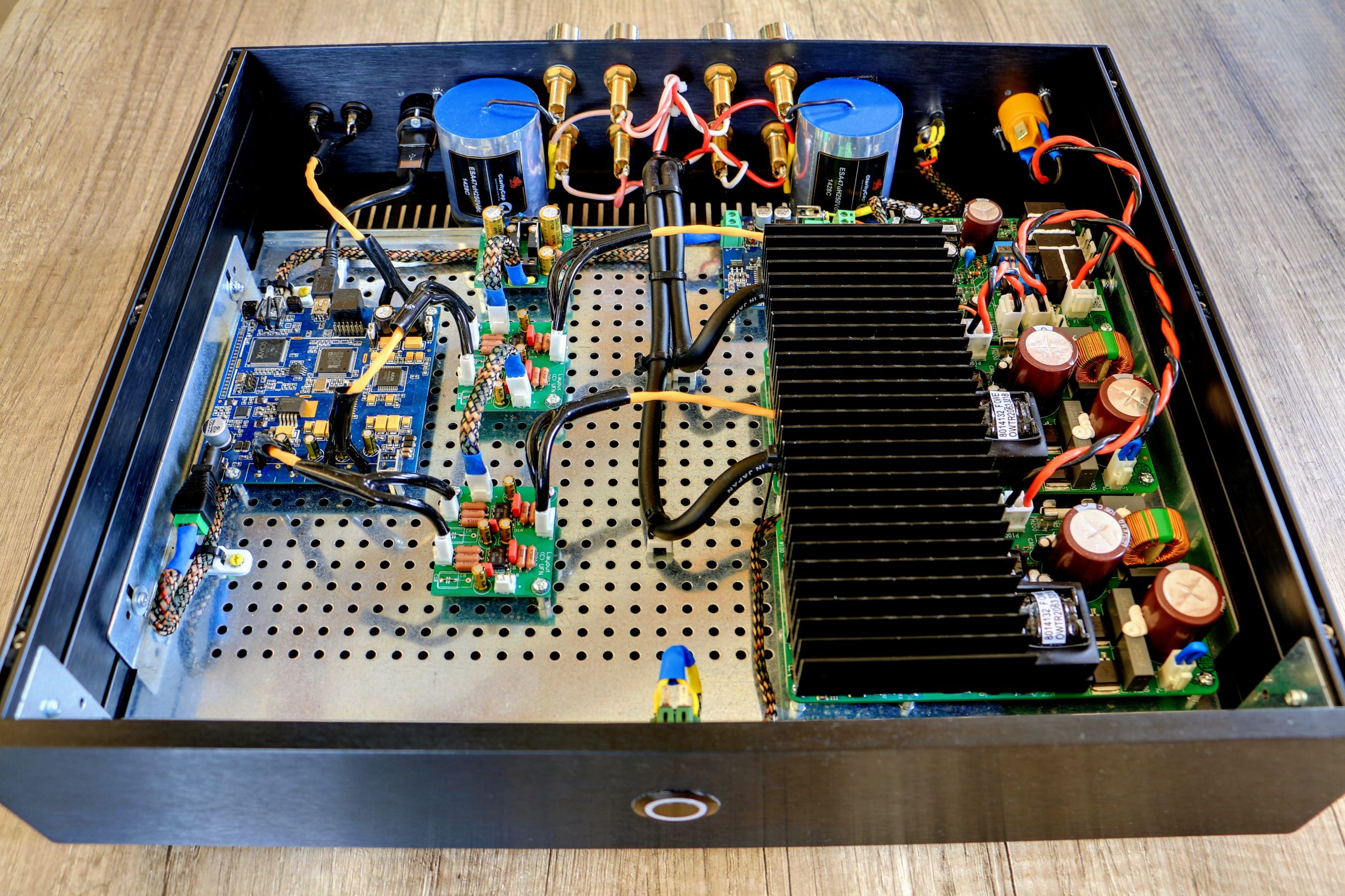

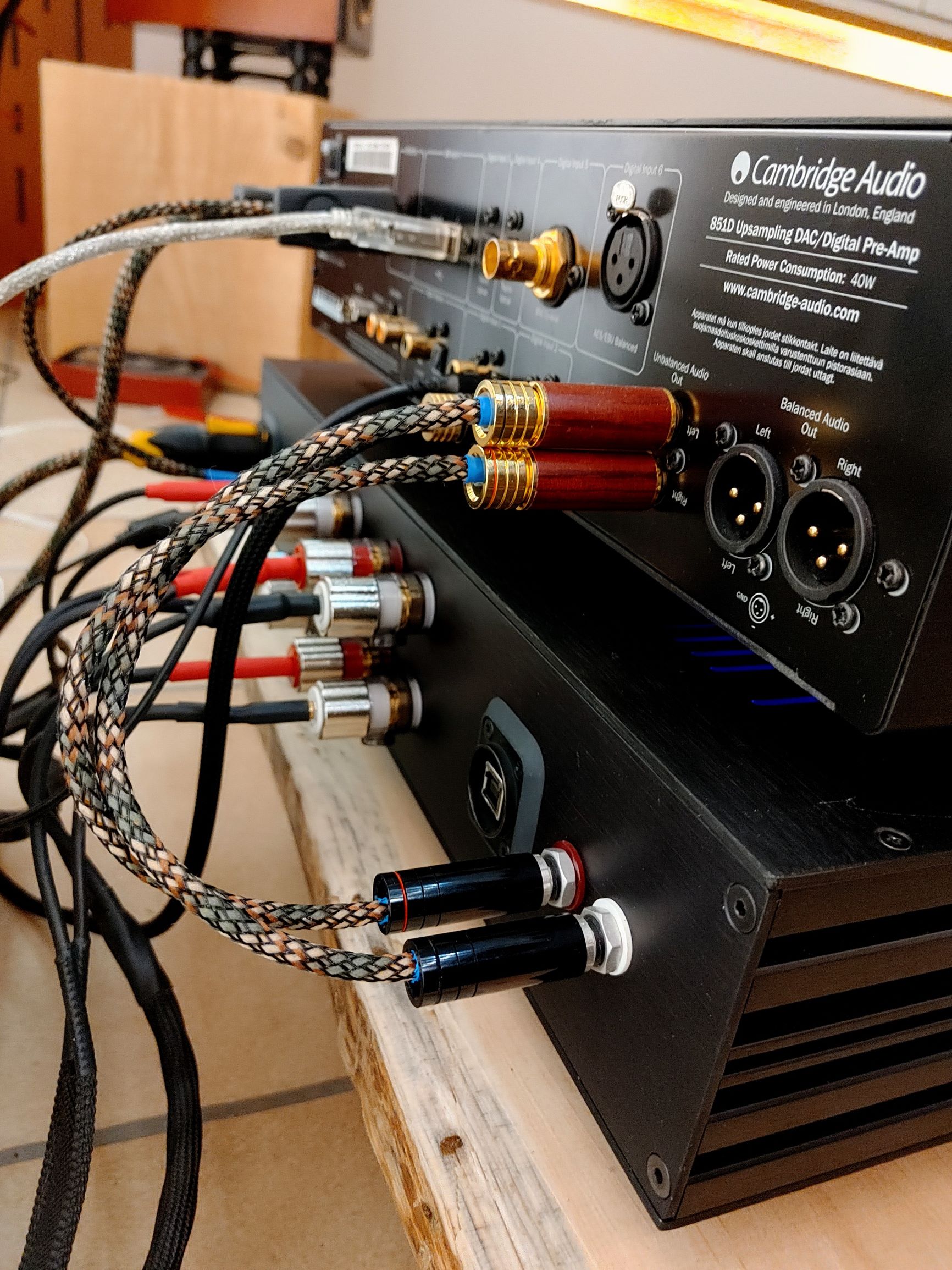

ICEPower 125ASX2 + input buffer

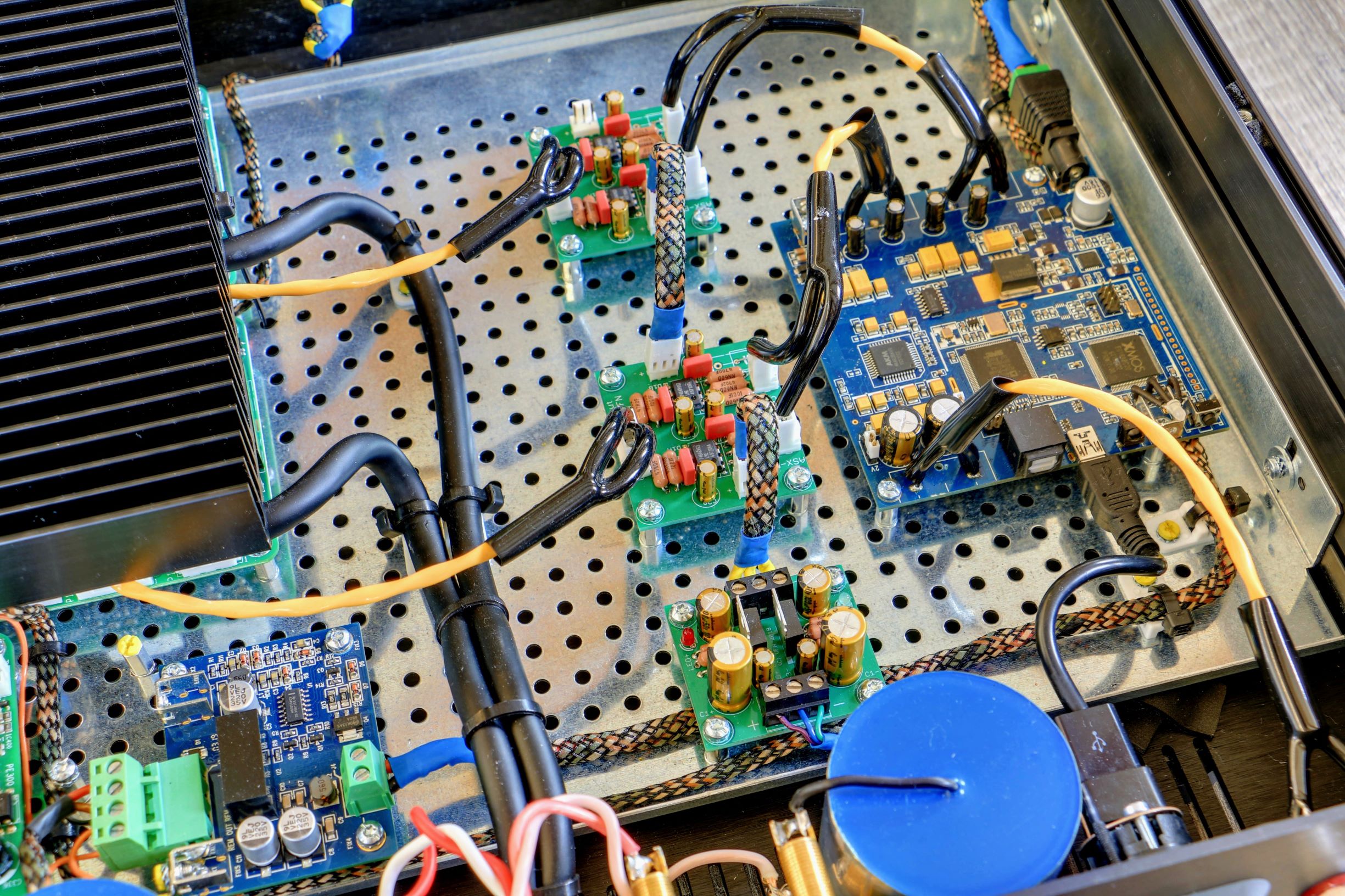

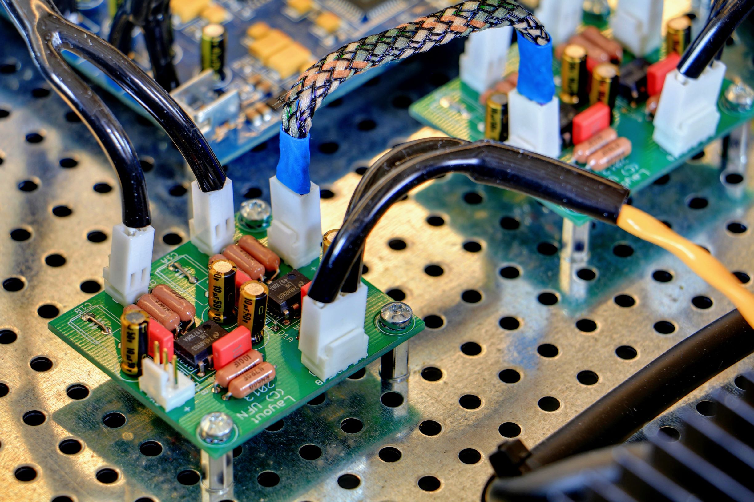

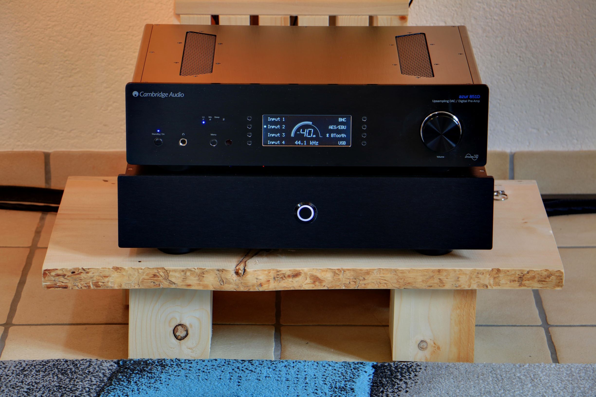

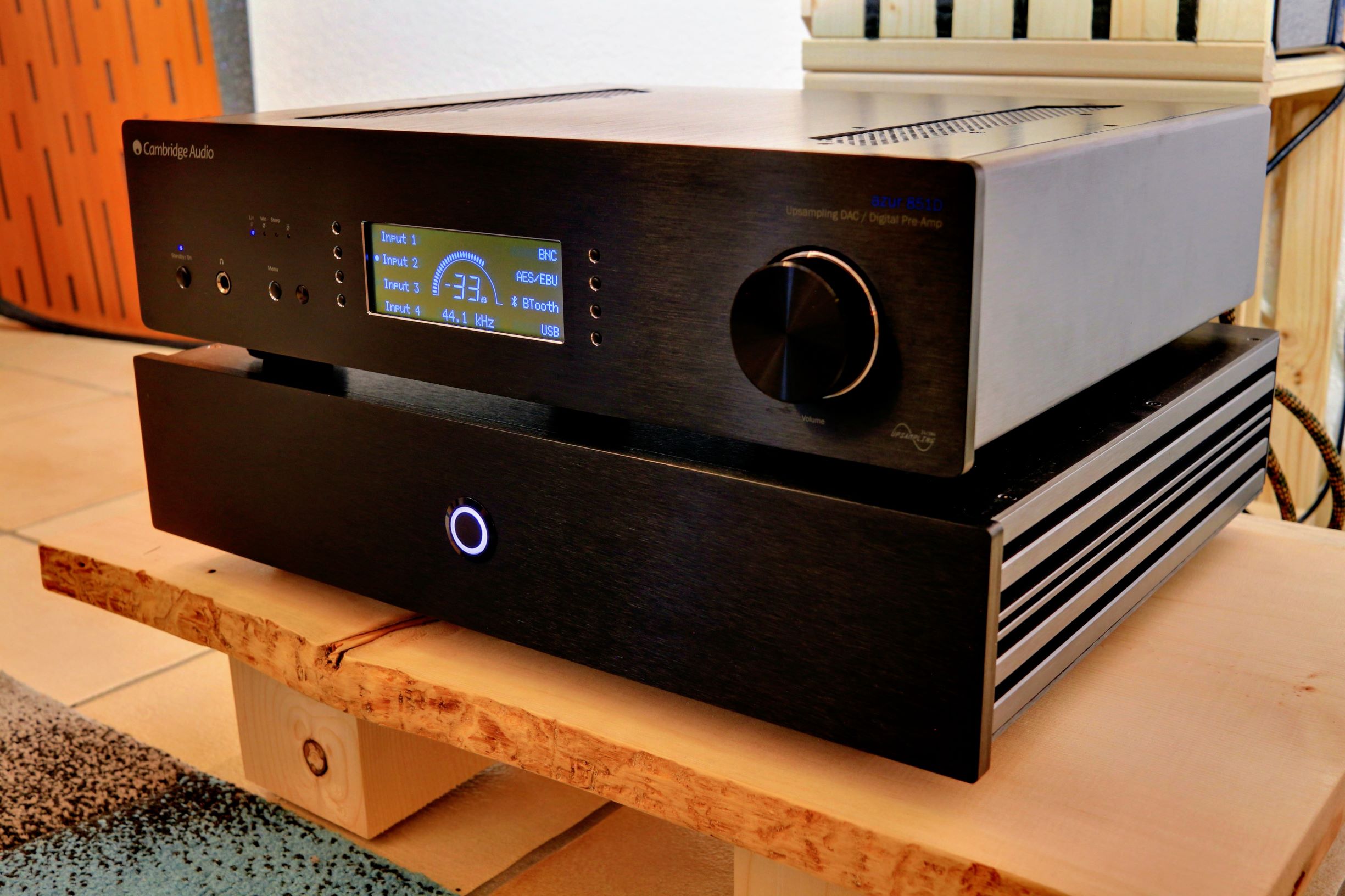

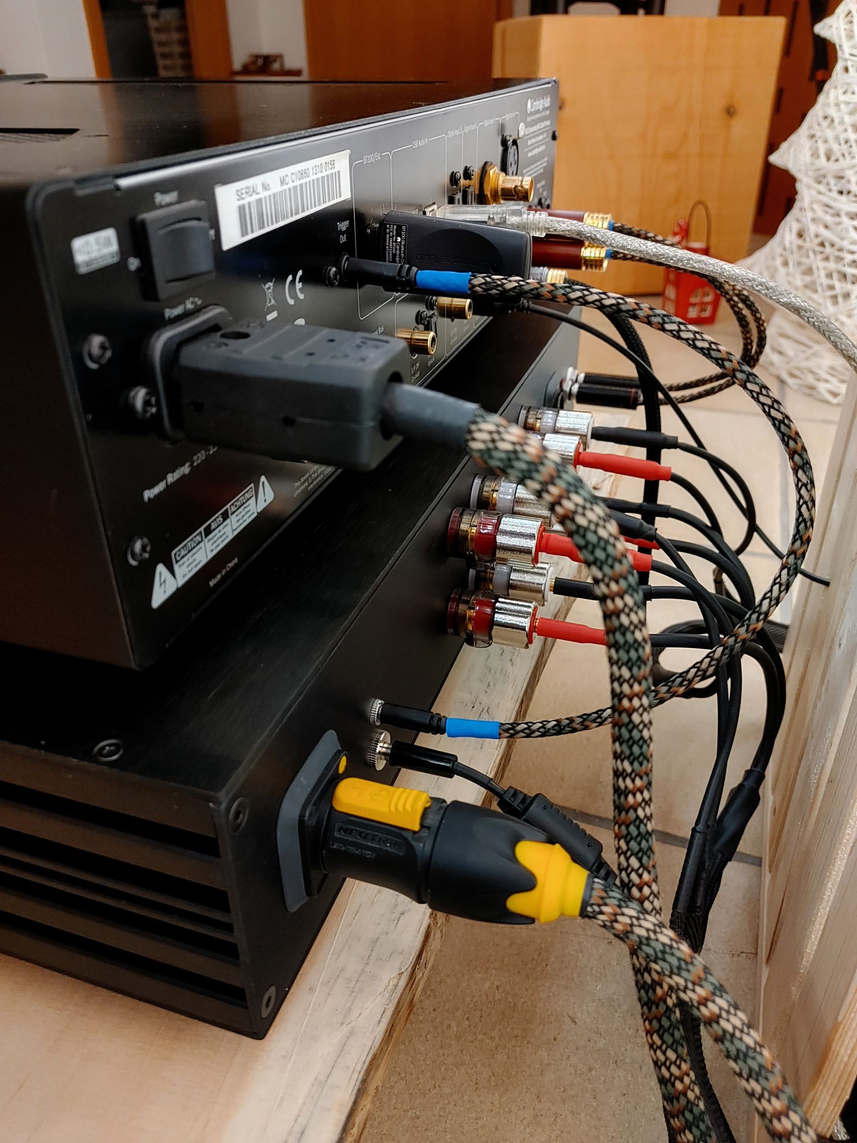

Hi there,
I will leave some additional photos about the amplifier here, the description of the project is here
Hi there,
