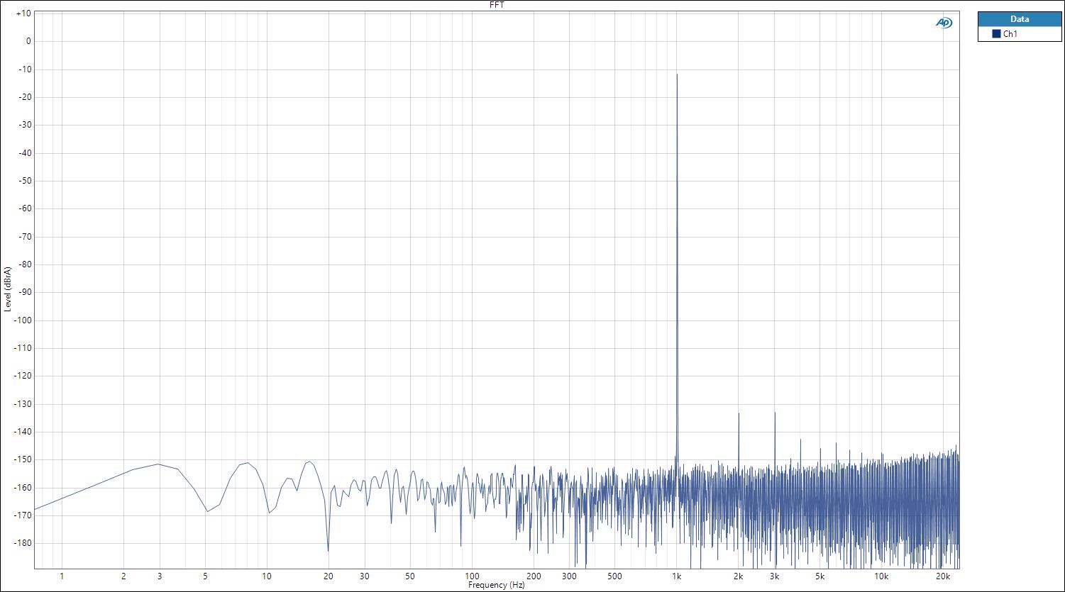

On another note look at the 10W FFT of the Starkrimson output. the harmonics are more than 130dB down. This means they are completely inaudible. 130dB down is equivalent to 15pW (0.000000000015) into 8 ohms.
Noob question: If you set 0dBrA as 10W into 8 ohms, would the harmonics still get 130dB down?
10W is about 11dB down from 0dBRA. So the harmonics are down about 120dB from 10W level.
However the power in the harmonics is still the same 15pW.
Got it!

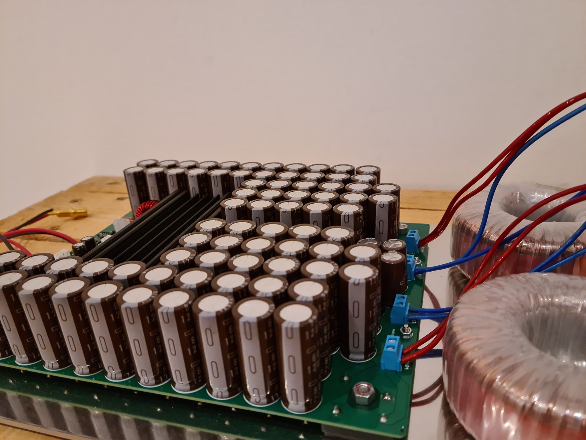

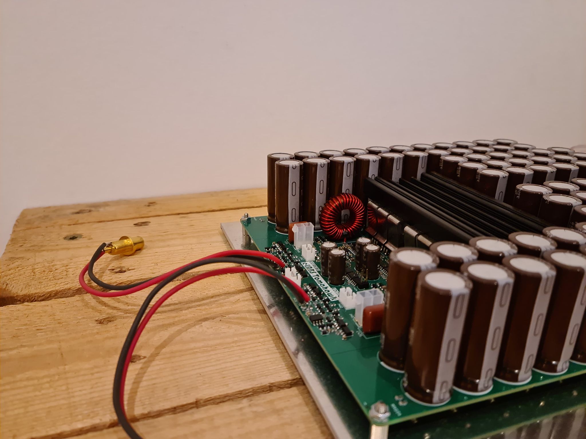

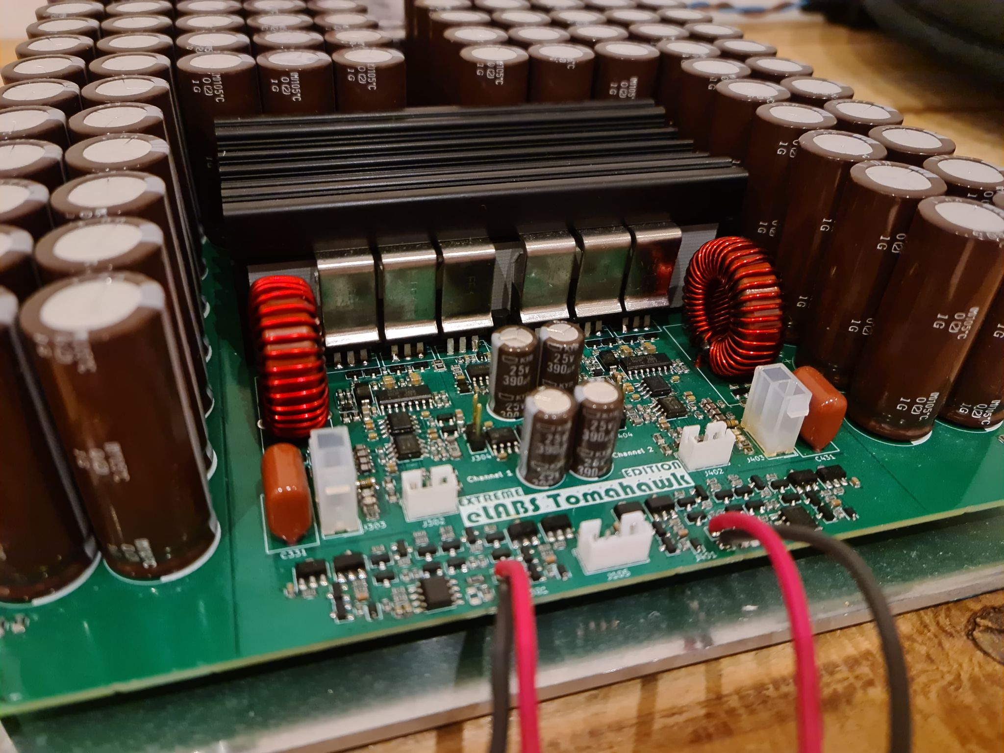

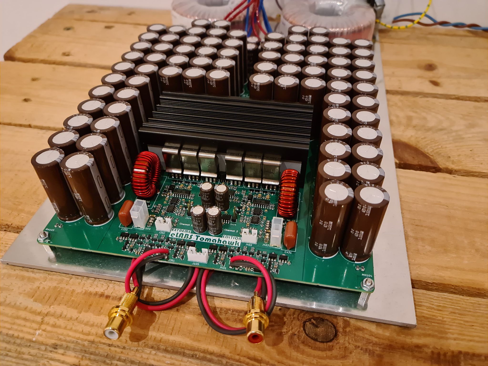

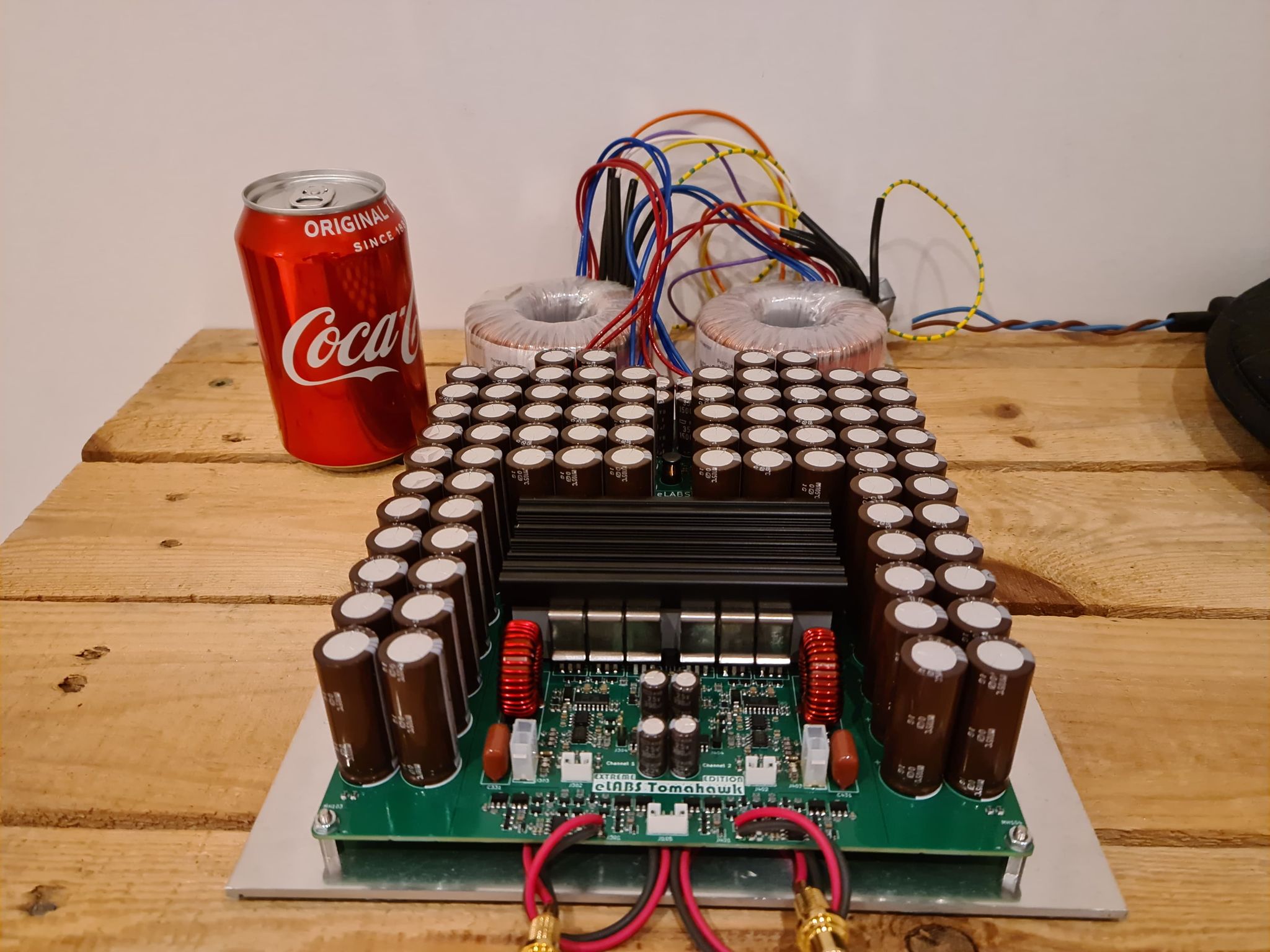

Besides the small 50x80mm class-D, we also did an Extreme Edition...
The size is 180mmx230mm.
The class-D circuit is pretty much the same as the small one, except the DirectFET are chaged to TO-220 package and the output inductor is a toroid version.
The board contains all the features and performance of the small version, and adds:
- Approx 100.000uF of LOW ESR capacitors. Both +/- 60VDC and +/-15VDC.
- Rectifier for +/- 60VDC and +/-15VDC.
All it needs is 2x40VAC and 2x15VAC transformers.
Hope you guys like our approach to class-D.

Well done!!! lovely !!! I don't like the irs 2092 chip ... The latest irs chip is better the done?
your board is just magnific!!! 🙂
Agree... We do not use 2092... We picked out the IRS20957, since it contains the short circuit protection.
