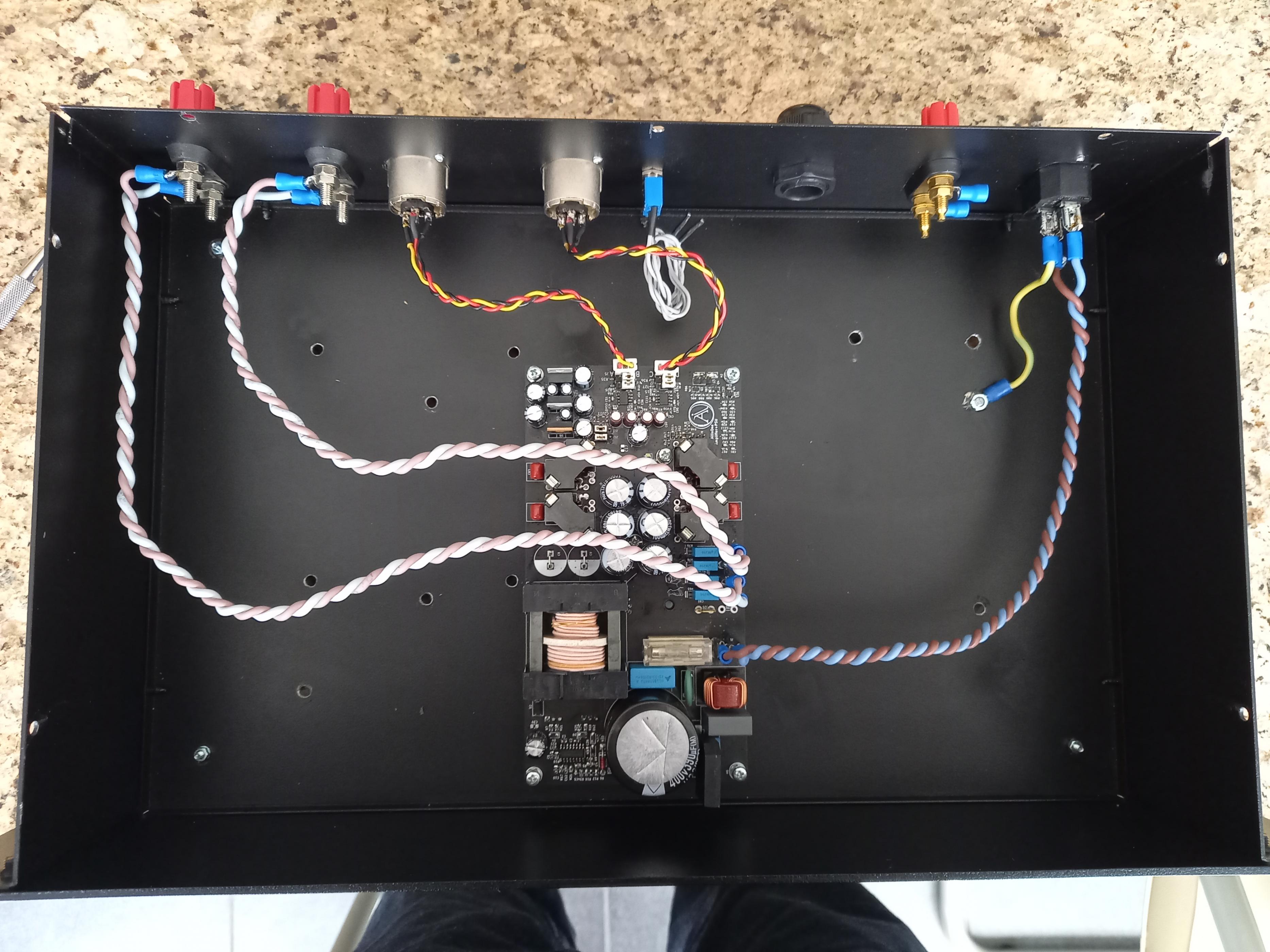

+1 for drMordor "all-in-one" TPA3255 board with PFFB
I have been using class D for several years (TPA, Icepower and Hypex) and for my ears this board has the best overal sound and presentation
My previous best was TPA3255EVM with by-passed op-amps, no PFFB
also good but more forward in your face sound
I know that taste is different for every person, just try it and decide for yourself

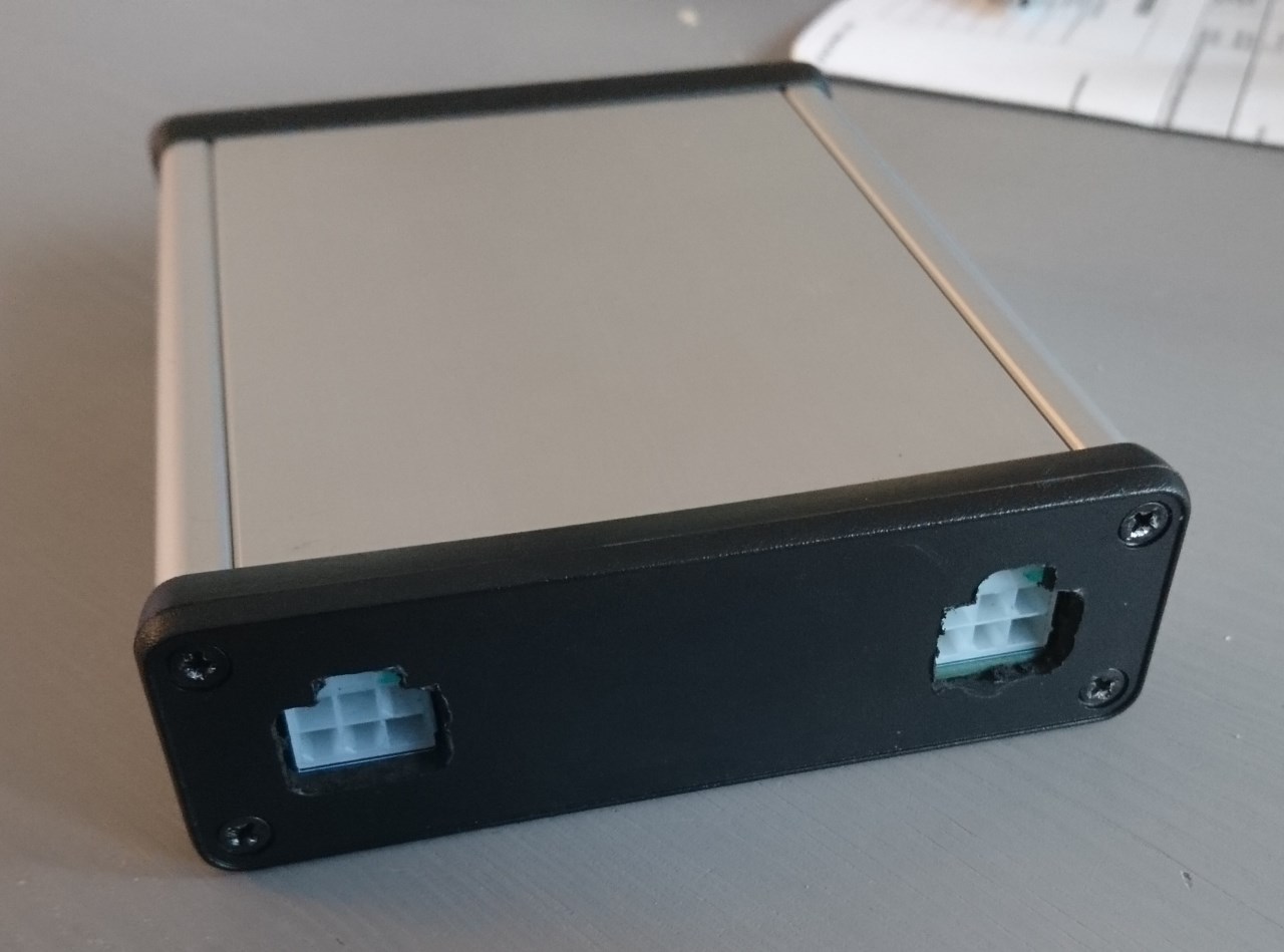

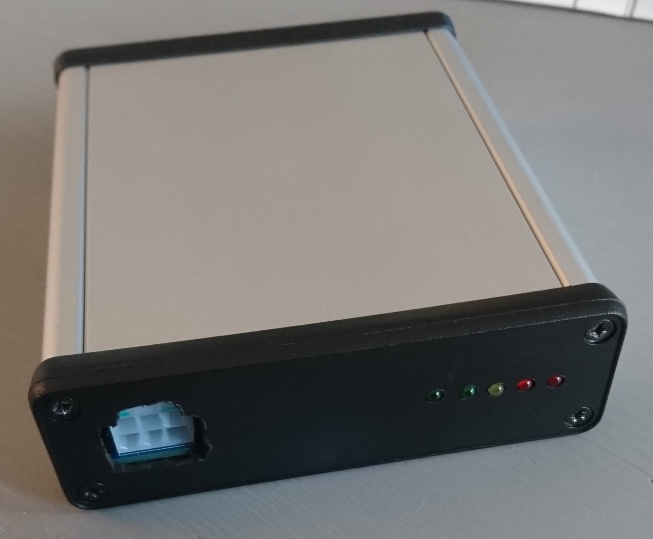

12 x 10 x 3,5 cm³ cased TPA3245 Amplifier for car use. Weight is 306g.
Goal was relatively compact size, high-level inputs, 12V operation with remote control via ignition.
Two of them are now used inside a Ford Focus MK2 as "in-line" amplifiers. Kept the original head-unit, switched speakers in the door-boards. Left the original cabling all as it was and just plugged those two between the original headunit and the existing speaker connections.
Works a charm and provides more than enough power for proper audio.
Step up to 28V is being done via 2 LM5122 in 2 Phase mode. Also generating 15V via LMR15410 and using LM2940s for 12V for the TPA3245 and 12V for the NE5532 input buffers.
Using a Infineon BTS70021EPPXUMA1 for switching the 12V.
Plastik shrouds are a bit how you're doing, but it's good enough.

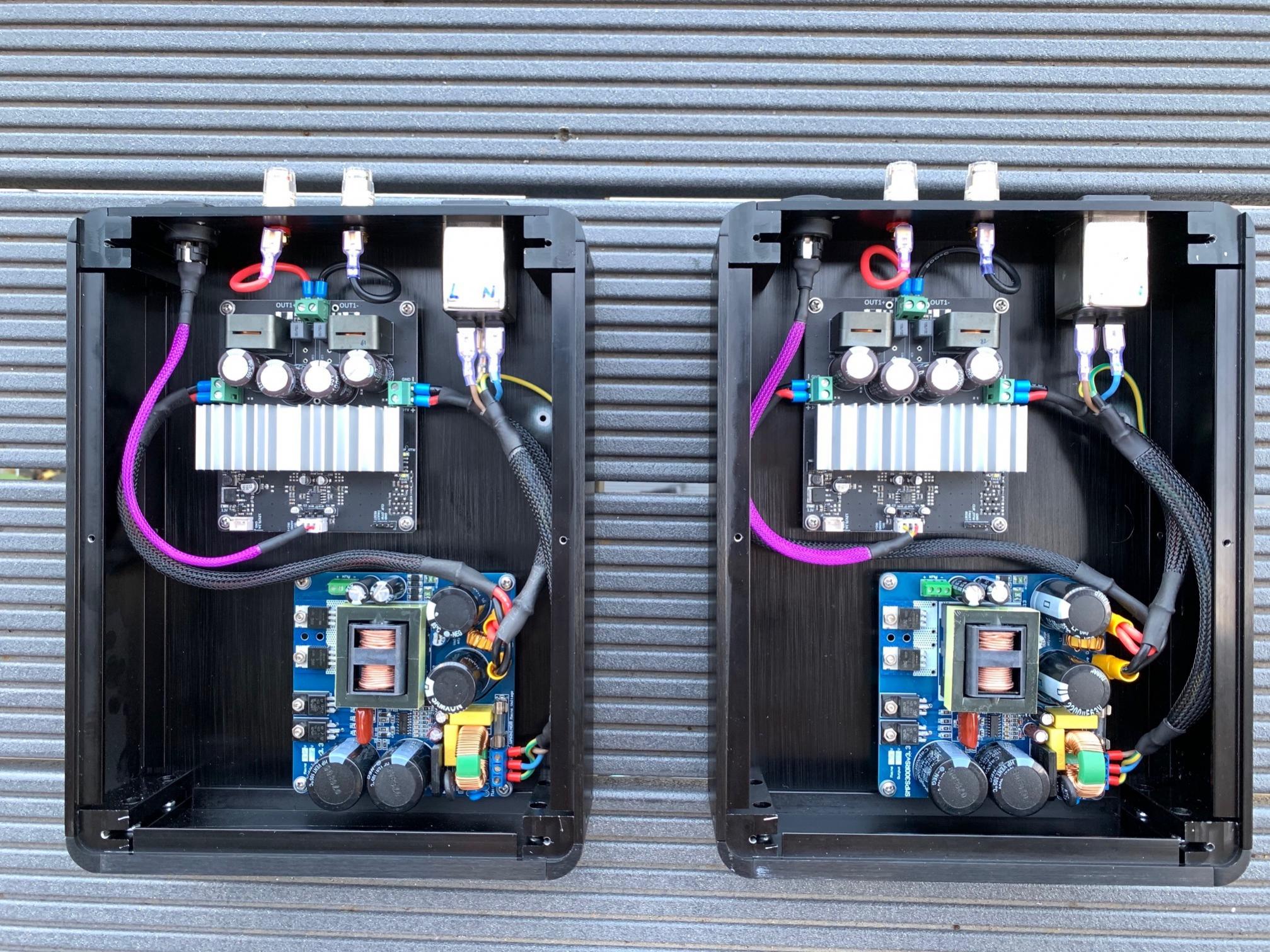

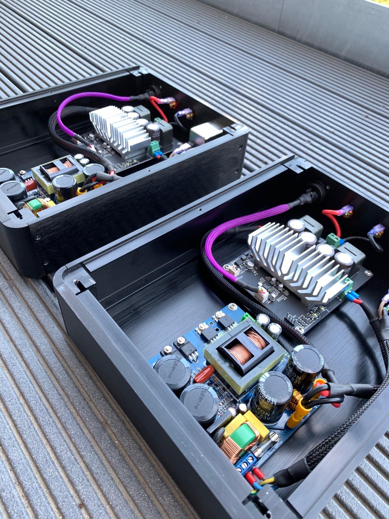

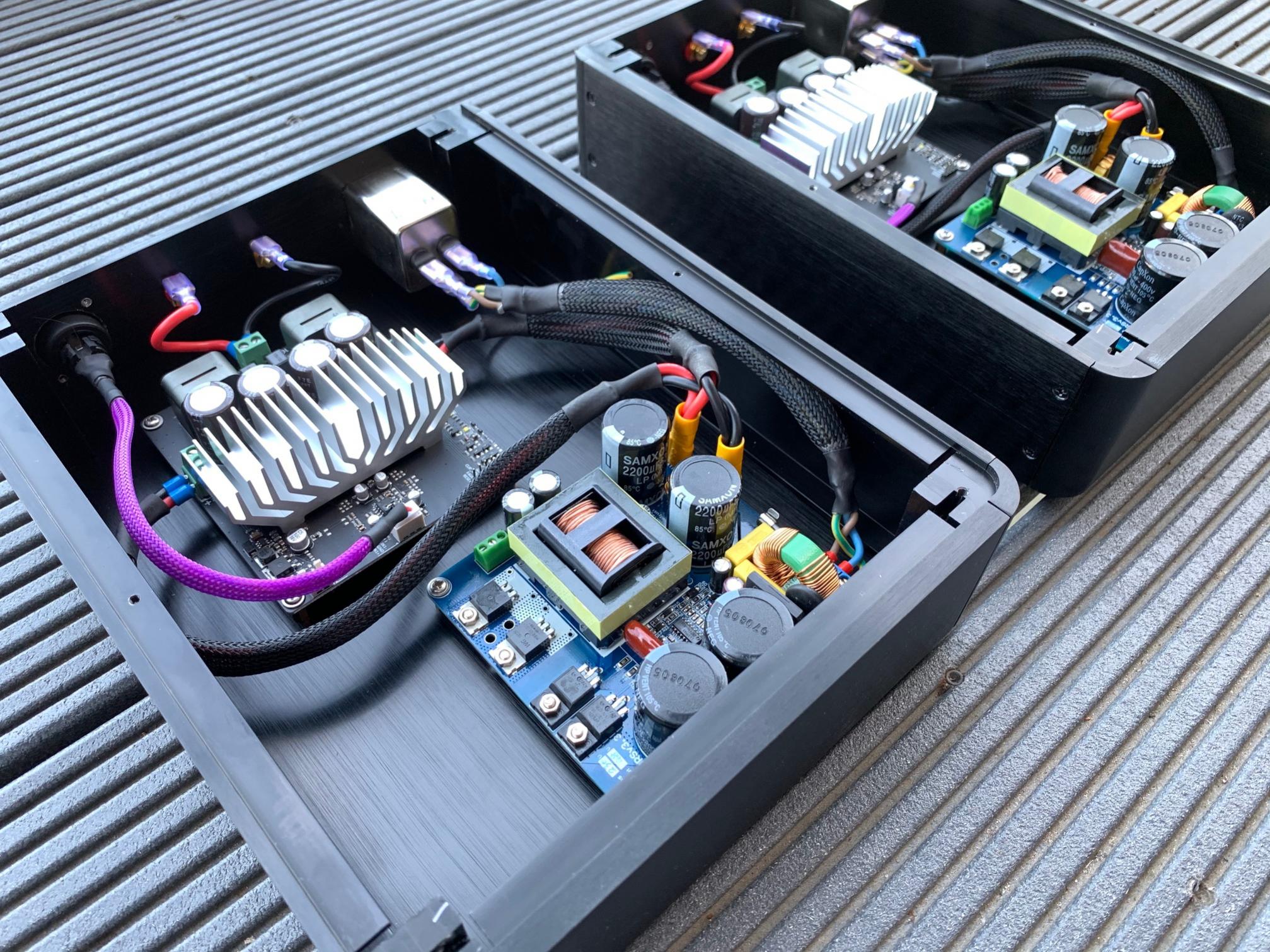

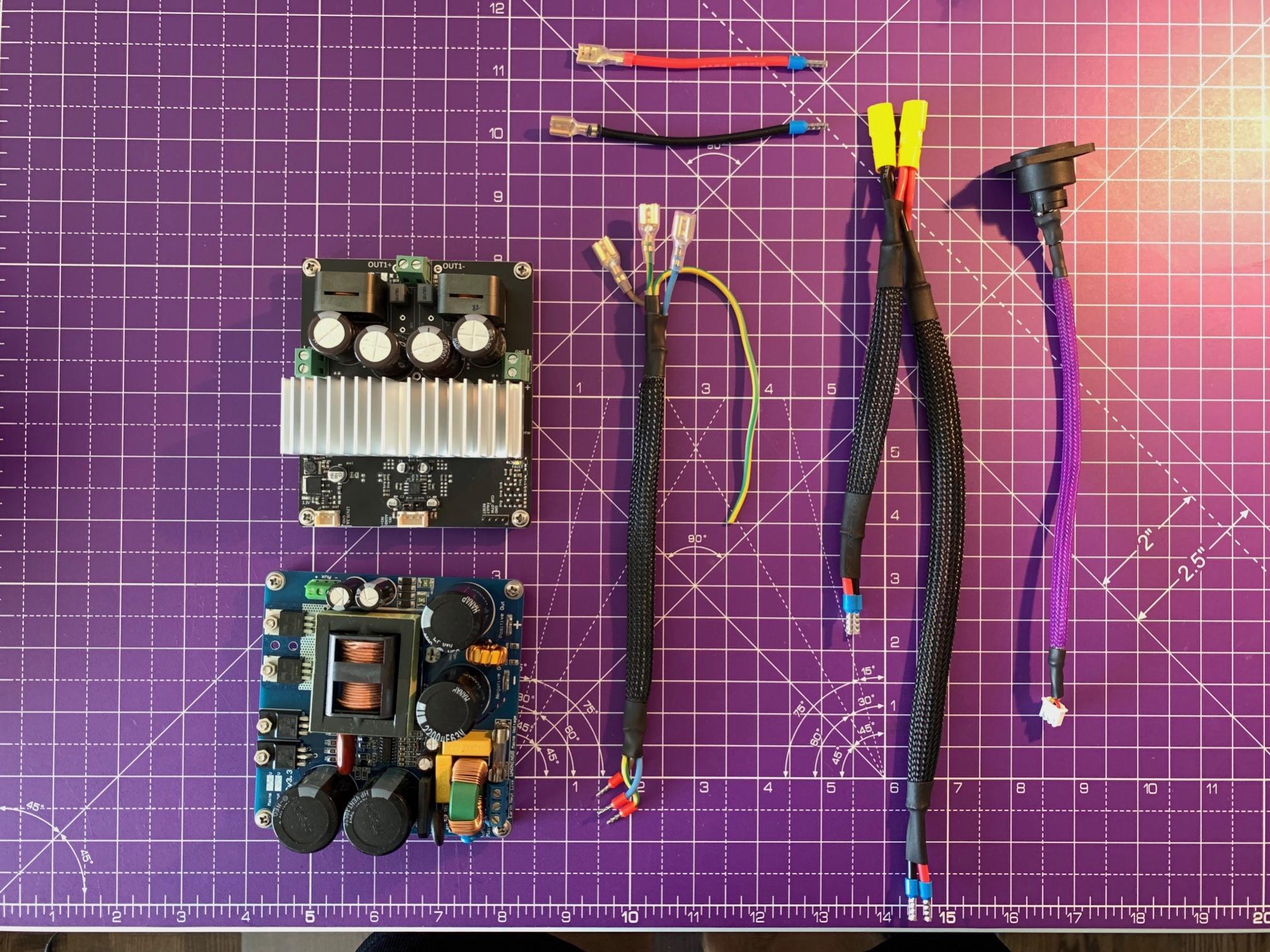

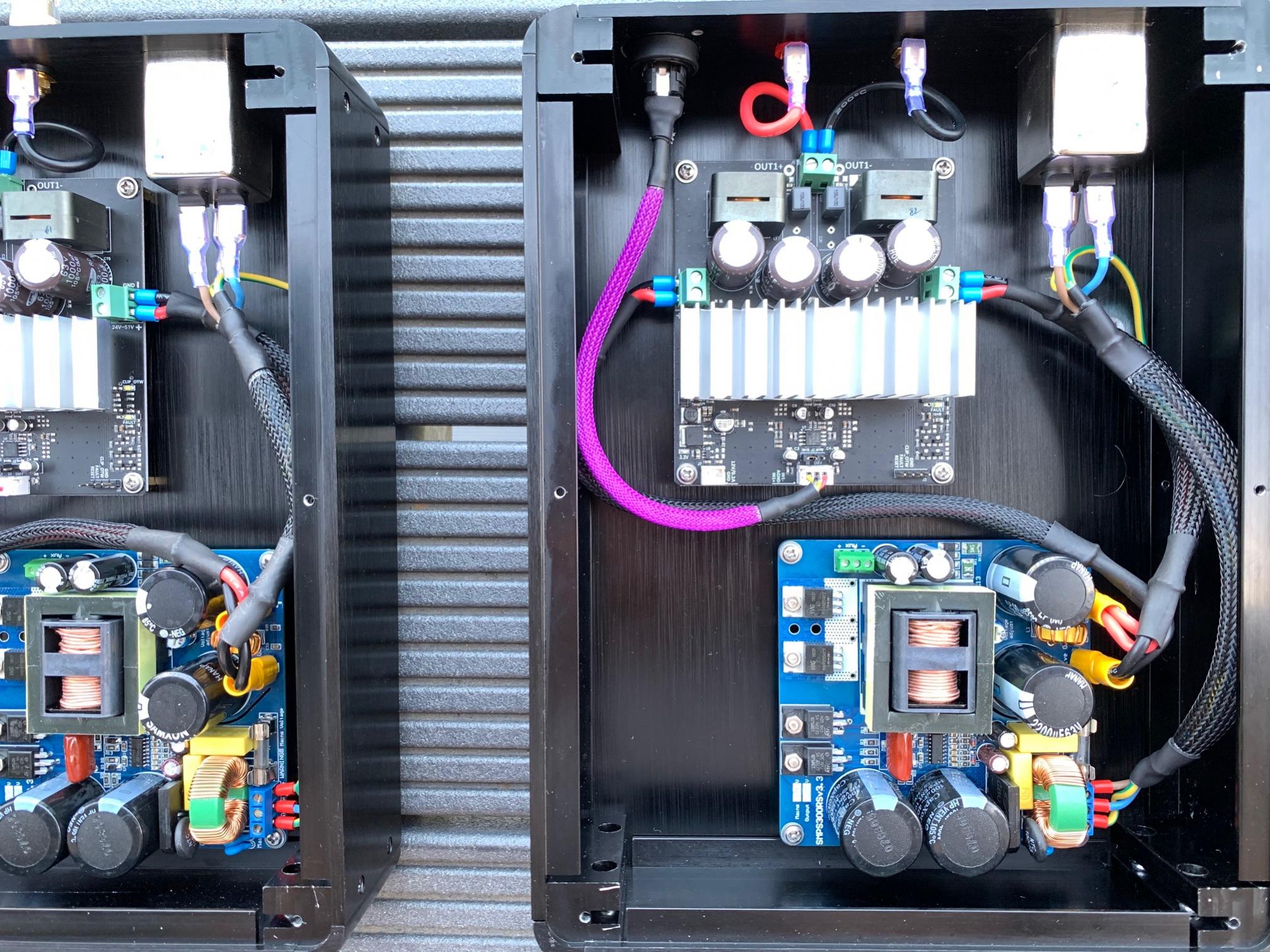

Considering DIY Audio is such a great resource and I'm grateful for all the information provided this is my somewhat limited attempt to give back. Having read a lot, I decided to build some DIY mono block amps, to the intiated this build is simple, however as someone new to this field it took me a while to research and complete.
The build is consists of connex electronics SMPS300RS and 3E Audio TPA3255-1CH-480W amplifier modules and some eBay cases sourced from China found on eBay. Overall I'm really impressed with the cost vs performance ratio. Im using a PI4 feeding a S.M.S.L Sanskrit 10th DAC into KEF LS50's. With an ear pressed to the speakers there is a feint hum, I recommend the combination.

very nice build !:blush:
i guess that´s the amp case?
BZ2106A Full Aluminum Enclosure Mini Power Amp Case/ PSU Chassis Audio DAC Box Rounded Shell Silver or Black| | - AliExpress
