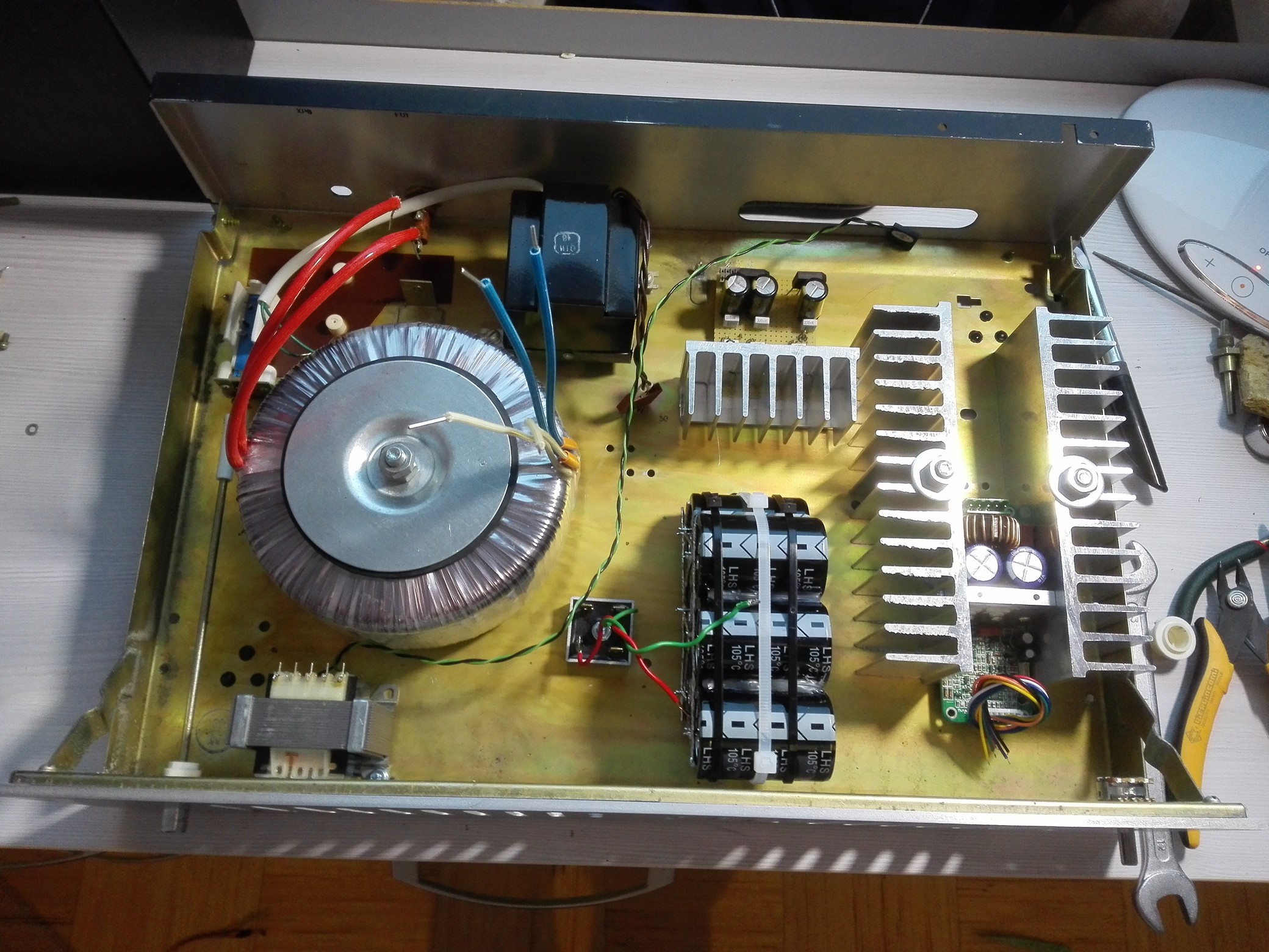

Actually the case had an IEC hole, and fuse hole already drilled. I didn't put a fuse, so the hole is left empty.Gribb - a nice looking amp with tidy internal layout. I like the use of speaker cab. receded binding post panels. I don't like the use of self tappers though!
It looks like you drilled the case for a mains fuse holder but have not used one. Why?
What is the mains safety earth connected to? It should be connected to the case as close as possible to the mains input socket.
The main earth is connected to the case directly around the IEC filter hole. I fit very very tightly (the paint has been removed).
The 240V cable that run from the IEC to the soft start is shielded. The shield is connected to earth at both end to prevent electromagnetic radiation to neighbouring cards.
I agree with you about the screws, those are actually for wood… I'll replace with black and shorter ones later.
This one HIFI 2000 400mm 3U Chassis - 10mm front Black - AudiophonicsGrib, whose enclosure?
I haven't have had the time to try in my acoustically treated room with a decent DAC yet, so I can't tell. I just tested the output power in my living room, the power is definitely here, very low noise floor.Grib - nice work, does it sound as good as it looks ?
Ideally it should be measured with an Audio Precision, if someone in France has one and is interested it measuring it, that'd be great 🙂

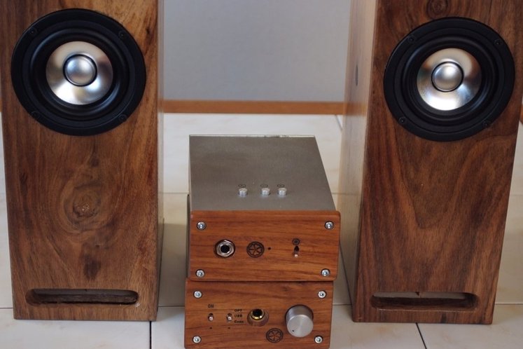

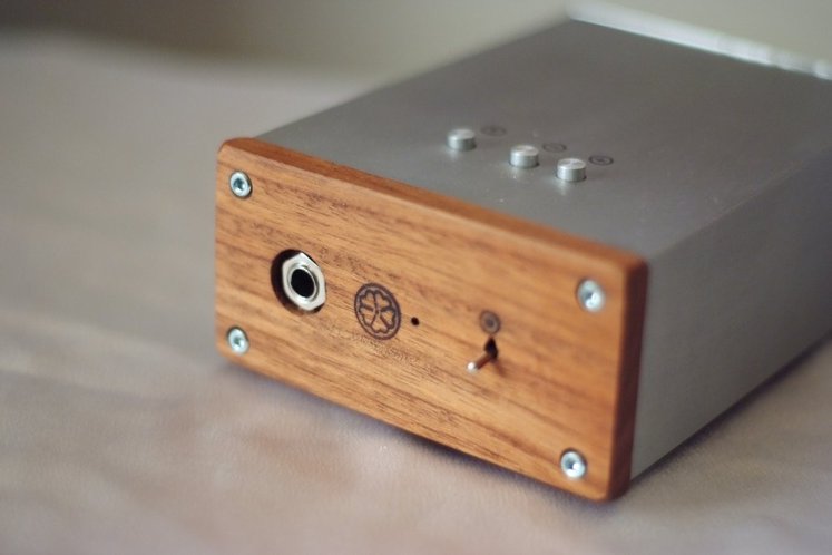

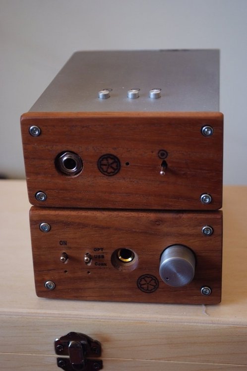

Some more miniatures...
This time, it's the STA333BW USB "full digital" ebay amp, very slightly modded, in a new enclosure. Also a nice DAC, FX6 in a new box, and some new small speakers, just to complete the picture 🙂
