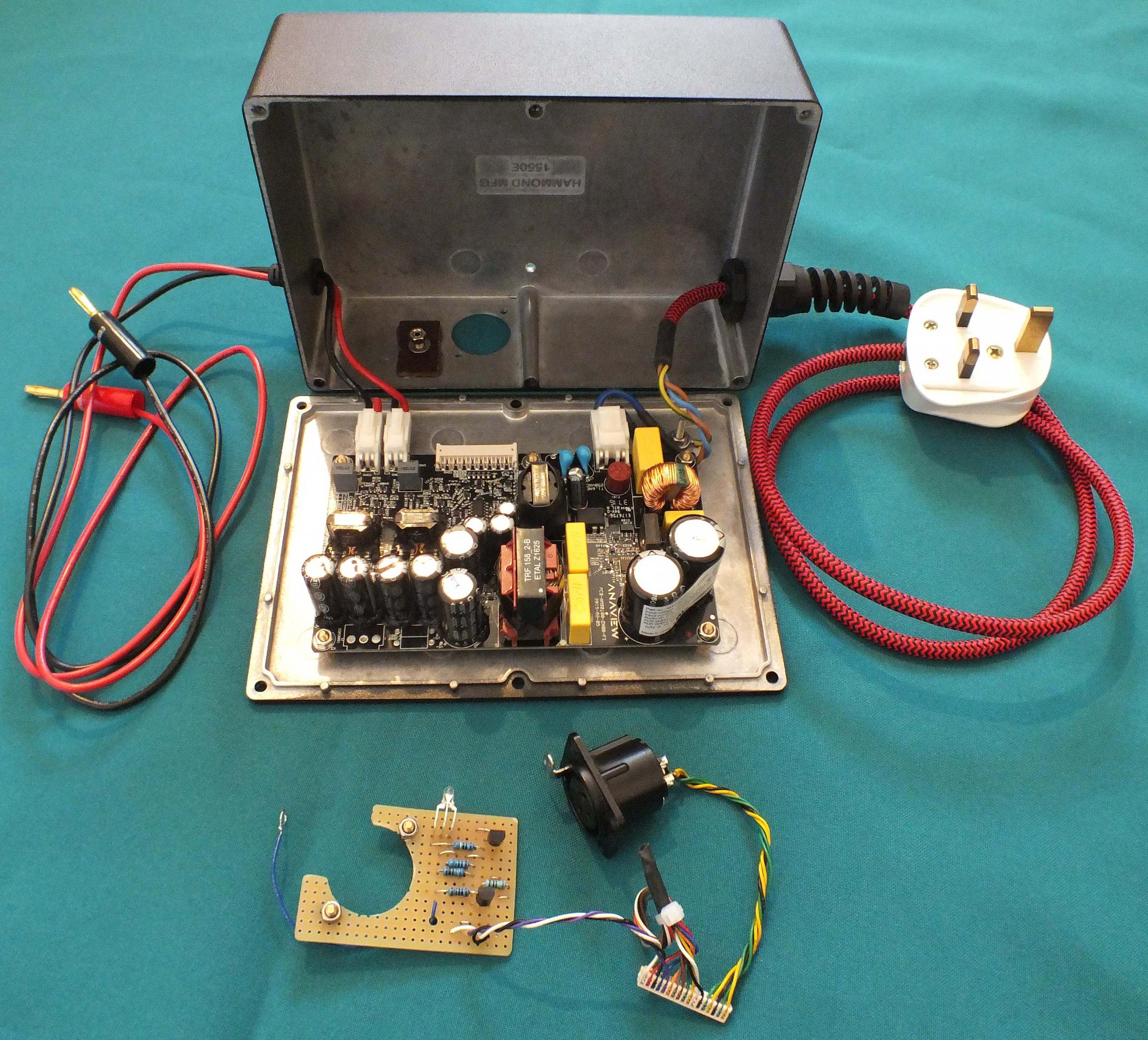

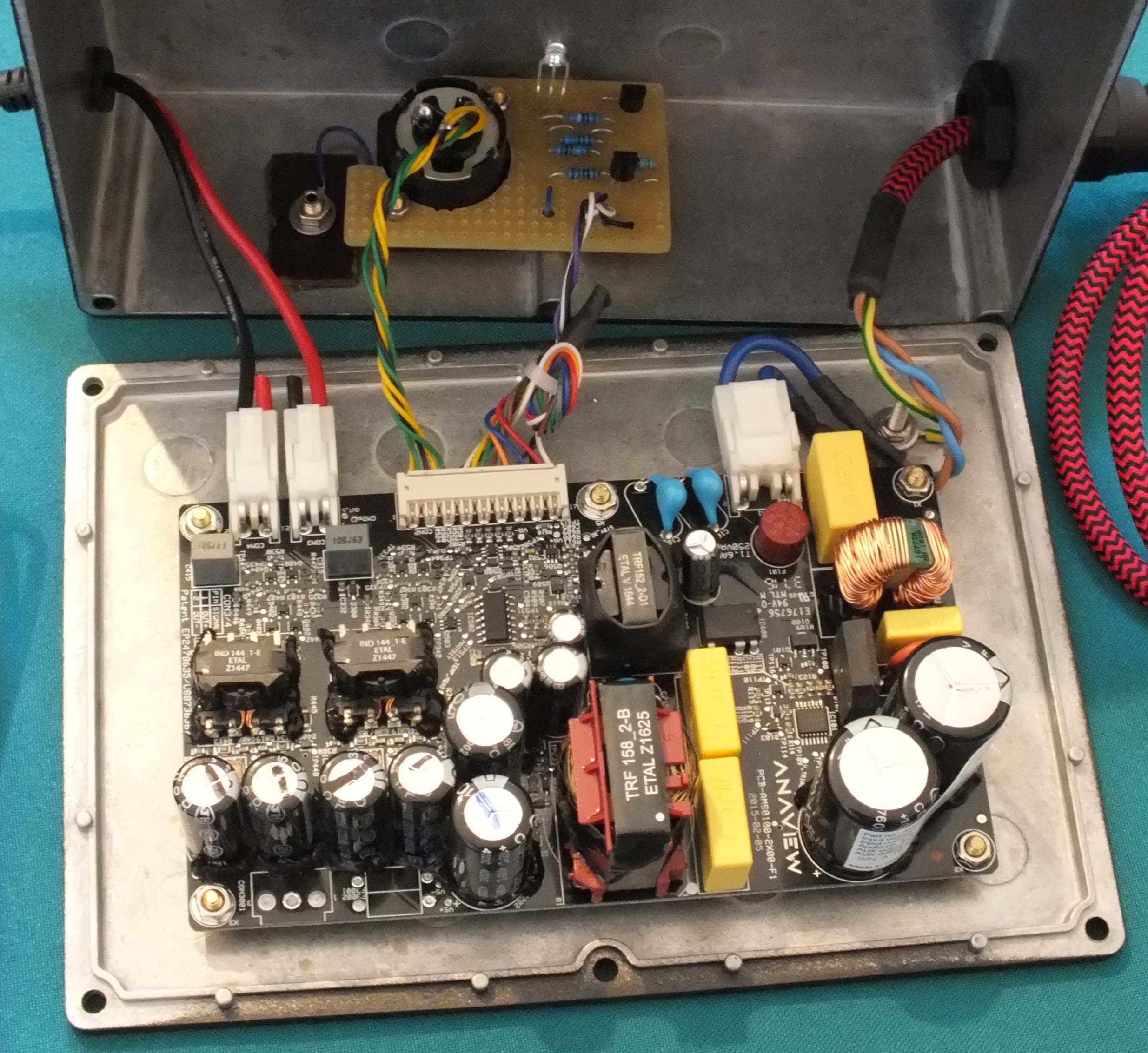

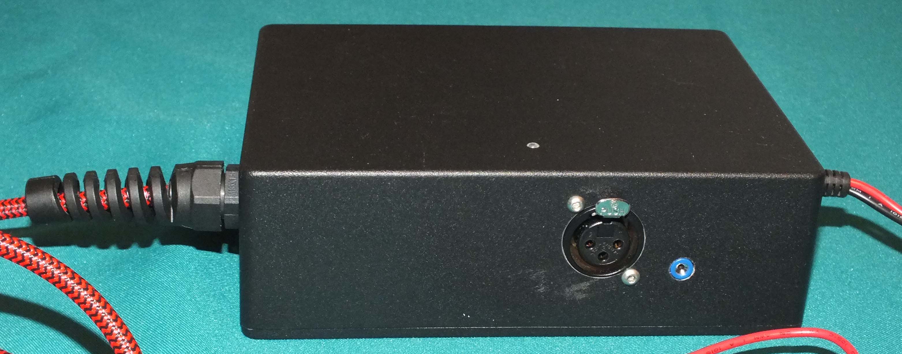

My Anaview AMS0100 monoblock. One of a pair. Sit behind each loudspeaker.
Ignoring the baseplate, only 2 (to be replaced with black) screws on show.
Hammond 1550EBK black textured pre-finish case is a tight fit. Had I mounted the board in the box rather than in the base/lid then separation of the halves would be easier but screw heads would be visible. For those who wish to know, I can confirm that the +/-25v supply is available (for future hanger module) - only the fuse and connector are not populated.

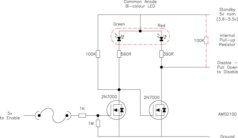

Attached also is the disable/enable circuit.

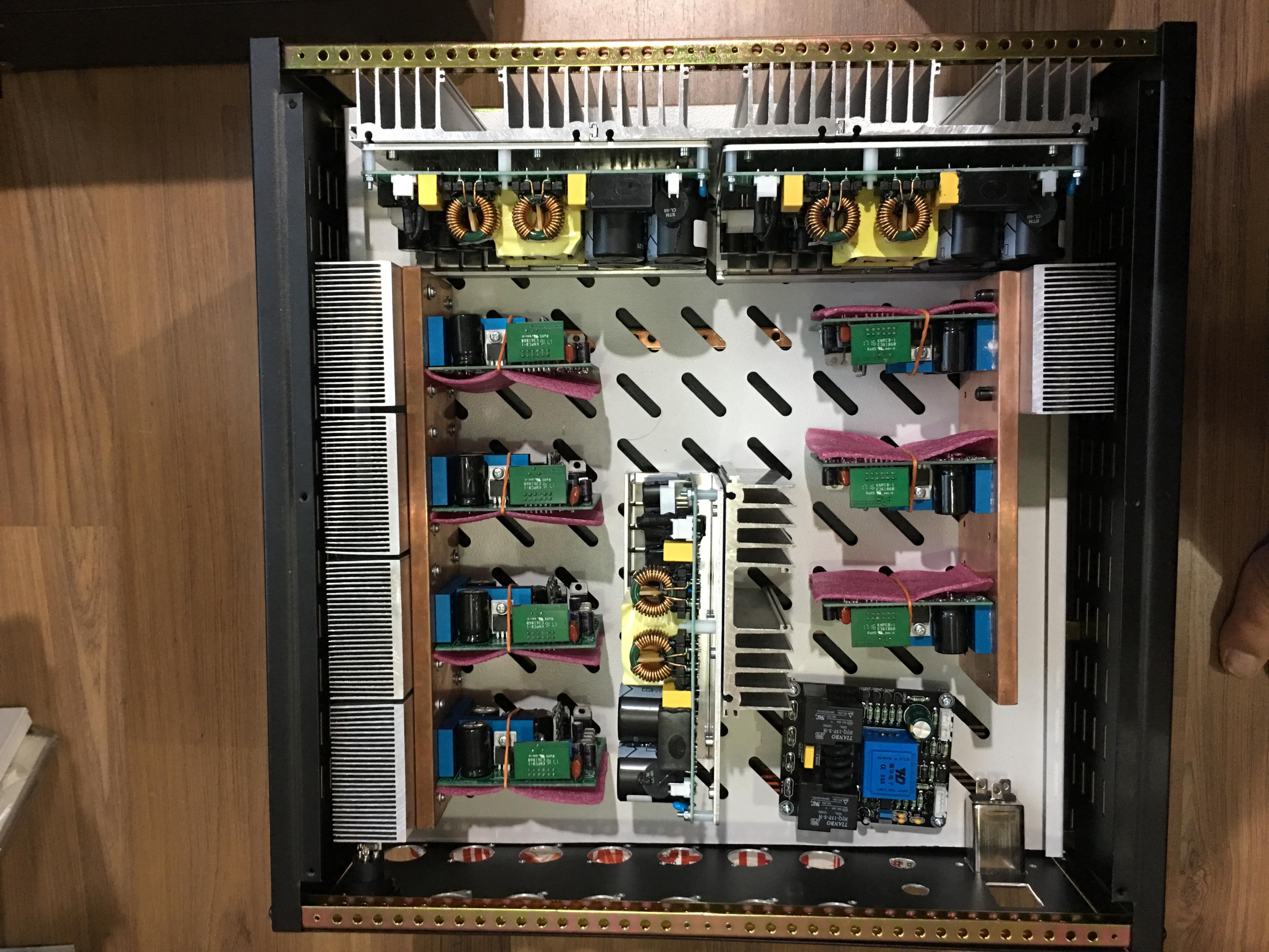

We gutted a Elan 16 channel amp, and we are using IcePower 50wpc, and 100wpc amp modules for the new amp. The only thing used from the Elan is the faceplate, and basic chassis minus the rear panel and we cut out the bottom of the donor chassis to insert a perforated bottom panel.
