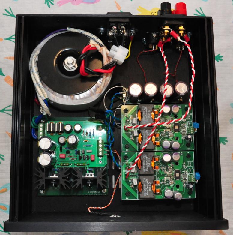

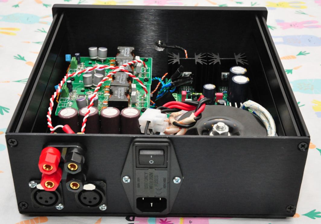

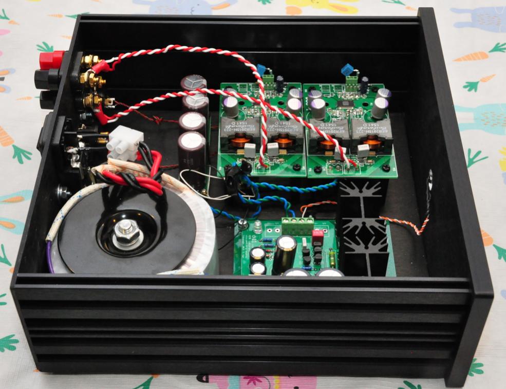

Here is a decent-looking but "failed" amp I built. The two amp modules are DUG-1 tpa3116 PBTL boards.
Power supply is a Sigma 11 configured for 18V. Transformer is an Antek AS-1220 (100VA 20V).
You can't see them in the pictures, but below the amp boards are two Jensen JT-11P-1 input transformers. The intent of using these was for DC-blocking and unbalanced to balanced conversion. I call this project "failed" because using these transformers created a hum. On its own, the hum was mild enough to be ignored, but when paired with my DAC, the hum was too much to bear.
Note that the DAC with any other amp produced no hum, and this amp with a different DAC did not increase the hum. Negative synergy?
At any rate, I've since removed the input transformers and installed DC-blocking caps on the amp boards. Now the amp is completely silent, with no trace of hum, regardless of what device it's connected to.

A possible cause could be that the mains transformer stray field could be picked up by the input transformers due to the short distance between them....
+1A possible cause could be that the mains transformer stray field could be picked up by the input transformers due to the short distance between them....
I had the same problem when transformer was very close to the iput VAS stage on my headphone amplifier. Well it is not the same situation, but as said transformers do stray magnetic field and can be easily picked up by other components.
If you can try to use transformer with magnetic shield.
The Jensen JT-11P-1 are encased in mu-metal shielding.
While trying to debug this I did move the power transformer out of the chassis, as far away as the secondary leads would allow (they used to be much longer than the picture shows, I later trimmed them down to size). At the same time, I also moved the input signal transformers out of the chassis (the other side of the chassis from the power transformer). The stock leads on the signal transformers are also pretty long, so I had a good two feet between power and signal transformers (with the chassis in between). That didn't solve the problem.

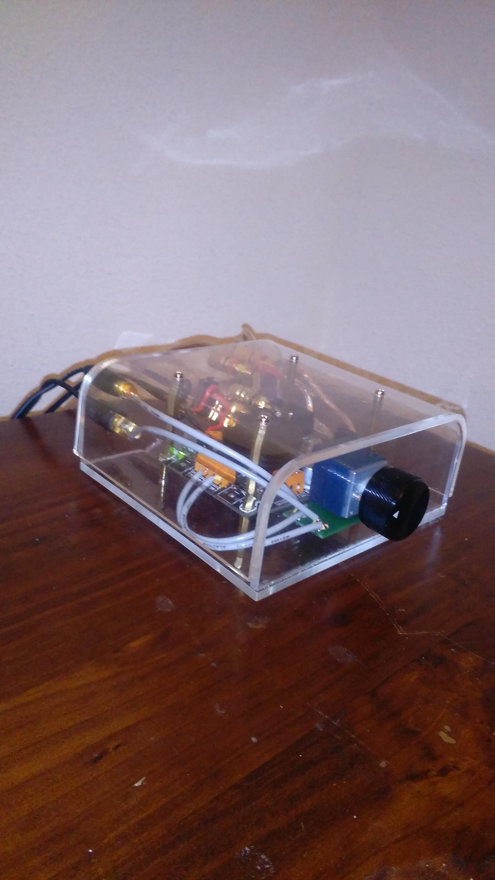

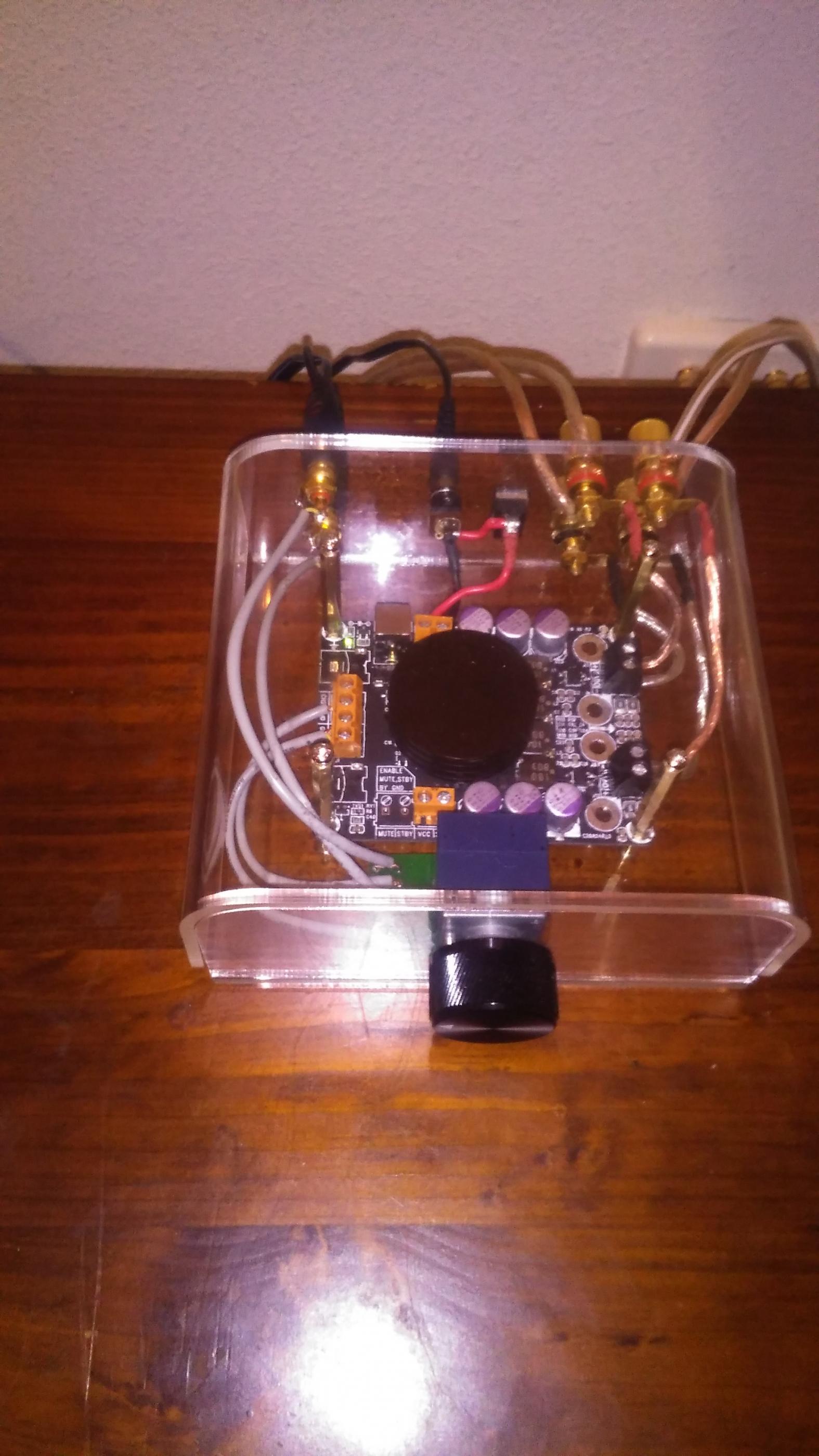

TPA 3116 with Sure Electronics board
Built a nice enclosure for this board.
Plexiglas with a curved top. Amazing what you can do in your home oven. 🙂
Upgraded the caps with Panasonic Oscon, and added an Alps pot and on/off switch. The sides of the curved top don't come down far enough, so I'll probably do Mark2 version of that.
Very happy with this...

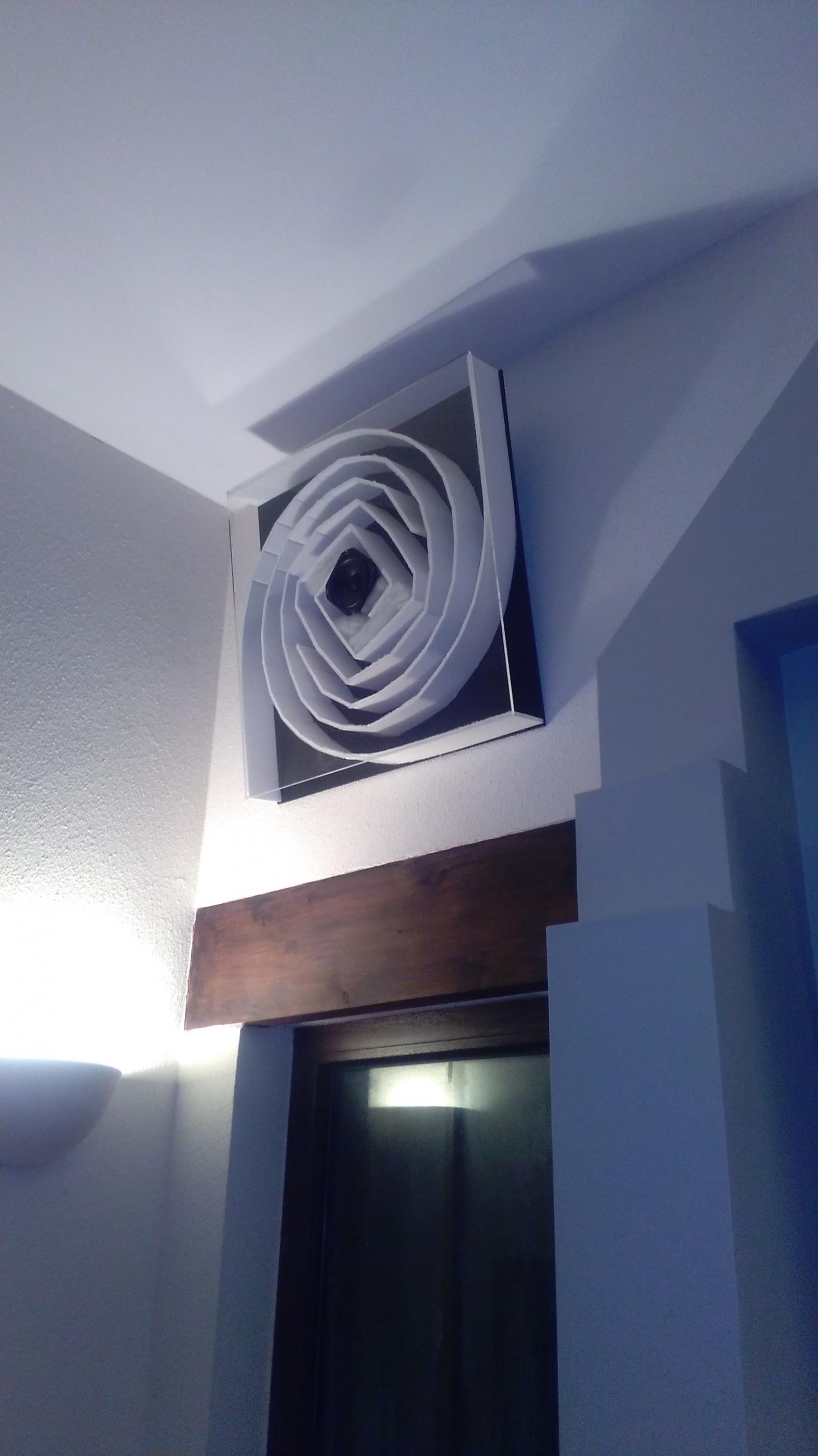

Goes nicely (and sounds nice) with my Cornu speakers with a plexiglass front.

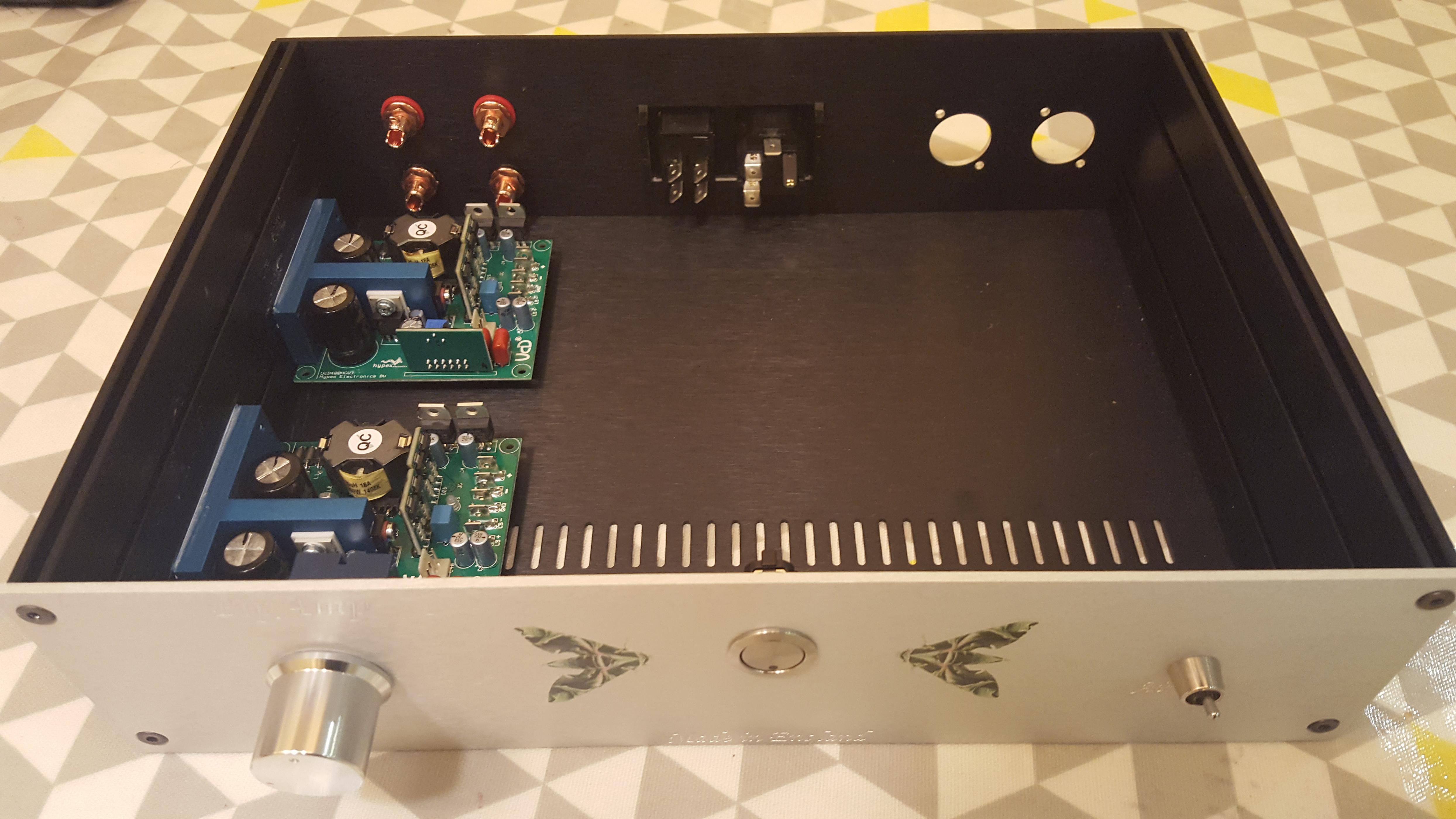

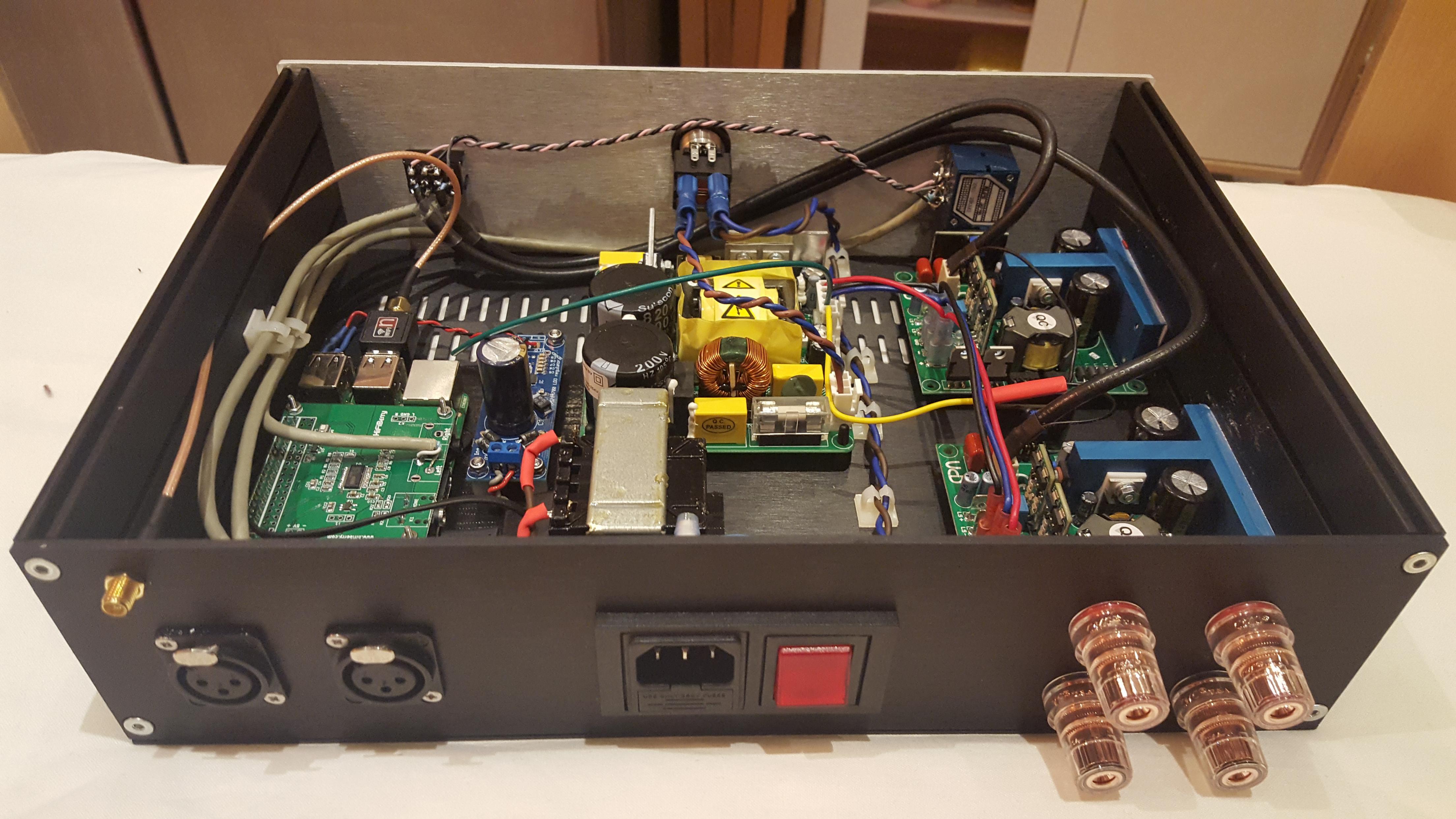

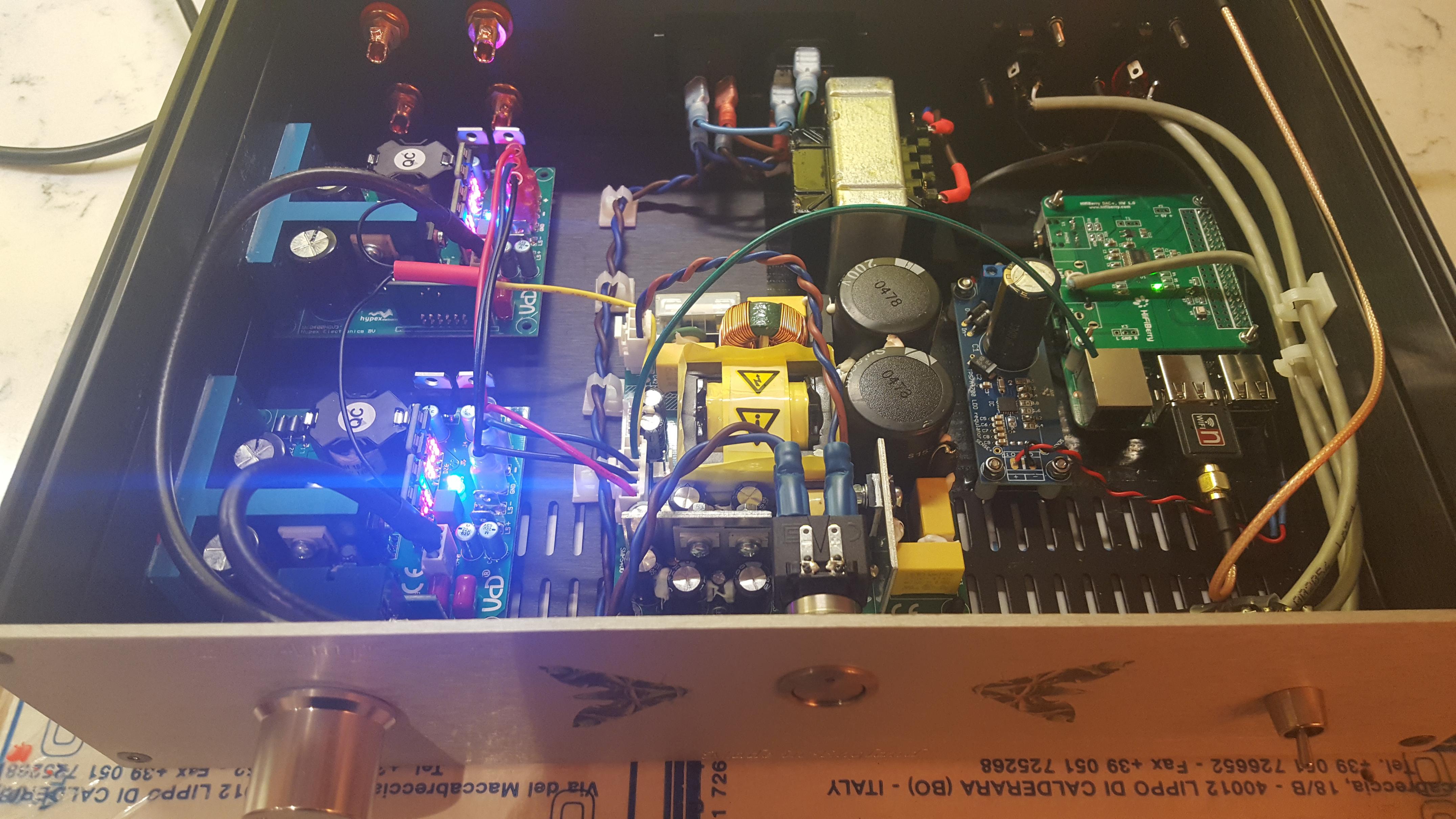

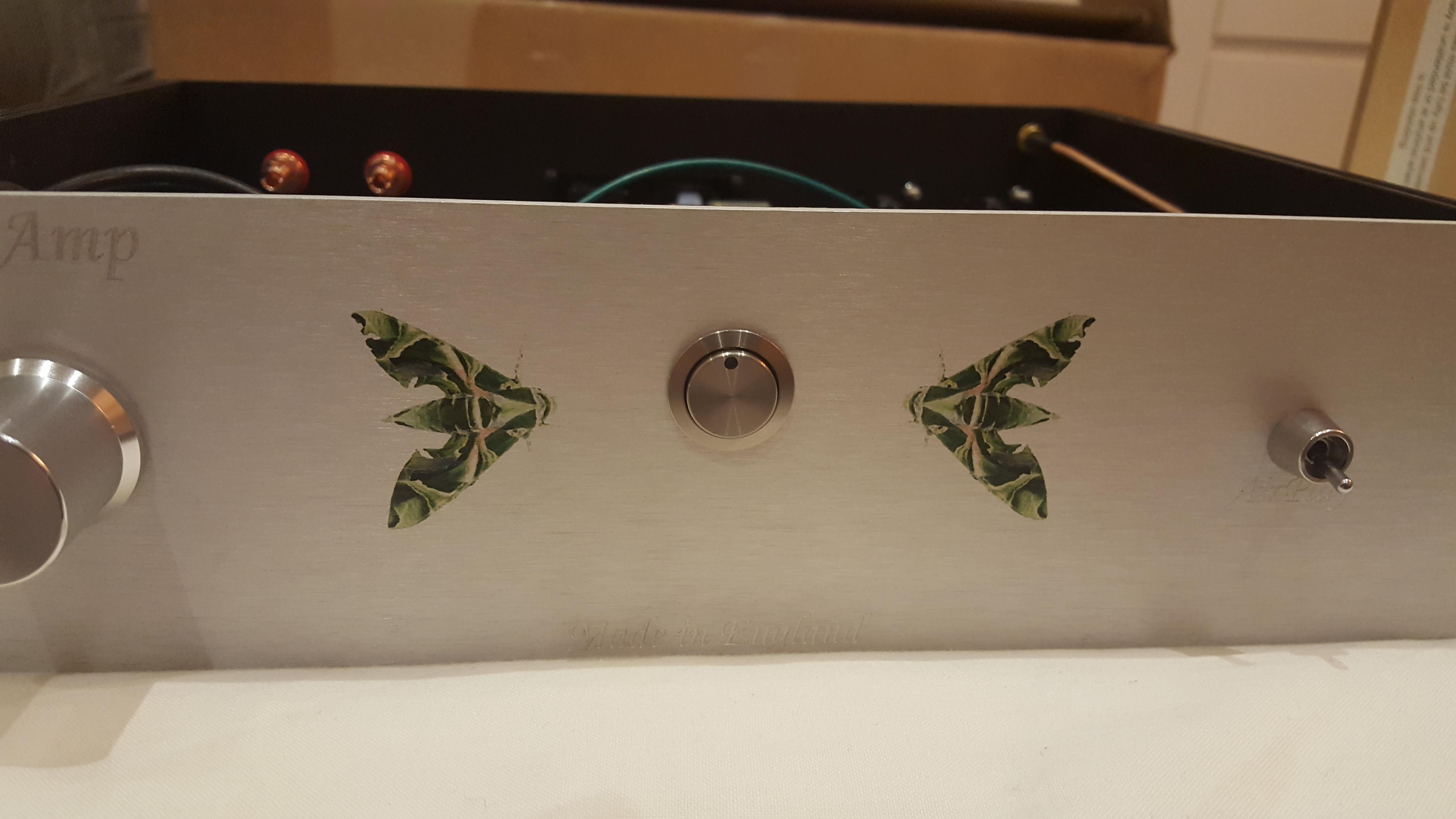

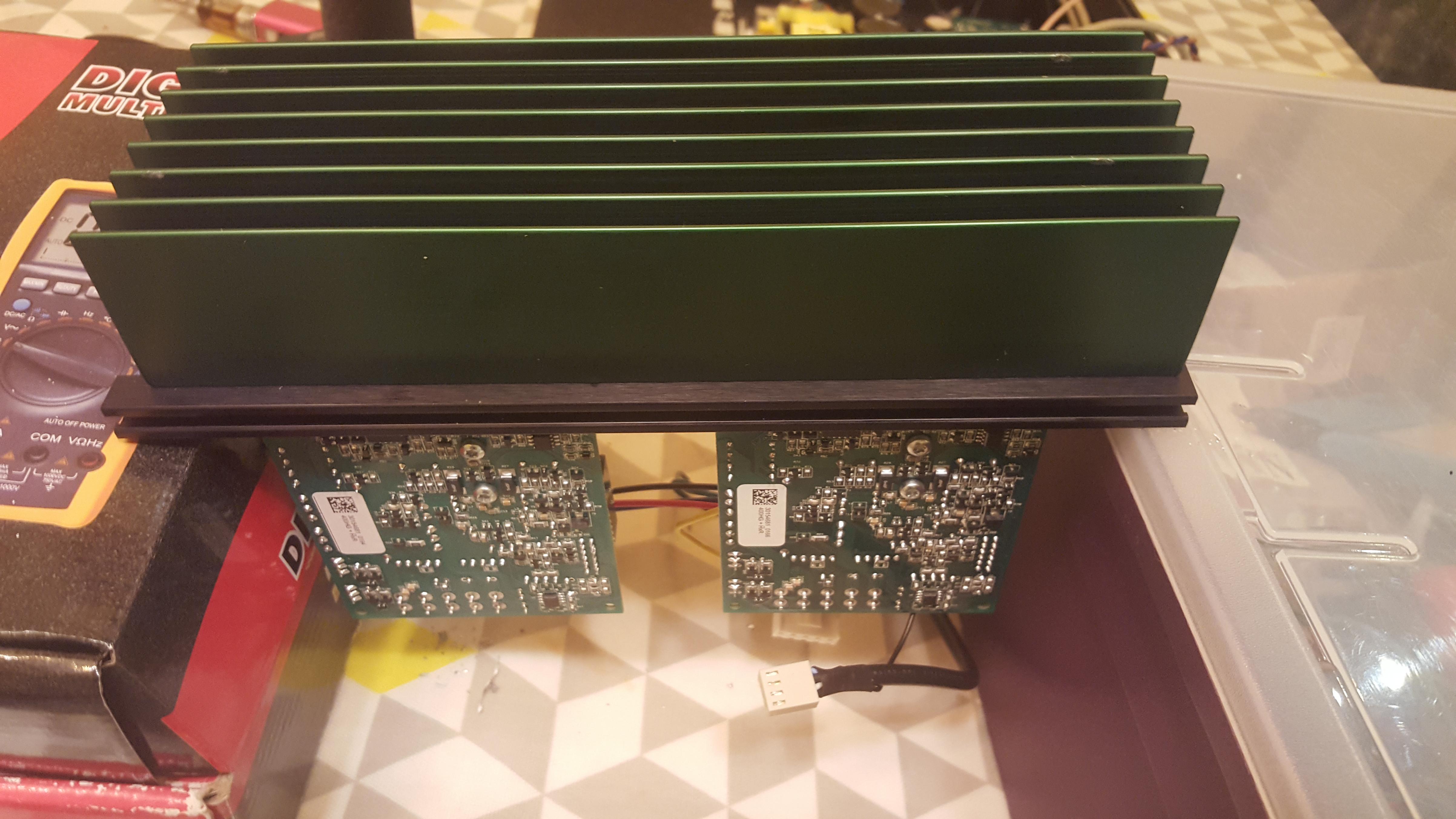

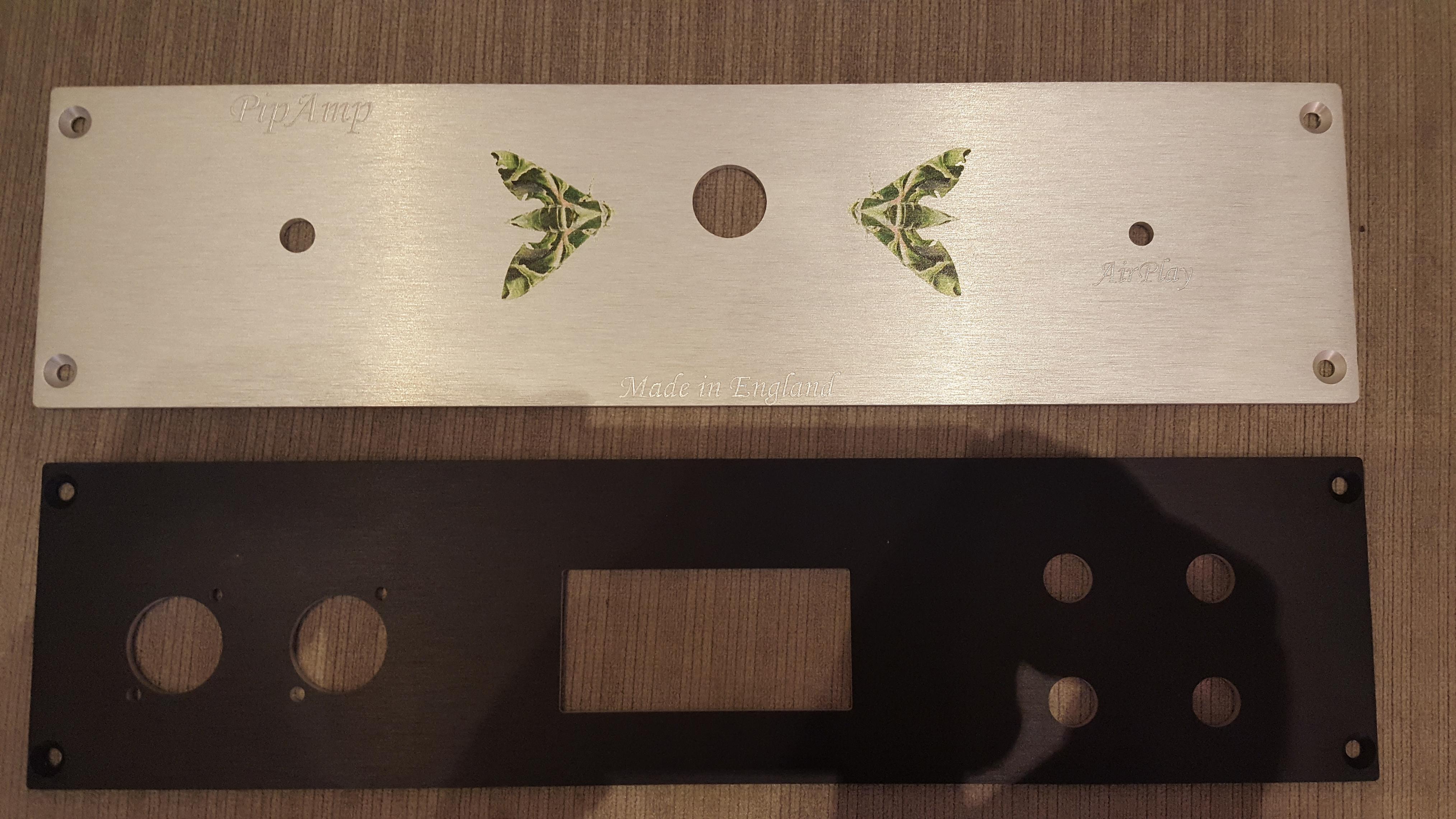

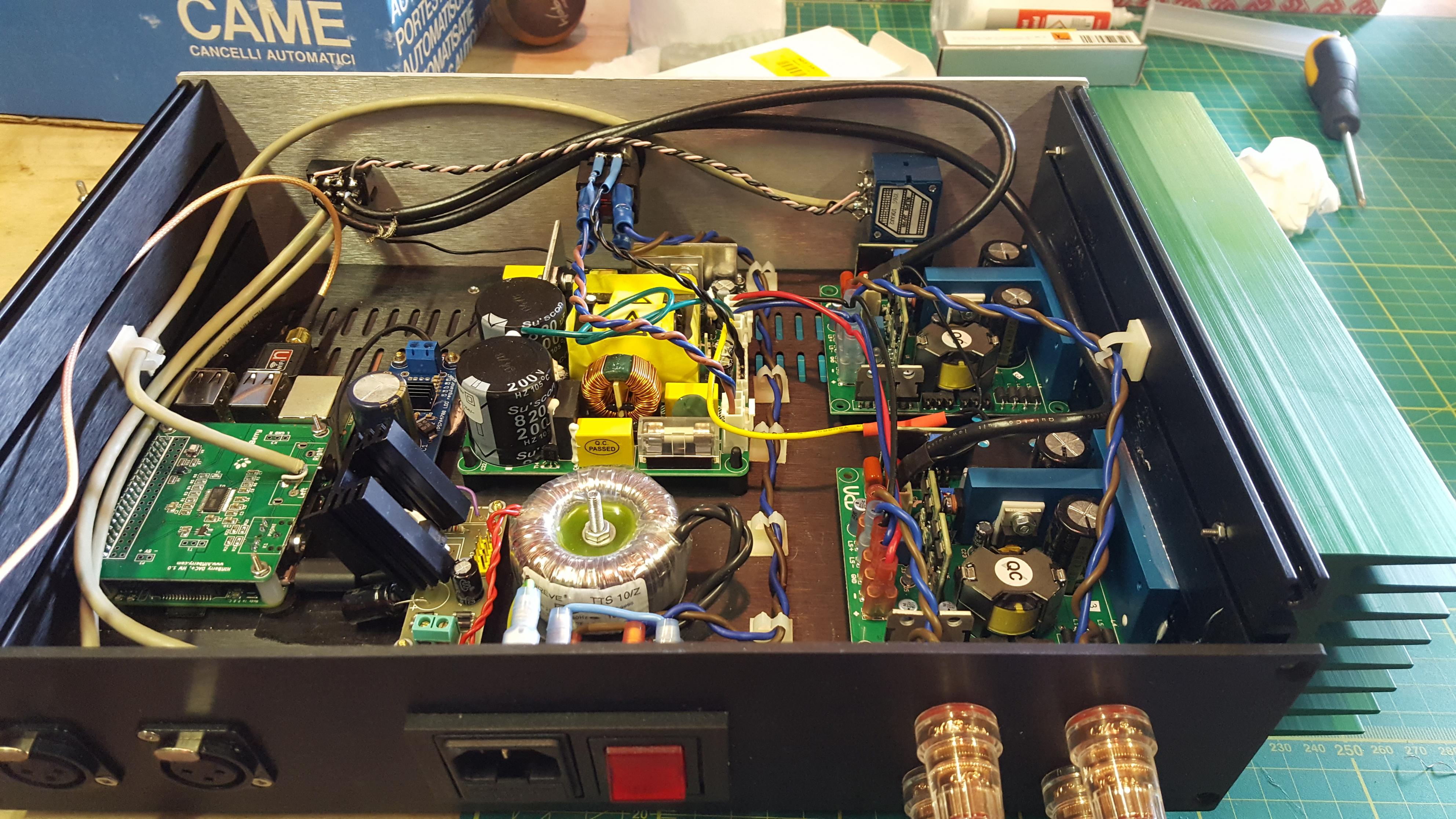

Network attached UCD400 Class D
Thanks to everyone who held my hand through this project, particularly with respect to the Pi Power supply and the selector switch. Oh and thanks also to Jeff Willing for kindly offering his time with CAD.
Most of this was painting by numbers and time spent trying to understand and researching what I was actually painting! Built a tube pre and power amp with the help this forum previously and a few other kitchen projects.
So, two UCD400 modules and a SMPS 400 from Hypex, a Raspberry Pi with Moode running, an LDO TPS based regulated supply for the Pi (Thanks Ales, Mravlca), an Alps 10K pot, a DP4T selector switch and a beautiful LED lit power switch from Schruter.
A few issues with the Pi supply over heating initially which is why you may notice the transformer change (which improved but not solved) and the addition of an 8V pre reg circuit which I intend to loose once I have a suitable transformer.
The sound.... very nice indeed... close to my ecl86 baby huey tube amp but with tighter bass which I enjoy but more clinical in the mids / tops which I don't enjoy as much as the tube amp.
Hypex recommended a preamp for the Pi so I had a simple NE5534 buffer to put between Pi and UCD but I ran out of space and time and the sound for the network player was very good without it (Would definitely be better with it though).
The switch selects between Airplay (Pi / moode and Unbalanced) and XLR Balanced. The pot only controls volume for the Pi.
Chassis by HIFI2000.... obvioulsy

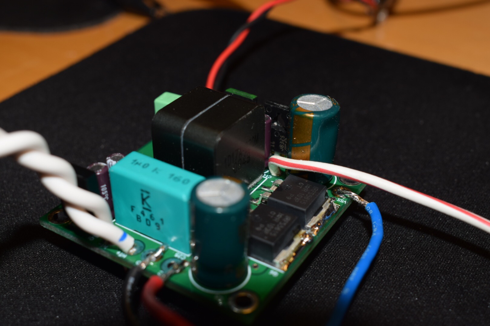

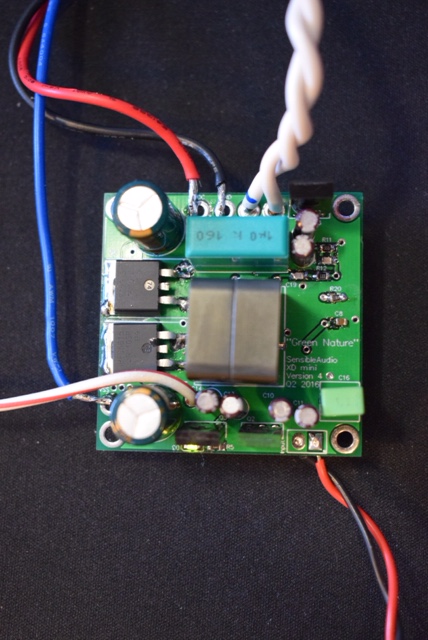

Green Nature v4
Latest version of my 5x5 cm 100W self osc amp. pre and post-filter fb.
Still based on OP275, MAX913, LM5401 and IRFS5615
From v3 to v4 I changed the 3 transistors for the voltage regs to BD139/BD140, to lift some heat away from the PCB ..... on version 3 they heated up everything on the board .....
The PSU transistors still get hot of course, but now placed in a way where they get more air flow ... and also can be mounted with a small heatsink or down to a alu back plate .... but running ok on +-40VDC
Hmmm, after running v4 for a little time, I must admit that the board/coil is still heating up. I know it is not the coil, as I have previously tried mounting it off board, so only thing left is the driver (LM5401) mounted just beneath the coil on the other side of the pcb.
It is not critical, but could have been a little better. Will try to lift the coil a few mm to get a bit of air beneath. .... still learning 🙂
Thanks 🙂
Only using it for a small office sub yet.
Next will be one more channel for stereo and using a Connexelectronic 240W SMPS.
.. So I'll get back with sonic impressions later 🙂
PS. the heat is not a big problem. But limiting the design to 5x5cm makes it more of a challenge 🙂
