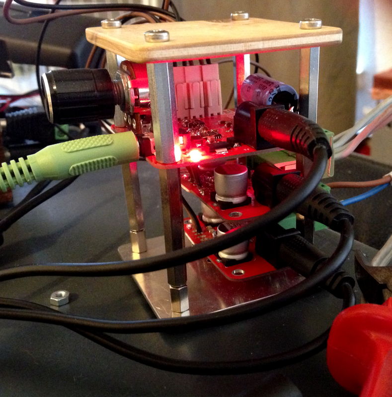

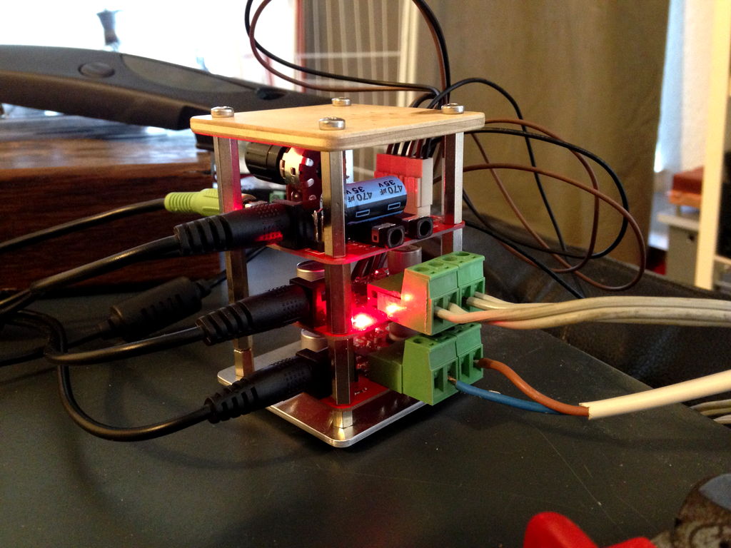

"200W" Stack, 2x50W + 1x100W TPA3132D2 with active X-Over (200Hz Linkwitz), powering my mobile Boombox. (2x 8" Beyma 8AG/N + 1x 12" MHB12 Sub)
Beymas at 26dB Gain, Sub at 32dB, PVCC=20V.
SPL at 2m, (C-Weight, slow, lp):
104dB, 122dB peak

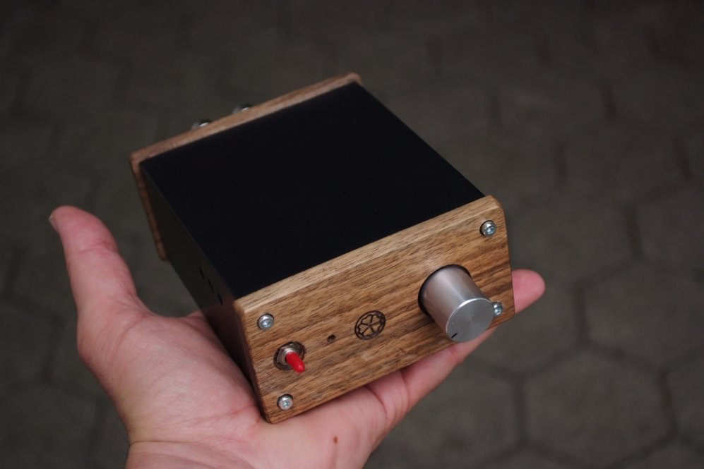

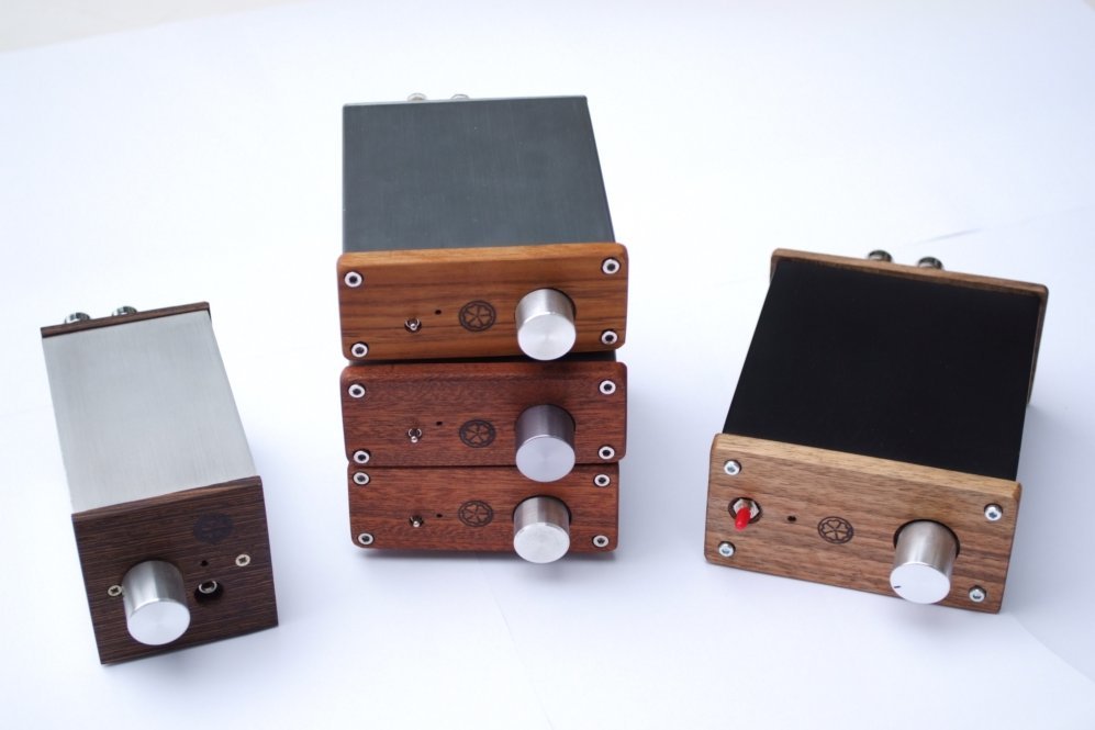

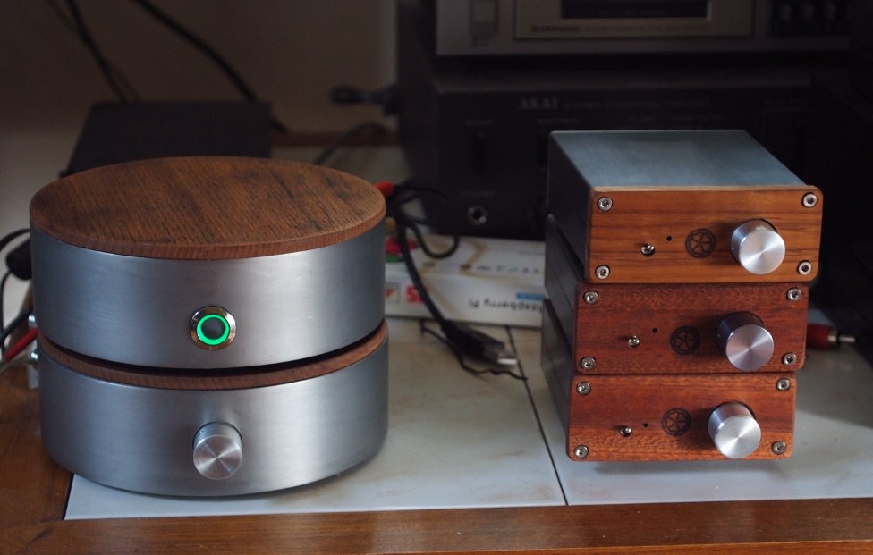

Been busy lately with various TPA3116 and TDA7498 amps 🙂
The first photo shows RasPi server + TPA3116 amp in round cases - I've been working on these far longer than expected... 🙁
