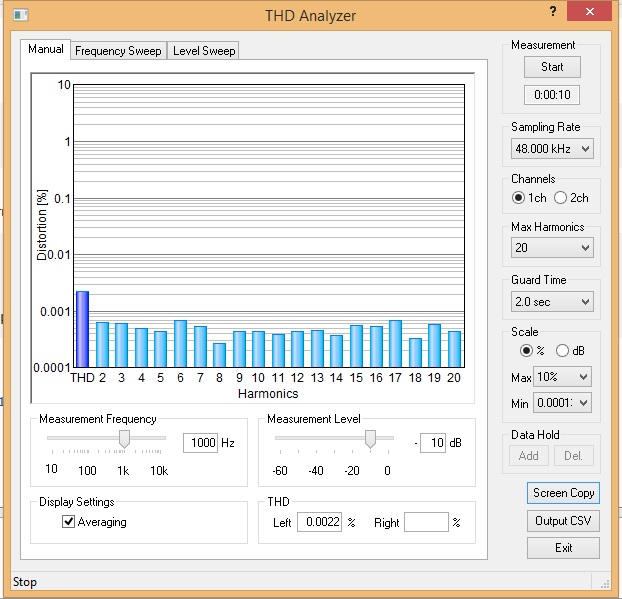

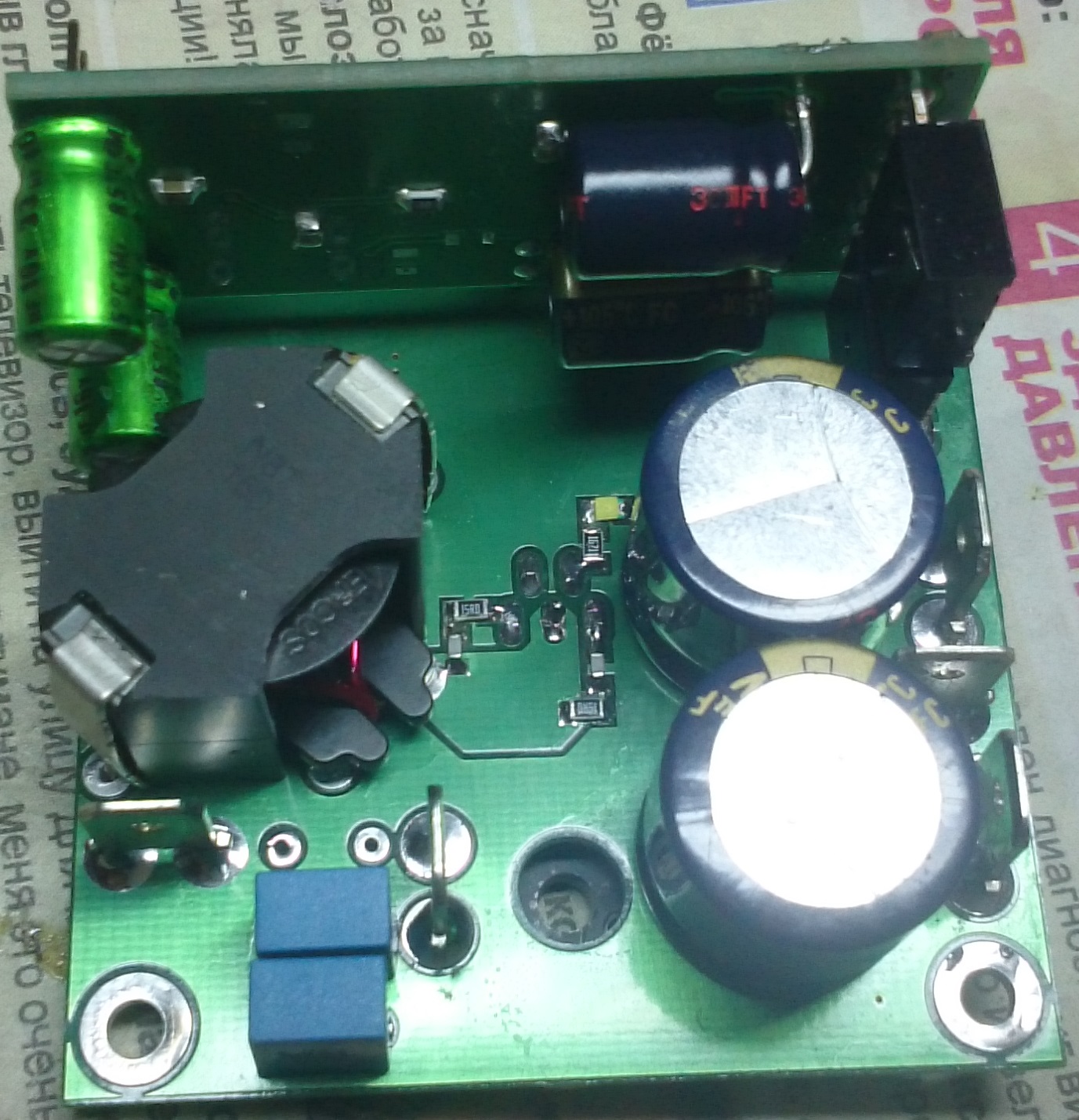

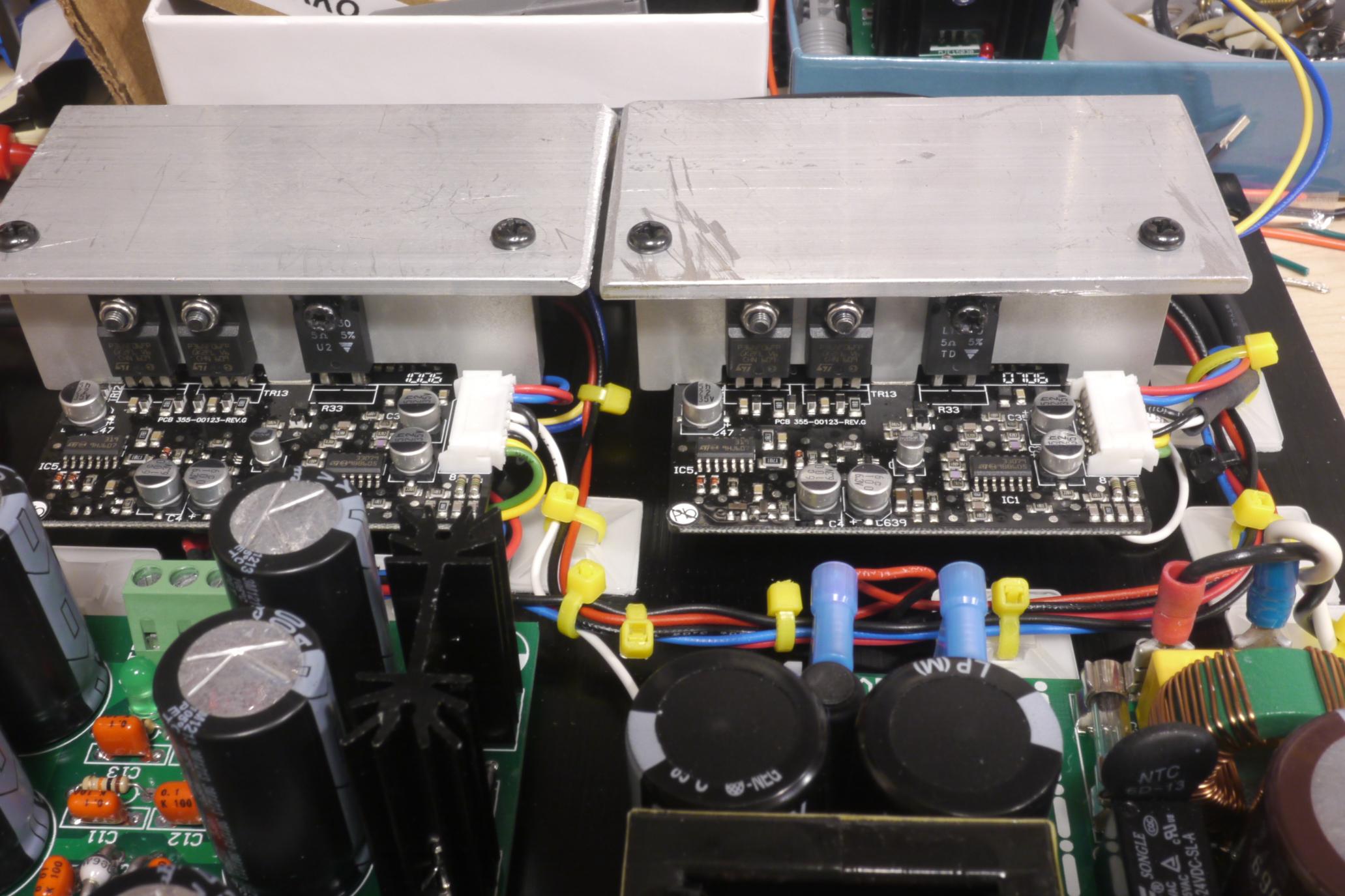

My nearly UcD+ integrator amp and measurement

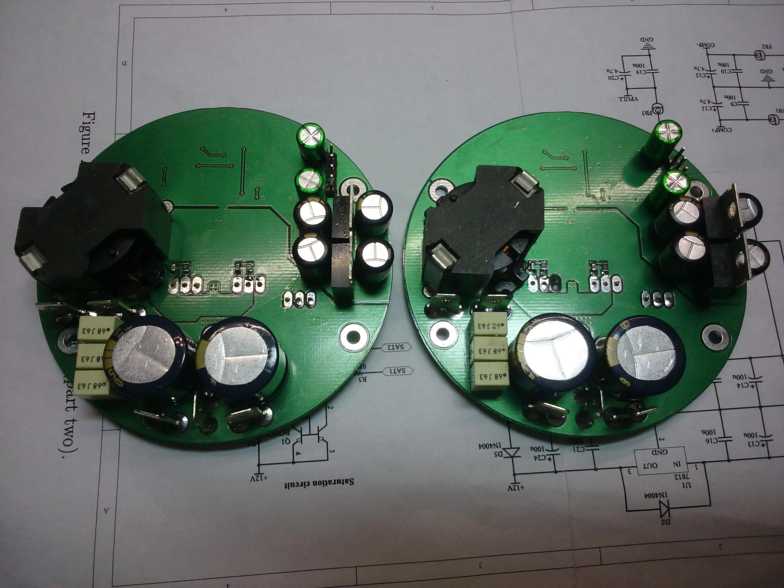

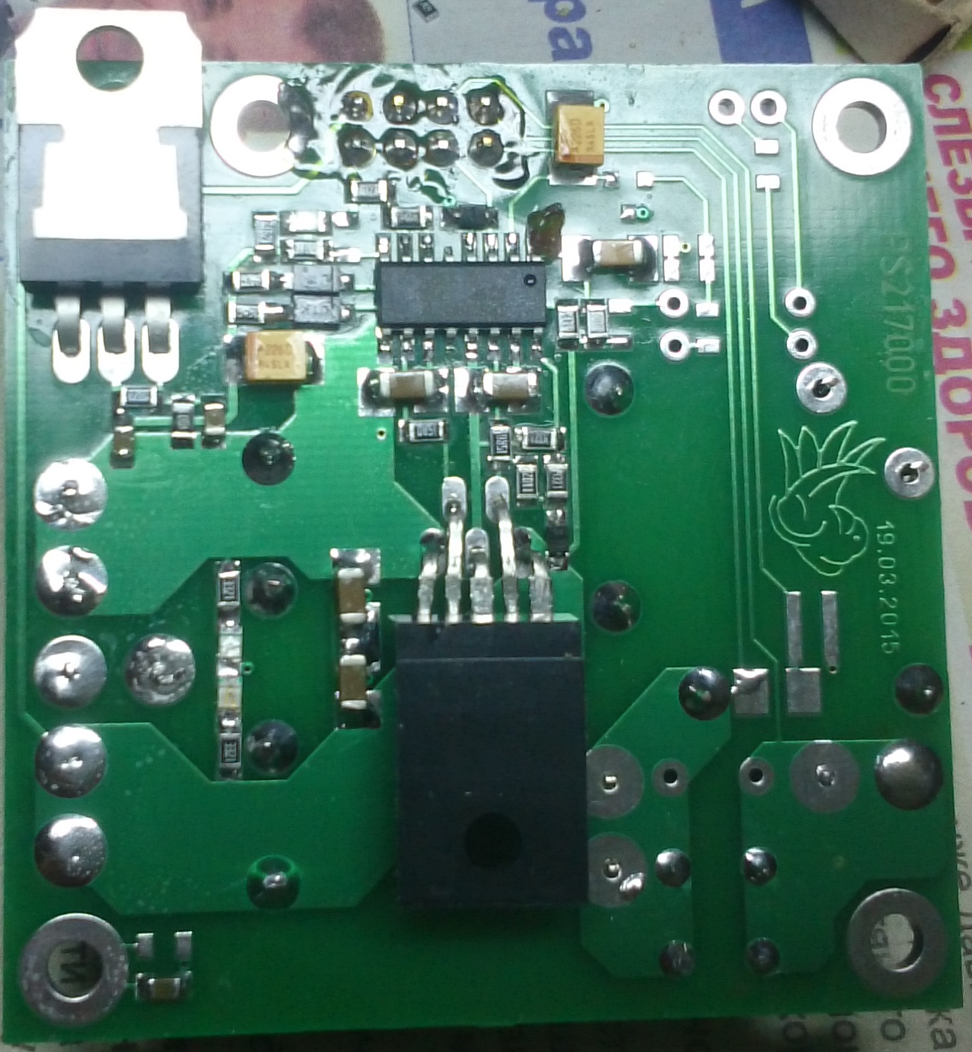

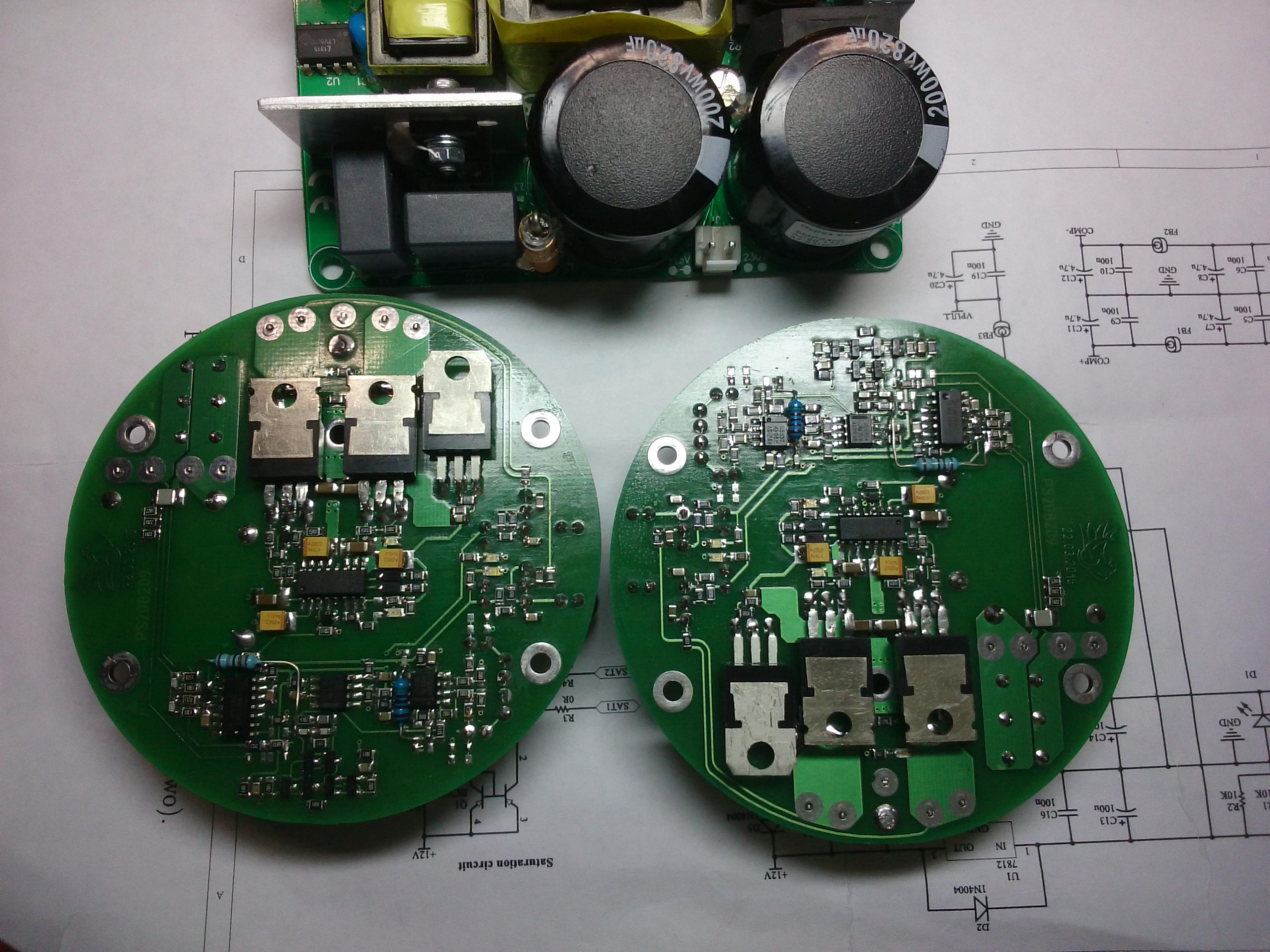

So you designed your own amp by using the basic principle of the patent by Boström / Abletec and subsituted the antisaturation circuit by the more elegant and lowest distortion antisaturation circuit from Kemp?
Nice. Definitely that's worth a new thread.
Circle amp using cheap idea from Kemp, not symmetrical sheme.
In photo amp using basic principle of the patent by Boström / Abletec and using
comparator and saturation sheme from Kemp paper.
