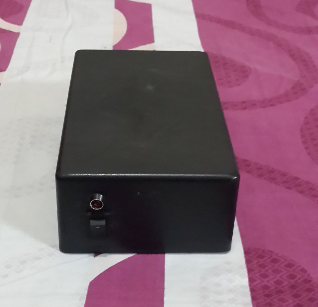

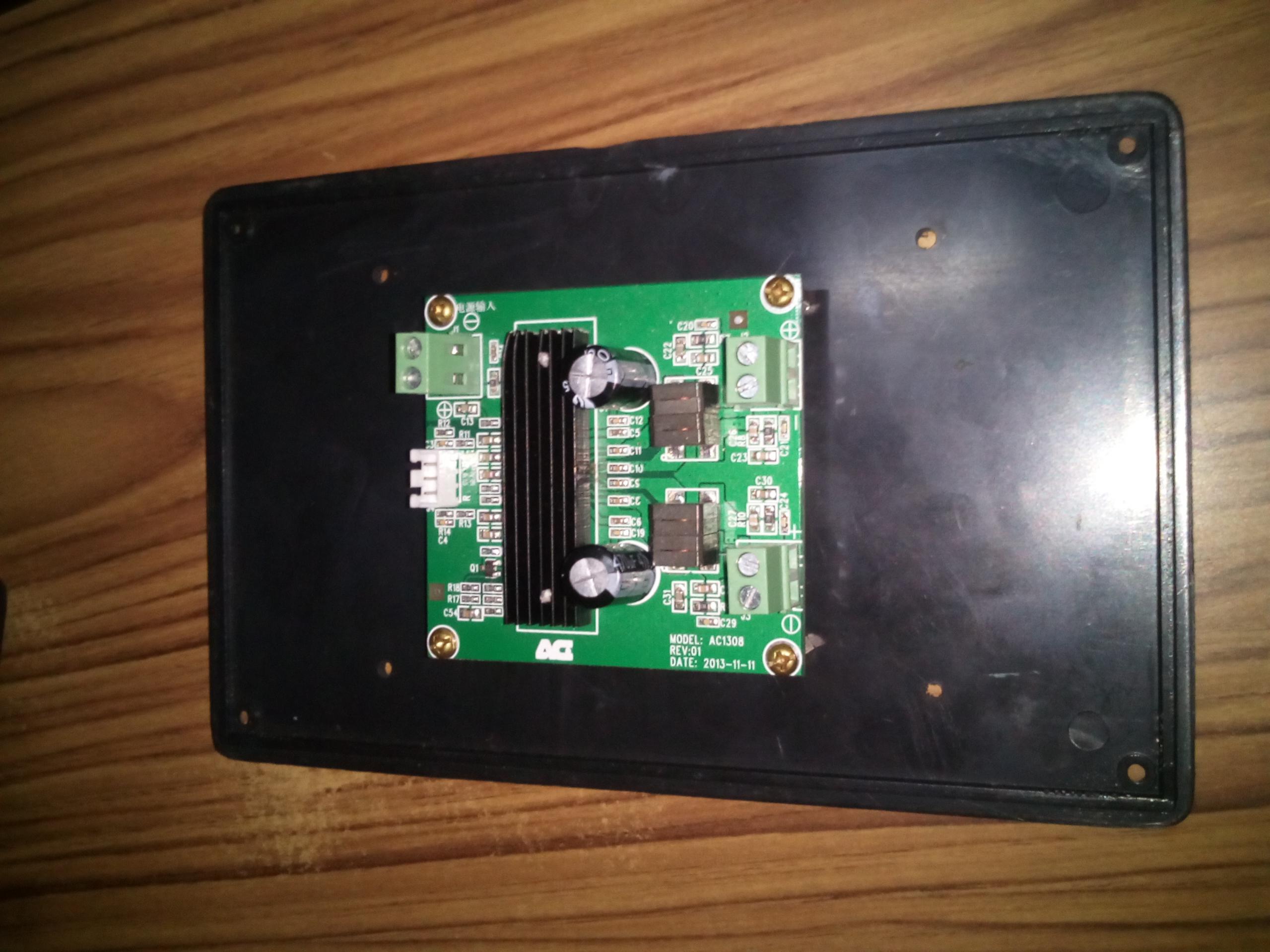

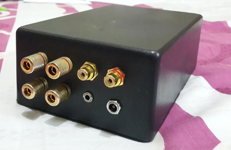

Hope I haven't already shared this: TPA3116 in a $1.99 Ikea picture frame case bolted to an Astron linear regulated PS.
my 2 cents

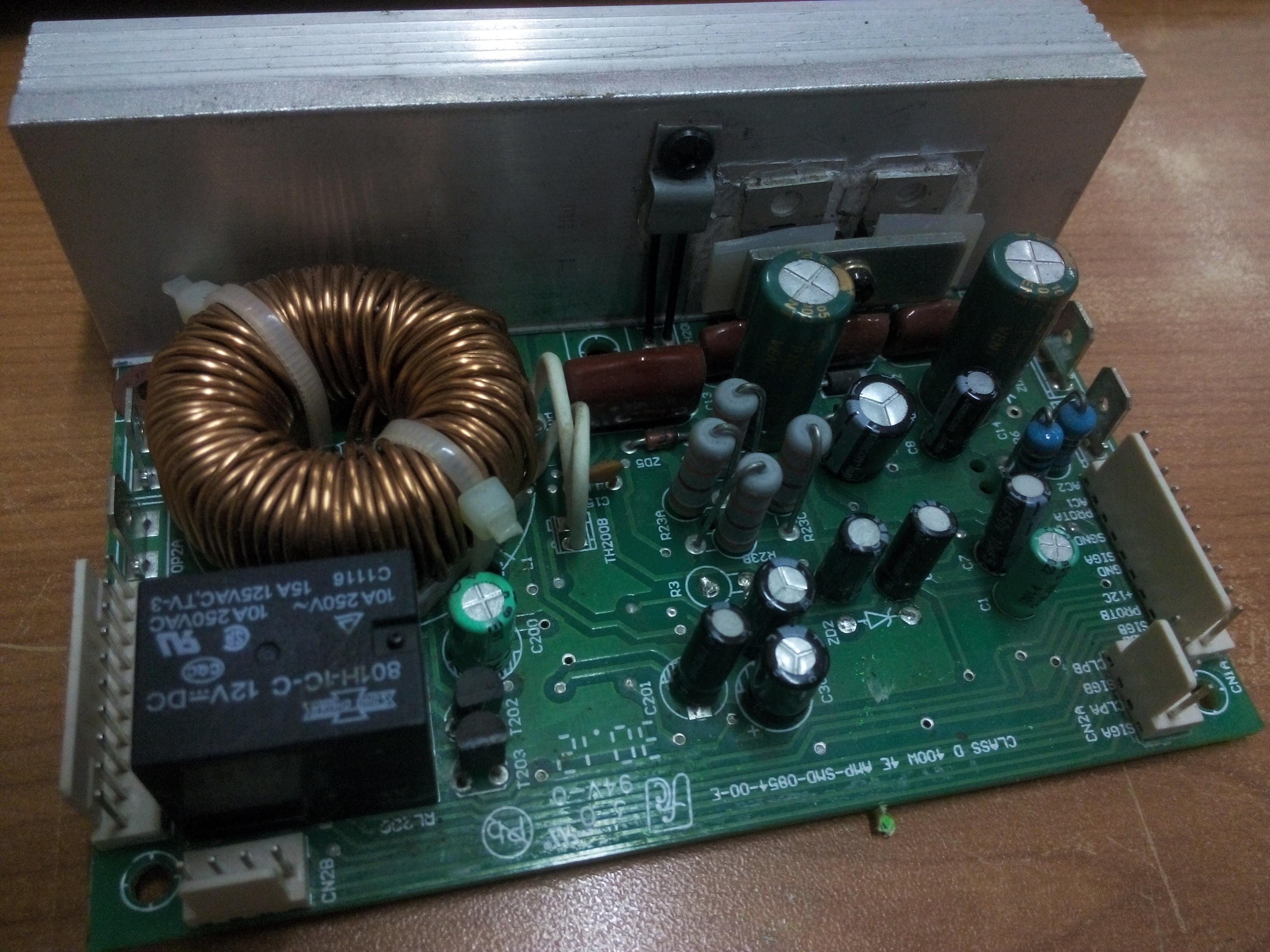

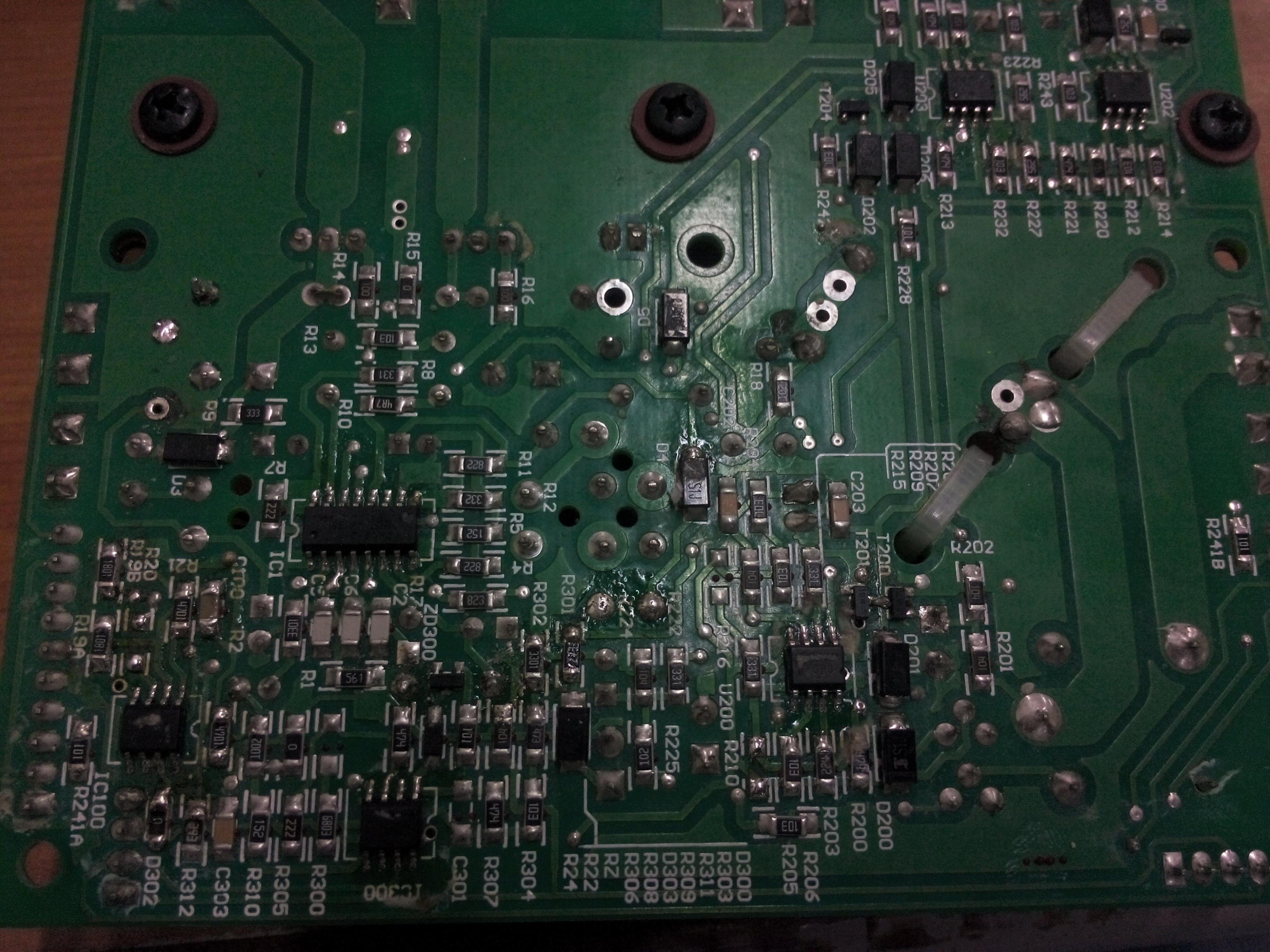

200W @4E has a flat response from 20hz to 20Khz with a slight peaking above 35khz ,it includes DC- protection ,clip pop removal , thermal + shortcircuit protection,signal presence and clip indicator with a option of interface with a VCA .
next attempt 1200W @2E
cheers
