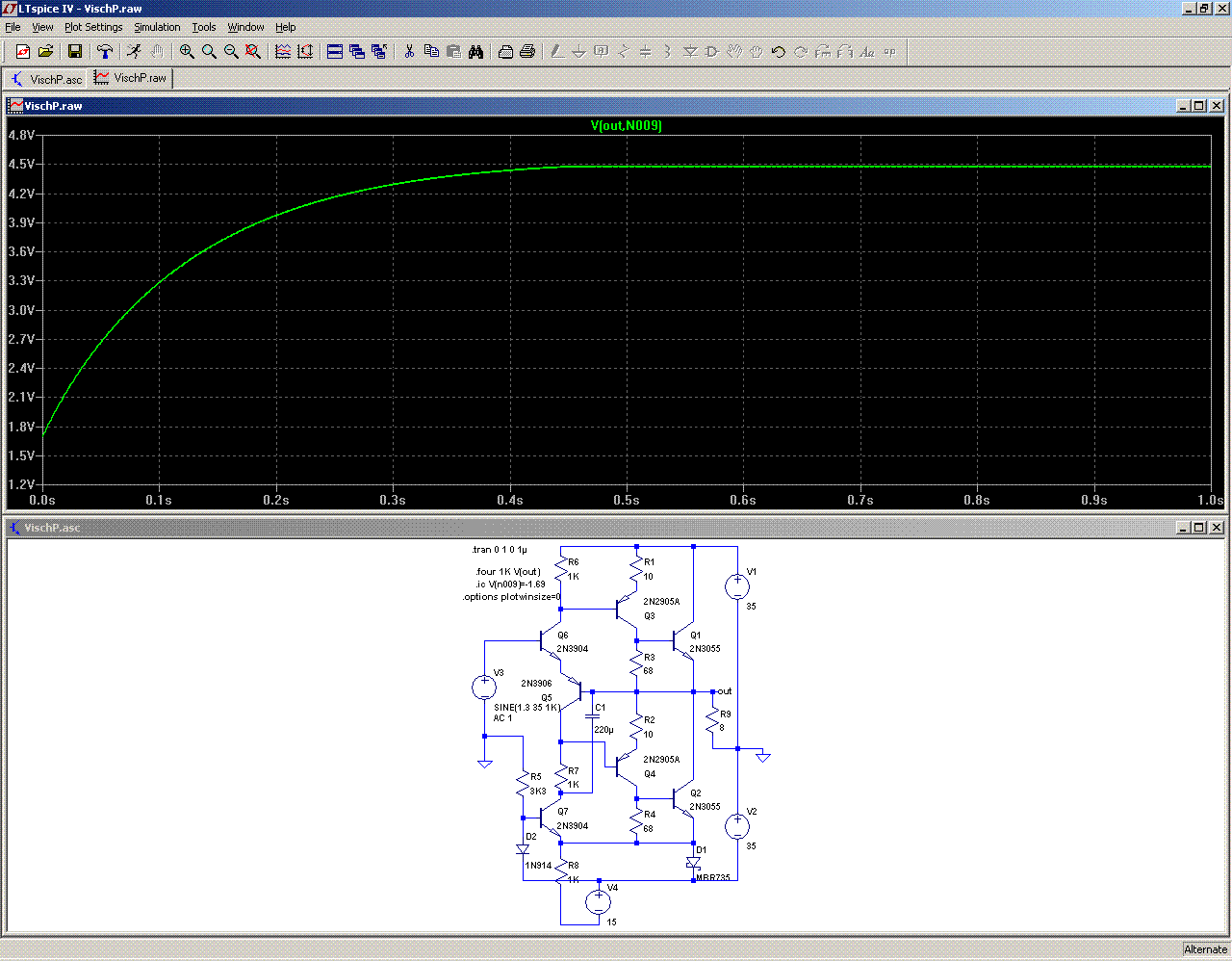

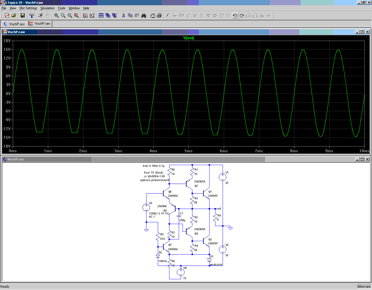

Coming back to the original Visch circuit, it does suffer from pretty nasty dynamic artefacts:
The sim shows what happens when a significant level of signal (15V peak ie. 25% of nominal power) is applied after an idling period: the .ic statement defines the voltage across the hold capacitor, 1.69V when idle.
During the first few cycles, the initial Iq of ~50mA is insufficient, and results in clipping of the negative part of the waveform.
After some tens of ms, the Iq rises to 650mA, and the clipping disappears.

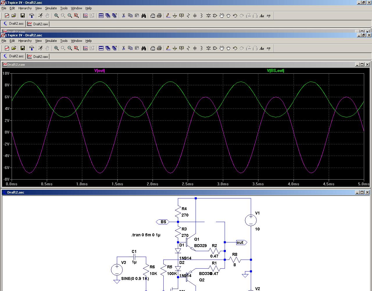

It isn't:

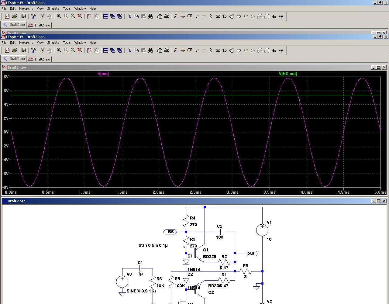

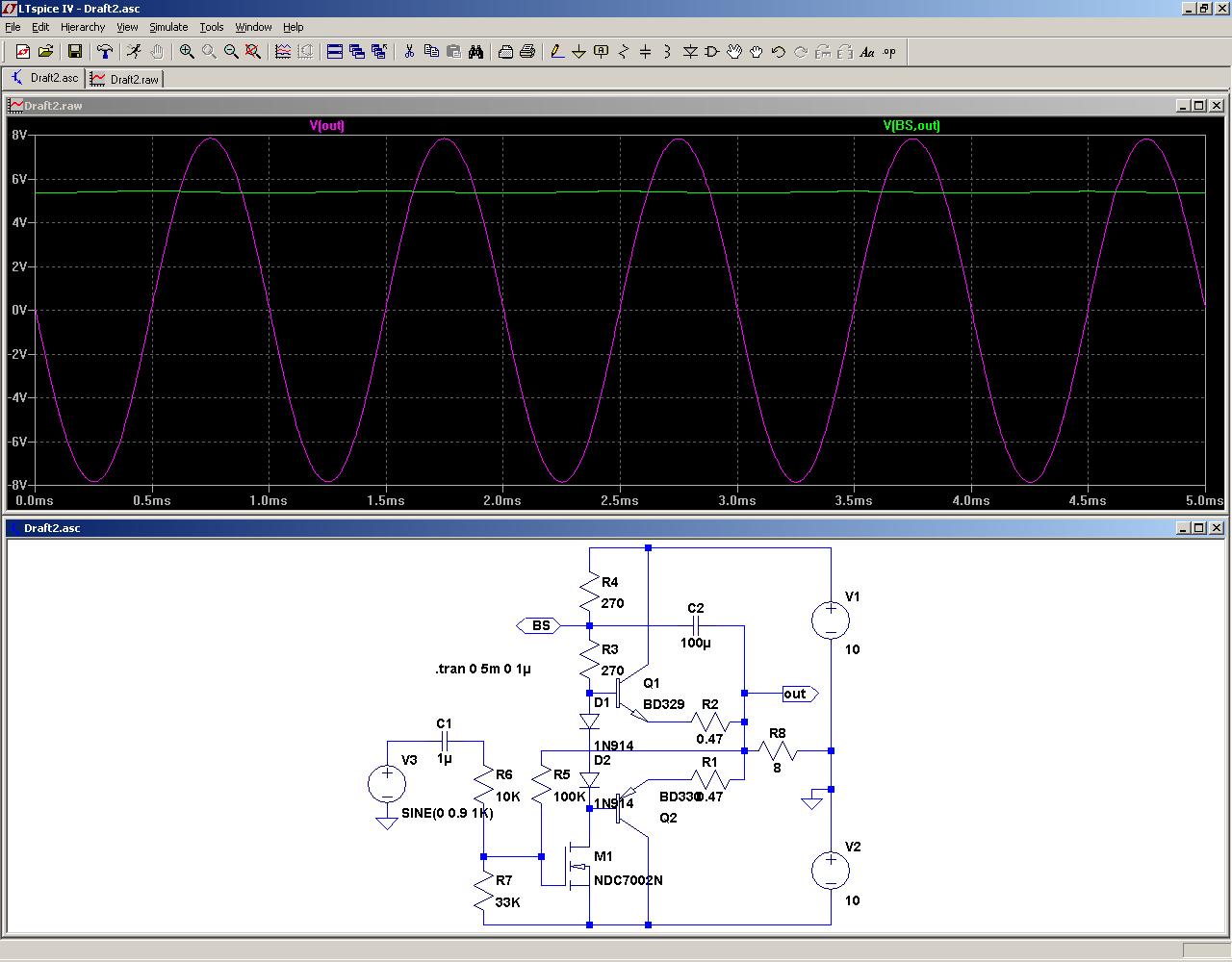

In the (crude) example BS1, the amplifier is operated at its maximal power, with a bootstrap capacitor of normal size: the voltage across the cap is centered about 5.4V.
BS1idle shows the no-signal condition: C2 now has a stable 5.4V voltage.
There is no difference, because the circuit is linear: the average potential on <**> and the average potential on out> remain identical, independent of the signal level.
The cap has initially a charge according to C*V.
This means that the CV product remains constant, provided the capacitor is large enough.
Thus the contradicting requirements are according to the polarity of the transient signal relative to idling. Exactly a bootstrap functions perfectly if the amp always idles.

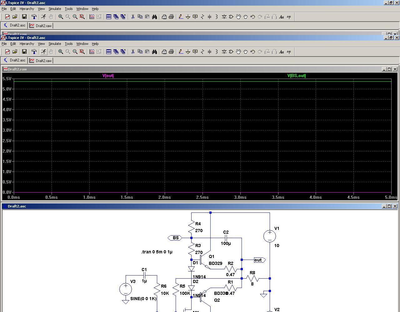

The only contradicting requirements are that of size vs. performance:
Hicap shows an extreme, with 100 farad capacitance, and locap shows the other extreme, no cap at all.
Ideally, C2 should be replaced by a battery, there would be no LF response issue.

I refer to the Vish schematic. Every bootstrap cap has to deliver current ...
The bootstrap cap must supply the 15 mA when the current source is off at negative swings and is recharged by the current source. With pencil-and-paper methods I cannot confirm the effect shown in the simulation. I will attempt to find out "who is wrong".

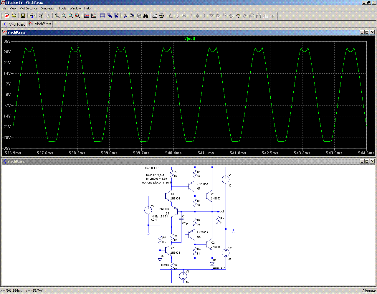

The capacitor in the Visch circuit is not a bootstrap. It is an analog memory element, holding the actual Iq setting.
The charge and discharge paths are entirely non-linear, and the reasoning pertaining to a bootstrap capacitor cannot be applied.
The maximum negative swing is ~30.5V, and this shows that the presence of the capacitor does nothing to improve that aspect: see the clipping example.
The circuit needs about 500ms to reach its full amplitude, and at that time, the Iq amounts to ~2.2A.

Well a bootstrap capacitor is supposed an analog memory because it is assumed that
q=CV= const and therefore the voltage swing is transferred in full.
However every bootstrap cap must supply current and must be recharged. Therefore at low enough frequency the assumption does not hold. With discharge q decreases and V=q/C drops. This is why there must be something wrong with the sim. Initially the C is charged and if dq/dt=i=15mA leads to a V drop of dV that makes the clipping then this must be always so there is no reason for a "recovery". The "time consant"
of 500 ms cannot follow from iconst*C

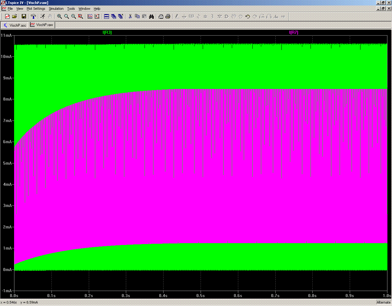

You may do a sim of i(R3)
I think I(R3) is only moderately interesting, because the voltage across R3 is constrained by the Vbe of Q1.
More interesting is the current in R7.
Q7, D1 and Q2 act as a sort of PWM modulator, sharing the 15mA between Q7 and Q2. The process operates in a closed loop and takes time to reach an equilibrium, and only part of this current is available to charge the capacitor.
