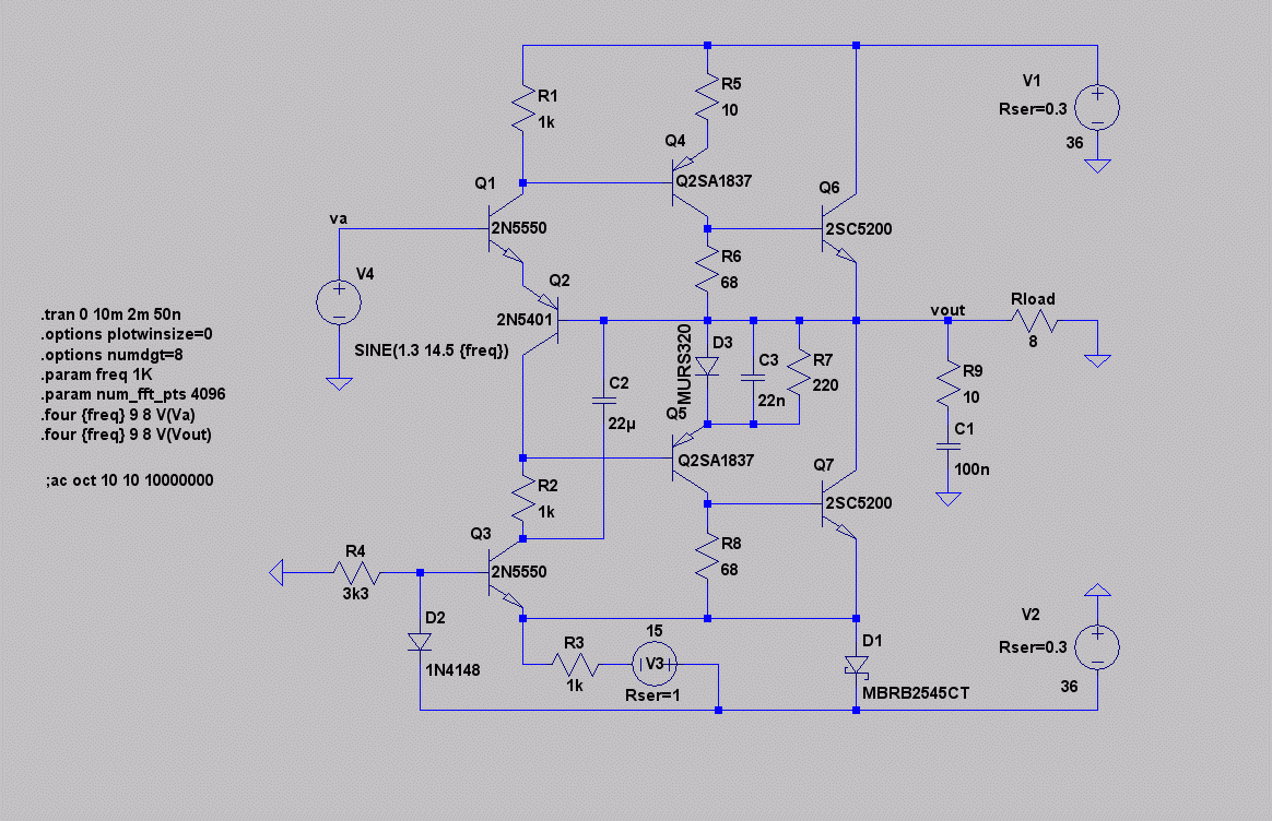

Hum...it is becoming a bit intransparent...could you provide the sims schematic?

No problem, attached.

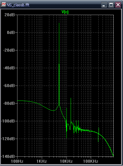

Total Harmonic Distortion: 0.004540% at +20dBU (14.5Vp) into 8R, a respectable figure.
R1, R2 and R3 are all critical; current through the RC is very touchy. The circuit has considerable OLG at the RC outputs; oscillation is a very real issue yet compensation is not used.
I also found, unsurprisingly, that reducing the bootstrap seriously increased distortion at 20Hz. A compromise at around 100uF seems best, but empirical adjustment would be needed as there will be subjective effects on the bass due to the distortion (up around 0.12% with 22uF).

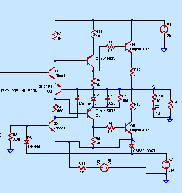

Why is there no Baxandall clamp at the emitter of Q4?
While both upper and lower device pairs are complementary feedback pairs (Sziklais), the output from the top is taken from the emitter of slave, whilst at the lower pair it's taken from the collector of the slave.
These circuit conditions are very different, with the upper pair used as a phase inverted, and the bottom with no phase change. The upper output device is used in emitter follower and the bottom in common emitter, so there is a requirement in the bottom pair to compensate the absence of a hefty BE junction between driver and output device, hence the Baxandall diode on one side but not the other.
Does it make any sense to have about 100 Ohms resistor between v out rail and the junction of the base of Q2 and C2??
If you mean a base stopper, maybe.....

The schemo contains at least 2 errors: emitter of CCS shorted on emitter of output transistor, and 250uF Miller compensation cap instead of 250 pF one.
That capacitor is a bootstrap, not a Miller compensation.

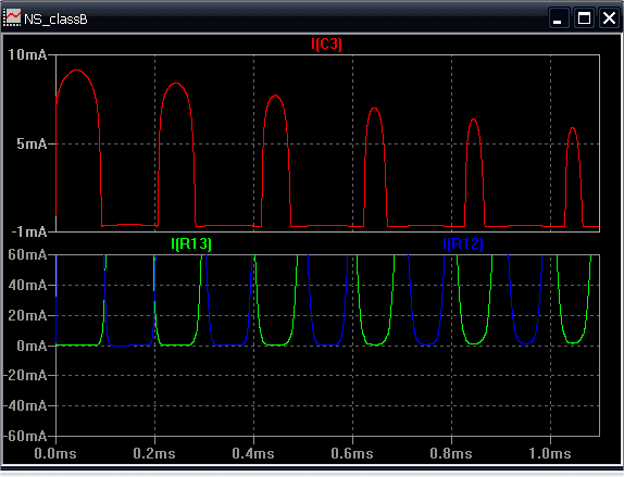

Ah yes indeed that explains how no crossover distortion appears even with class B setting of the power BJTs. It appears the same design idea is realized in the old QUAD 303? But why the bootstrap? And indeed the emitter of the current source is forced to -34.4 volts same as the base. If I hadn't built in 1976 I were sure it cannot work but since I have I see it works...
Say "no crossover appear even... " etc. require a bit of explanation because iinstead crossover distortion exist but it's heavily counteracted by strong local NFB factor applied on both halves of output stage. At low frequencies the circuit should work fine, but at higher frequencies, where on.off speed limit of output devices are involved, im not sure if it work very well same as it work at lower frequencies.

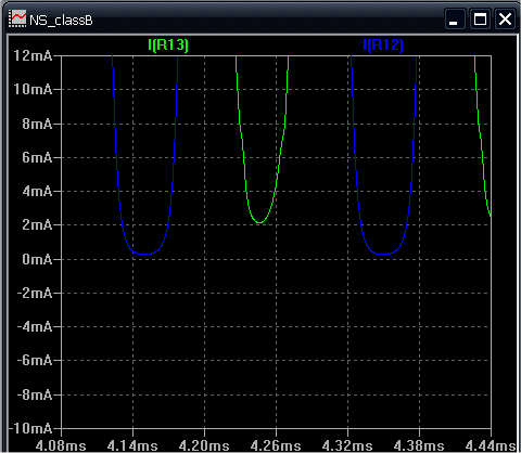

I think it switches all right...... maybe a false dawn, BUT, the transfer kink at crossover is extremely well handled, as good as anything in AB I have ever seen.

No, not a false dawn. Just a different form of a concept yet largely applied: use of big NFB factor in order to clean away the most of crossover distortion - and not a really "non-switching" circuit as claimed by its title. The real interesting thing is not the undue "no-switching" attribute but the way of applying to a quasi complementary outtput stage the strategy usually applied in complementary triplet stage (or Sziklay output boosted stage as i prefer call it), where the output stage beneficiate of a dedicated, local NFB loop for linearizing it and its crossover distortion.

Hum...if no triplet is ever turned off it doesn't switch. Or better shouldn't.Peter,

That is the circuit idea. Hence the NFB factor remains constant around signal zero crossing. At least as far as I understand the principle now. So the focus is now on oscillation. Is the principle of action dependent on frequency ( yes)

The outputs definitely switch, but the crossover is immaculate, really clean. I'm not sure that switching needs to be a problem if crossover is really well handled.
