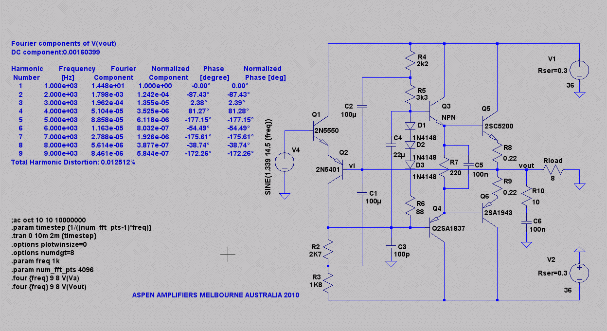

Complementary Class AB Power Buffer
Here is the power buffer rearranged for complementary output drive.
The Rush Cascode input stage doubles as the VAS and uses shunt compensation since there are no phase reversals through the signal path. The twin bootstraps and input offset set DC operating points. FR is very good, flat to almost a MHz. Distortion is passable, not wonderful, but this would sound pretty nice I believe.
Quiescent is around 70mA as designed. RC current varies between 220uA and 2.7mA. This causes variations in Vbe at Q1 and Q2 which contributes to distortion but it's largely H2, which at 30Vp (56 watts into 8R) is around 65dB below the fundamental.
If someone decides to build this I'd be interested to hear from them. Of course, it goes without saying this would need a tube or other voltage amplifier in front of it; Zin is suitably high, many tens of kilohms.
Hugh

Ok I will sooner or later make one however the quasi version. I have eventually managed to open the case of the amp. The devices Tr1, Tr4 of the original schematic are BD1.. types in SOT package mounted in thermal contact with the heatsink. This could have been an advice in the lost original article in Wirless world. For the intended use, drivers in active speakers, thermal stability is an important issue.
The 2SA1837 are not available I have a bunch of 2SA968

Balaboo, thanks for your observations. Like most circuits, this is a hotch potch of different ideas thrown together, but it is unusual and it peforms well. It does seem to have a lot of phase shift, which may not be good, however. Neither does it handle loads less than 8R well because of negative half cycle current limiting, but that could be fixed with a pre-driver. I measure loop gain at almost 67dB; this explains why it is good. It is NOT a conventional feedforward circuit, although it does enjoy a lot of negative feedback.
I have not built it yet. I'm hoping someone else here may do that.
Hugh

I agree it is topology. I will build the quasi version but am worried about its thermal stability. The NFB will not control thermal runaway. This is an issue because in an active speaker the size of the heatsink is determined by the overall design of the speaker.
Hahfran,
Replace the three diodes and resistor with a simple npn BD139 Vbe multiplier, mounted atop one of the output devices. Use 1k5 from collector to base, and around 1k trimpot from base to emitter. Use a 22uF cap across collector emitter; believe me, this will stop thermal runaway.
If you wish, you can also reduce loop gain by inserting a 22R resistor between the two emitters of the RC. This could also be useful.
Hugh
Hugh
strange amp...
it has none of the advantage of current feed back topology,
as well as none of those of differential inputs,
despite mimicking the two...
in respect to hugh s schematic, Q1/Q2 can be seen as a
differential, no matter that the two transistors
are complementary...
feedback is returned to the base of the second stage,
making this amp a voltage feedback one...
the difference with a classic differential is that Q2
has no other current limiting that the one provided by the
collector s resistor s network...
anyway, Q2 s current is highly variable, thus creating lots
of distorsion if the available feeback is not high enough..
i think that it s an inferior design compared to the classical
current feedback design using the same number of active devices..
this latter was largely documented in some motorola s ap notes,
and is capable of -100 db distorsion at 10KHZ, with monotonic
deacrease of harmonic products..
for useful lectures, here again a link to rod s excellent description
of the thing....
