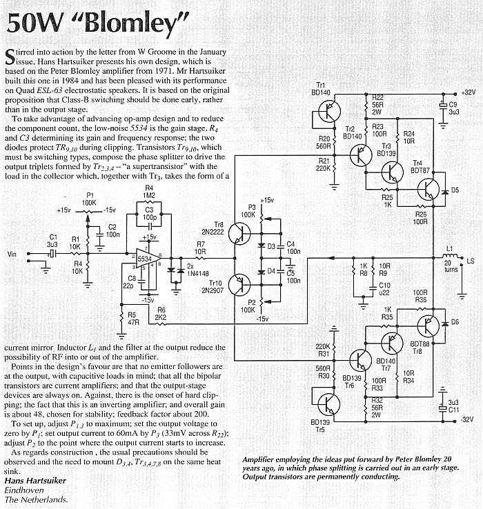

Ok I downloaded LTSpice but still having trouble with the results of .four they make little sense. What I found was the Blomley topology this topic is however already covered in another thread. The schematic of a Blomley curcuit by a Philips lab guy is attached ( contains some errors) it looks interesting. It avoids switching in the output stages. Further it features quiescent current stability dynamically. I don't know whether that contributes to sound however it is clear that the junction temperature varies
with power dissipation and so does the quiescent current. This won't happen in this circuit. Basically it is the same with tubes but there the plate heats up
and that hardly affects the cathode temperature.

Ah, yes, I too have this 1984 circuit from Hartsuiker.
I vaguely remember building it many years ago but finding it no better sonically than a well set up Self DEF type II. It is certainly clever, but setting up T8 and T10 is very tetchy and liable to change with temperature unless D3/D4 exactly match the transistors for tempco. I would prefer a transistor array, all on the same die for this purpose.
The output triples have gain, at Tr2 and Tr6, and the circuit clearly shows emitter followers, darlingtons in fact, as the output devices. This may explain why it's actually very good with high capacitive loads like the ESL63, a notoriously difficult load. But there are many, many devices from start to finish, and an IC; this makes stability only possible with a lowish fb factor, at only 46dB. The circuit is also push pull throughout and this tends to null even order, whilst doing nothing for odd order harmonics.
It's elegant, but I don't believe it's the answer. A single ended approach would be better, IMHO. That is why I favour the RC concept suggested at post #27.
Hugh
es agreed the splitting TR8,10 and D3,4 is a weak point but the general idea is interesting
because it shifts the switching point away from the power transistors. One would of course avoid the IC. One may investigate whether TR8,10 could be jFETS possibly cascoded with BJTs.
However according to ole Baxandall Symmetry of a Class B the circuit is not an emitter follower. Neither is the QUAD 303 triplet an emitter follower. (Also according to Baxandall
Wireless World sept 1969 ).
The weak point of the #27 circuit is still the thermal runaway given that in my case of active speakers the heatsink size is actually less than it should be. However the max. power is determined by the dynamic range the speaker should be able to reproduce.
I see no way to feed back a current proportional to the base of Tr4 that would solve the problem of thermal runaway. Otherways it were clearly preferred.
