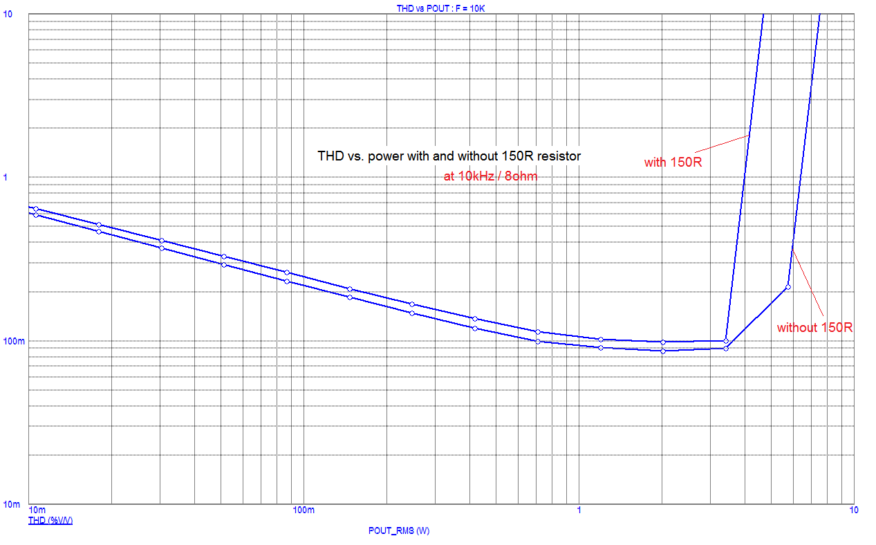

That is, maybe PMA doesn't see an improvement with 150 ohm because there is already more current flowing through the base-emitter capacitances than through that resistor when the circuit is going through the crossover region. I don't know, it's just a hypothesis.

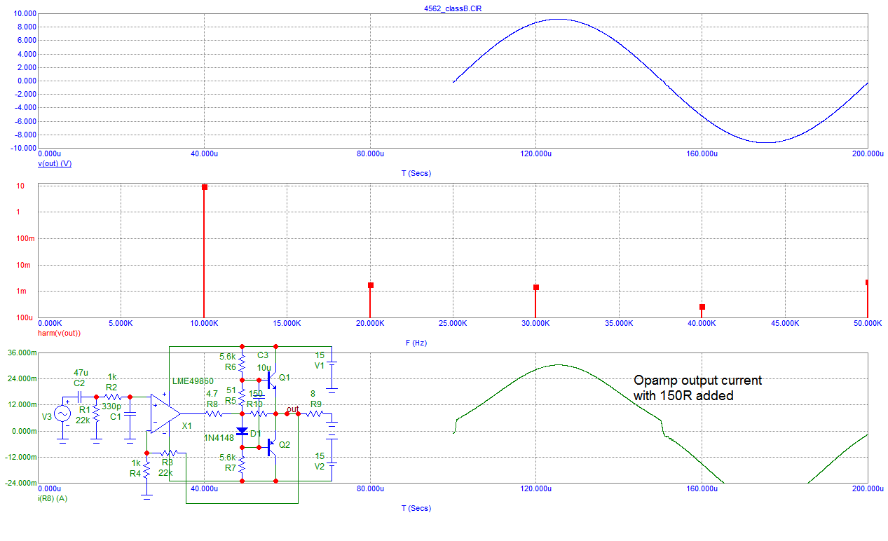

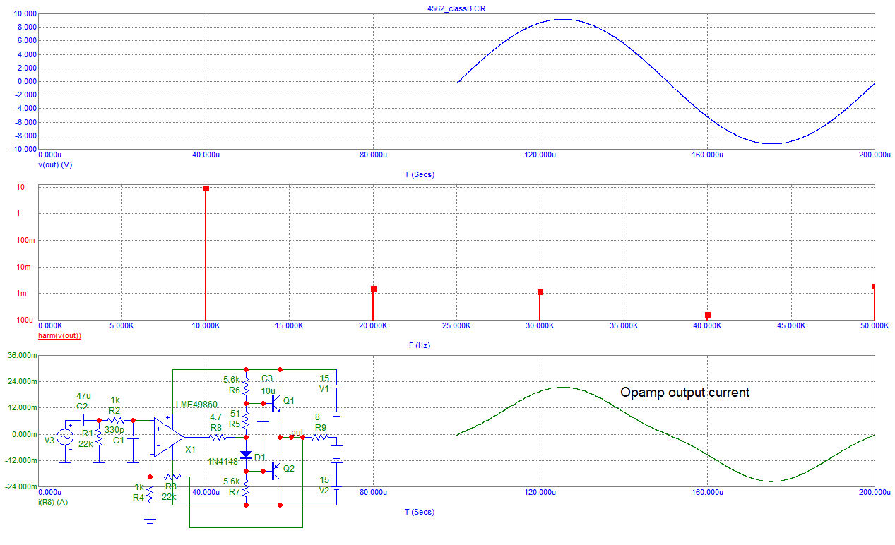

Plots without 150R, including opamp output current

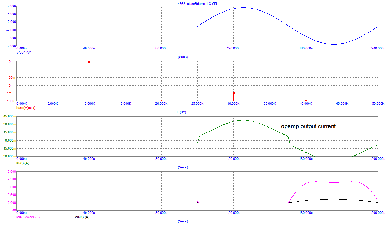

Plots with 150R
Comparison of THD vs. level at 10kHz, with and without 150R resistor

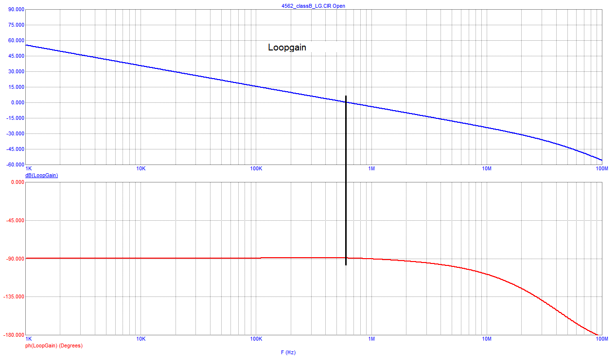

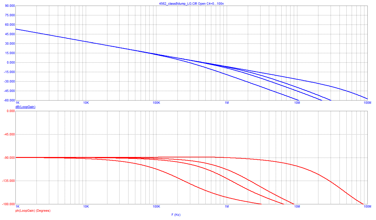

Loopgain stability analysis

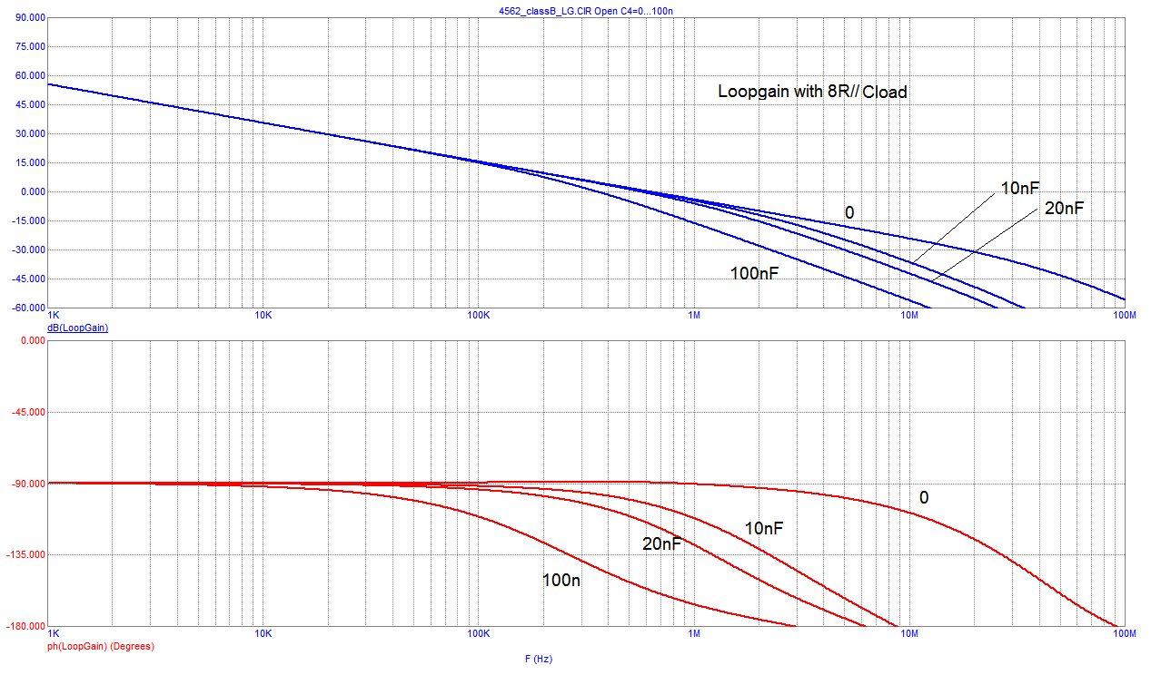

Stability with 8R//capacitive load

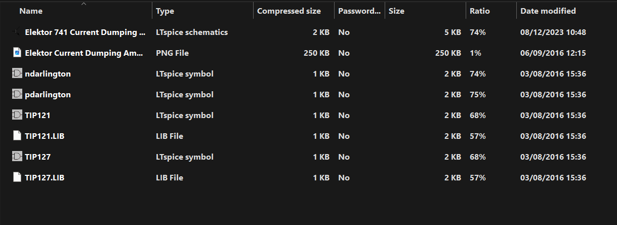

These are sim files for the current dumping' 741 amplifier. This fascinated me as a youngster.
I think it should click and run as everything is in the folder. The two voltage sources replace the diodes in the original and are the key to getting good performance by biasing the driver stage up to the point of conduction of the outputs.

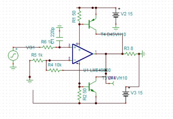

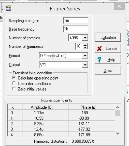

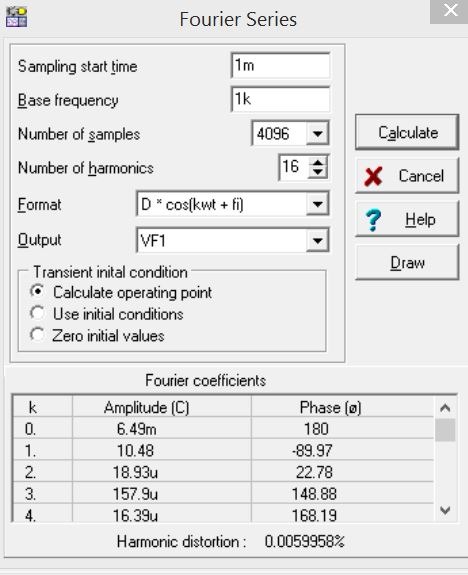

I don't see what transistors you are using. I tested the same opamp with chosen bjt and got 0.0003% 1khz 11v 8ohm.

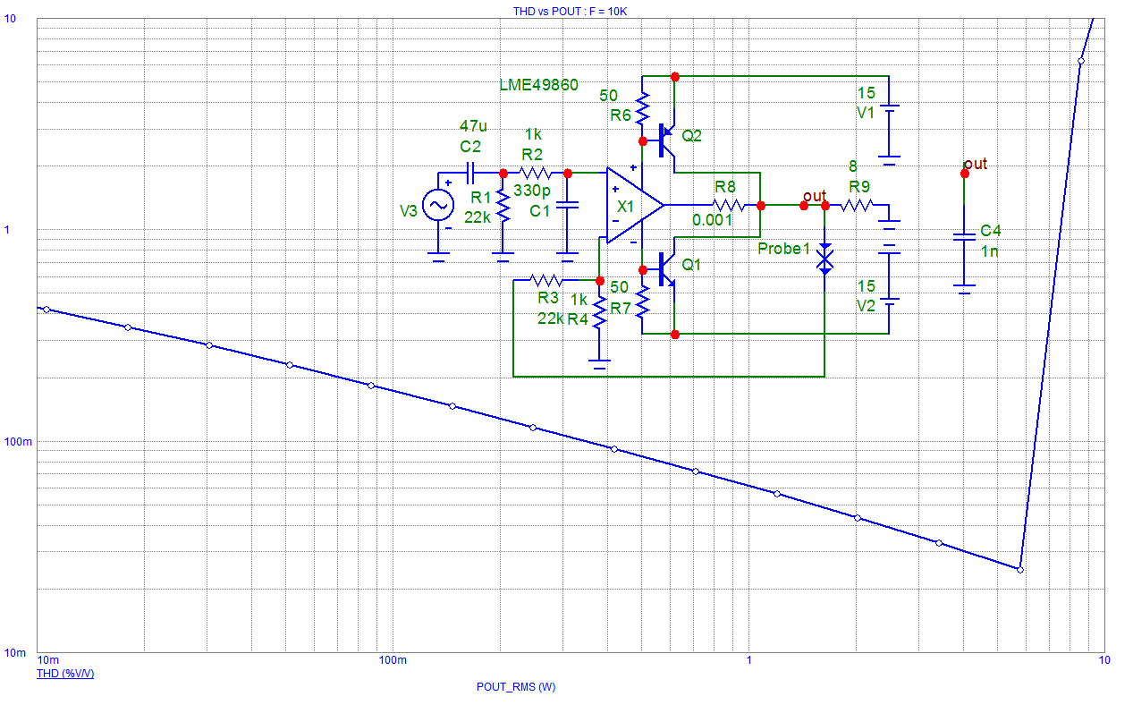

BD139/140. Microcap 11 Professional. You are comparing apples and oranges. I tested at 10kHz and gain 23x and you can see it from attachments in my post #48. You are testing at gain 11x and 1kHz. Loopgain at 10kHz is of 20dB less than at 1kHz. You cannot take two different test conditions and make a comparison. It does not make any sense. Best to build the circuit, if you want to be serious. Simulator models precision is limited.

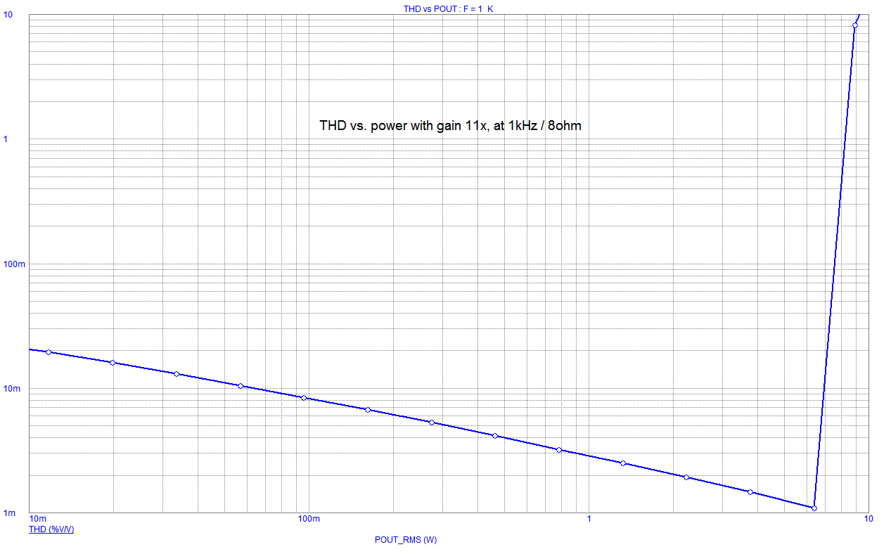

THD vs. power for circuit gain 11x, at 1kHz
Quite a difference compared to 10kHz THDlevel and gain 23x, right? We need to compare apples to apples, not apples to pears. Still, we can see inevitable underbiased class B issue.
And you definitely cannot get 11Vrms from +/-15V power supplies. 11Vrms makes 15.55Vpeak, +/-15.55Vp, which exceeds power supply range.
The d44hhv19&Co are not modeled correctly as they conduct with 0.4v Vbe. Adjusted cut off, using the LM4562, I still get 0.0003% for 1v to 10v, 8 or 4ohm for 1khz.
