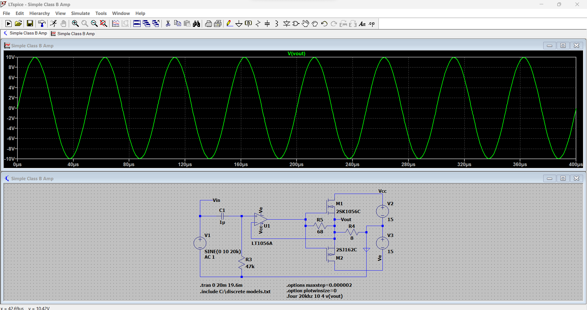

Class B Circuit Opinions...
Concept only. Use transistors with very low turn on volts (Germanium 😉) and scale the feedforward resistor such that the opamp output current is not exceeded at maximum output current.
Parallel opamp could work well here. Voltage gain set to unity to maximise feedback factor for correction. 20kHz shown.
Lets try Lateral FET's...

Hahaha yes I have much to learn. I am drawn to these dead simple circuits, even though they typically need improvement.
I will look into this current dumping scheme further.

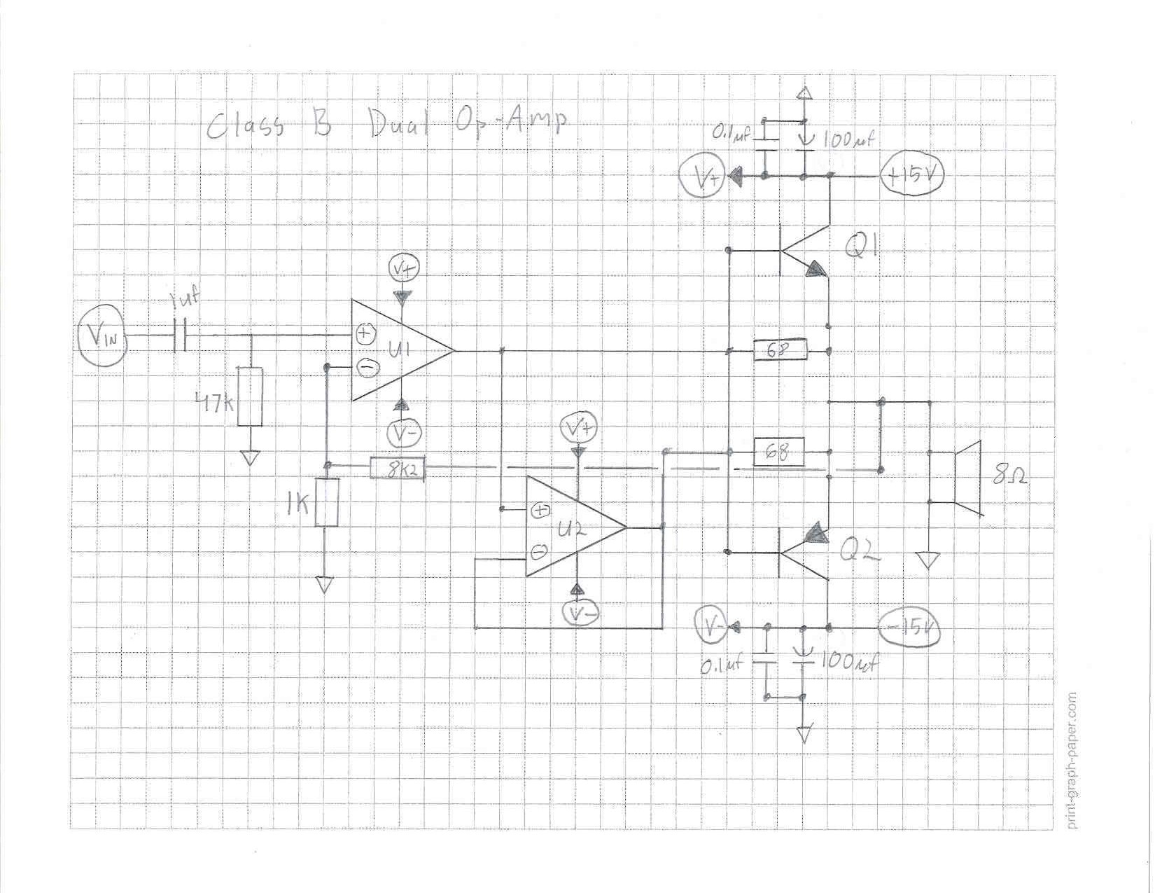

I have redrawn the schematic based on suggestions made by Marcel and Mooly. It might be a bit difficult to read, but basically I have used the lower value feed forward and feedback resistors as well as adding a a unity gain op-amp section slaved to the first one. Should the second op-amp output be connected to only its own 68ohm feed forward resistor, and not to the bases of the transistors?
It's far from elegant, but I want to see this circuit work properly with minimal changes.
If this circuit doesn't get close to a "hi-fi" sound, then I will look at adding diodes for bias or a current dumping topology.
I'd also like to try Mooly's version with MOSFETs, but I'll have to see if I have any suitable power MOSFETs in my parts bin.

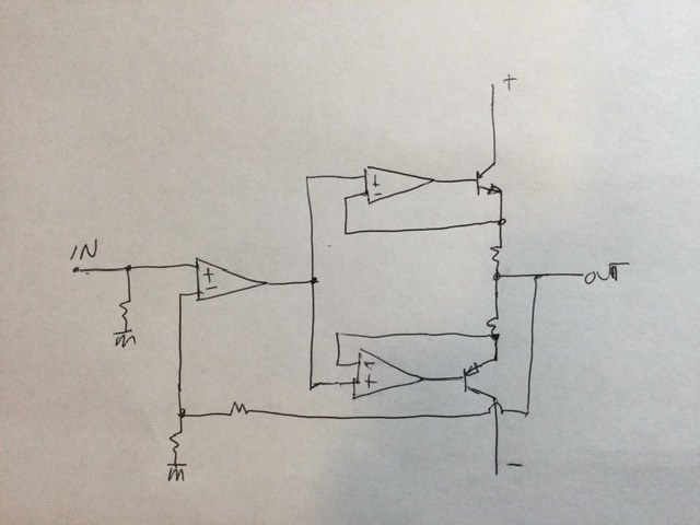

You might get away with this. May or may not be strictly class B, depending on the offset voltages of the op amps. But the offsets are far lower than a Vbe, and it will needs some emitter resistance to absorb the effects of th offset, which could result in a small bias current. It does require each output to be slaved to its own op amp, requiring three. Could get pretty decent if using R2R op amps. Kind of got the idea from the 1EF thread where they use power op amps to directly drive 0281/0302. In that thread, there was a bias stack inserted ahead of the buffers and run in AB.

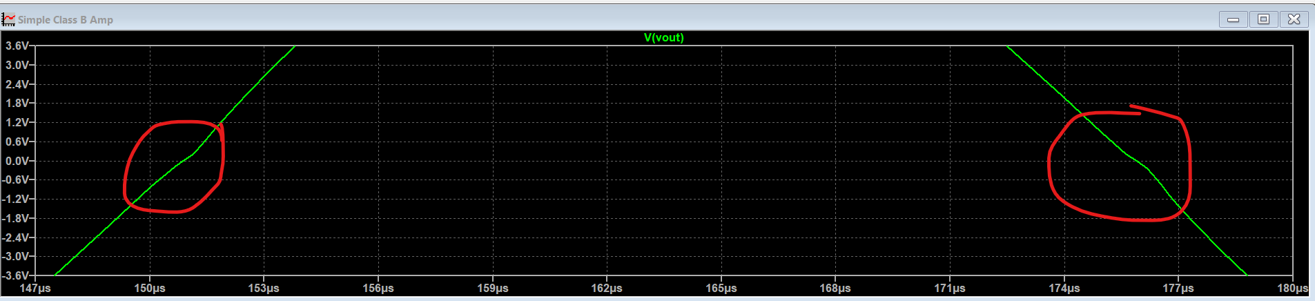

That s exactly that, a true class B amplifier, meaning that there s no output stage current biasing, as such it will produce a lot of
crossover distorsion even if the op amp is of good perfs, you would be better building a similar amp using a pair of TDA2030 or 2040, you wouldnt even need additional transistors.
Actually it's class C in that each device conducts less than 180°. The
feedback is trying to fix that 'hole'. That's why it sounds bad.

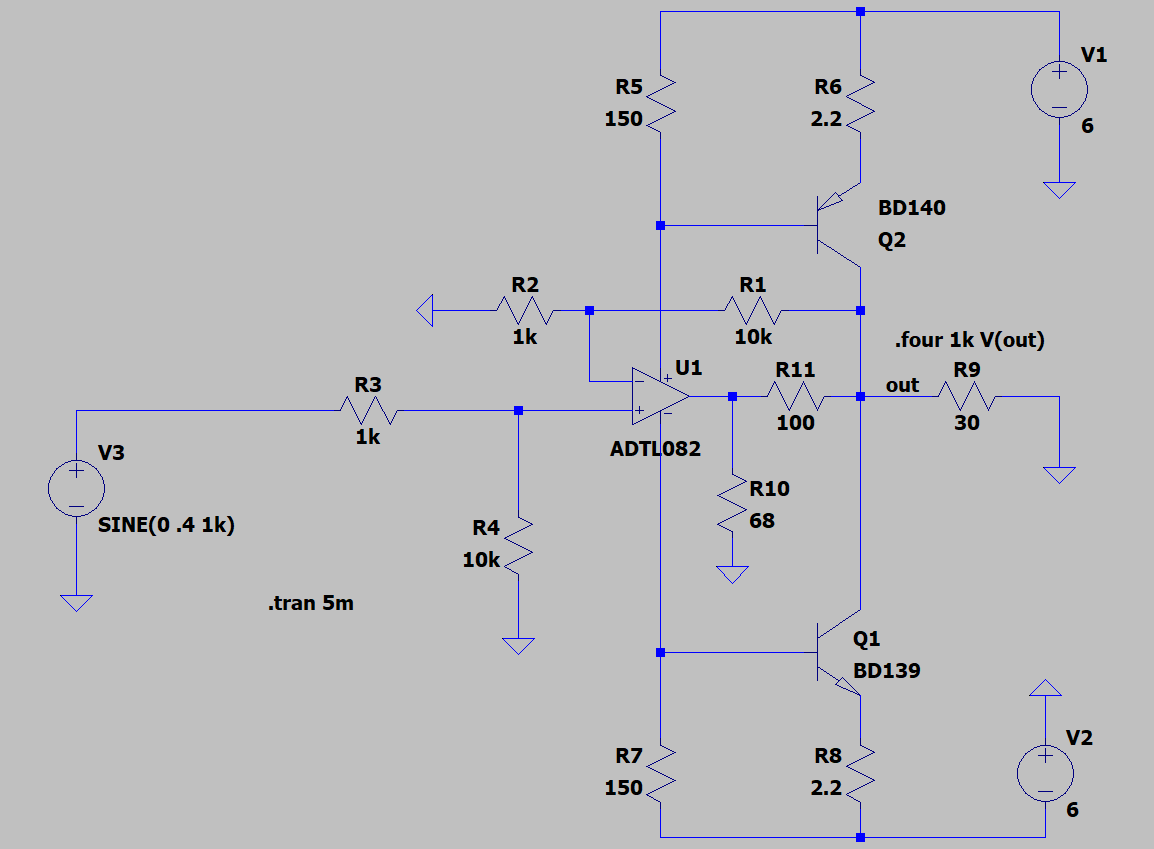

We old timers have played with these things a lot. Using an op-amp IPS has the following issues:
1. Limited supply voltage. High voltage op-amp exist but the point of this is cheap and common parts.
2. The output saturation voltage of common op-amps is already limited, and adding an EF makes it worse, although not so much if the bias stack is driven in the middle and bootstrapped.
3. Common op-amps are compensated for unity gain by themselves with no extra stages added, so stability can be a problem.
I have a b-zillion simulations I could post, but something missing in this thread so far is a supply pin driven common emitter output. The biggest problem with it is that he op-amp supply current has to be matched with the OP base resistors. I should also mention that one stage between an op-amp and an 8 Ohm load is not really enough.

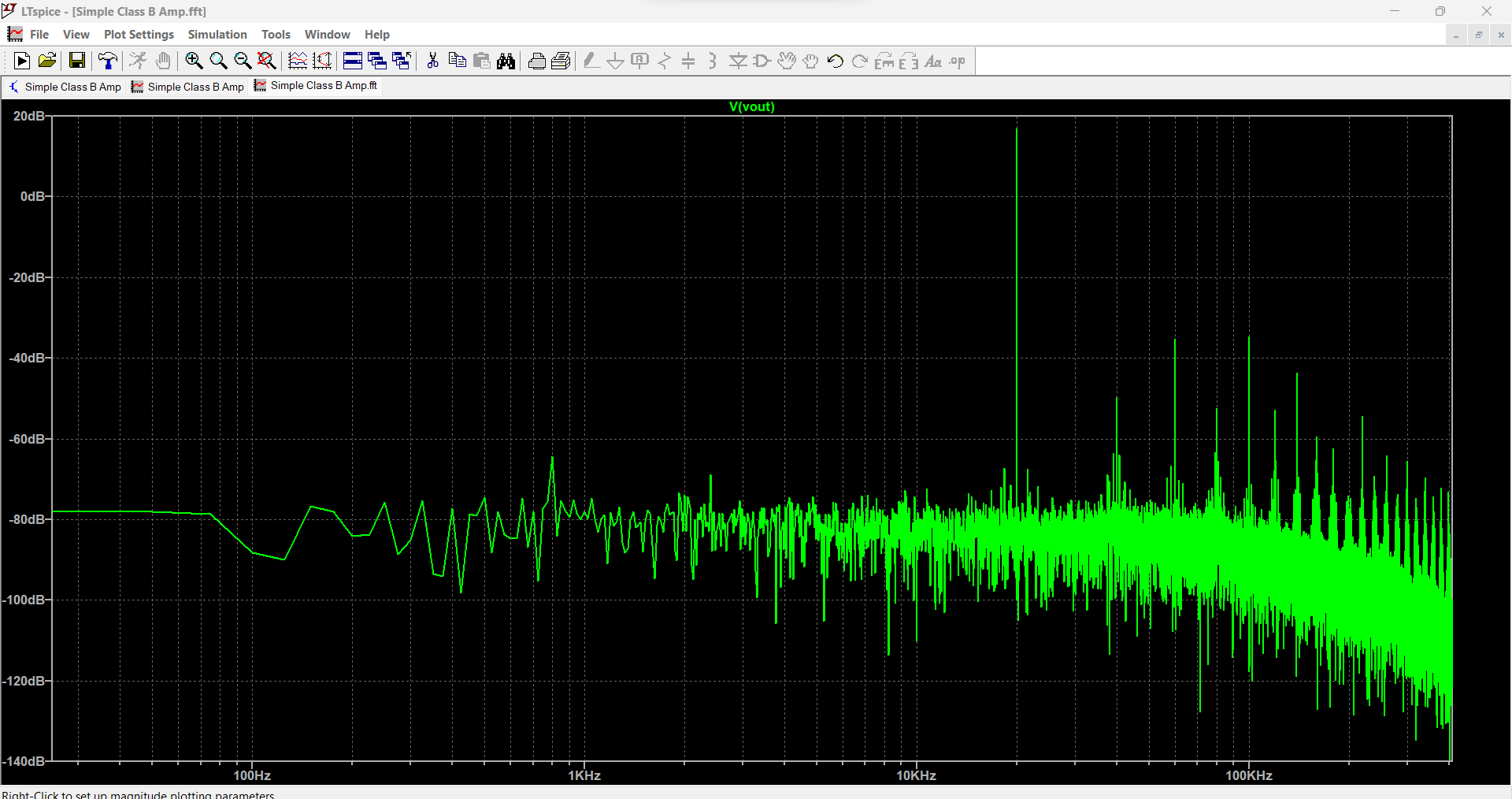

Class B is unsuitable for audio. Class AB requires only a few more components.
Ed
Well, very much depends on how you define the classes - if you define class B as a 180 degree conduction angle, this is close to the lowest distortion point... Some people call that AB though. The original circuit in this thread has less than 180 degree conduction angle, which arguably is class C.
So it pays to be precise about the biasing, not just give a letter. For example standard emitter-follower power amplifier outputs are biased to around 50mA per device. CFP outputs to 10mA or so. Both are empirically determined to be lowest distortion points for those systems, and close to 180 degree conduction angle. Biasing EF to 10mA and CFP to 50mA give poorer performance, so you can't really assign classes to those bias points without explaining the nature of the output devices.

Those are good points for sure. It looks like this circuit is good for playing around with on the breadboard, but not worth any serious application.
Yes, now you got it correct. It is a toy, toy circuit, not something to be used as a home amplifier. Of course even toys have some sense, but, as it is getting complex, the only value, simplicity, is lost and you do not get an advantage of much better parameters. The only challenge, from my point of view, is to keep it simple, but usable, with acceptable distortion.
