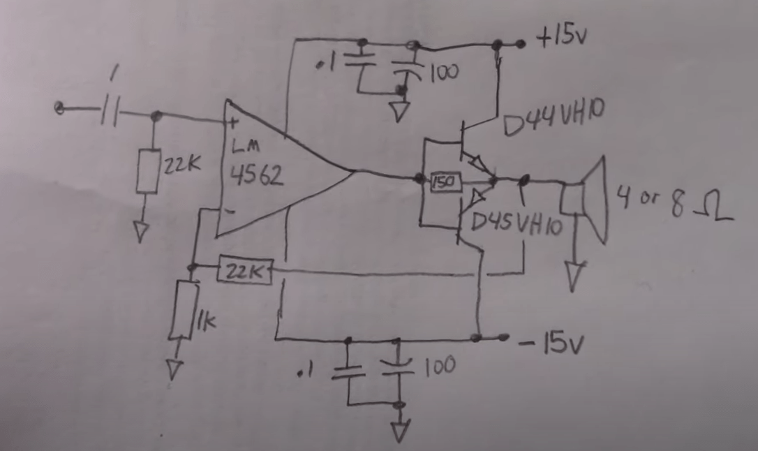

I have decided to try out this circuit described by JohnAudioTech in this video:
It is a very simple circuit, and it seemed to work quite well in his video. I built the circuit myself on a breadboard, and it didn't sound too good. I think there was some crossover distortion happening, but I haven't put it on the 'scope. It could be down to my poor breadboard layout, I'm assuming the feedback line between the output transistors and op-amp needs to be kept physically short.
What do you think of this circuit? I do appreciate John from JAT developing and sharing this class b amp circuit with us, but would it be worth building an actual desktop amplifier with this circuit? I thought it would be good to run my computer speakers, since it would be on all the time and wouldn't draw too much idle current.
I'm curious to hear what you all think!
That s exactly that, a true class B amplifier, meaning that there s no output stage current biasing, as such it will produce a lot of
crossover distorsion even if the op amp is of good perfs, you would be better building a similar amp using a pair of TDA2030 or 2040, you wouldnt even need additional transistors.
It's a bit like the Elektuur/Elektor Edwin amplifiers from decades ago. The feedforward path via the resistor between the bases and emitters is supposed to cover the crossover region and change it from a true dead zone to one where there is still some loop gain left. Reducing the 150 ohm to some smaller value should therefore reduce crossover distortion, as long as it doesn't overload the op-amp.
You could also consider changing it into a rudimentary current dumping amplifier. QUAD's current dumping scheme is somewhat similar, but far more effective against the crossover distortion.
The opamp has to cover 1.2V Vb-b dead zone by feedback. Loopgain decreases with frequency, thus high crossover distortion is inevitable. It would be good to use a small Vb-b bias voltage. As small as to keep it in class B without danger of thermal runaway, but even then helping the opamp, because dead zone would be smaller.
BTW the same circuit idea has been with us for decades, it is no new invention. It was, with one more resistor between opamp and bases, used in sixties in analog computers.
Without adding any complexity, you could try changing 150 ohm to 68 ohm and the 22 kohm feedback resistor to 8.2 kohm. You have a bit more loop gain then, especially in the crossover region. It will still be a bad amplifier, but hopefully not as bad as it is now.

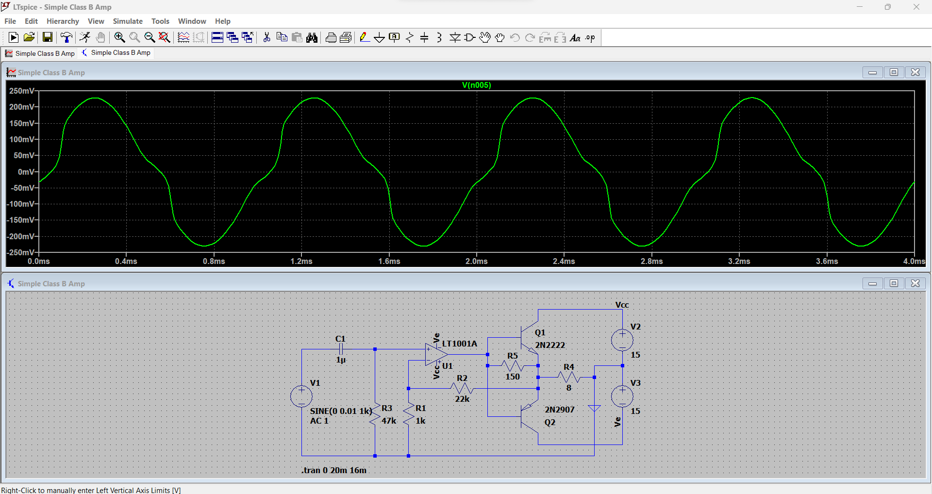

This shows the problem of the crossover distortion.
Lets try it 🙂 Much better...

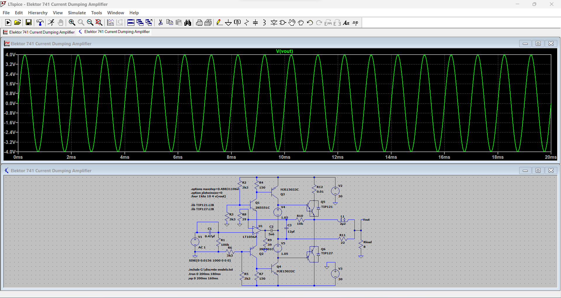

The Elektor current dumping design using a 741 always fascinated me and I have a simulation for that one.

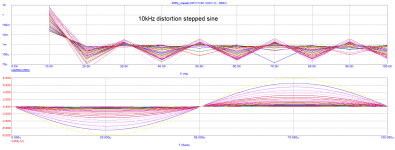

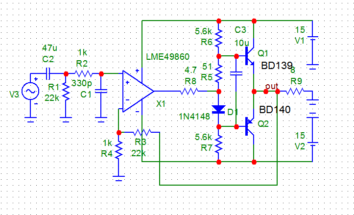

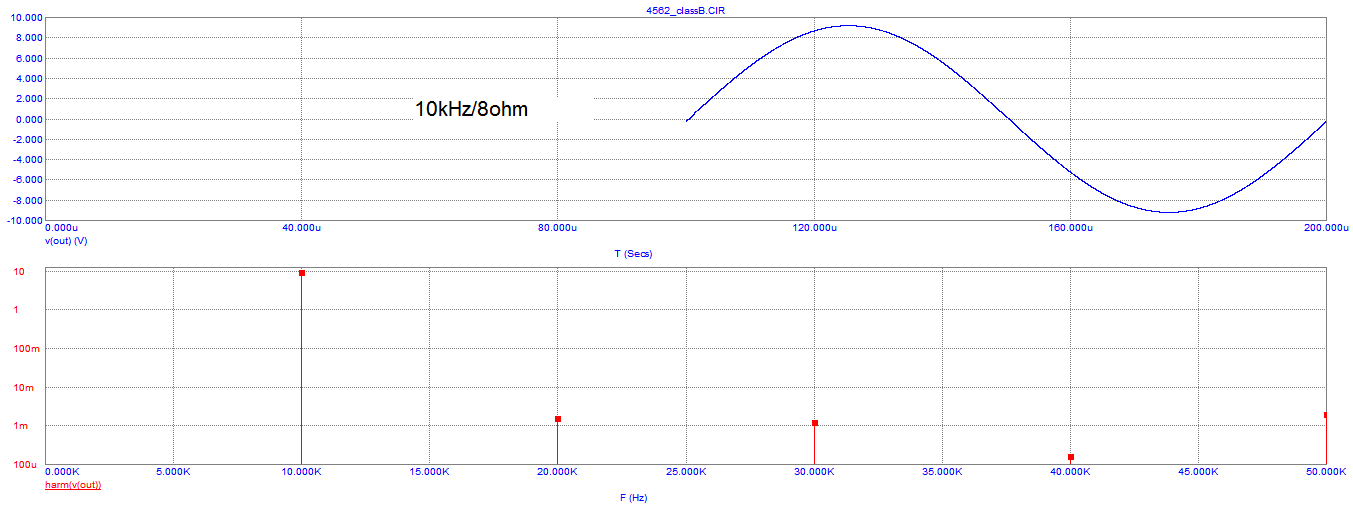

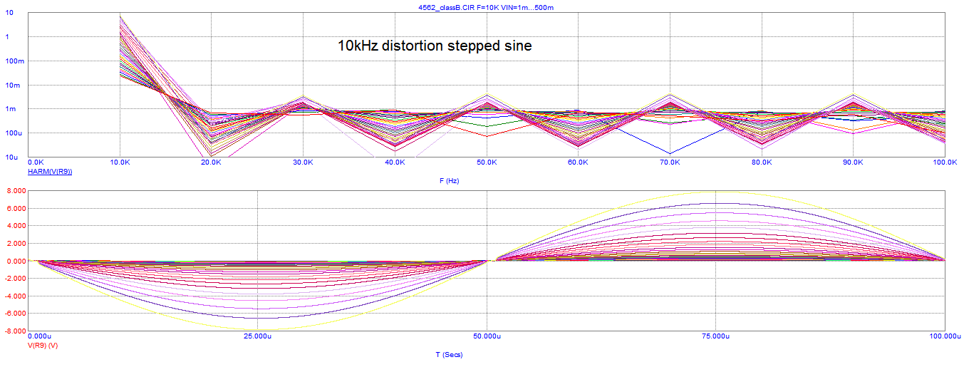

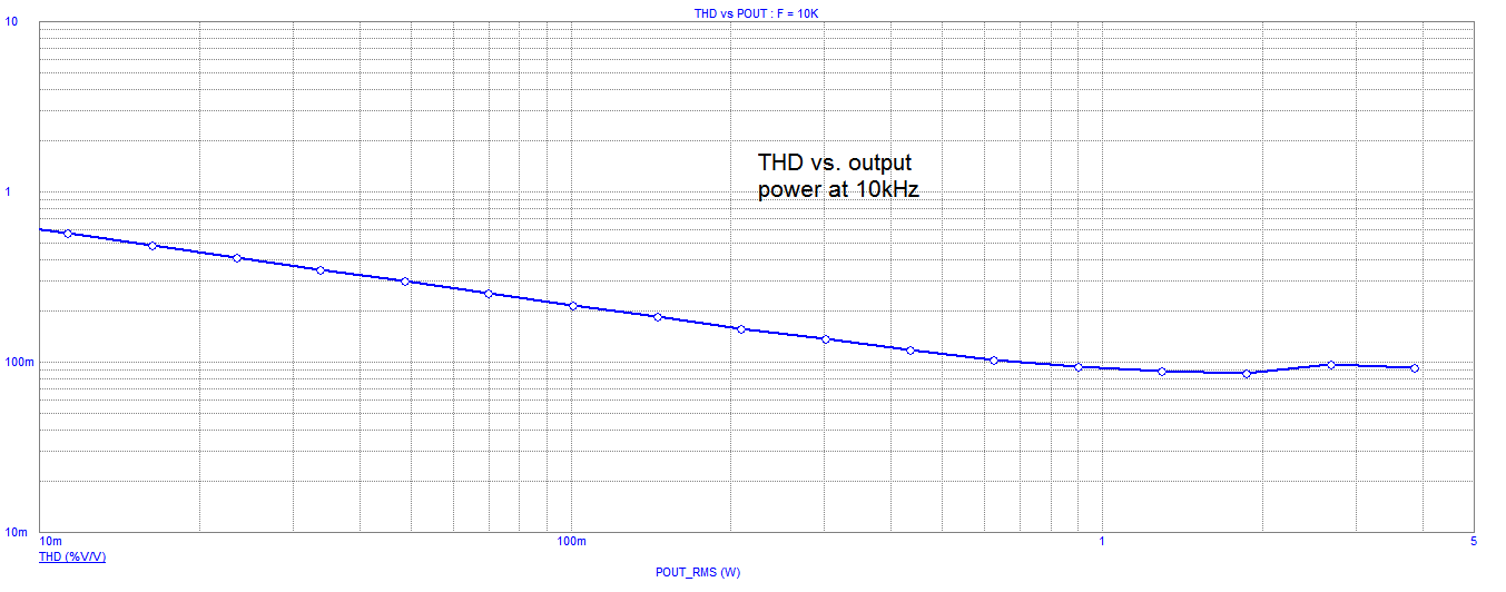

This is my way how to make a real life, working class B amplifier from the circuit suggested in post #1. Temperature is no problem, even at 100°C there is negligible idle current in the output stage. Distortion is at least acceptable, see the 10kHz wave. Please do not test at 1kHz, it does not tell much about crossover distortion. Add supply bypass capacitors like 100uF//100nF.
THD vs. power at 10kHz
10kHz stepped sine HD and scope

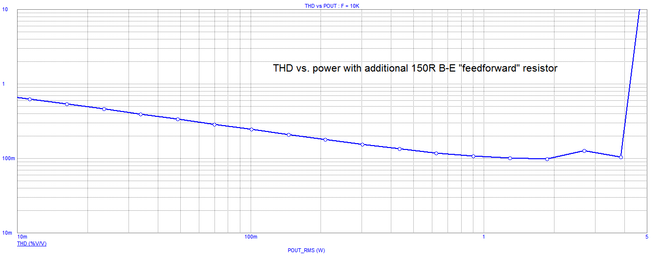

Why did you remove the feedforward path (150 ohm or 68 ohm or whatever resistor)? Now you have a real dead zone.

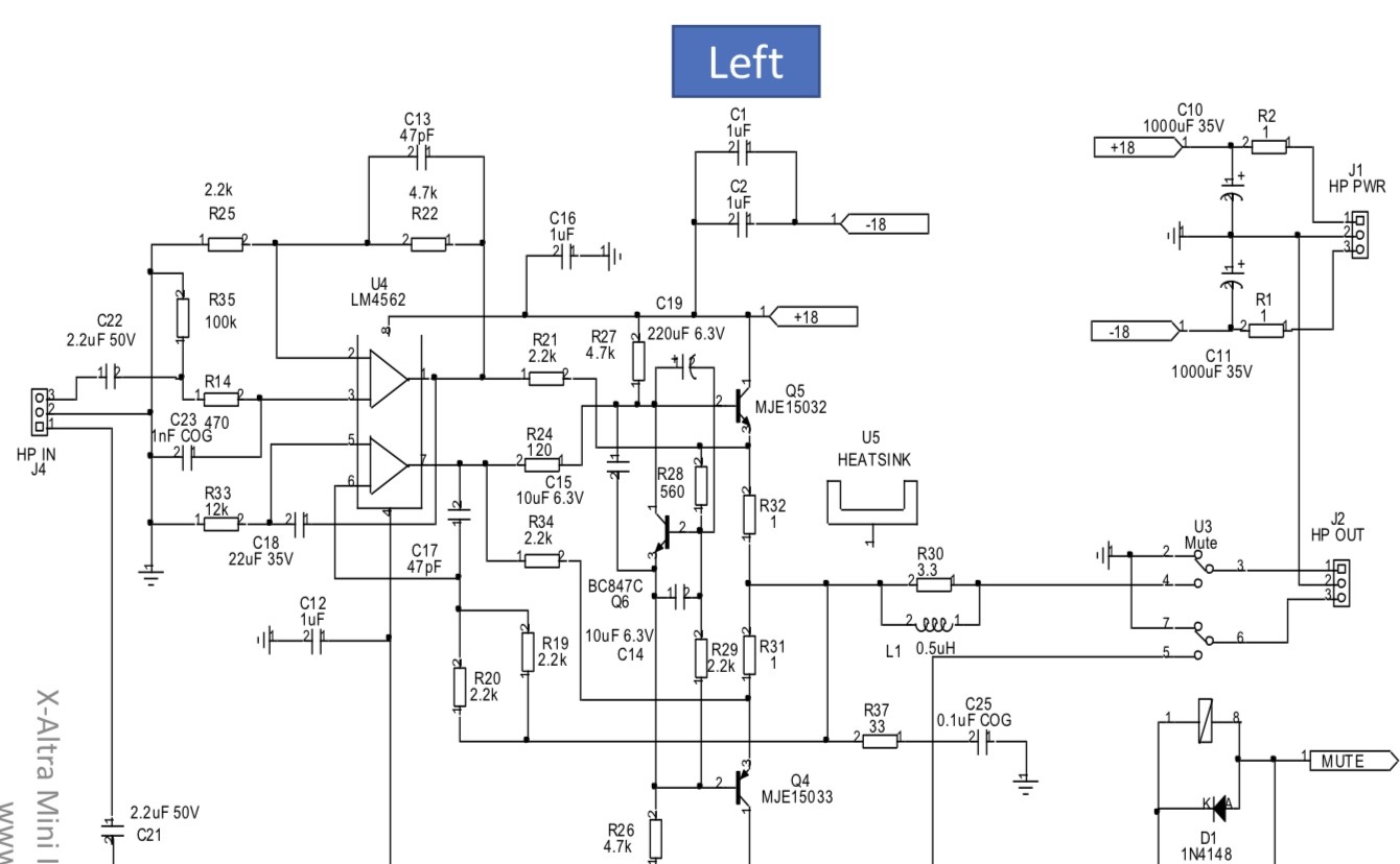

I looked at these issues when I designed my HPA1 headphone amp. I used single transistor (Q6) to bias the output stage into class A (90 mA) and then as done above, put the whole thing inside the feedback loop. The OPS transitions very smoothly to class AB and the distortion at full output (32 ohms) is single digit ppm.
