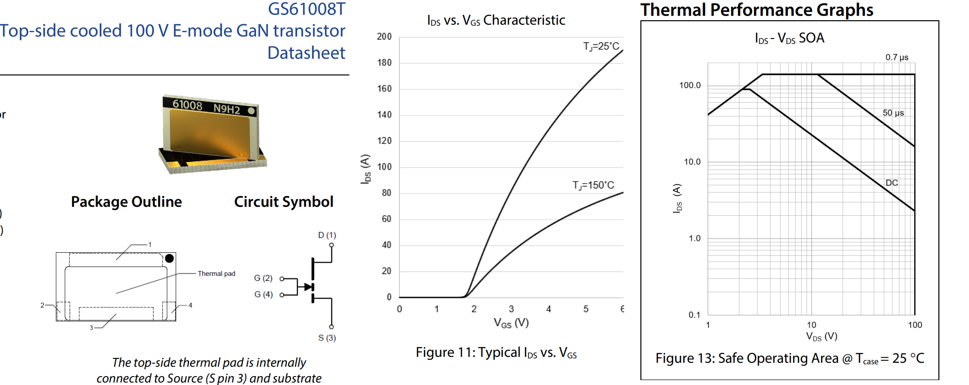

Slightly impractical package, but capable of high dissipation and the tempco has the friendly sign.
https://www.mouser.fr/datasheet/2/692/GS61008T_DS_Rev_200402-1837994.pdf

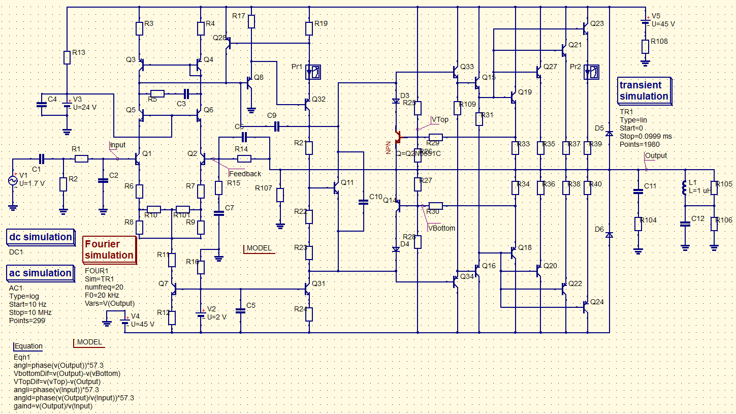

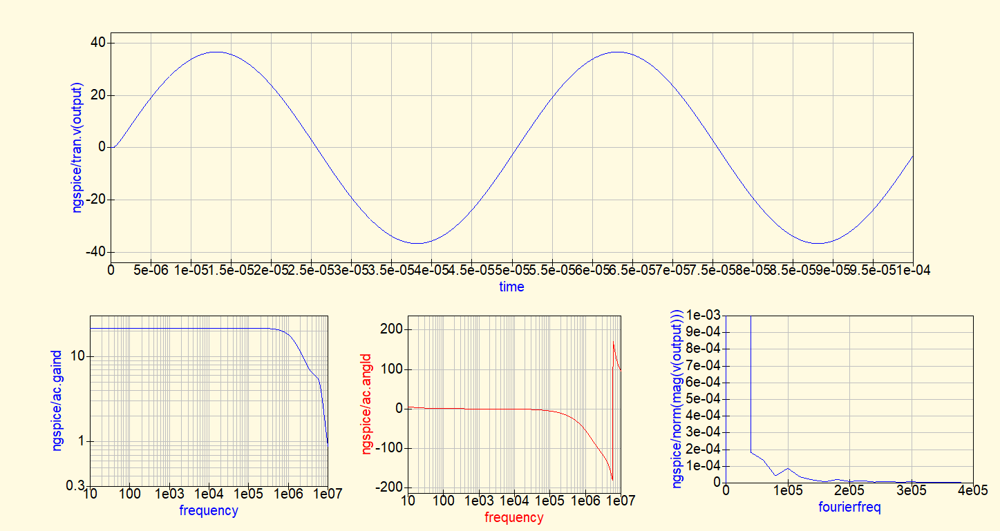

I think you can get some decent power and performance out of these simple parts. This is an output triple using four parallel TIP41/42 and a 2N5551/2N5401 VAS. The THD is 0.02% at 20 kHz. The output is 38 V peak into a 4 ohm load, or 180 W.
Given that 2N5551/2N5401 is about 2 cents a piece for Chinese versions, and TIP41/42 is about 35 to 50 cents a piece, this is not a bad solution I would think.

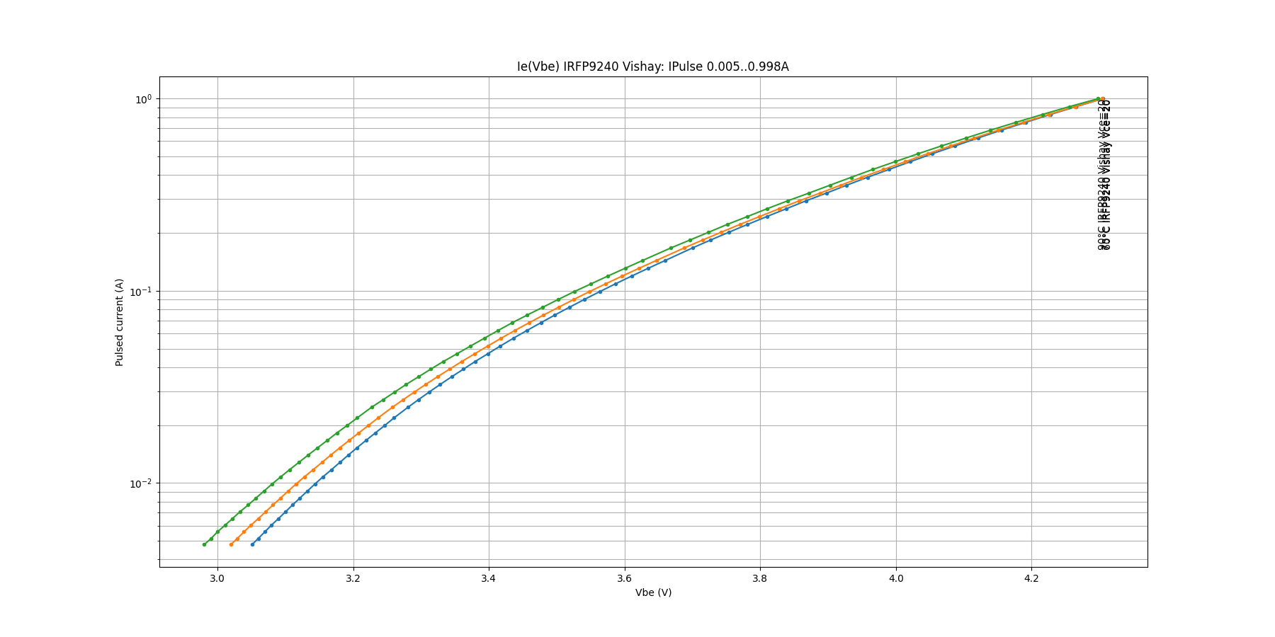

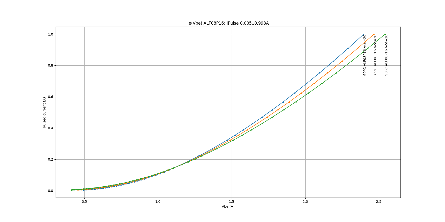

These two PMOS have a zero tempco point at an unexpectedly low current ; lateral ALFET for comparison.
If my measurement setup gives correct result, this would mean they should work fine in linear mode...
https://www.diyaudio.com/forums/sol...ed-transistor-measurements-2.html#post6706531

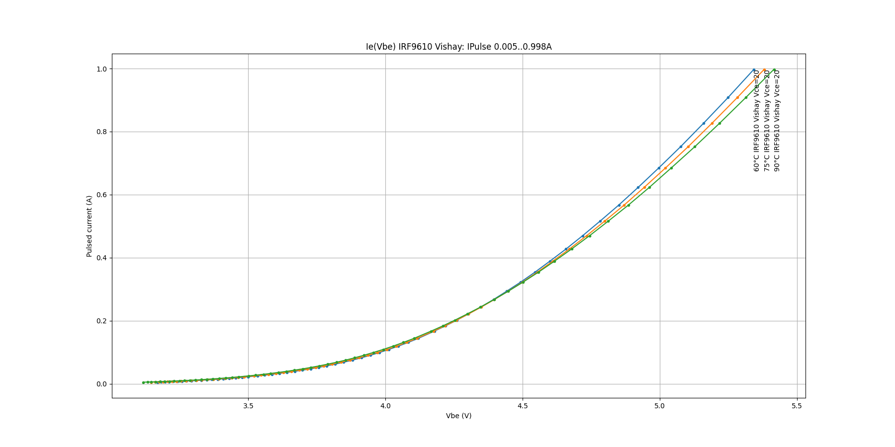

Oops, only one of the graphs is in log scale.
Anyway, problem with IRF9610 is, it's a TO220 with a rather large 6.5°C/W RthJC so it's not suited for an output stage unless you use a huge quantity in parallel. But IRFP9240 tempco is pretty civilized too, just a few mV/°C, so I'm optimistic about this one.
