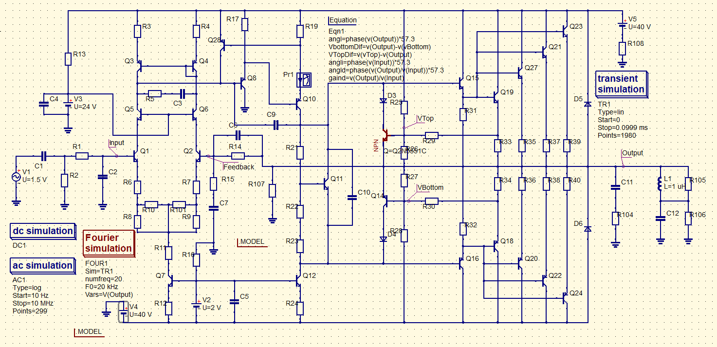

I realize that future designs may not be able to get all of the best, most exotic transistors and tried to make a future proofed design. I have used MJE15032/MJE15033 for both VAS and driver for this reason, because the transistor seems to be fast enough for VAS and can take more quiescent heat, even though MJE15032/MJE15032 is an unconventional VAS choice. I put this into my amp project
GitHub - profdc9/PowerAmpAudio: Power Amplifier based on Michael Chua's C300 amplifier
I am trying to use the fewest number of types of transistors to future proof the design. I use only 2N5551/2N5401 (or MPSA42/MPSA92) which still seem to have many cheap copies made, a medium power transistor for VAS/driver (MJE15032/MJE15033 or MJE340/MJE350) and a high power transistor for output stage (MJL3281/MJL1302 or 2SC5200/2SA1943). It wouldn't be the fastest, but for less than 100 V rail-to-rail, one could substitute TIP41/TIP42 and TIP3055/TIP2955 if there were no other available faster parts.

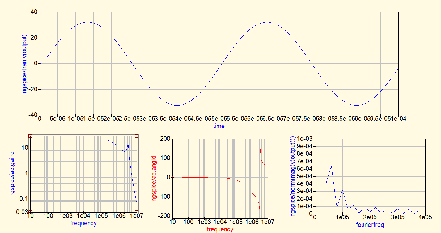

Just out of curiosity, I modified my amp project to use only 2N5551/2N5401 and TIP41/TIP42. The simulated results are better than I thought they would be. It delivers 135 W into a 4 ohm load with 0.06% distortion at 20 kHz.
The VAS transistors Q10/Q12, the buffer transistors Q15/Q16 and the output transistors Q18-Q27 are all TIP41C/42C.
