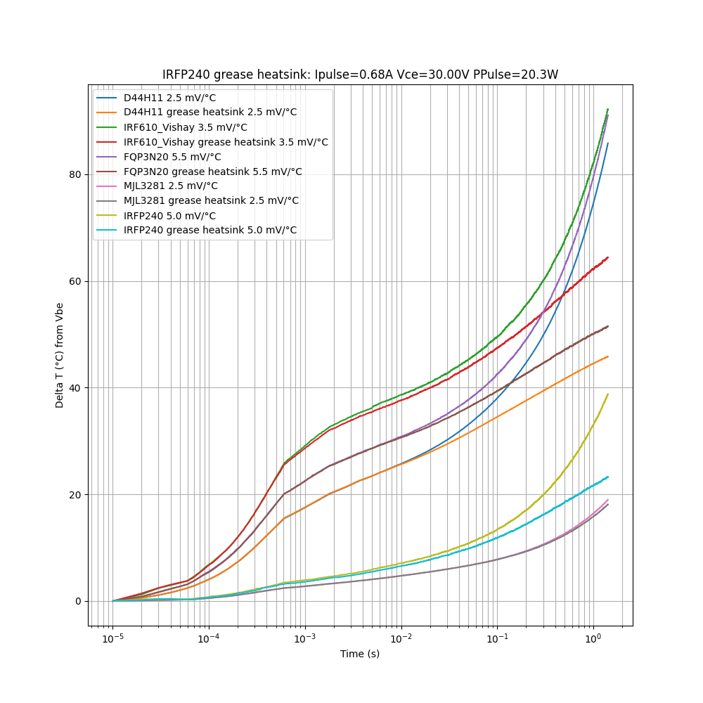

I've made a setup for transient thermal impedance. That applies a current pulse at constant Vds/Vce and acquires Vgs/Vbe.
If there is second breakdown, hotspot or Spirito effect will it show up as a difference in the curves between two pulses of identical power but different Vds?
I think that you are correct, different behaviour at constant power, but different Id/Vds.

Well I've tried to answer the question with a measurement, and it looks like the answer is "no it doesn't show up on this measurement". The little FET I've tested is a TrenchFET, so there is no way it will work in linear mode... of course the datasheet shows a nice "DC" safe operating area which is probably bogus. No difference in transient thermal measurement at the same power between Vds=10V and 30V. Ah well, it was worth trying.

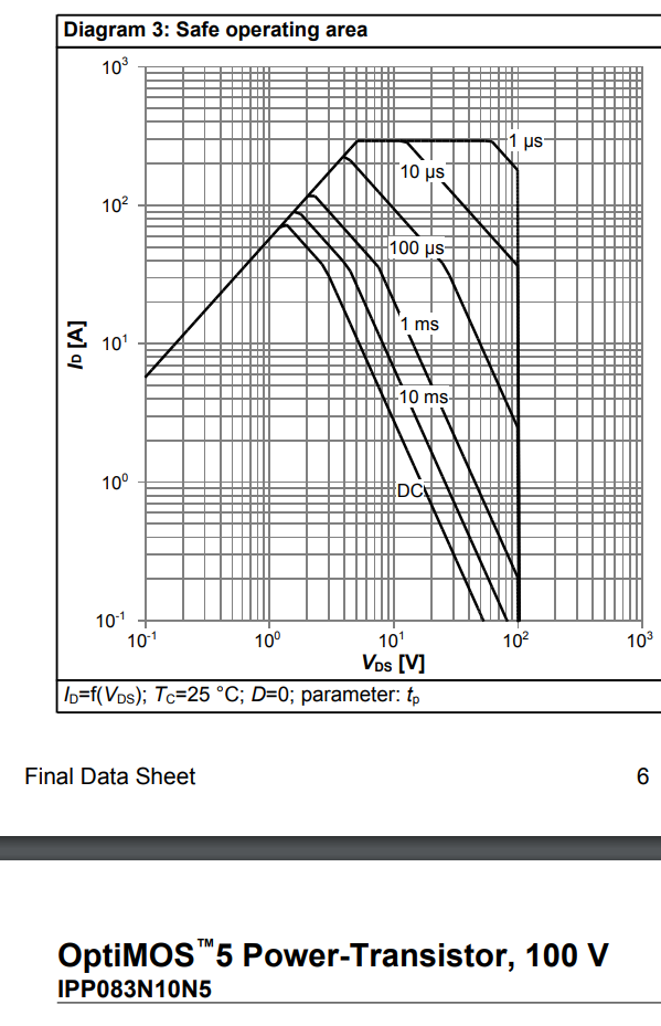

I spent five minutes, see figure 10 of:
https://nl.mouser.com/datasheet/2/196/Infineon_IRFP7430_DataSheet_v01_01_EN-1732904.pdf
Just look for insanely low on resistances.

Even "linear" parts have it a bit
OptiMOS™' 'Linear' 'FET' '100V'/'150V'/'200V - Infineon Technologies
I think this is the only honest manufacturer
