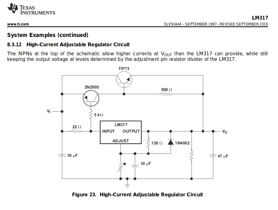

That’s not what feed-forward is, tho. This is like a current bootstrap on a LM317 regulator except the regulator outputs a current. The output voltage is controlled by feed-back.

And this presents a limitation on its load. Too low and the class A will saturate before the bootstrap transistors turn on.
There is a 0.6V dead zone, otherwise it wouldn't be a class C part, and in that dead zone the class A part provides all the current. The class C part supplies basically all the current when it is on, but not when it isn't.
The class A still provides voltage and current to bias the class C transistors.
The class C bootstraps the class A output.
Correction: this isn’t true of the Quad 405 where the class A drives the load through a 47 ohm resistor. So it only has to provide 0.7V or so across 47 ohms before the “dumper” transistor turns on. What is a limitation is the class A has to drive a single power transistor and this is what saturates it with heavy loading.

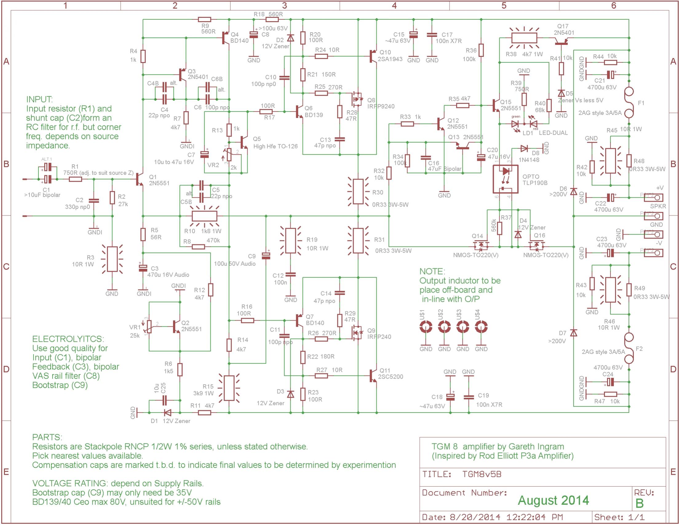

Most class G (or H) amps cannot be considered clas AB+C. Why? Because the output is usually fed from the class AB stage all the time. It is the power supply (common terminal for AC signal) that is either modulated or switched. There have been a few exceptions that ARE class AB+C. Such amps have two (or 3) completely independent output stages which drive the load in parallel. The AB stage feeds the load until it’s supply runs out of voltage, then the class C stage takes over for output voltages above that. Probably the best example is the original QSC MX2000 (the non-A version). The component count was much higher - using two complete sets of D424/B554 per channel ($$$). Sounded better than the newer versions, too. It had that funky folded inside out common emitter output stage, but the same thing can be built with regular emitter followers.
Classification concerns the transistors first. If a transistor leaves current passing for less than one alternance, it works in class C. There are transistors working in class C in a class G output stage.
Their role is attached to the power supply of the optimised class B stage which is the only one "seen" by the load, unlike in the Quad current dumping stage where the load "sees" the class A and the class C devices in parallel.
In my TGM8 there is only one power rail and the Class AB is therefore in parallel with the Class C. It's not that the Class C stage takes over from the Class AB as the Class AB is always providing current to load when the Class C stage is active; what happens is that the Class C stage augments the Class AB stage above a certain current level. It has the great advantage that low signal levels we have the nice AB cross-over behaviour of a BJT transistor that requires relatively low idle current and then at high signals the Class C stage jumps in to help with powerful FETs. The power dissipation of the AB devices is capped and beta droop avoided. It sounds terrific.
