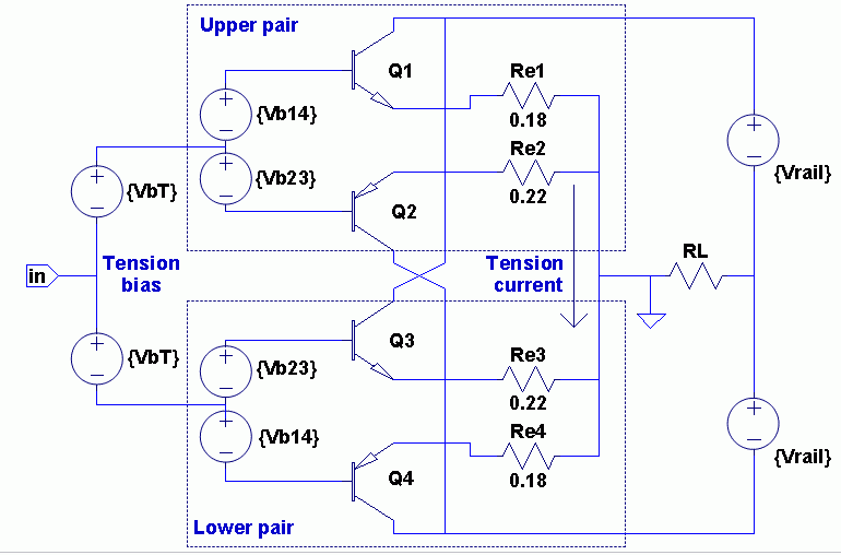

Hi zjjwwa,
With Bob's an my implementation of Class-AB+C you don't have two Vbe bias generators "stacked on top of each other". The situation of Class-A bias is not as grim as suggested. Total idle current of 300mA for a 100W OPS can give a wide enough poser band to cover the 1st watt with negligible crossover distortion. That's not a lot of heat compared to standard Class-A amps and a lot less crossover distortion than standard Class-AB in optimum bias. And over the past decade there has been a move to paralleling Class-AB stages with minimal emitter resistors to get lower distortion and this is increasing the total idle current closer to 200mA for a 100W amp, so 300mA for Class-AB+C is no longer an issue, nor is the complexity with two parallel stages. The only difference is a few bias components.
This must be an improvement in the state of the art -- no development like this has been seen since the 1970's. BTW Quad "Current dumping" is different to Class-AB+C in that the latter does not need negative feedback whereas Quad's relies on negative feedback to form the balanced bridge so it iuses hybrid feedback plus feedforward. You can run my LTspice circuit for Class-AB+C operating as Common Emitter to see it can operate with zero feedback (apart from emitter degeneration). The file is available here. If you are not into LTspice then a spreadsheet showing the same is here. Screen shots are attached for both.

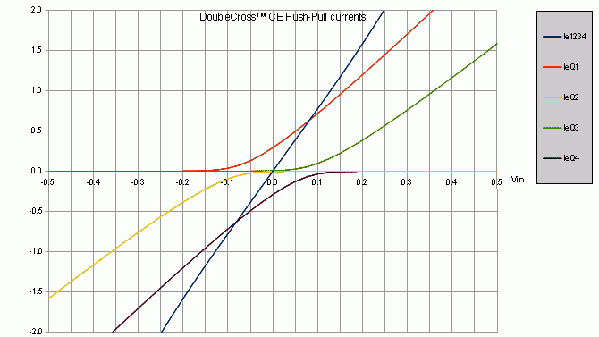

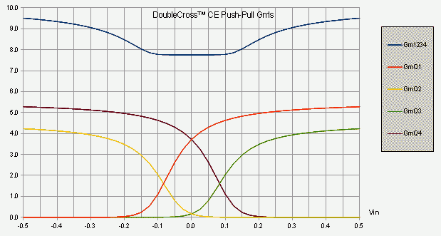

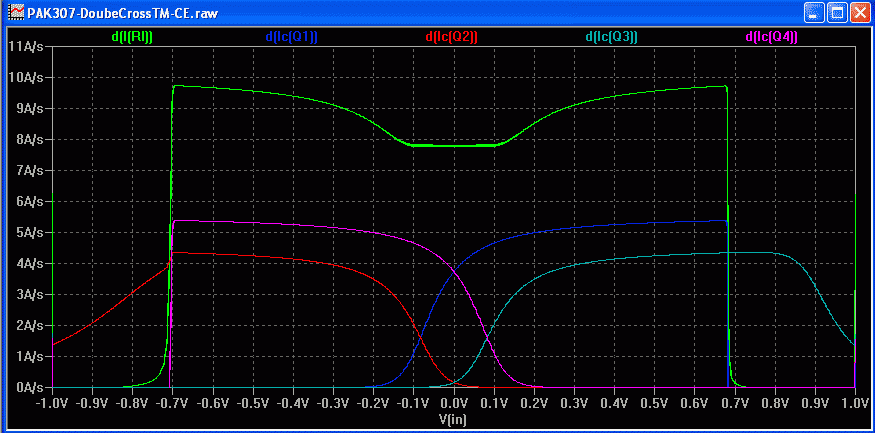

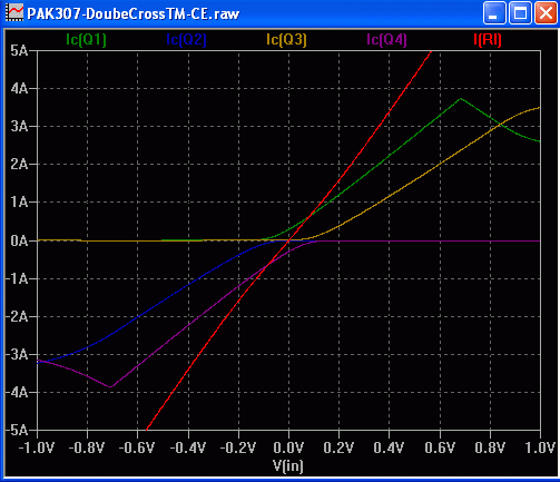

Now for biasing, look at the attached circuit based on Bob's book Figure 13.8a. Can you see two parallel output stages? The upper one is shifted up a small voltage by the "Tension" bias voltage and likewise the lower one is lowered. The plots for the currents show this shift. Bob says in his book the way to implement these bias voltages turns out to be surprisingly easy. I arrived at the same method independently. You may be able to see it in my circuit posted here, otherwise Bob's book gives a clearer implementation for implementing the bias generators than mine.
Re: building a successful design, there are presently no proven Class-AB+C projects. Bob Cordell has only built and tested the output stage. Bob is working on his BC-1 design out of his book and may be nearing the stage for DIYer's to make, see this post.
Re: digging into amplifiers -- they are very complex pieces of equipment, even the minimalist amps. The standard topology is the preferred one because it is the easiest one to get working and the best understood. When you get off that well worn track you can easily get lost in a jungle of complexity (like my amps😉). Even for the standard design you can spend a lifetime learning about it.

Will need to catch up on a few things here, read up a bit.
But basically, your graphs - look very familiar. To what I have been doing and plotting in excel at least. But using a more familiar, intuitive method.
The problem that I have with your circuit is that I need to better understand it first. It is in parts non-obvious ("exotic"?) to me. It seems to be achieving exactly the goal that I am looking for.
My 'more familiar' method was of the KISS variety, simple and stupid emitter resistors, which are bypassed by a diode and series connected similar, or better, slightly lower in value, resistors.
Picking specific proportions between them, and using a standing current of half the forward bias Vf of the diode used, seems to render similar results.
But at the same time - the rest of the circuit is "pretty much standard"....
Will need to think this over, the thing with your Rush transistors and how it works.
Yes, I think that I will start off and dig into the xls sheet. More familiar.
