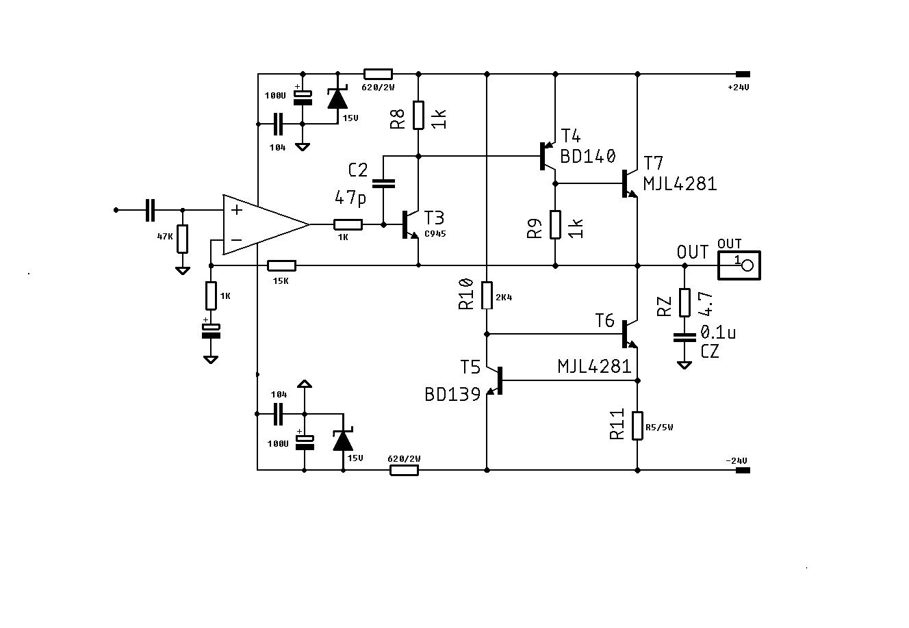

Class A, 4 Watt, No Feedback, Simple Circuit, Great Sound

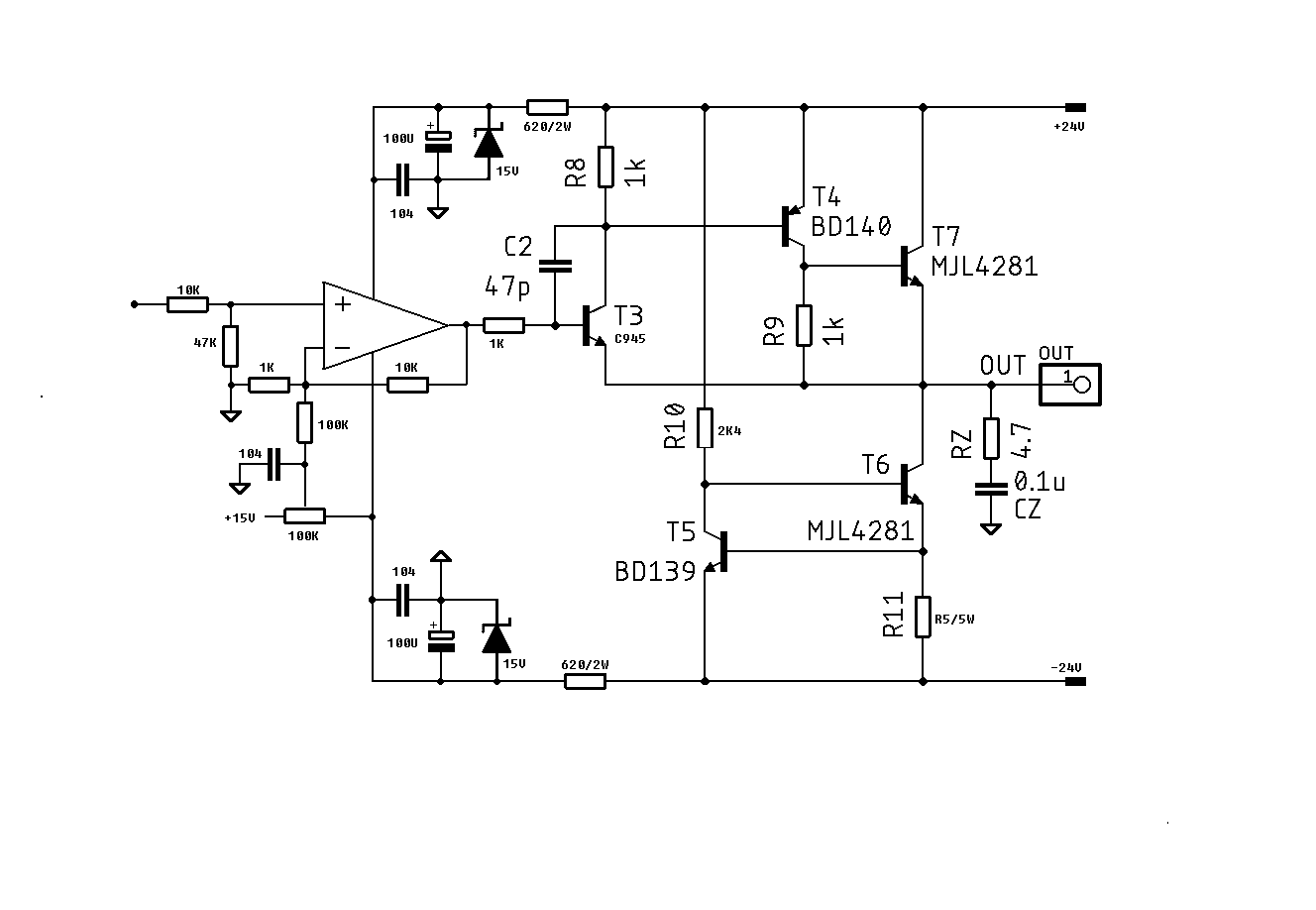

Ive just made a headphone amp version for my Sennheiser HD 800's. 15V at 50ma bias. I simplified the the upper CFP to use a BC337 and an MJE15031 while the lower current source uses
another BC 337 and a MJE15030. Over all gain reduced to 4.5. Its powered with 4 x 18650 Lithium Ion batteries for now. First impressions are that it sounds very very good. I think it could be even better than my DHT valve headphone amp which was a big surprise. Now to do some comparable measurements.
Dlis,
This is a simple CCS. BD139 is the sense transistor, and it always has 0.6V across base emitter.
With this voltage also impressed across R5, the current flowing will 0.6/0.6=1A (1000mA)
The current to drive the base of BD139 will only be very small, maybe 1mA or less, so that 999mA will flow into the 2SC5200 and it will be a constant because the Vbe of BD139 does not change.
The collector of the BD139 will settle at a voltage needed to ensure the 2SC5200 passes the necessary 999mA.
This is a CFP two transistor constant current source, well known, and delivering very good performance to very high frequencies.

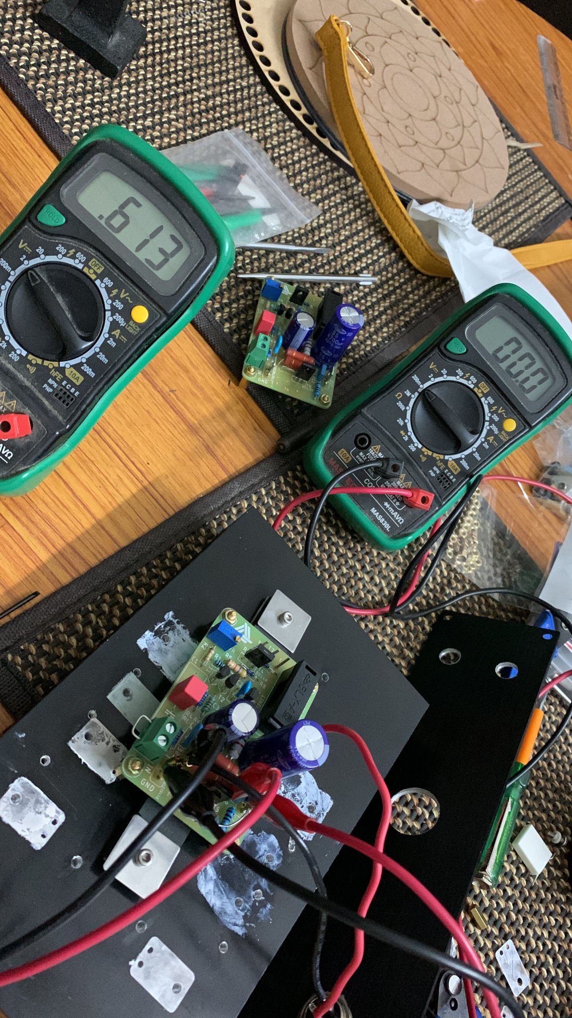

I powered up one channel today using a 24vdc 5a laptop adapter. Used a 100R/2W resistor between the output and ground as Juma suggested. Because I had 1R/3W resistors so used a pair and then the rest of the parts are exactly per the schematic. 2SC5200 pairs as power mosfets. I see the bias across one of the 1R resistor being 615mV with the offset very close to 0.5mV and stable. The trimmer does not change the bias or reduce not sure if the trimmer is the issue or I used a slightly lower value 1R power resistors parallel.

Ok I read the post #4 again and as @lineup suggested I removed the 100R/2w output resistor and was able to adjust the DC output voltage to V/2 + 0.8 so my supply is 24/2 + 0.8 to set it to 12.8vdc using the trimmer :)
Its playing some beautiful music in a single channel :)
Plays as good as ACA if I can say very good mids and vocals the forte of class A. Thanks @lineup for a sweet sounding amplifier and can be built with super cheap parts without any exotic JFETs or mosfets.
