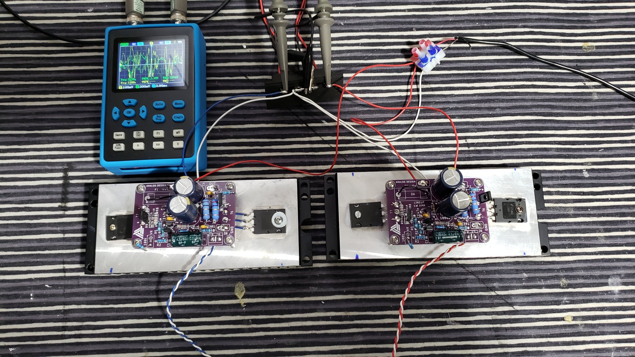

I received the boards, thanks bloqhed, and build the amp. It works, but one channel overheats. Must be some simple issue, short, or wrong part. Do not have time to deal with it right now.

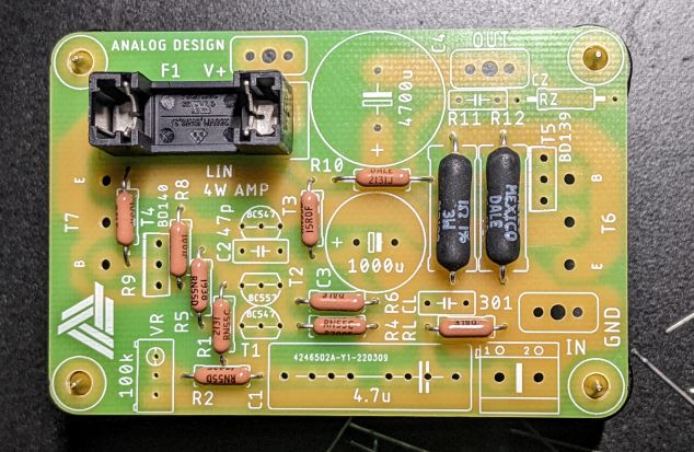

Boards arrived but build ground to a halt as I missed RZ from my BOM - a rookie error 🙄

I have used the following for the caps in this design:
Rz = 0.1uF 100V film
C2 = 47pF Silver Mica
C5 = 330pF 100v film
C1 = 4.7uF PP film
C4 = 4700uF 35v audio grade electro cap. eg Nichicon UKA.

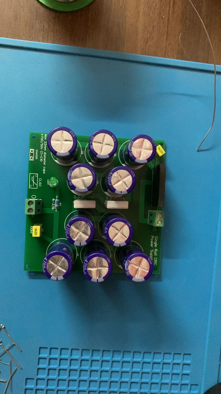

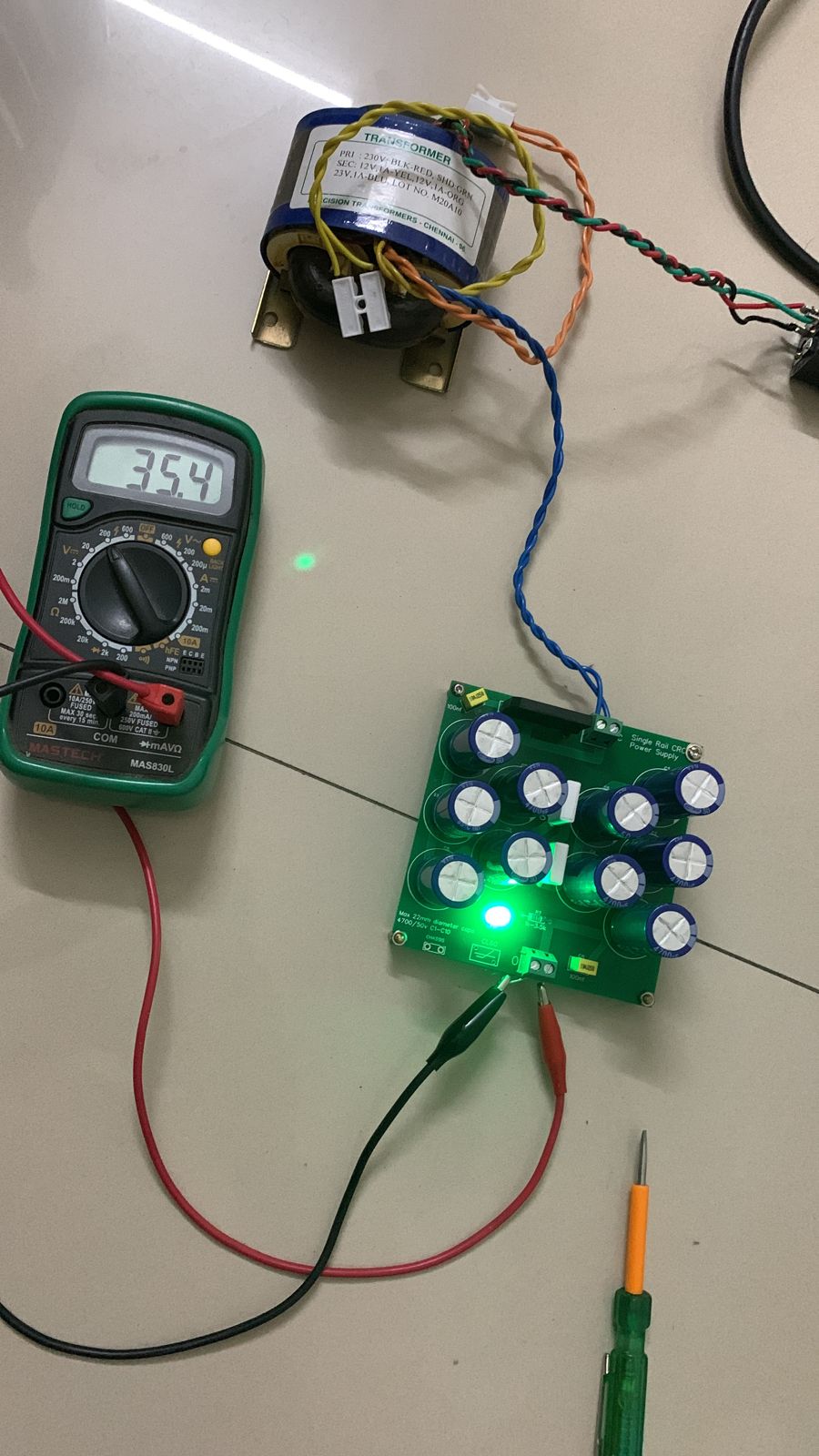

I can confirm that the boards are working fine with a test rcore transformer I checked with the 23VAC rail I get a stable 34.2vdc because of my home voltage being a bit higher than the normal 220vac. Here are some of the pics using Samwha 4700/50v caps and pair of BPR 0.33R/5W resistors.I did my first attempt at the easyeda.com online site as I do not have kicad or other softwares 🙂
Here is a small renderer and I did print few boards to test my board and I tried to use small caps of 2200-4700/35-50v low noise and also they are cheaper than bigger sized caps. Hopefully it works, if you are interested here are the gerber files.
Note: This board is yet to be tested.

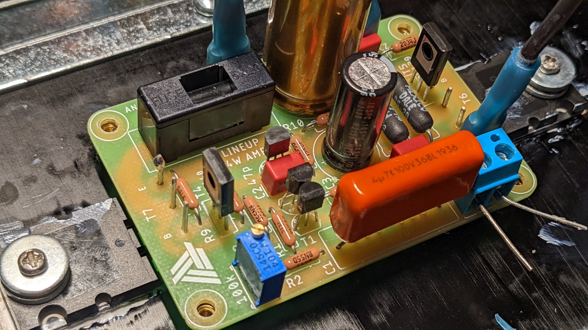

I've made some progress. Drilled and tapped the heatsink and attached to bench PSU. Unfortunately the current draw is only 20-30mA (shown on bench PSU) whatever I do with the pot and seem unable to bias the circuit.
Could anyone point me in the right direction for troubleshooting and what measurements to take? (this is my first build so patience is appreciated)
Many thanks
Many thanks
Many thanks
I'm not entirely sure if it applies to your situation, but I recall in post #139 it was mentioned that the output cap can't be hanging and you need to load the speaker output by tying a 100R/2w resistor from output to ground.
I have a 12ohm 20W resistor connected to the output. I've also remembered to solder the jumper JP1. I know it's likely to be something silly but I'm at a bit of a loss...
