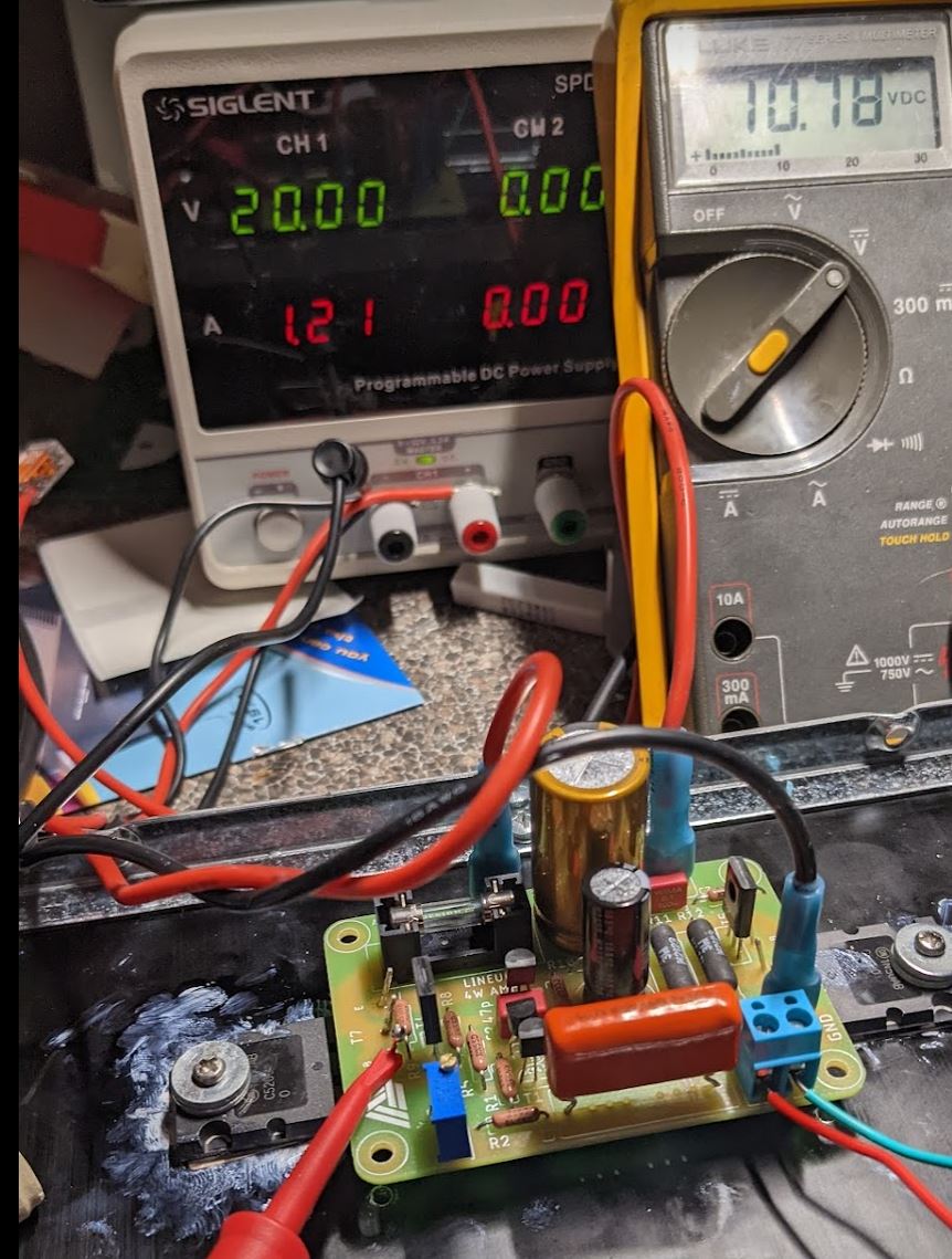

DC output voltage V/2+0.8 Volt so for 20V in should be 10.8 V (as per post#4) but I'm only getting 0.69V

Are you sure your bench power supply is not set to limit current?I've made some progress. Drilled and tapped the heatsink and attached to bench PSU. Unfortunately the current draw is only 20-30mA (shown on bench PSU) whatever I do with the pot and seem unable to bias the circuit.
Could anyone point me in the right direction for troubleshooting and what measurements to take? (this is my first build so patience is appreciated)
Many thanks
Compare voltages between the 2 pcb's as you move through the circuit, you should see where the problem is doing this now you have a fully working board to compare with.
Look for a wrong value resistor, faulty transistor or a bad solder joint.

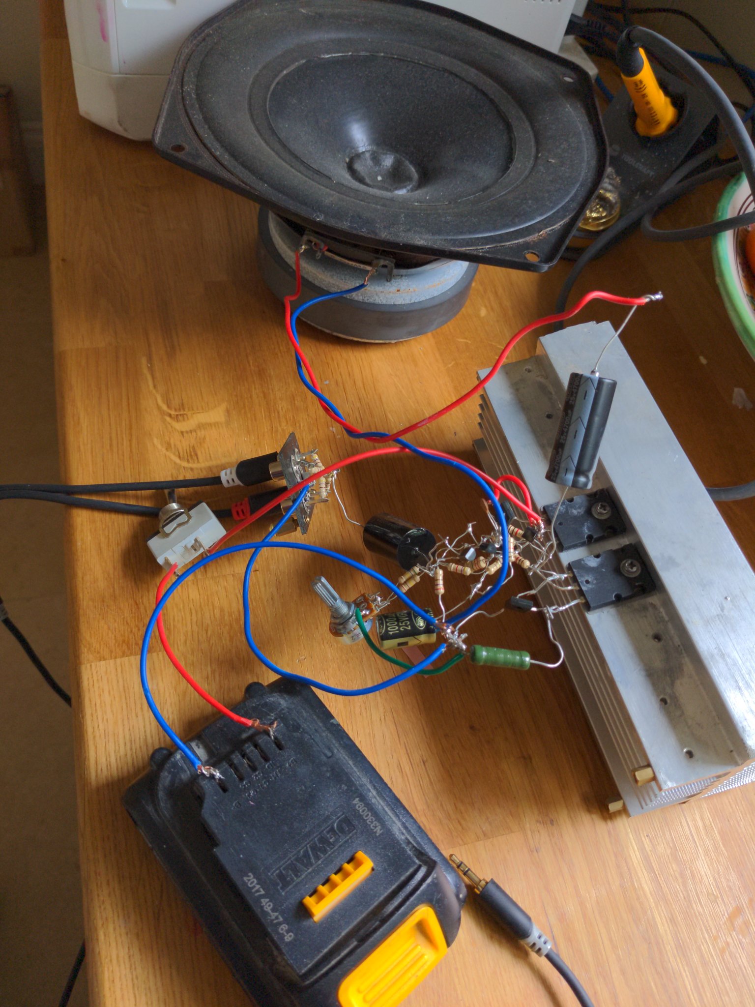

Well, no PCB here but this works for me!
Temporary setup, but the 18v lithium ion battery works well for testing...doesn't stay at 18v for long mind you!

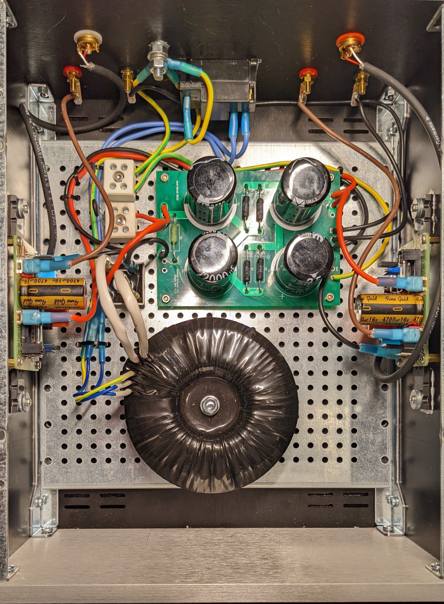

The transformer / PSU is in and everything wired up. Checked earthing with meter and everything looks safe on that front. Slightly nervous of switching on to be honest! Any last minute advice or checks to do?

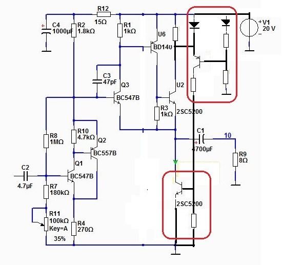

While studying the original circuit I was wondering if the current source on the output stage could be replaced with a "Taylor" circuit (as in P. L. Taylor's Audio Power Amplifier Wireless World June 1973) - the red boxed circuit.
The number and type of components used is about the same as the original circuit.
In this way the maximum "negative current" in the load is not limited to the current set by the current generator but is (much) greater.

I'm not a stranger to Class A - my other amp is a FW F7 🙂
I summoned up the courage to power it up earlier today and it's utterly silent with no hiss or hum or power on thud (I have added a NTC thermistor). There is an unexpected voltage drop from my calculation (caused by NTC?) and I'm getting around 19V instead of 20V, however the bias was off only 0.2V from powering on a bench PSU.

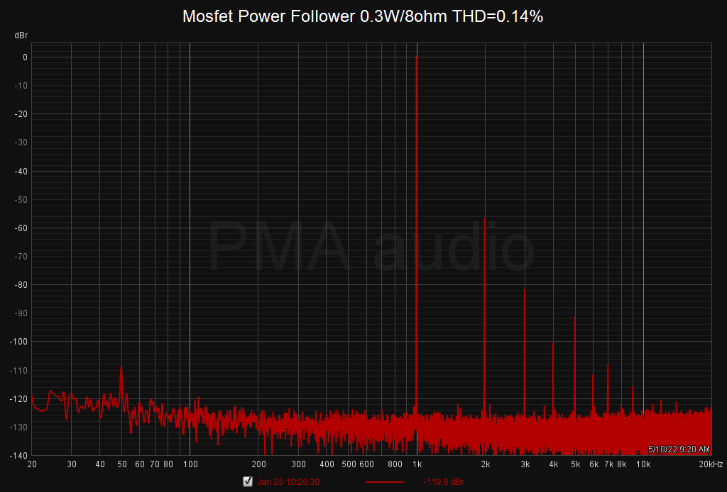

This does sound a different beast to the First Watt. It's extremely clean sounding with plenty detail (and bass surprisingly) but something intangible seems missing. I know it's a bit of an unfair comparison, but I had high hopes of this simple circuit. I'm wondering if this has something to do with the amount of feedback? I've not amassed enough knowledge yet but is the feedback controlled by R1 and could this be adjusted without throwing the whole thing out of kilter?
Look, what you need is to measure distortion at the output at say 100mW, 1W and 10W, at 1kHz and 10kHz. This will give you some view what it is doing. Guesses and second guesses about class of operation or feedback ratio are pointless, it is nothing but audiophile bla bla. This is technology and engineering and it follows laws of physics. Nothing else, nothing mysterious.
