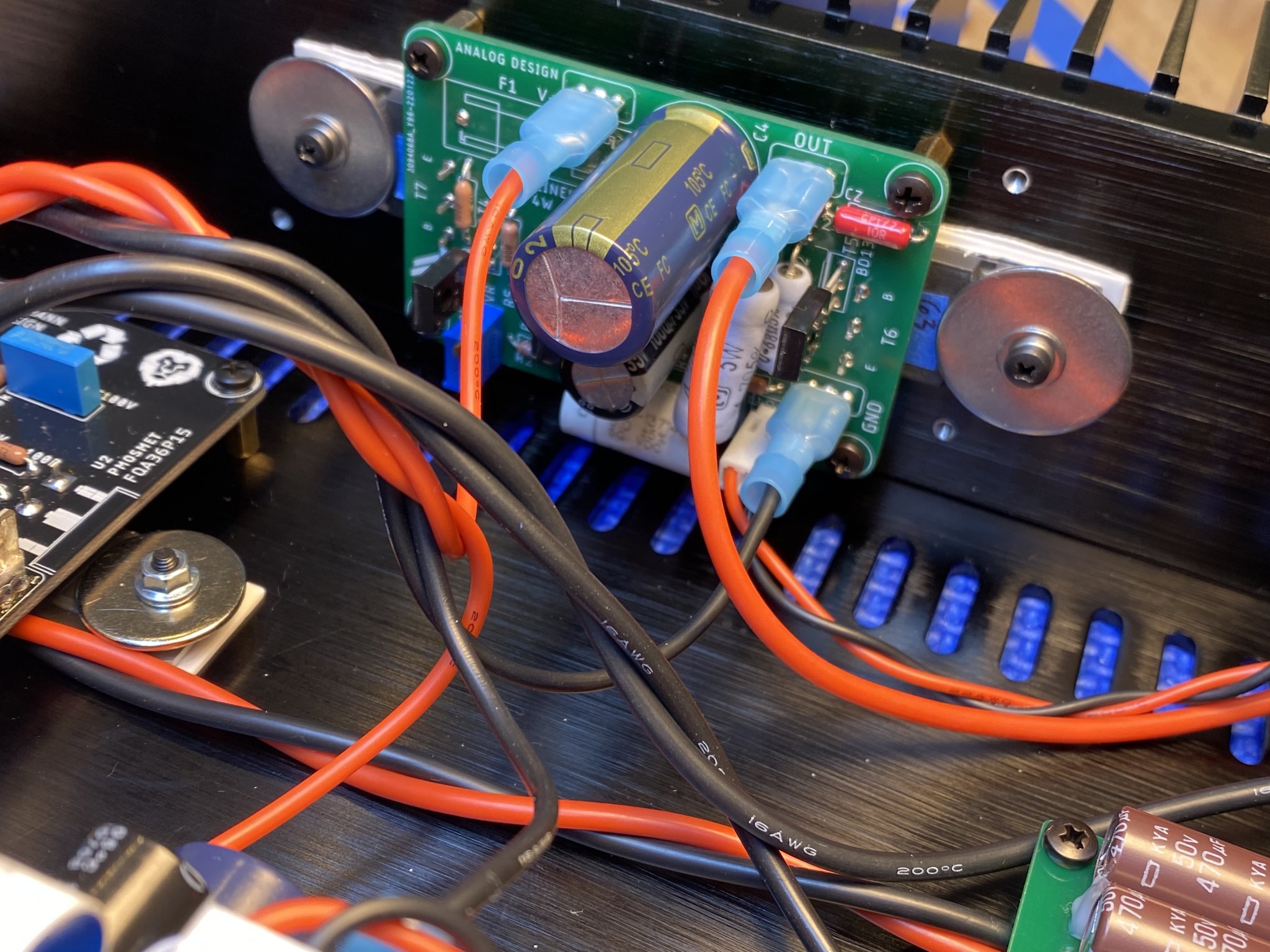

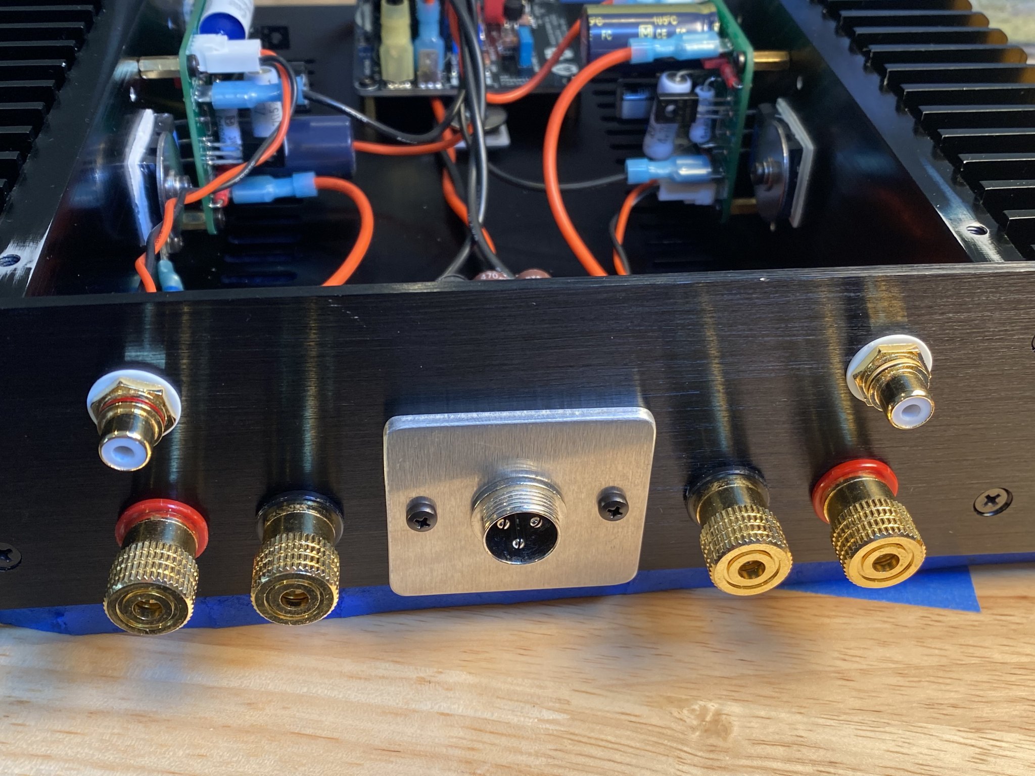

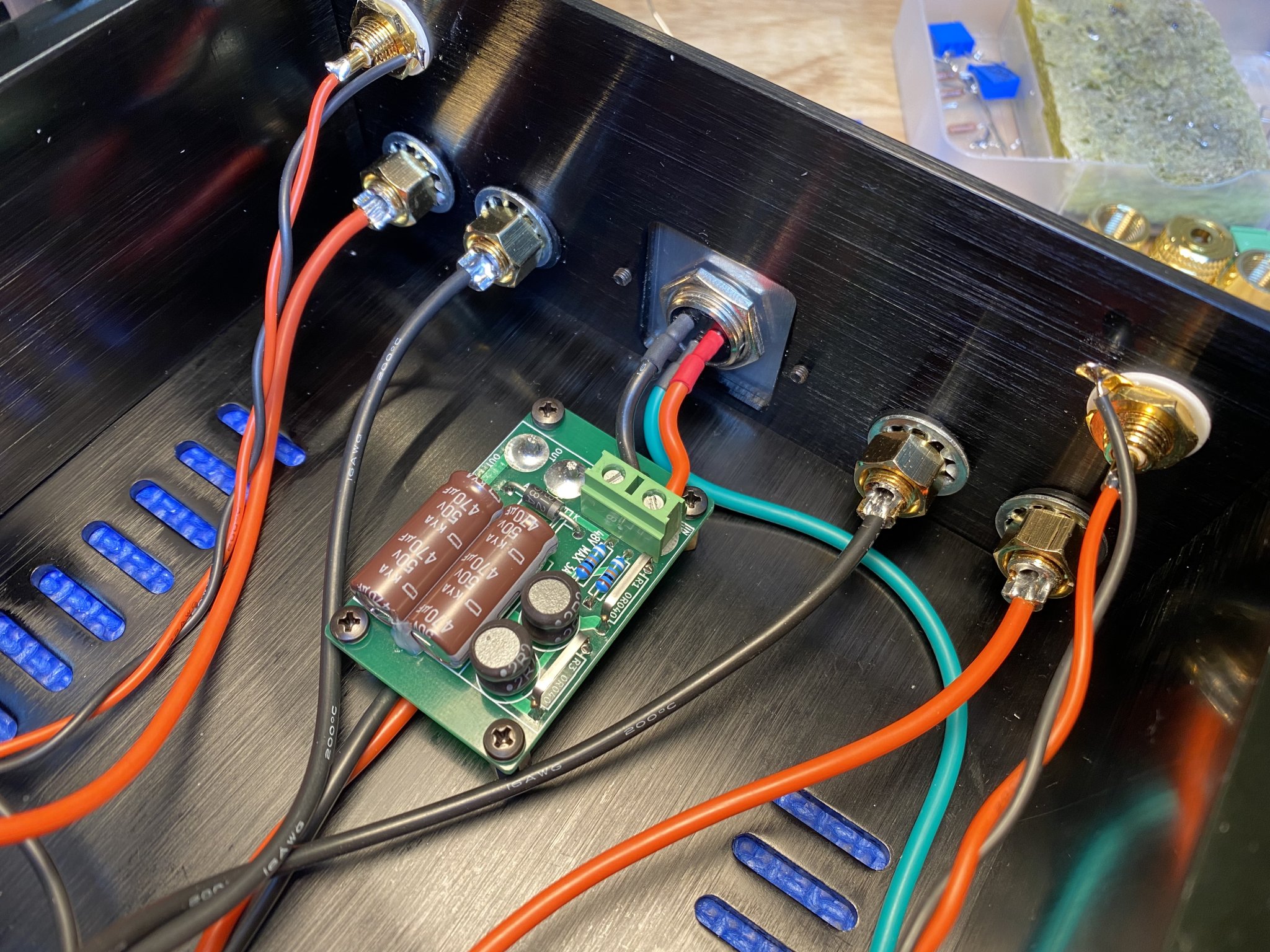

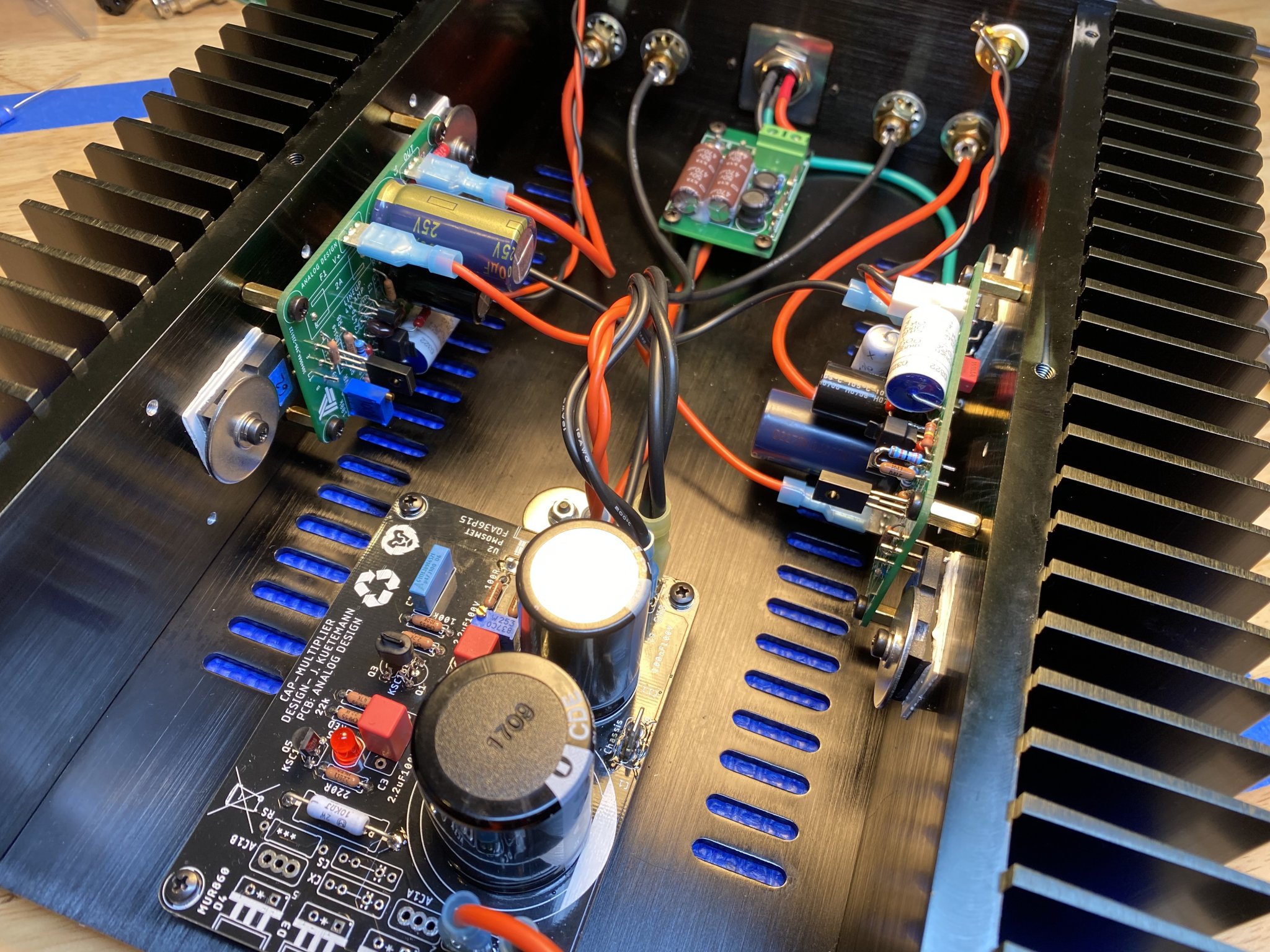

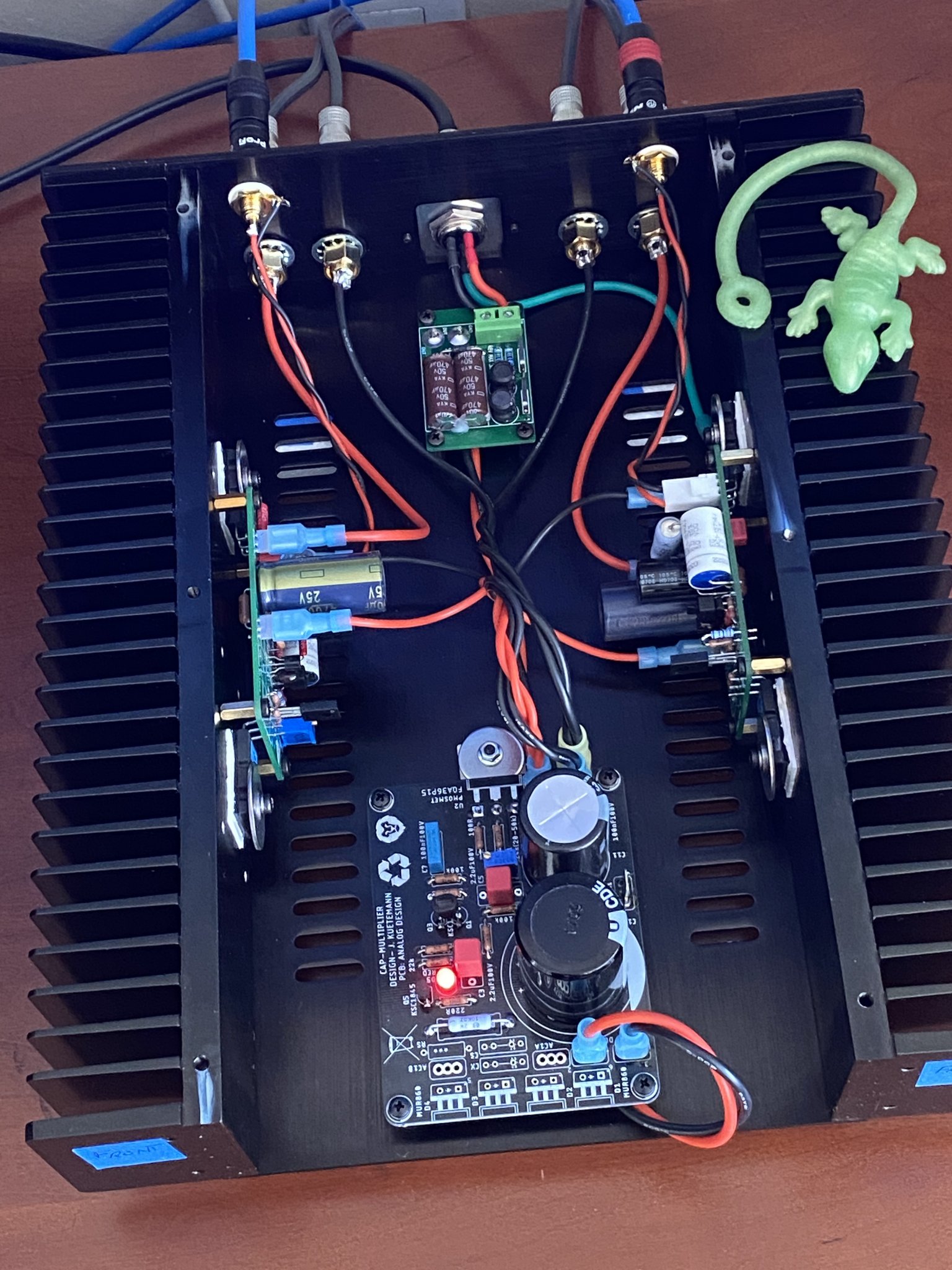

Another Lineup 4 Watter is born! This was an especially satisfying build because none of the parts, besides pcb’s, were bought specifically for this, even the chassis was repurposed.
I robbed the Meanwell 24v, 5A power supply brick from my MoFo. Mark Johnsons nice little dc filter is inline before Jkuetemann’s capMx. Output is trimmed to 21.5vdc. The amp boards run a 1A bias current. This amp sounds pretty darn good for only 4 watts! My speakers in the main system are not an ideal match, being not very efficient.

That's a very clean build.
May I ask what the thick pads are between the outputs and heatsinks?

Thanks!
I use these:
https://www.ebay.com/itm/TO-220-247...=p2349624.m2548.l6249&mkrid=711-127632-2357-0
I use these:
What is the maximum recommended supply voltage, i have some spare Mean Well SP-150-24.
https://eu.mouser.com/datasheet/2/260/MWEC_S_A0007326910_1-2552099.pdf
It has adjustable output voltage from 22.8V to 26.4V.
You can use higher voltages than 20V but unless you increase the bias, you won´t get any more output from the amp.
So it´s OK if your heatsinks can take the additional power dissipation.
If you´re fine with 4W (you can probably squeeze 5W+- out of the design as is), I´d adjust your PS down to 22.8V and use maybe a 2-stage RC-filter for further filtering. That would get you close to the original.
