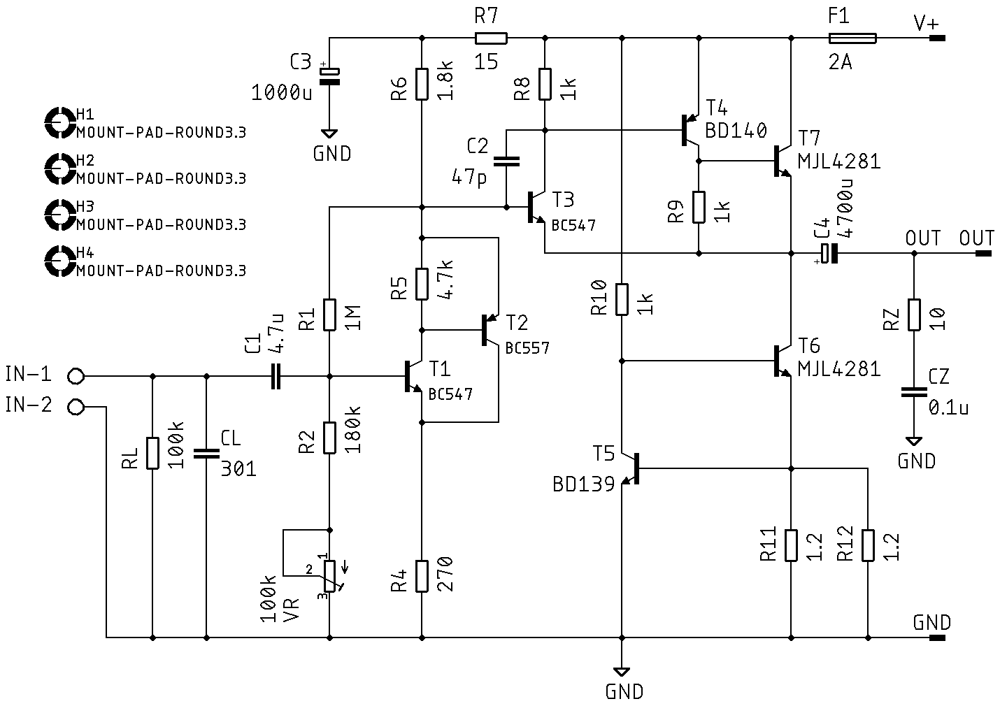

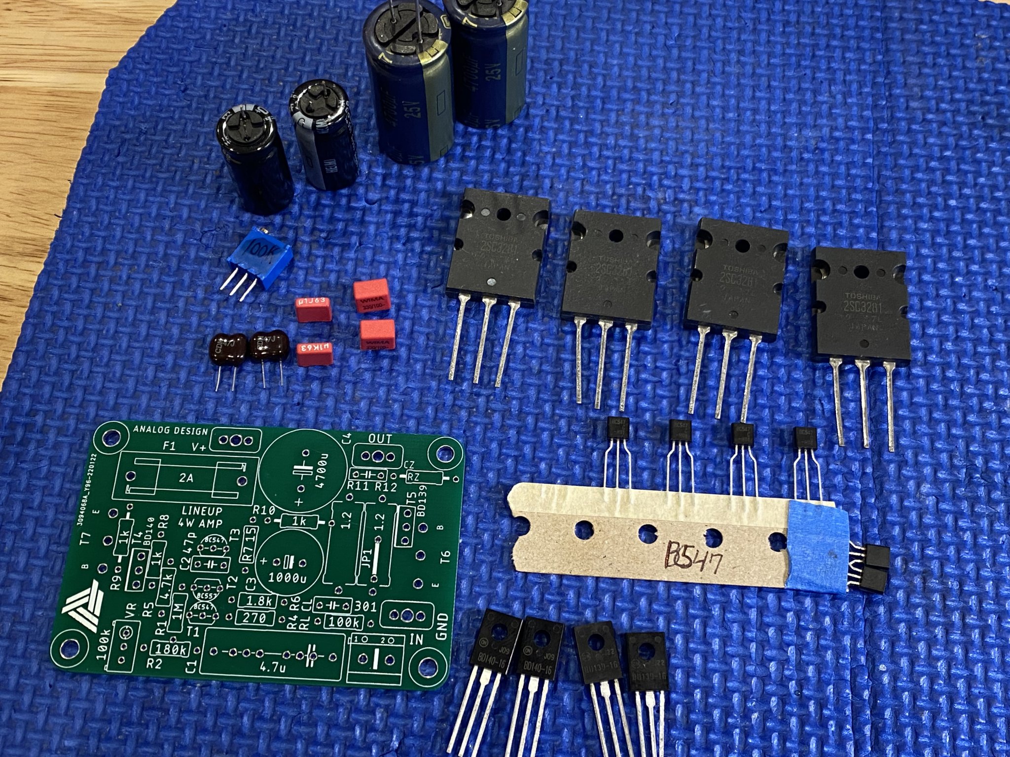

Yes need 2 pieces of 2SC5200 NPN per each amp board in this design.5200

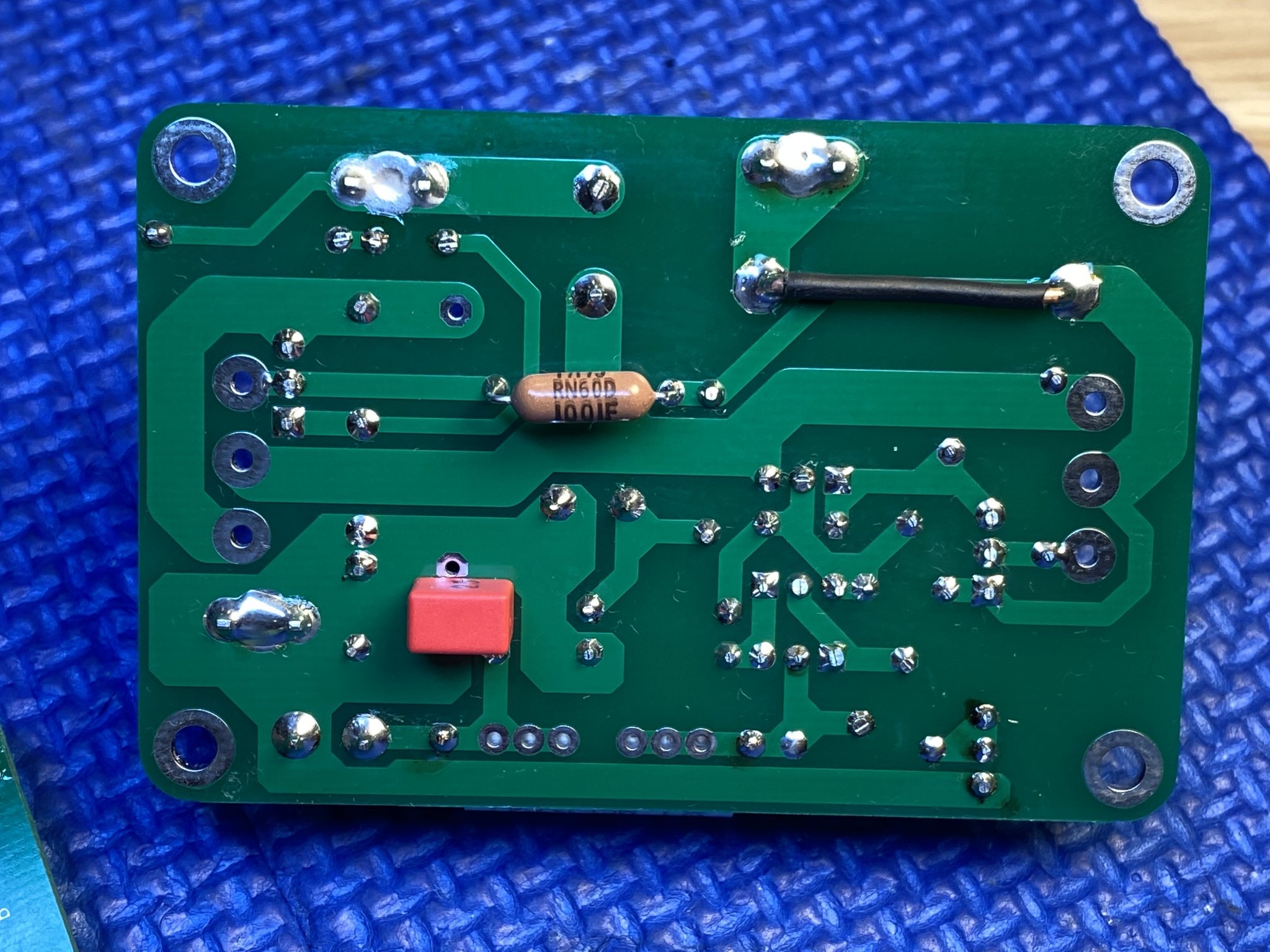

I went ahead and had the pcb’s made from your Gerbers, they look very good as always. Even though there is no copper traces on the top side, the metal does line the vias so solder will wick through to both sides.👍
I started to gather parts from my bins. My psu plan is to use a 5A, 24vdc SMPS brick feeding a capMx to drop a couple volts and added benefit of its “softstart” characteristic.

Yep, I read the suggestion of adding an inductor which does sound interesting, you know about my MOT hoarding, Hehehe!! But, the simplicity of Lineup’s circuit is what interested me. Besides, I’m planning and gathering parts for a higher power Class AB amp 😉.

RFfilterCL 301 capacitor equivalent to 300 pF
ZobelCZ 0.1 µF

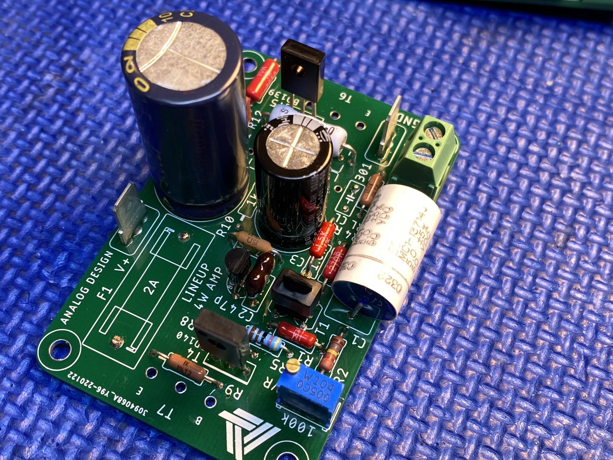

Made some progress on Lineup’s 4Watter. Using Prasi’s pcb layout everything fits nicely. Even enough room to fit a good 5uF polycarb film input cap. The only caps with correct specs in my stash for output was Pani FC, not my favorite.
R10 (R6 Lineups schematic) is a Dale 1K, 1W resistor that was a bit too chubby to fit between the capacitors in case it gets hot, so I installed it on the underside of pcb, along with a FKP2 330pF for CL.
I intend to play around with the gain and installed sockets at R6 for easy swapping.
Currently have a single 3W, 0R68 Pani ERX at R12, we’ll see how hot this amp gets with a bit over 1A bias current.

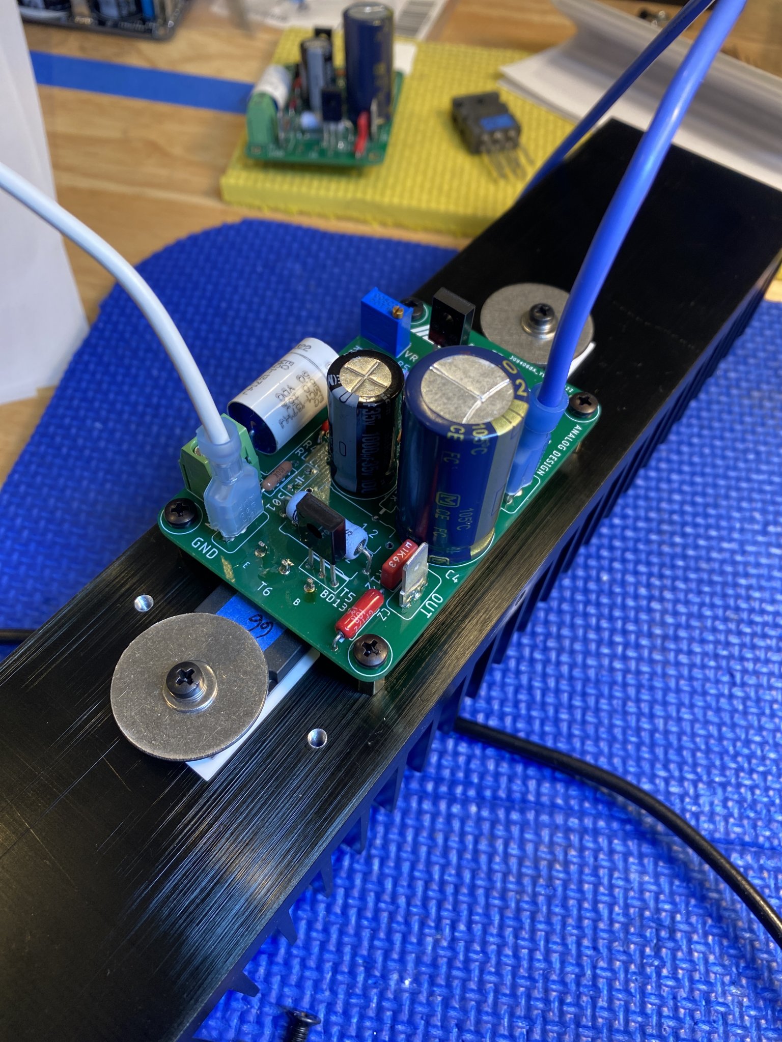

Next step is to make time for the dreaded chore of drilling/Tapping the heatsinks.

You got to load the speaker output (100R/2W to GND) - output cap can't "hang" in the air .Hmm…
I powered up one channel and I’m getting the same DC voltage at the speaker output as the lower BJT collector to gnd, 10.7vdc
Almost as if the output capacitor is missing?
