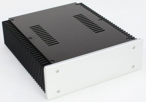

Nice PCB, as usual! Should work with popular slim cases from eBay (~245x213x70 mm, 60mm internal height). Heatsink might get up to 50-55 C with 30 C ambient.

That's exactly the case I want to try the amp in. It houses a gainclone ATM. I wonder about the Rth though, the heatsinks aren't big.
Not comparable to the known mini dissipante or the case for the ACA. The 25K rise is an estimation on your behalf or do you know their Rth?

Estimated based on the following two heat sinks from HeatsinkUSA.com
8.460" Wide Extruded Aluminum Heatsink - HeatsinkUSA
1.1 C/W per 3" (22 fins)
10.000" Wide Extruded Aluminum Heatsink - HeatsinkUSA
0.9 C/W per 3" (26 fins)
The one on this chassis is approx 9 1/4" wide 2.5" height and 30 fins. I also came across taller versions of this case in AliExpress.
Thanks hanair, that gives me some confidence to try the case. And Prasi has a good point here: some of these cases as this one have substantial front and back plates that can easily be put to good use if you enhance the thermal coupling between them and the heatsinks by gap pads or thermal foil.
The front is 7mm thick and the back at least 3mm.
That could raise the thermally conducting surface by quite a bit.
I never ventured into Class-A because of the heat concerns. I am going to do this trial and error and see where it goes!
This is what I am thinking: Irrespective of the amplifier efficiency, the power dissipation on each side is going to be 22W. If we want to keep temperature rise caused by this heat to 25C over the ambience then we need a heat sink that is rated at 25C/22W (~1.14 C/W) or less than ~1.1 C/W. You may have to adjust Iq after an hour or so until it reaches an equilibrium temperature that you are comfortable with and suitable for your surroundings. 55C is pretty hot! This is assuming that the sink temperature of 55C can keep the transistor junction temperature within its limits (which certainly is the case from my estimates even for TO220).
