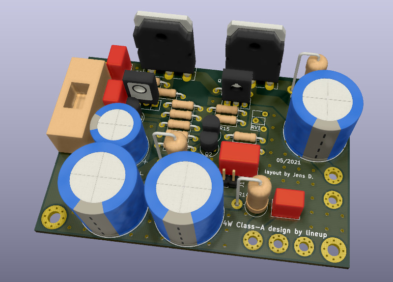

Class A, 4 Watt, No Feedback, Simple Circuit, Great Sound
Another rainy day and still no vaccine shot in sight.

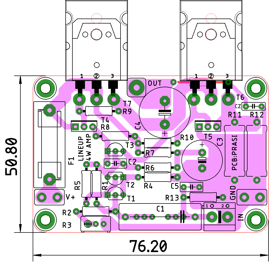

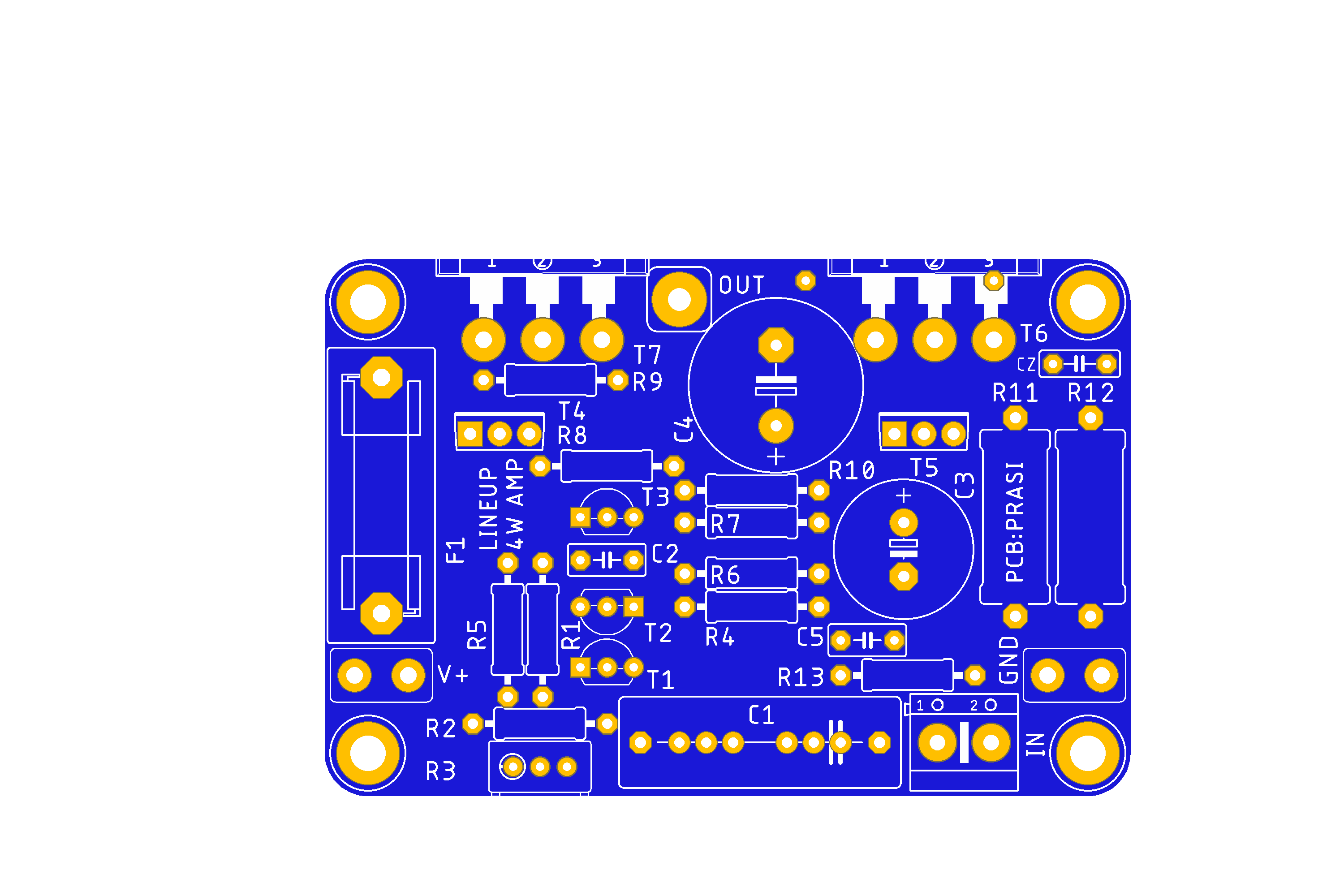

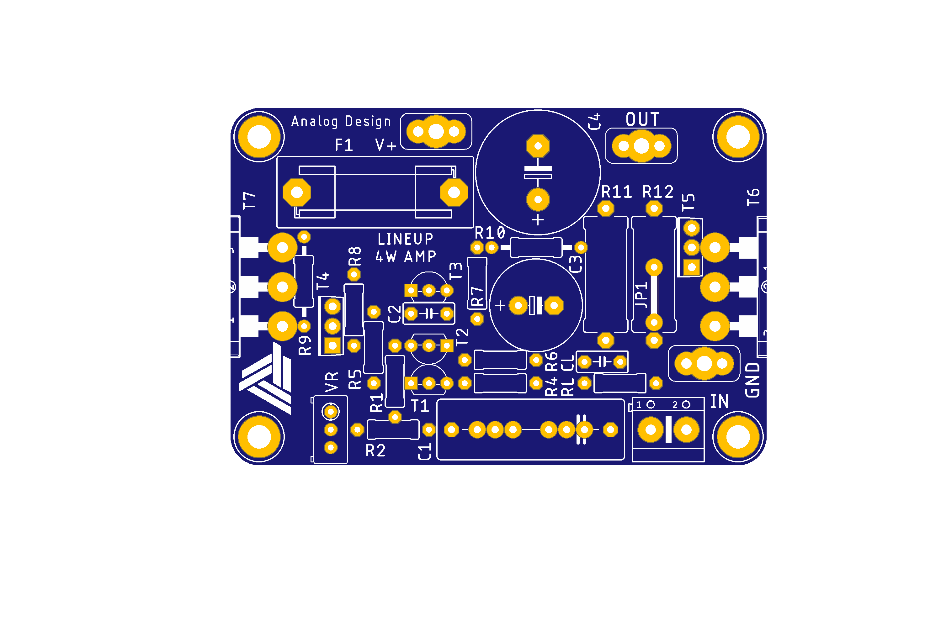

What else to do than making another PCB-layout of lineup´s super simple, single-ended class-A BJT designs.
So next PCB order is lineup´s headphone amp and this cute little class-A amp.

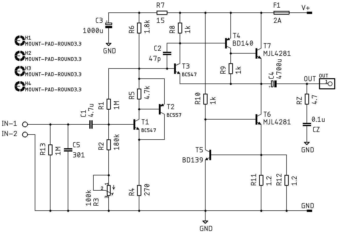

#32 You can do without the first two transistors.
It will look like a Philips circuit from the 70s.
In the emitter Q3 at the output, include 1.8 kΩ. From emitter to ground 270 ohms. The operating point is set by the divider on the base Q3.

The circuit is simple enough which was the attraction/beauty for me.
I have to admit that despite the Passlabs&Class-A craze around here I still haven´t properly made anything class-A so that will be my first!
It really looks good on paper and can be done with parts from the drawer.

The 4W class-A amp will eventually power my Mark Audio A7.3 in an active setup so power needs are pretty low to get sufficiently loud.
