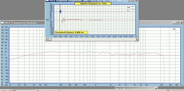

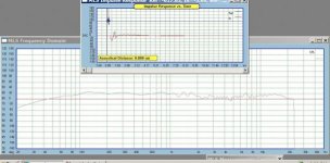

Not to cut in but I've recently build a Thor alike TL based on Usher 8945A and Hiquephon OW4. The bass was astonishing. TL terminated on the top. Attached is the SPL of te TL terminus.

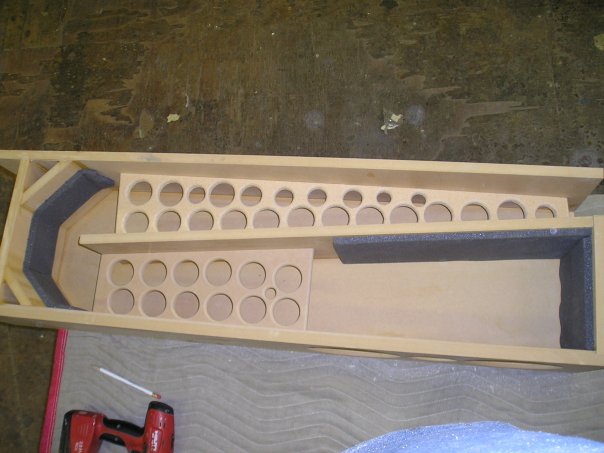

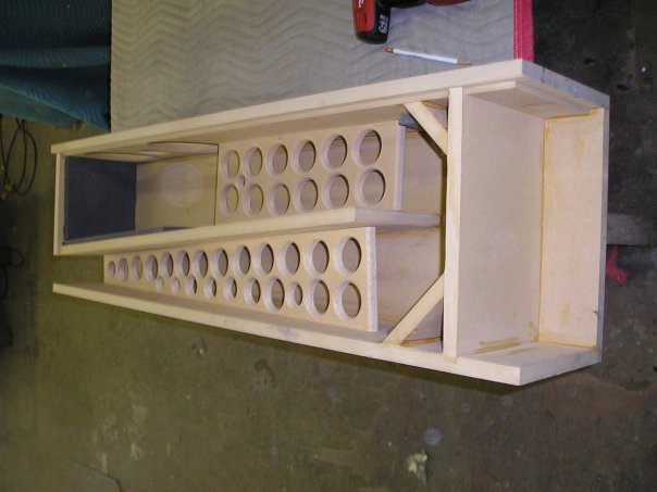

Nice to see the holey braces i have championed, but you did not take advantage of the driver braces -- these help improve downward dynamic range.

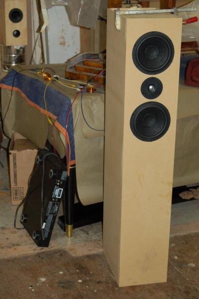

It looks like R-Carpenter has added a separate layer behind the front baffle for added rigidity, that would help transfer the driver's basket energy to the cabinet.
Nice looking build R-Carpenter! What are your plans for the exterior? I've wanted to use Usher drivers too. Got a link to your calculations and build?
But still only to the baffle which is the last place you want it to be.

Heya, thanks. No link and the calculations are long gone.

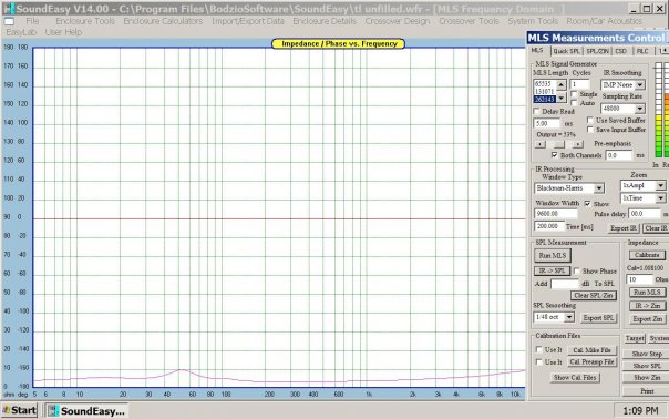

The crossover was 4th order electrical. In the begining I had 4 db BSC added but the speakers ended up back to the wall and BSC was taken out. Attached is the impedance of 2 woofers in the filled line and FR.
This project is actually about a year old and was sold to a friend.
I added a layer of elastomer to the back of the front baffle. I do find it very effective but speculation aside I am a happy owner of the accelerometer so all the guessing will be gone soon and Plywood vs MDF or bracing every which way can be verified.
The idea was to build a similar TL based on the same method that D'Appolito used but with the more budget minded drivers. At that it was a success. The exterior was not fancied up. All corners took 3/4 round over and satin black lacquer.
