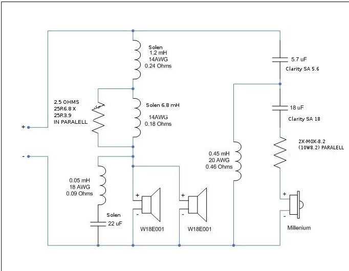

In your Short Thor Plans.pdf you show a crossover which I've not previously seen for the Thors. Where did it come from?
And thanks for the pdf-plans.🙂
I've not till now assembled all the revisted Thors in a single pdf... thanx ichiban for the poke... if someone can point me at the latest revision of the optional XO i will update that.

So that xvr in the Short Thor Plans.pdf is incorrect?
I was under the impression that the .pdf 2sooner posted
was his.
was his.
I didn't look at 2sooner's XO in any detail. The source for the optional XO in my doc is in the doc and there is some info in this thread.
dave
dave
sooner's XO looks closer in topology to the original than the optional.
dave
Thanks for the reply Dave, I'm familiar with the Jim Angie xvr. Thought the other xvr might be someone else's design and not an earlier version.
dave
Looks like this is Jim's revised XO.
http://www.diyaudio.com/forums/multi-way/142615-short-thor-build.html#post1808247
dave
Again, I accept no credit other than gathering info. The XO is the latest from the HT forum. The are some measurements I do not like on the cut out sheet. The length dimension on pdf p2 is incorrect. Adam at Madisound had to do some mild substitution
to supply the XO.
