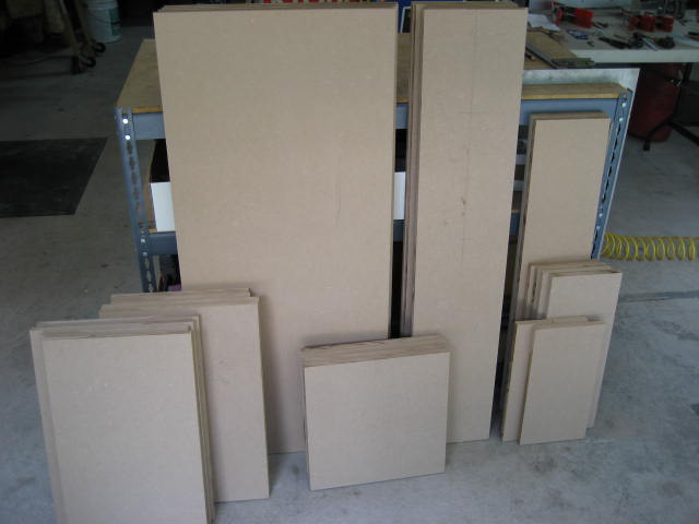

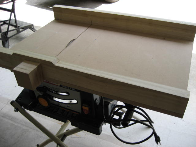

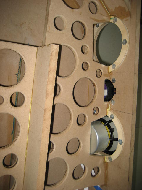

well I got quite a bit done I think, keep in mind this is my first attempt at making speaker cabinets. I cut all the boards to size for the Seas Thor and SL's Sub Bass thor.
The first thing I did was to make a cross cut jig for the table saw, I'm glad I did as it really helped to keep the cuts square and for repetability. It was well worth it.
here are the parts test fitted, I am very happy how the cuts turned out.

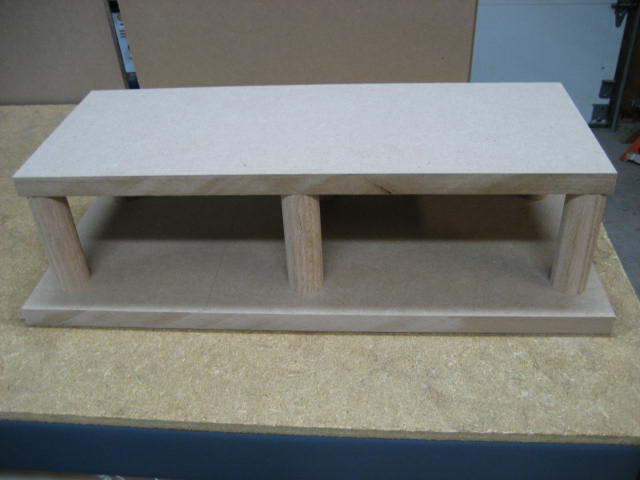

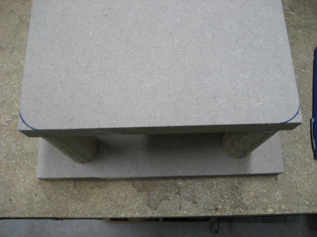

as for the pedistal I have an idea. I think I am going to use some 1 -1/4 round oak on all four corners and maybe 2 more in the middle down to a 1" or so base maybe a couple of inches wider on either side than the cabinets. also maybe rounding the front corners of the cabinets to match the radius the round oak. What do you guys think?
Is there a special glue for MDF or is wood glue ok?
also I would like to use the threaded inserts for the speakers mounting screws. Where can I get these and what size will I need?
I still have to to make the bracing with the holes. Does the one that is right behind the speakers touch the magnets on the woofers. I have the sheided ones.
How is the port attached to the cabinet?
Frank

Frank,
Sorry, can't quite picture how your pedistals will look. Could you mock one up for us??? and yourself of course.
TiteBond wood glue, either #3 or 4, I like to use 1 coat on the endgrain of MDF and let it soak in, then glue both of the pieces in place and shoot a couple of pin nails into it while it drys. Never ever ever had a glue joint fail when done this way.
As far as the brace touching the backside of the driver.....I suppose it should, but mine don't and haven't had any problems with 'em yet. I have the ones with the rubber boot. I have several horizontal cross braces in addition to the one vertical brace though. Make sure you don't center the vertical brace, off set is better for sound wave cancellation.
You can get the threaded inserts from OSH (Orchard Supply Hardware) they have several styles to choose from. I like the ones that look like corkscrew picture holders for sheetrock. It is a VERY good idea to use 2 layers of MDF at the driver locations. Back bevel around the drivers to make them fit. 2 layers is plenty of support and you may not even need the threaded inserts, depends on what type of screws you mount drivers with. I used #8 Allen head.
I attached my front loaded port to the back side of the front Baffle with sub-floor adheasive. On a test chunk of wood route out a hole 1/4" deep that is the same as the outside diameter as the port tube. Snug fit is what you are after, glue it in place and let it dry. When it's dry, drill a large hole from the otherside into the center of the port tube. Use a flush cut router bit inside the port and Voila. instant perfect fit. I then used a 3/8" roundover as a flare to give it a finished look. However, as you are going to downfire your Thors, it doesn't have to be beautiful.

Thanks Renron I will mock one up and take a pic. Thanks for the detailed answers to my questions, it will make my job a lot easyer.

Frank,
Aaahhhh, now I get it! Thanks for the mock up. Looks good, and a cool idea. Be aware that the tweeter height will change accordingly and you may need to sit on a phonebook or two to get your ear to the "sweet spot" tweeter wise.
Looks like a good idea and I like the rounded front, are you planning on using a round over bit too?

Hi Ron
yes I know I will have to adjust tweeter height, so I will just add layers to bottom of base. or get a lower chair LOL
I would like to match the Radius on both front corners all the way up the cabinets. I don't know if there is a router bit that big, 3/4 is the biggest I've seen.

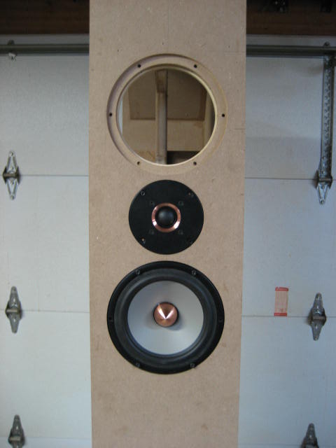

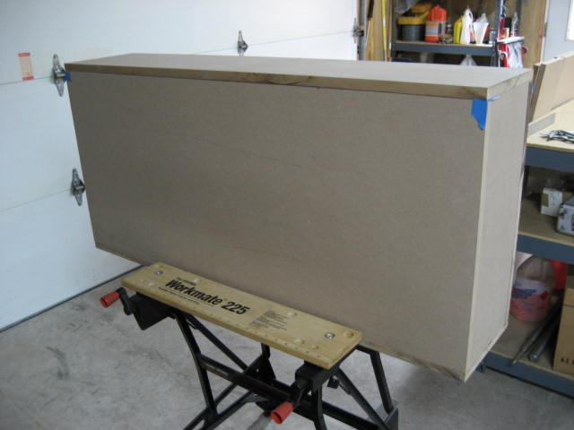

Hi all
well I have one cabinet almost completed. I haven't much time to work on them and it took a lot longer than I thought it would.

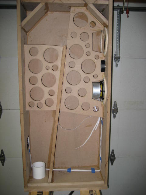

I have a question on the batting amount used. I started with the recomended amount of 9 and 15 oz but it sounded muffled. I removed 9 oz from the rear compartment and it really sounded much better.
Can someone give me a idea of how much to use and where to put it? Does teasing the batting make a differance?

Frank I might not be any help because mine have a different internal structure, no typical TL baffle like yours do. I have "tuned or voiced" mine to the way I like them, and how they sound where they are placed in the room. I have removed even more of the stuffing after each change. I LOVE the new crossover design and it being outside the "box". I have removed all the stuffing out of the bottom / last 1/3. I would recommend that you do NOT glue them up until you have an opportunity to live with them for at least a few weeks. Remember they WILL take about 80 hours to break in and sound their best. I'd be screwed if I could not have access to the internal chamber. I also replaced all the wireing to the drivers with different gauges for bass and tweets.
Only you can tell if you like the stuffing amount and how they sound in your listening room. If they sound muffled to you then take out some more stuffing until they sound boomy, then slowly replace stuffing and give'em a listen. If you pick one song that has great detail and use it as a guide, you'll soon hear the difference in stuffing amounts and locations inside the cabinets.

Don't tease the batting.........You'll only P*ss it off. %)
fluff is good, packed is bad. Hey, it's DIY! Have fun learning.
