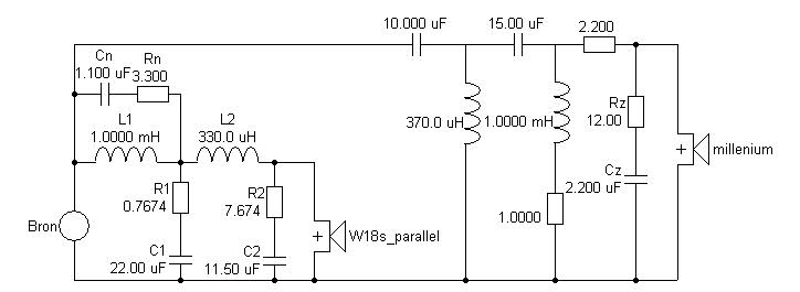

btw: maybe this already came across in this thread, but can the Odin filter be used for the Thor?
if there is nothing to exite the resonance, there will be nothing that resonates... 🙄planet10 said:It won't fix it, the resonance will still be there. The only place it can be fixed is in the driver itself.

I don't remember who posted this -- but it was in my files:
http://www.diyaudio.com/forums/attachment.php?s=&postid=1319454&stamp=1191790511

Admitedly I am a beginner at this DIY thing, just trying to understand the concept of resonance as it applies to the Thor/Odin speakers.
Is the resonance in the cone / spider or the frame? In the case of the frame could blue tac or similar compound be applied to lessen the effect? What frequency are we talking about?
Would those frequencies (assuming their above the Xover Fq) be excited by the tweeter? As Henkjan suggested.
If the tweeter was better isolated from the interior of the cabinet would that help reduce the energy transfer to the W18s? Or is the baffle and driver proximity the conduit?
I hope this is not too dumb. And I know I'm out of my league with this stuff, but I'm learning about a hobby I enjoy.
Ron
dave

Even if you notch that frequency out completely (ie create a huge dip in your FR), harmonic distortion products from lower frequencies will still excite the resonance (measurements were shown, IIRC, on a german forum)

jackinnj said:if you put it black&white then you are right of course, but I doubt if it will be audible...Even if you notch that frequency out completely (ie create a huge dip in your FR), harmonic distortion products from lower frequencies will still excite the resonance (measurements were shown, IIRC, on a german forum)

Thank you, I can create with wood what others have taken the time to design. I am just learning electronics. NOOB. But, I can build circuits.
Dave, as I understand your post(s) the 1/2 order and secondary harmonic frequencies can cause the distortions. So....there is no way to eliminate them, only reduce the primary ones. I think I got it.

that would be from the dutch forum... you might want to ask him if you are seriously interestedRenron said:Henkjan, do you have a link to Jeroen_d 's post on that X-over filter?
Re: Re: Re: Re: Re: Re: chorus sounds gritty or Xtra sharp!
I think this is it...

I've paralleled the 2u2F cap in the original tweeter network with another 2u2F cap as was suggested somewhere? and the grittiness/breakup is much less.
