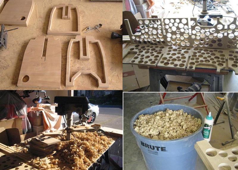

JGWinner,
you are absolutly correct in all your points. I was just offering other (affordable) solutions. When cutting MDF, cut most of the way through for the holes then flip the board over and finish the cut from the other side. It keeps the MDF from fracturing and flaking out on the back of the cut. If you do it over a garbage can it helps with the mess. 🙂

Ron:
Alternatives are always good - good point about the drill and flip. It helps with plywood but is really essential for MDF of course.
What brace is that in the upper left of your pic? Looks like a curved side to your speaker?
I love the trash can shot!

John,
The solid ones are internal tops of my speakes, not the finished tops, and the hollow ones are some of the internal rib braces attached to the spine. Yep, good guess, they are from my curved thors.
