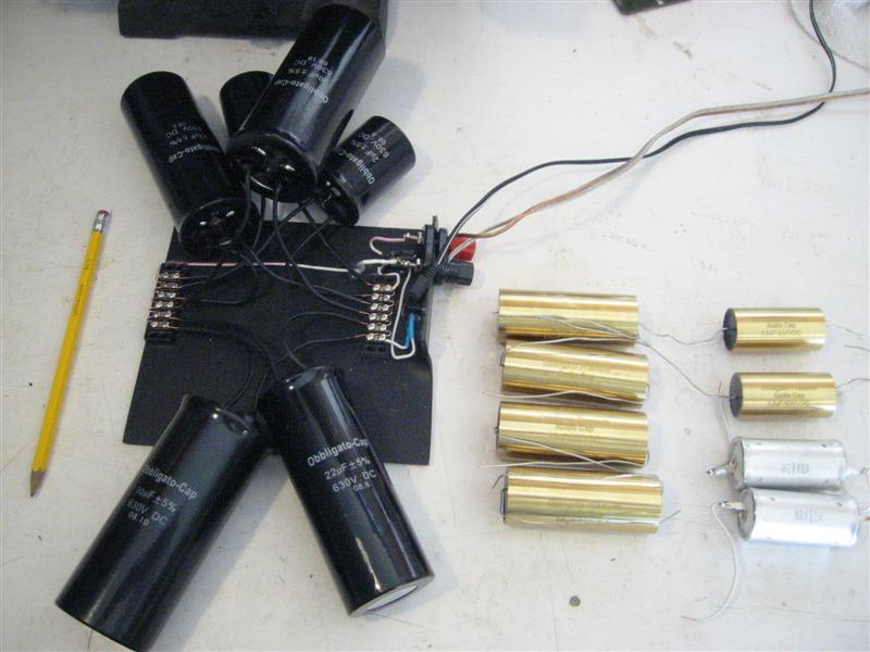

Dave, and SM.
What a marvelous plug you designed too!
I was listening to a new CD I got for Xmas, "Pictures from an Exhibition", I had to touch the subwoofer to make sure it was not playing. It wasn't. They don't replace subs, however they sure drive deeper than most expect for their size (drivers)
I received most of my new Xover parts for Xmas as well. Here are some of the Caps that will go in a new Xover outside the speaker.
Mike A. ,
If you start a new thread and ask your questions there, upload photos I sure others along with myself will be more than happy to help you however we can. This is a wonderful group of DIYers, very helpful.
Jump in and start asking. Don't be overwhelmed by inaction.
My curved Thors' were my first pair of speakers I ever built. I have since built 2 other pair and a MONSTER subwoofer for HT. How can I help?
PS, If you start a new thread put a link into this thread.
Ron

6) Amen to that, my new X-overs will be OUTside
Thanks again for all your work P-10
Ron
