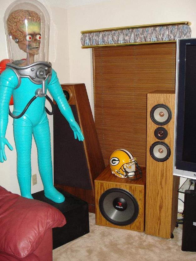

Here is a pic of my "other" subwoofer upstairs, a 15" (38WX) Focal Utopia to help my SEAS subwoofer get LOW.......... notice the JBL - L250's in the corner (an 80's holdover)................ I have the Revel Speaker Studios (original version, not the newer box looking) as my front speakers downstairs in my bedroom, Kef ref 205's as my rears......... and a set of the older Kef Ref 105.4's, another from my 80's phase sitting in the front room waiting to find a good home.............. my wife thinks I'm crazy, but when you stop wanting things you got one foot in the grave, right???? lol..................

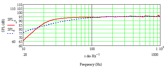

But how about a Super Thor, featuring two eight inch W22EX001 and a T29CF002?
How would a MLTL box for that configuration look like? Huge?
Would there be any improvement in the really low bass?
Short Thor? Mm-hmm.
Small Thor? Definitely!
Well, I'd rather you guys than me with that evil break-up mode. The XO is going to have to be good & well below that point.
Anyway, a box is easy enough. 56in x 8.75in x 16.25in (HxWxD). MTM layout, tweeter 12in down from internal top, 3in diameter x 5in long vent centre 2in up from internal base. Stuff 0.4lbs ft^3 of hollow-fibre material from the top down 26in.
