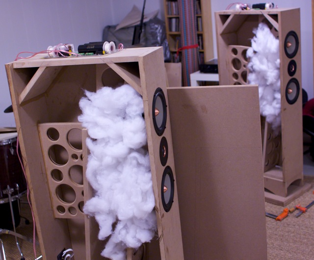

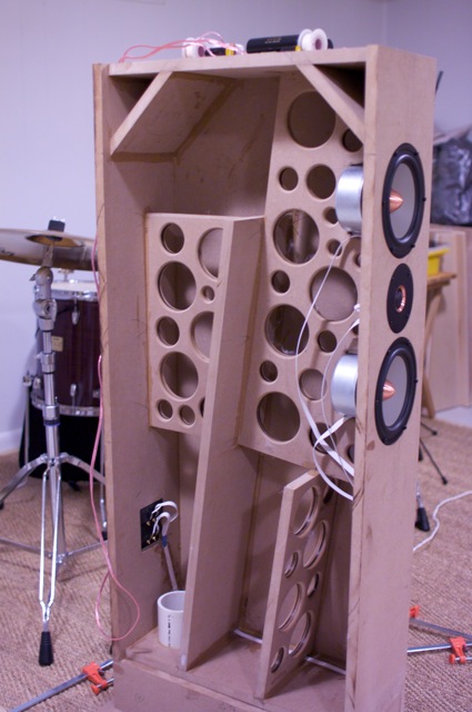

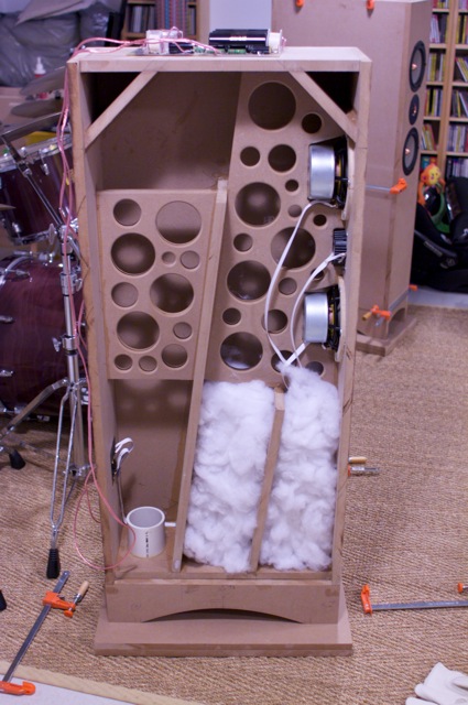

I did moove the stuffing per your recommendation. The sound has improved considerably from it's original configuration. It's much cleaner now. I'm still getting a little boominess (not in the listening position), but I'm wondering if it could be due to the fact that the enclosure is not completely sealed. The loose panel is well clamped though... Or if I need some more stuffing. The Original Thor design calls for filling through the whole cabinet.
Or maybe I should move my drum kit somewhere else... LOL!
Anyway, I've attached a few images. The initial configuration, stuffing only at the bottom, no stuffing, and current configuration.
I'm thinking about adding a litle more stuffing throughout the enclosure, just leaving the volume next to the port free.

I just filled the whole cabinet except for the part closest to the port and my resonance problem is gone, but the sound is not as open as before.
There must be a midle ground to be found. Maybe I have to losen the stuffing more, take some out and make it less dense...

I think you've found out about "tuning" the cabinet. It will also be different in a different room. Your lucky you can access the cabinet from the side to adjust the density of stuffing. I have to go at it from the bottom.

Just a quick follow up on my stuffing adventures.
I tried to stuff the fat Thors with the recommended amount (0.75lbs per ft3) and it is sounding very good. No resonances but still a very deep and tunefull bass, so much detail...
