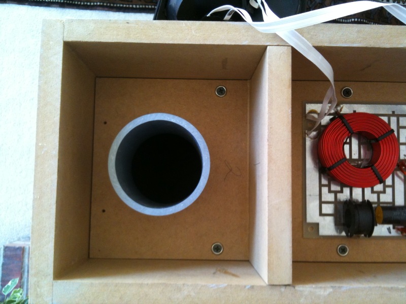

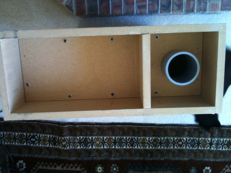

I'm running mine completely sealed in a 1.2 cu ft cabinet 10 inches wide with a 1/2 inch roundover on the sides of the baffle. The bass is pretty good but a sub definitely improves things. I think the modeled bass response has a -3dB point of 50 Hz.
1) If want to go with the port, make the cabinets as big as you can. You could then play with the port length and dampen it further with cotton or similar if bass is too fat. I would recommend the cabinets 10" wide with the 1/2 inch roundovers as mine are.
2) For the crossover, Madisound should have all the parts needed. You can use the 14 AWG Solen inductors. If you're interested, I have another LR4 crossover design which crosses at 1.5 kHz. It has a few more parts than the 2 kHz LR4 design but it theoretically has lower distortion due to the 3rd harmonic peak at 1.6 kHz further attenuated. Both LR4 designs sound good.

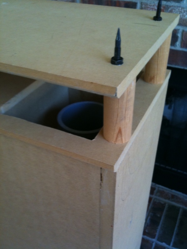

Unfortunately I already cut the blanks yesterday since I had some MDF lying around and some spare time. The box has a 9.5" baffle and is 1.18 cu ft without a brace so I think I'm going to go the sealed route. I'll cut some holes in the brace as well.
If I don't like it I can always build a bigger box and put a port in it. The practice won't hurt me. Ultimately I want to replace my 20 yr old Vandersteens in the HT with Clearwave Dynamic 4T's and the Odin's are practice before I build something bigger.

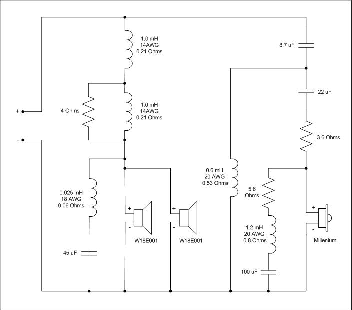

I'd be very interested in your 1.5Khz crossover design if you can point my towards a schematic. These first XOs I plan on having made for me, but I'd like to make my own at somepoint, but for now baby steps.

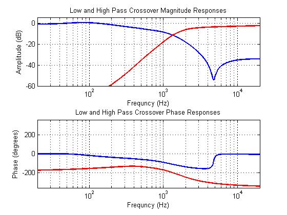

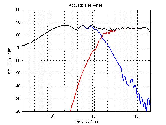

You may want to do a 2" flared port in the back. You could then start with a long length and cut it back and possibly dampen it to where the bass sounds right. This would give you flexability with the bass response. If you go sealed, you have only one option.

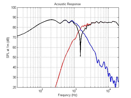

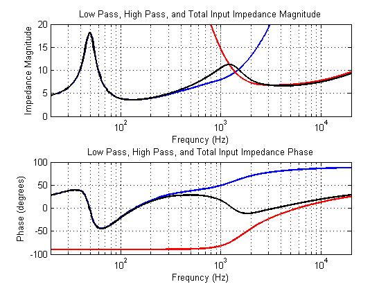

Here's the schematic for the 1.5 kHz LR4. I'll post response plots tomorrow.
I bought parts for this at Parts Express. Not sure if Madisound can make the 0.025 mH inductor.
In my crossover, the 3.6 Ohm is a 5.6 Ohm in parallel with at 10 Ohm, the 8.7 uF is an 8.2 uF in parallel with a 0.5 uF, and the 22 uF is a 20 uF in parallel with a 2 uF.
