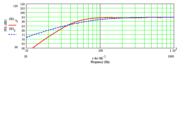

What happens to the Thor if you remove the transmission line and make it sealed?

What would be the difference between the original Thor enclosure and a sealed box? Not a lot. The standard Thor enclosure is so heavily stuffed it's basically become a badly designed aperiodic enclosure. Dave and Martin pointed this out quite a long time ago. The frequency response curve for a sealed box of the same volume looks almost identical, though the respective impedences are a little different. A 'proper' aperiodic enclosure could be interesting though, and for almost no extra effort over a sealed type, you'd bet better FL and a flatter impedence curve. I tried simulating one a few pages ago. Not my best as I took a duff approach, so here's a proper one, done in the Ported Box sheet.
3/4in material assumed, & internal dimensions. 45in tall. 7.5in wide. 12.5in deep. Tweeter centre 10.25in down from the internal top. Stuff the enclosure 0.5lbs ft^3 of Dacron or similar from the internal top 25in down. Aperiodic vent centre 4in up from the internal bottom on the rear panel. Couple of options here. You can either use one or two Scan Speak aperiodic vents if you are so inclined, or take the cheaper and more easily tweakable, if not as pretty, option, and cut a hole / slot, and stuff it with reticulated foam or fibreglass, nominally 1.0lbs ft^3.
