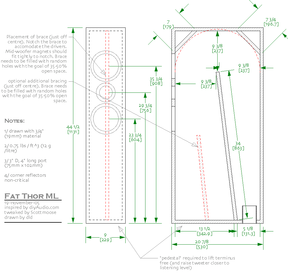

rabstg said:While the finer points of theroy are discussed Repute is enjoying his new Fat Thors on the custom stands.
Comments?
More pics?
dave
That would be a Repute question.... I just built them, he has to live with them. 😀
But I can say from the original Madisound cabinets to these that they went from an "ok" speaker to one I "could live with"...
rabstg said:they went from an "ok" speaker to one I "could live with"...
Well that is something...

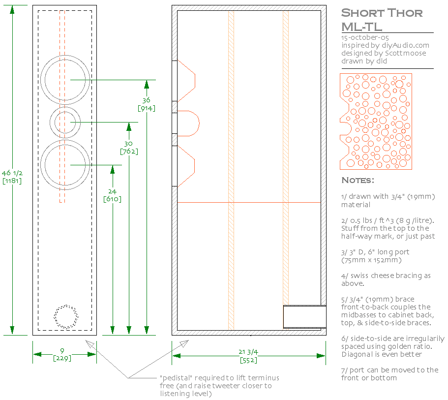

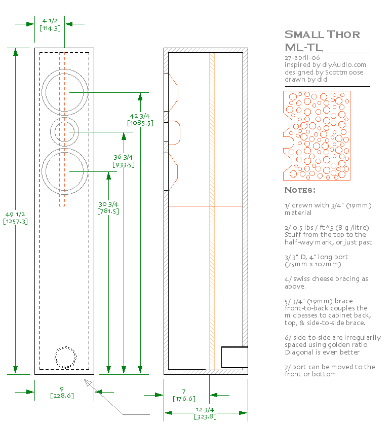

And with a kind poke from another member i finally got Small Thor drawn. Compared to the other contenders this puppy is diminuative....
dave
Is it a "2 chamber" box?
What is the wood from bottom to top that we see the edge of?
Is it a vetical side wall brace that has unseen holes?
And what is the difference between that and the fat thor other than volume?
How much extension does this one lose?
